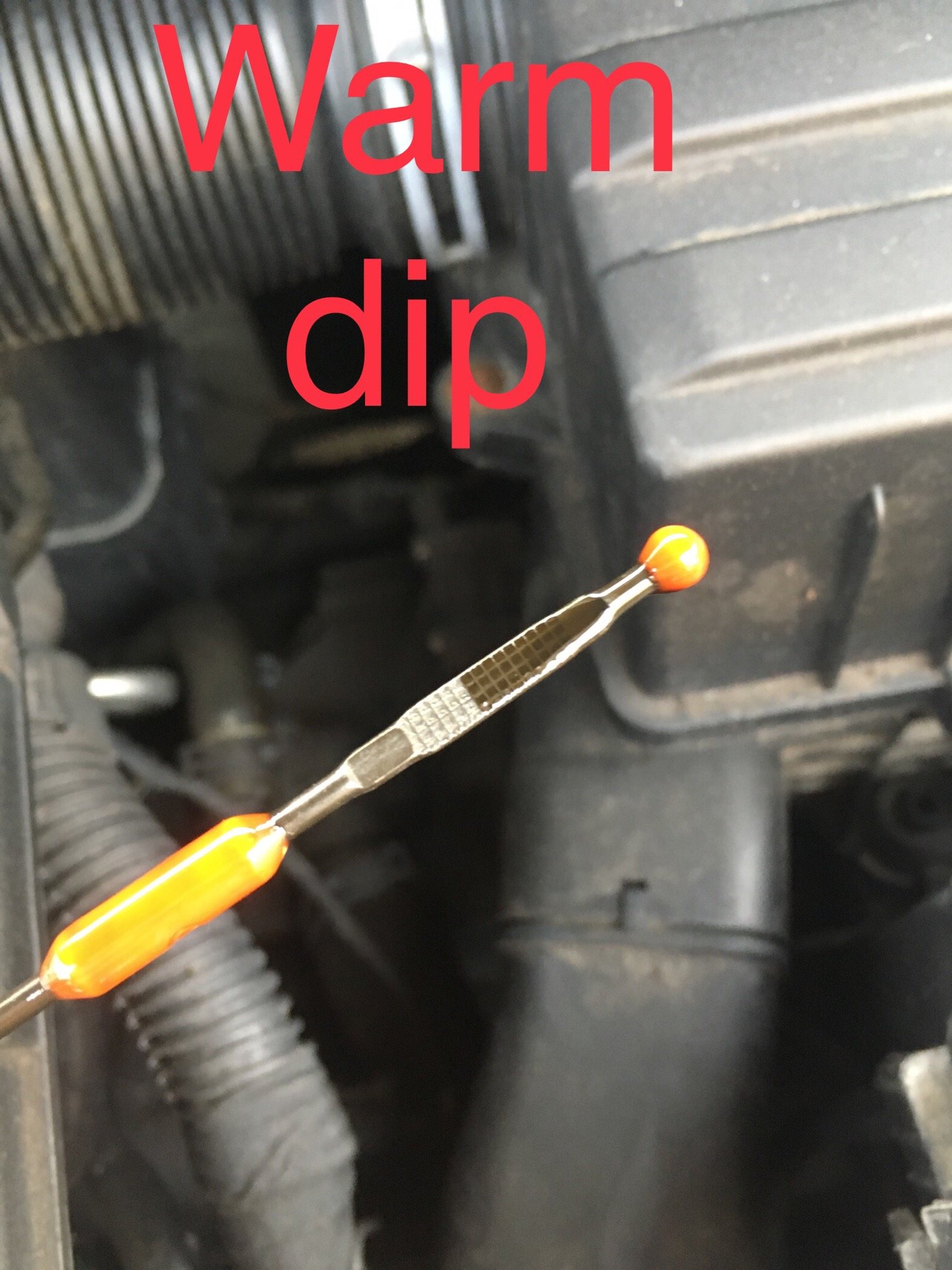

No lights came up in dash i have dipped today randomly as im looking to book in a remap but with the oil issue im holding out.
What is a gubbed engine?
I use 99 momentum
i have changed plugs to the denso’s
i will be dropping the sump and changing oil and filter.

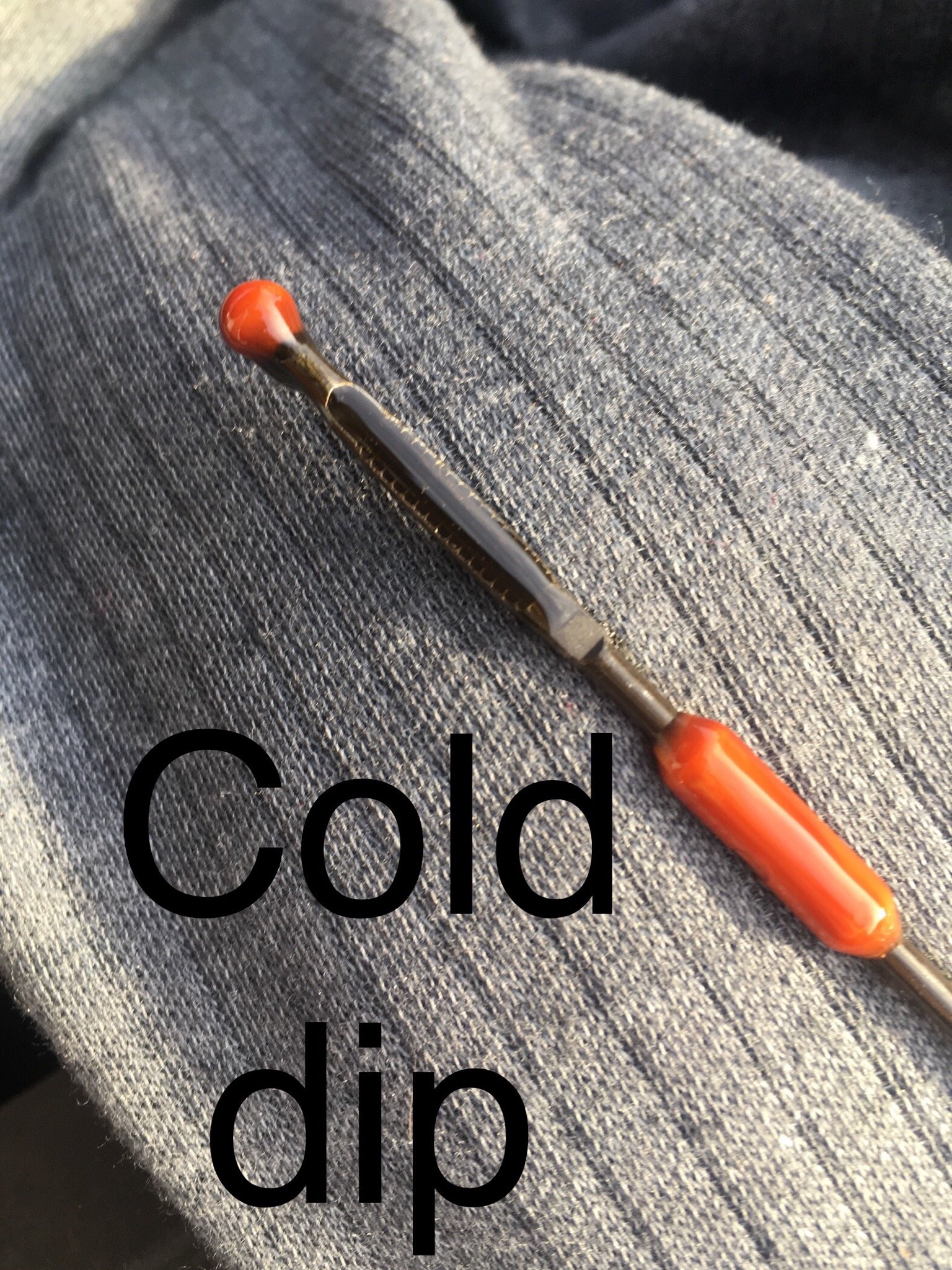

I did notice in the oil filler cap smelt a lot like unburnt fuel very petrolly
Did you dip the engine at operating temp, and also when cold?
How much oil have you added. ?
   No oil on the bottom orange ball is over 1.5 litres short of oil from 3.6 litres.
No wonder it would smell.
Do not drop the sump.  Remove the Sump Plug.  or suck out the oil via the dipstick tube and then remove the sump plug, any oil and fit the new oil filter.

I dipped at operating temperature
i have added 1ltr of oil
by dropping the sump i meant the plug.
Will fit filter without the o ring as suggested too.
1 Litre is not enough oil if the oil cold is at the bottom orange ball.  So you have not enough oil in.

I dipped at 90 degrees temp ? Should u fill to top of cross hatch area when hot?
Edited by GT0161
Spelling

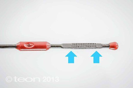

Yes.
Then when it is cold see where it is.
It should be on the flat bit above the Cross Hatch.
1st Picture too low when Hot, and far too low when stone cold.
Edited by Skoffski

Will do that tomorrow and post my result thank you for your help skoffski
That oil level is perfect, most of the twinchargers I have seen seem to settle at half way down the dip stick same as your photo.  Make sure you take the reading on very level ground.

@OzFabia
I think it is nonsense unless you did the oil change or watched it done and afterwards you know there is at least 3.6 litres in and that is where it is with a 'at Operating Temperature Check', so above 80*oC Oil after 'a few minutes' when stopped on the flat.
& higher than that once the engine has been sitting and stone cold.
If you know there is the correct quantity of oil and it is on the cross hatch then good.  IME it is not 3.6 litres when it is half way down the 'Area B'.

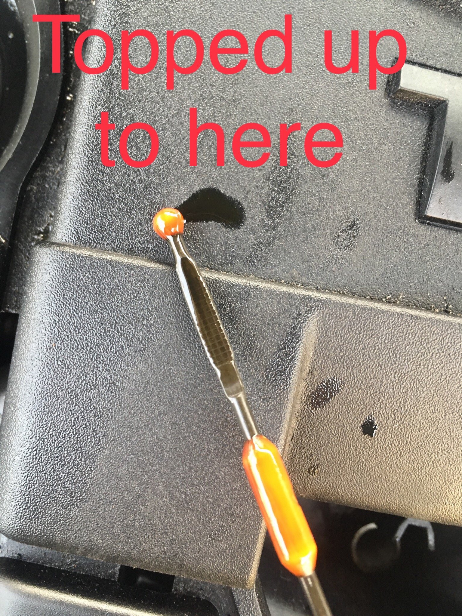

Ok so i did a cold dip earlier on today then a warm dip and it sropped so i topped up matbe a little too much im not very good at these things if i come across a bit thick lol
will check once every week from now on and post results
Good.

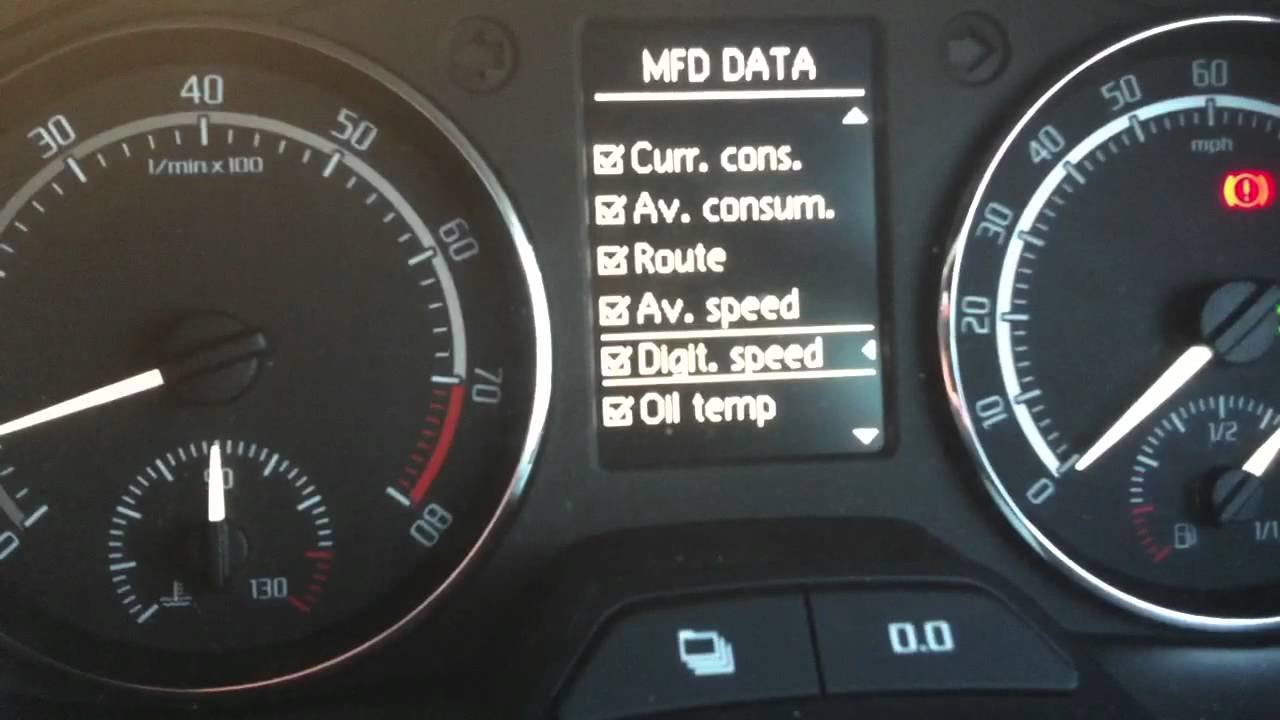

If you have 'Oil Temp' enabled, keep an eye on it and how long you drive until an indicated 50*oC, then till it comes up to 80*oC then 92*oC or so with easy driving.
The higher oil level helps it run cooler, and when it gets up above 100*oC the temp back down sooner as you slow down.
Chill and don't worry, maybe dip it cold occasionally for the next few tank fills of fuel.
Check tomorrow where it is before you start the engine if the car is on the flat.

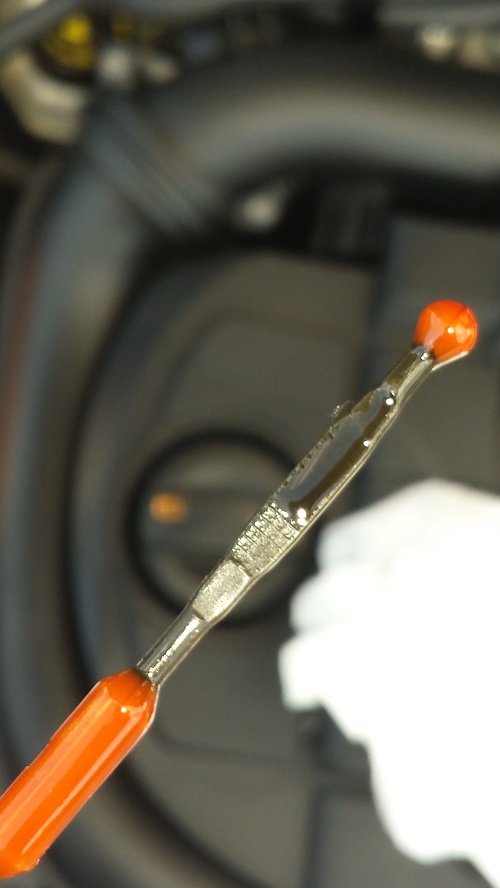

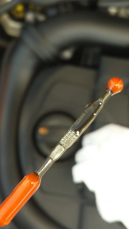

When i changed a Twincharger from 5w 30 FS LL to 5w 40 FS i found the engine oil was showing the indicated temp a few degrees lower on the same run on the same road at the same speeds.
I tried that quite often with different cars / engines over a few years.
