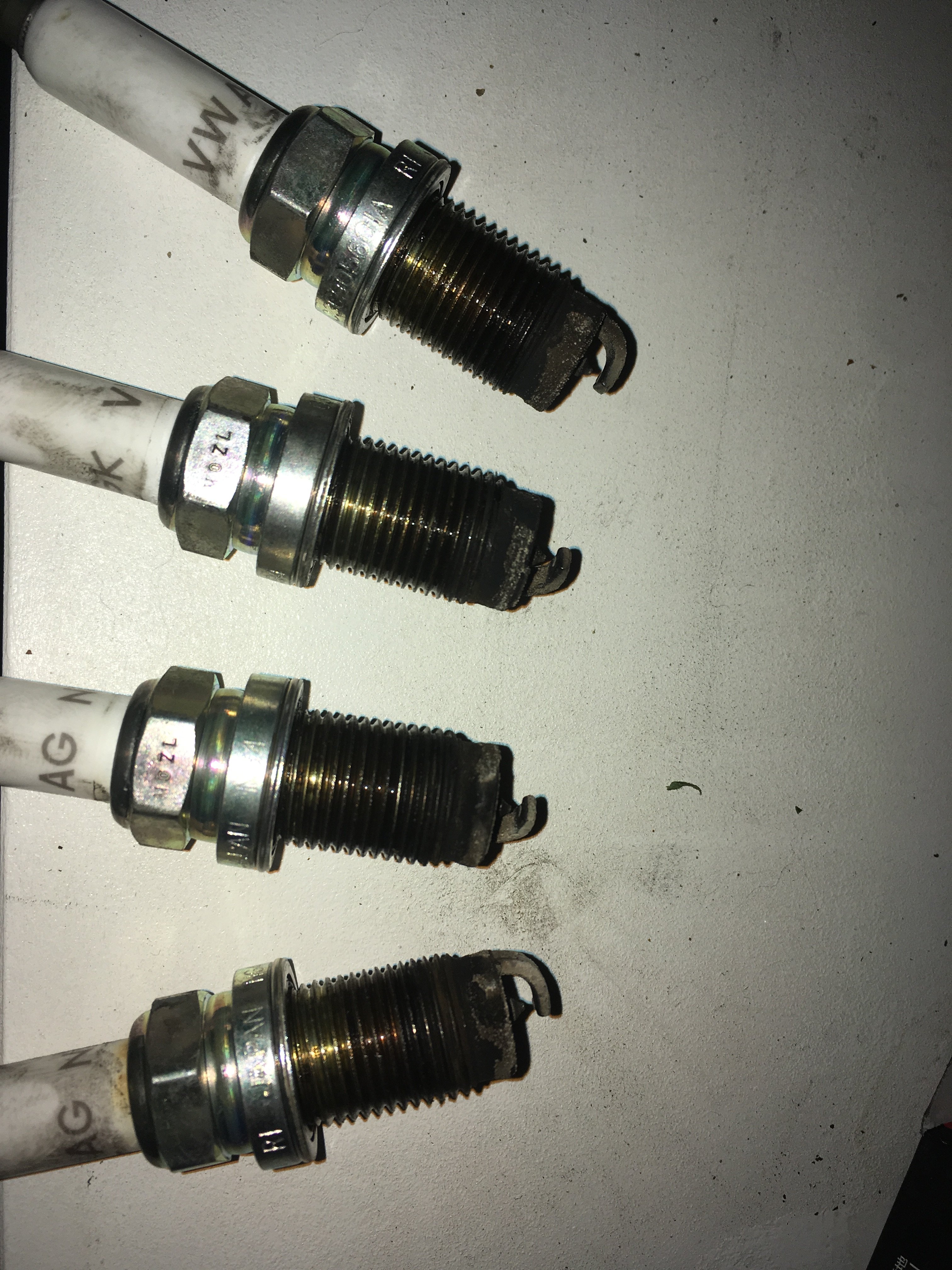

So these are my old plugs which have covered 38,000 miles they seem ok to me ( but i know nothing lol) but factory so glad i swapped them out.

@GT0161   How do you know they have covered 38,000 miles without you have had the car for 38,000 miles.
The Spark Plug type fitted change in 2011, which are these?
If it had a Major Service at 4 years old (2015), so a 2nd Major Service, the Spark Plugs should have been changed then.
Edited by Skoffski
@Skoffski no mention of plug changes in service book and also vag stamped on plugs so i presume they are factory
Edited by GT0161
No they are OEM as used at services at Main Dealers, which are as get fitted at the factory.
No way are those original from 2011.
