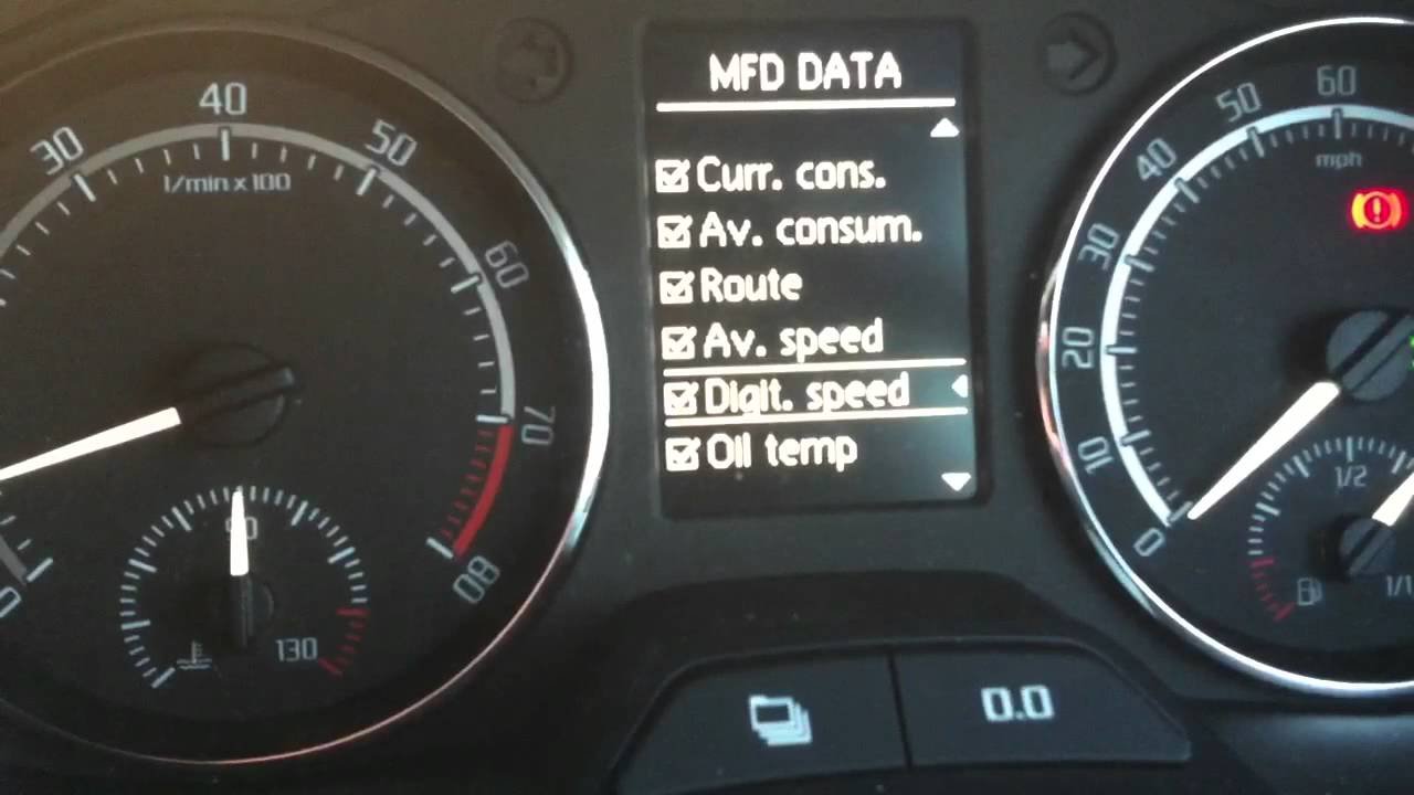

TPMS beside Parking Brake, you just set your tyre pressures.  The ignition on and hold the TPMS button and reset.
Maxidot,  Average, Reset etc is on the end of Wiper Stalk and reset button on bottom of stalk.

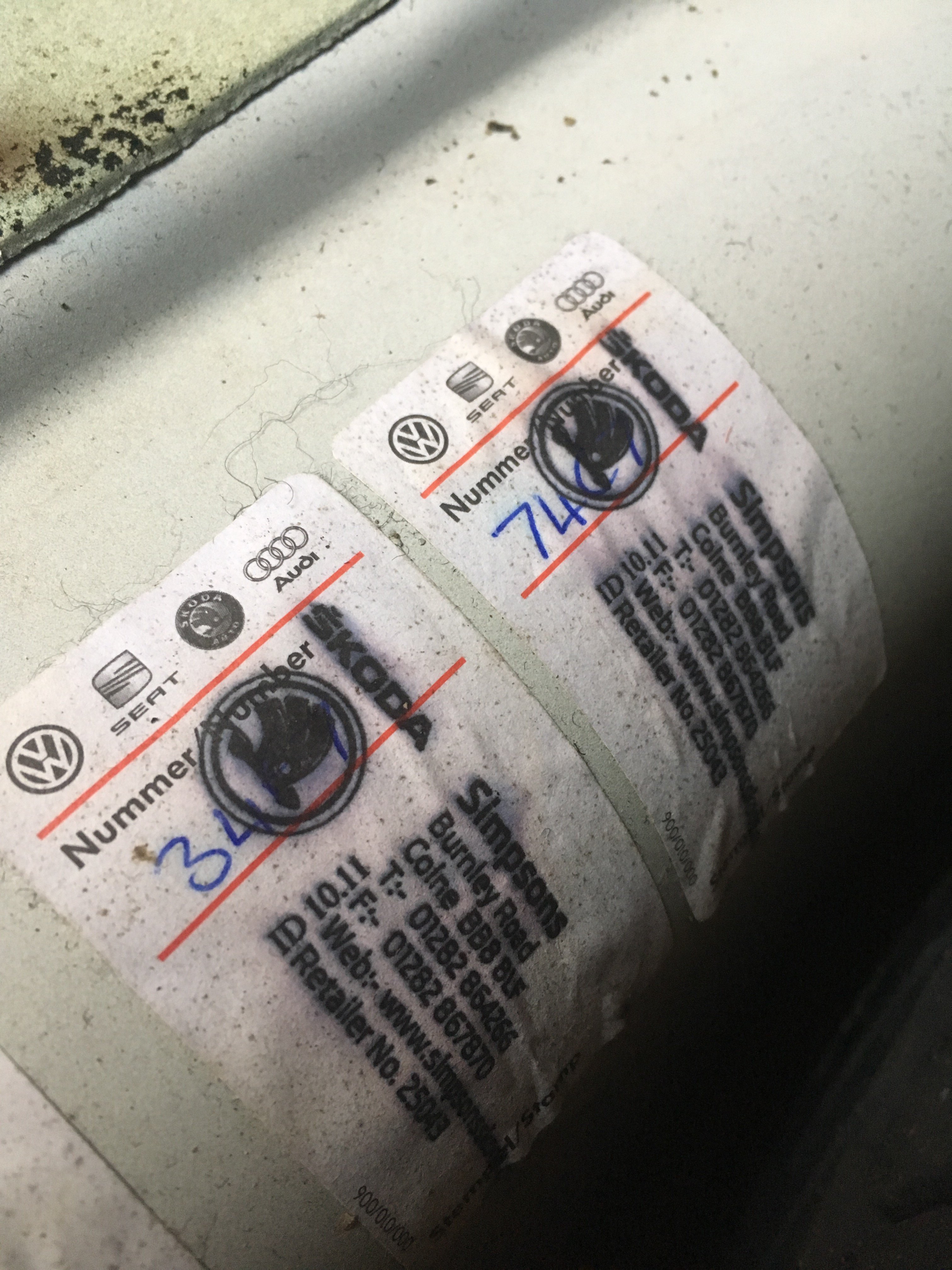

Regarding the boot stickers mine has two i have  attached an image below

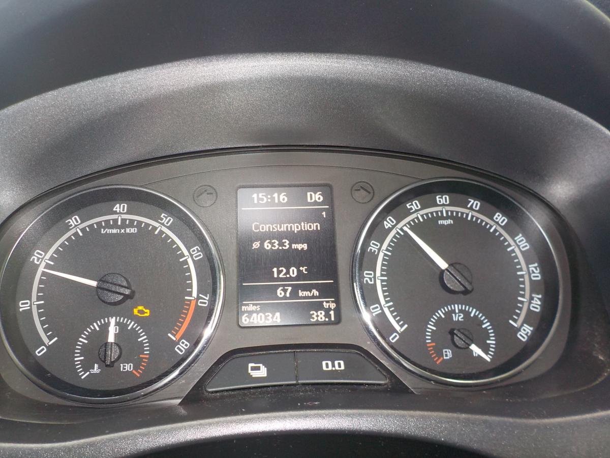

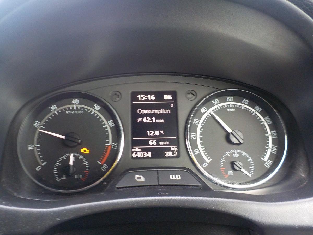

Has your car got an eco map 62mpg is wicked compared to my 25mpg lol

Stage 1&
running in limp mode with the Turbo disabled because it needed a water pump and supercharger magnetic clutch.
But 37-42 mpg as an average from a tank is easily done, and with plenty of Average Speed camera miles over 53 miles from a gallon of 99 ron.
60 + achievable through 50mph average speed cameras with a bit of drafting a nice lorry or bus.

Also iv got two stickers in my boot one is the dsg one you mentioned but no idea on the second

Sorry i do not know the 2nd service campaign number, it could be the Wiring Loom or the Heated Seat Element and Switch.

Thanks again the second is in fact the heated seats 74c7

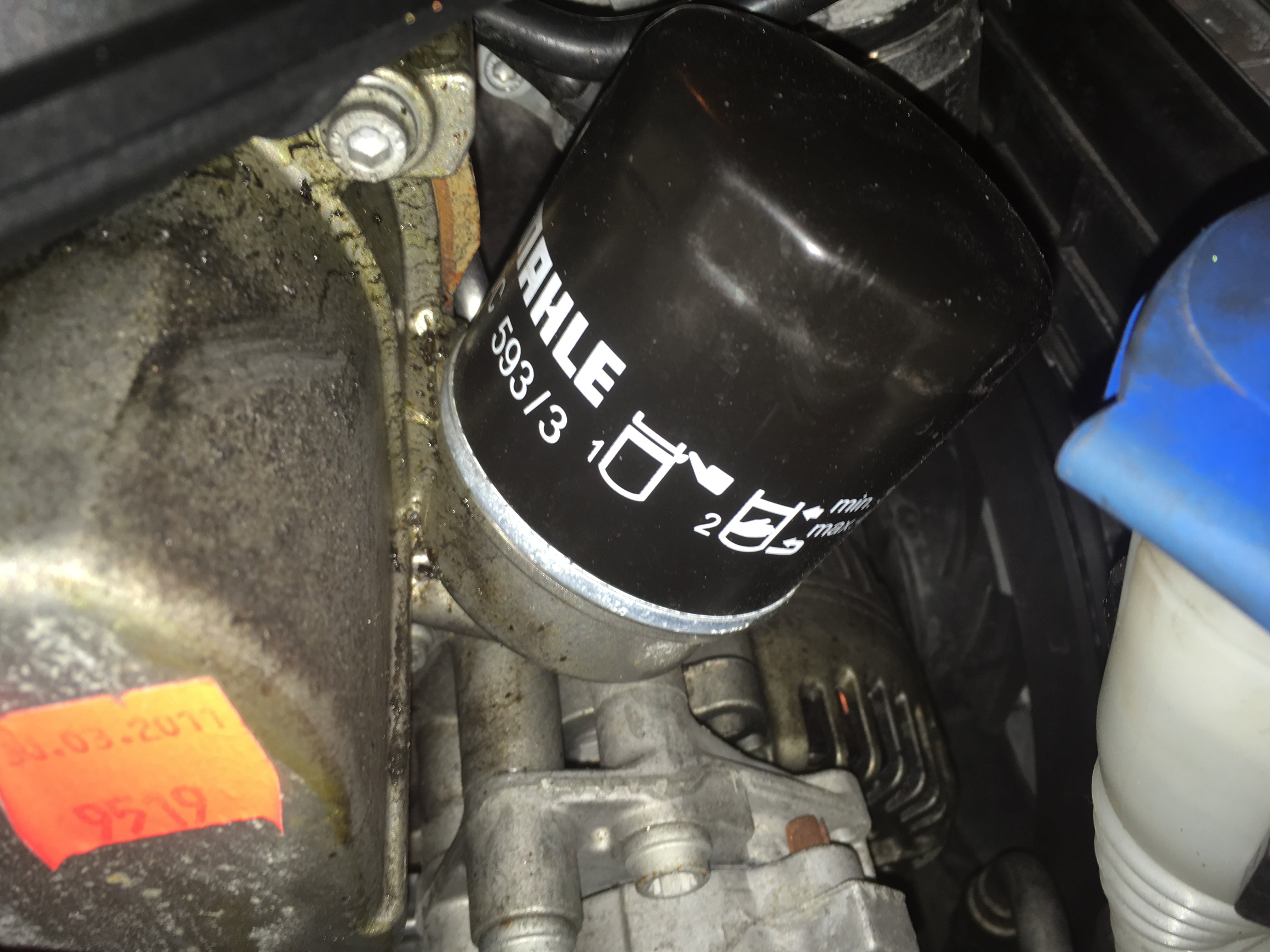

i have attatched a photo of oil filter

I always fitted a Mahle Oil Filter,  an OC295.
