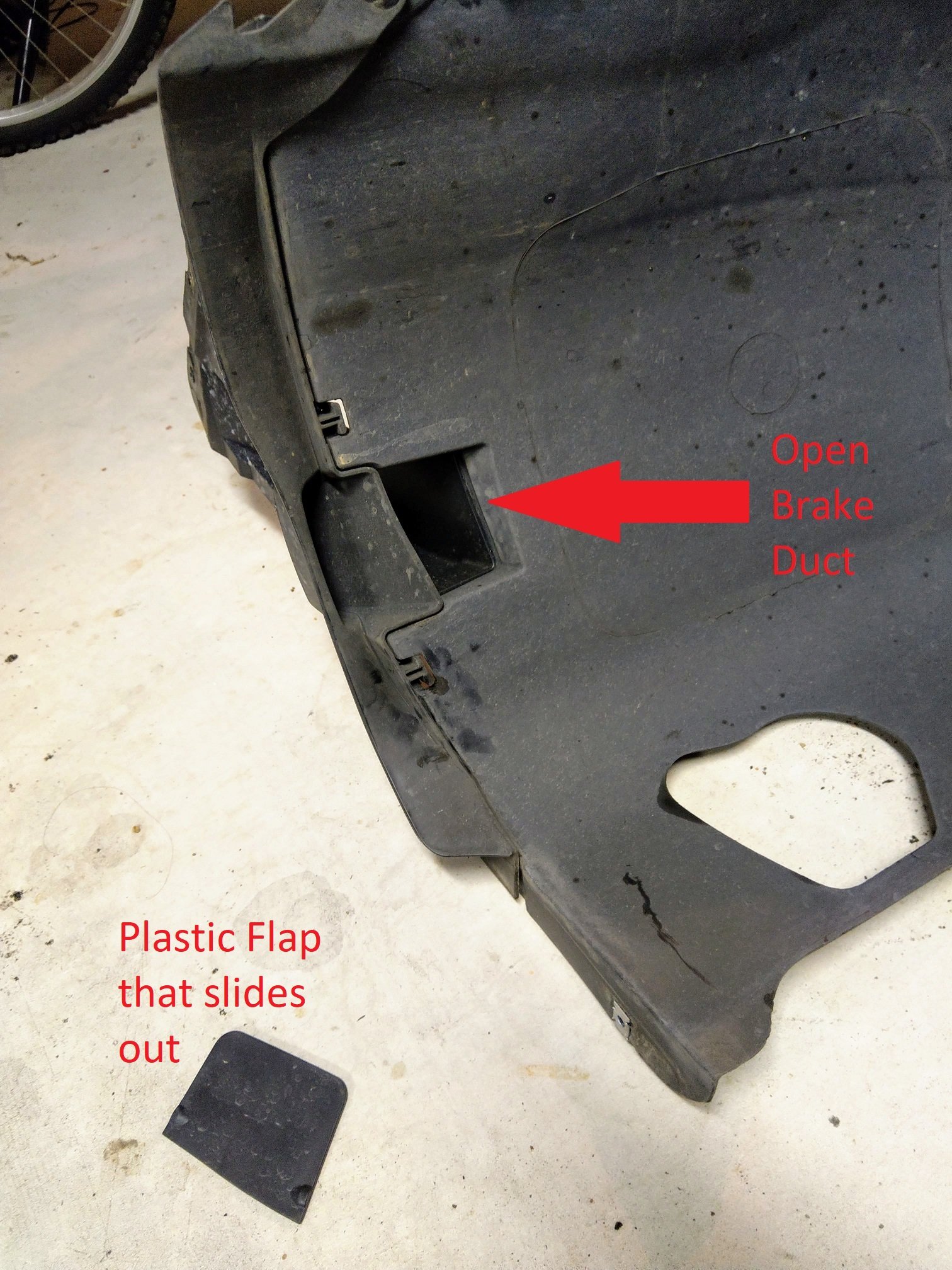

so today, after removing my wheel arch liners, i decided to remove a plastic flap that keeps the brake ducts closed.
i don't know why Skoda would have the brake duct airflow closed/blocked?!?!?
anyways, its out :)
now i can gain an extra 4m of braking distance thanks to the cooler brakes.  hahahaha

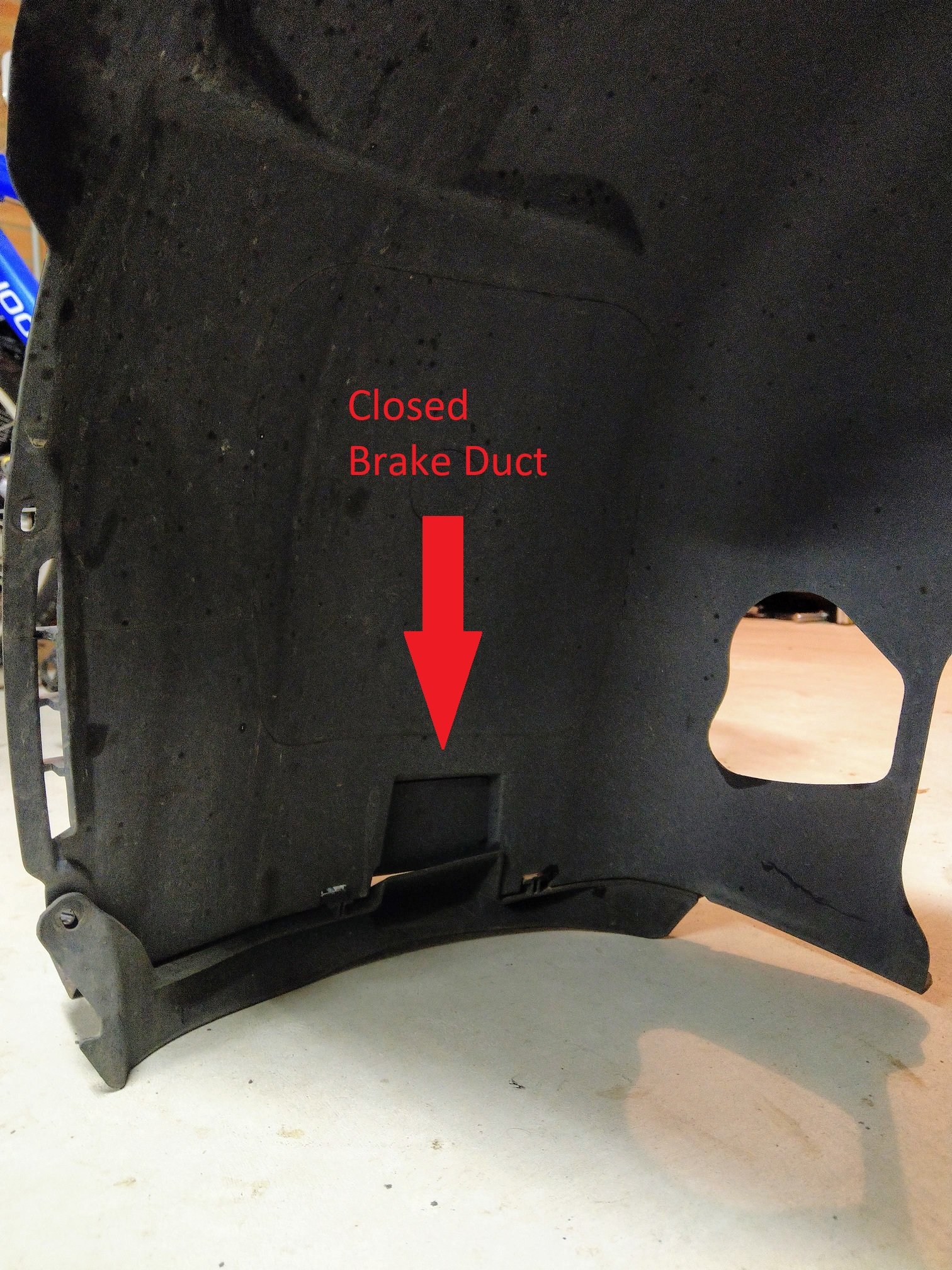

After putting max lock on the front wheels, I can see that the ducts on the 280 are closed.
I'm now trying to decide whether or not I open them or just carry on with the carbon ceramic brake upgrade I had planned.  I'm sick of cooking my brakes when nipping down the shops. :biggrin:

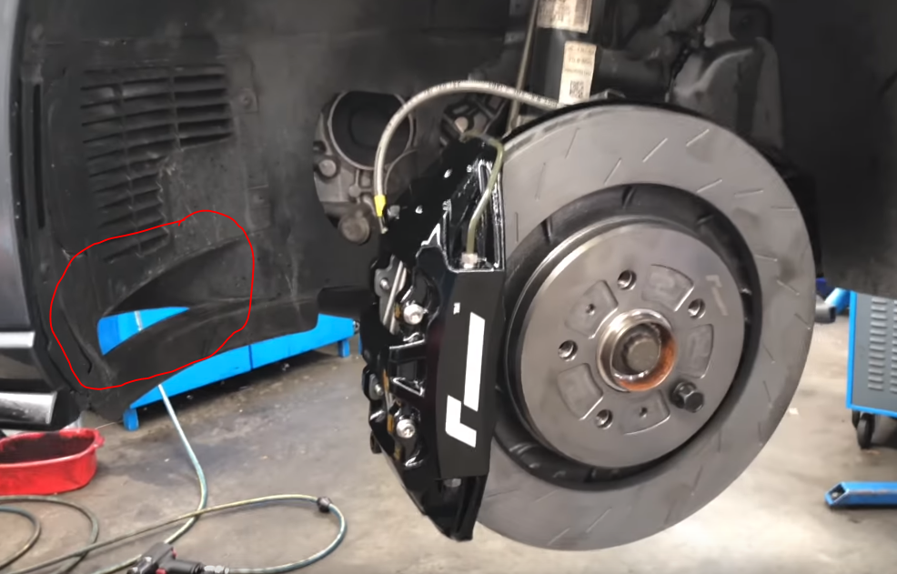

This is what the Golf GTI/R fender liners look like:
Surprised the 162 at least is having the arch liner fully closed.
Wow.....that has a lot bigger opening brake ducts and lots of slots above it.
That must b for the R.
I'd b surprised if the GTi has the same.  Unless its the Performance edition with the bigger 340mm brakes.

GTI has the same opening on the liner (the one circled in red) and almost certainly the same slots above it. Also GTI Clubsport 290 and Leon Cupra are the same as in the pic. Superb also has 340/310mm discs front/rear no?

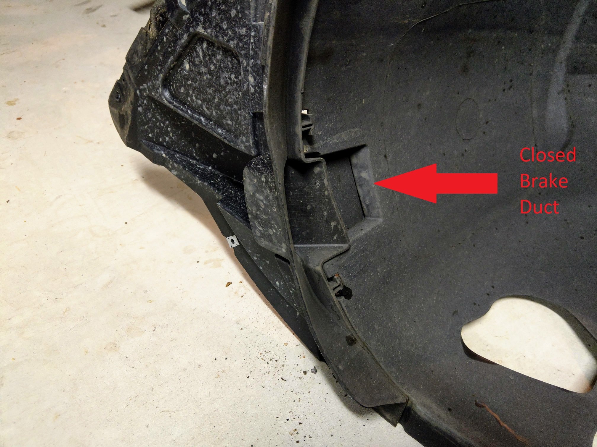

Same slots in the 206TSI / 280, however mine also has the brake duct sealed off...
As in the pic below then?
Correct, on both sides (left and right).
The brake duct is only as big as JR RS has shown in his original post pictures.

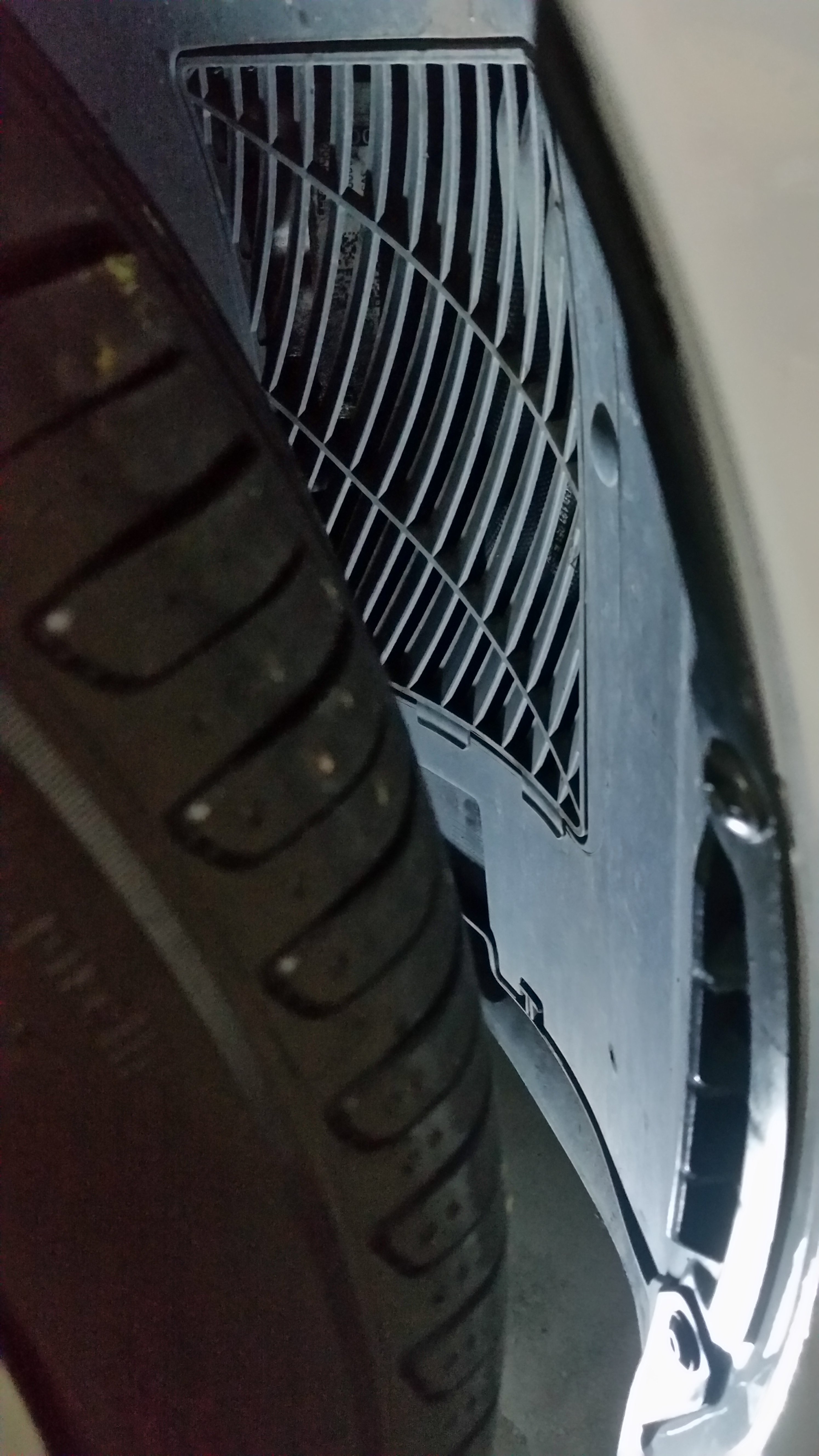

Here is a picture of mine (showing the grilles on the drivers side - the same on the passenger side also).
Remember the 206TSI has openings on each side of the front lower grille also to channel air in...
By comparison the "blanked off" brake ducts appear very small.
Even my wife's Jetta has a more open area to channel air in as per the pics above from other Golf owners.

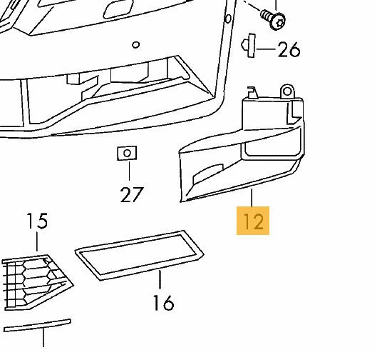

6 minutes ago, SteHaworth said:
Yes, they fit either side of the front lower grille.
The ducting is to channel the air through to the Transmission / Oil Coolers on either side.
The air the comes out within the slotted part of the wheel well (once again on either side).
Nothing to do with Brake Ducts though.
This appears to only be on the high powered petrol engines.

14 hours ago, SteHaworth said:
Ah I see, I’ve got a 272 sportline plus on order so it may well have these already then
They are 100% on the 272 for oil cooling as mentioned by @ope126

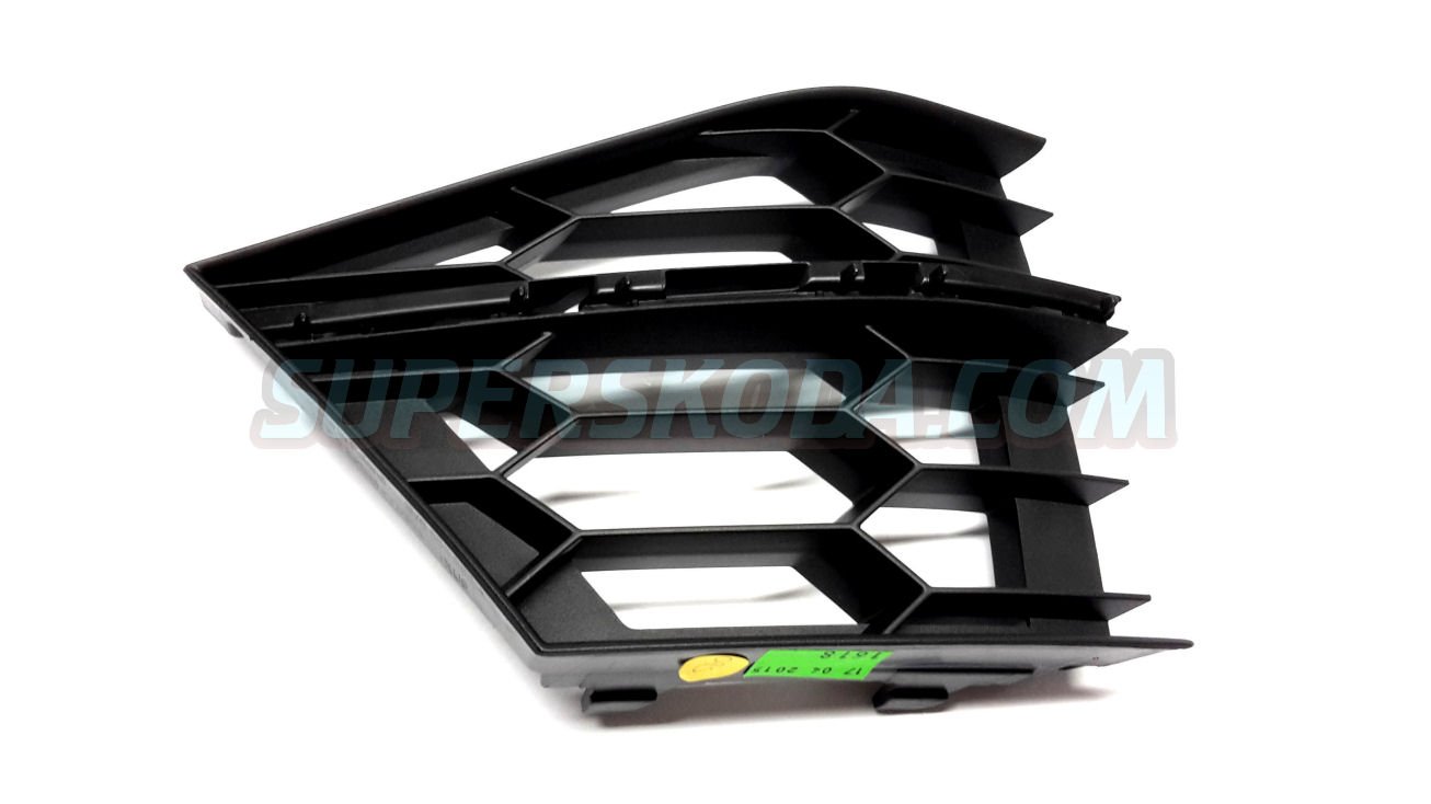

Are they open on both sides on the 272? On my 280 the right hand side was originally blocked off, since there’s nothing behind it.
I decided to order the relevant “open” part from superskoda since I hated the asymmetrical look.
