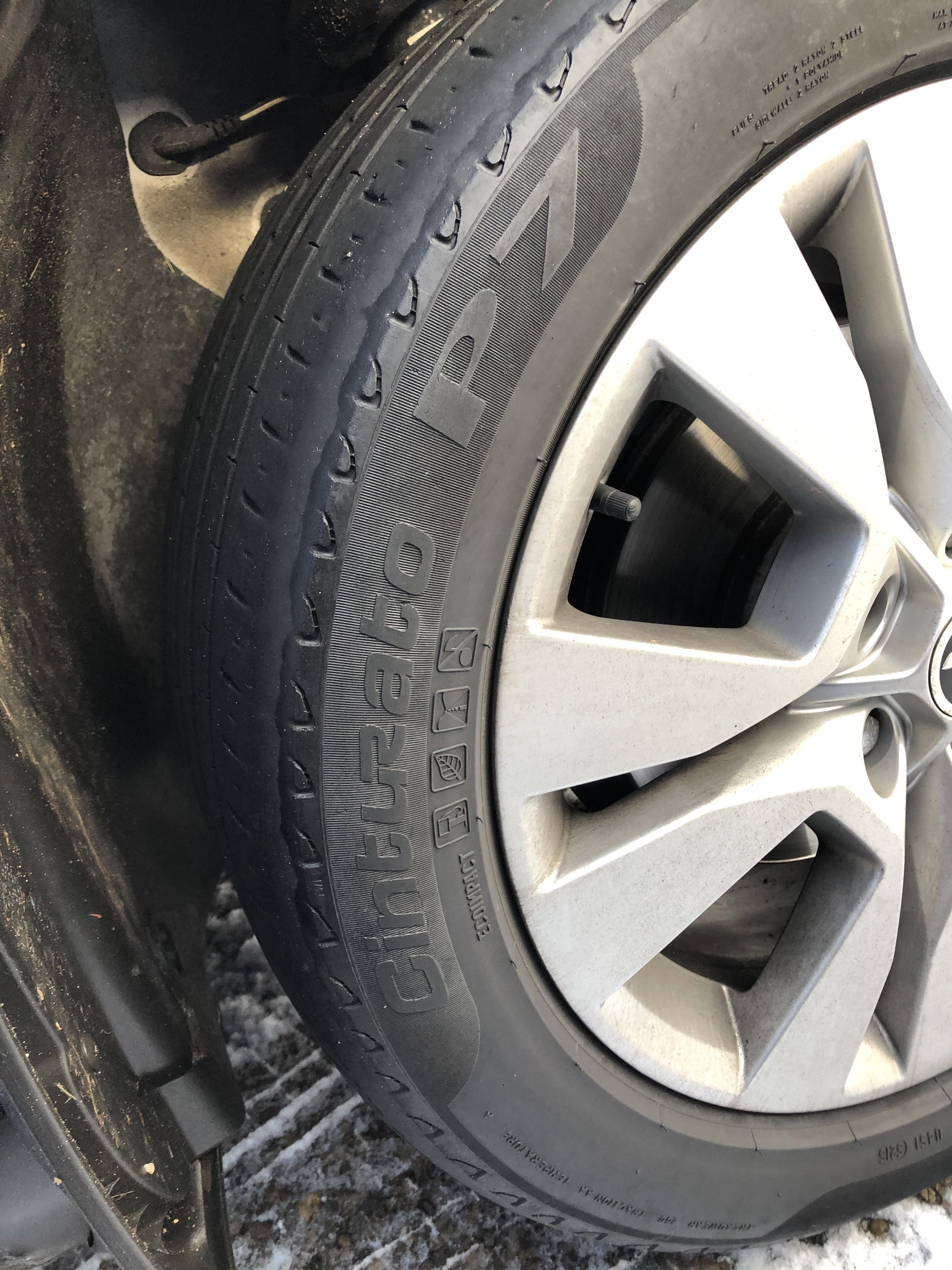

Is this what they class as a Summer tyre?
only noticed the symbols today
Yes, its a bit worn on the edge !

I mean the symbols under Cinturato
the leaf symbol - any ideas what that indicates?

From: https://info.kaltire.com/pirelli-ecoimpact-environmentally-friendly-tire/
Quote
ENERGY EFFICIENCY (petrol station symbol)
The Pirelli EcoImpact tires are made of low rolling resistance rubber compounds and a unique internal construction that decreases carbon dioxide emissions and fuel consumption levels so you save money on fuel.
CLEAN AIR (leaf symbol)
During the manufacturing process, tread compounds are created without the use of high aromatic oils. This limits the petroleum dependency and reduces the dispersion of potentially hazardous substances being leached into the environment during production.
HIGH MILEAGE (road symbol)
In an attempt to deliver cost savings to the consumer, EcoImpacts treads are specifically designed for long wear. Aside from extending the life of your tires and saving you money, this feature also reduces the number of tires being made. When fewer tires are made, fewer raw materials, water and energy are consumed. It also lessens the impact on the environment when the tires reach the end of their life.
LOW NOISE (crossed out note symbol)
When driving from Point A to Point B, these tires promise a low level of tire tread-related noise in the cab for an optimal driving experience. This benefit also reduces your contribution to noise pollution when driving around town.

From experience of the stock tyres on my Superb, the 'P7' symbol indicates "a 5hit tyre" :D

It indicates the Pirelli are trying to claim eco credentials for their tyre.  It's marketing.
The P7 is definitely a summer tyre, though - Pirelli themselves classify it as such: https://www.pirelli.com/tyres/en-gb/car/find-your-tyres/products-sheet/cinturato_p7
(For information: the Italian word "cinturato" means "belted".  The original Cinturatos were the some of the earliest tyres to use radial construction, with "radial" meaning that the carcass plies are arranged with the cords at 90° to the direction of rotation - i.e. radially, in comparison to the old cross-ply construction technique which had multiple plies with the cords at roughly 60° to the direction of rotation, with each ply crossing its neighbours at an angle of about 120°.  Eliminating the crossing plies reduces frictional losses within the carcass of the tyre from ply cords rubbing against each other as the tyre flexes.  The "belted" bit refers to the additional plies outside the carcass plies, in which the cords run parallel to the direction of rotation: these plies stop the tyre increasing in diameter as the rotational speed increases, so maintaining the tyre's profile at all speeds.  This isn't unique to Pirelli: all radial tyres have them.)
