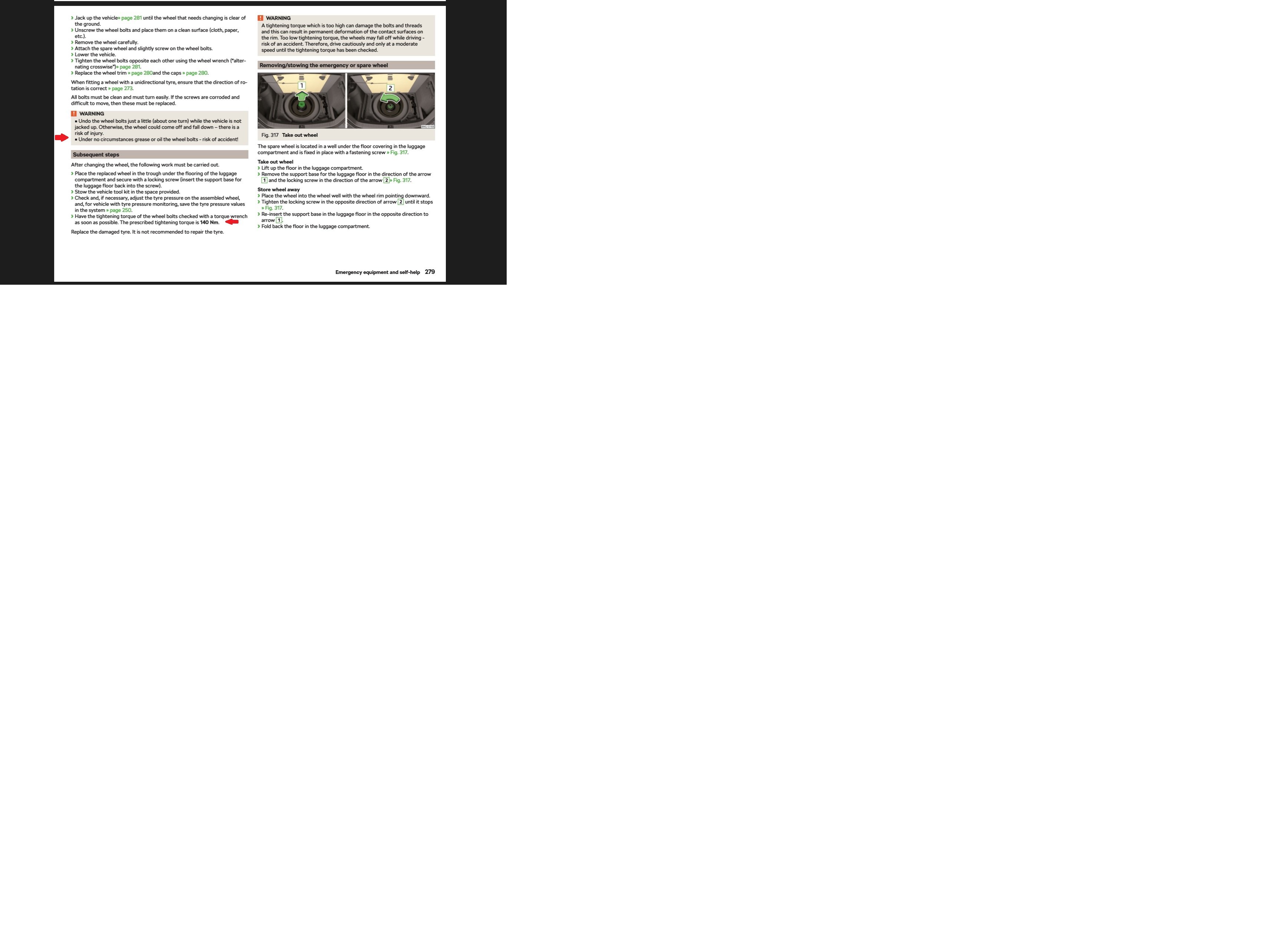

On 22/01/2019 at 18:35, Roottootemblowinootsoot said:
Do not 'grease'  Bolts / Studs before torquing them.
Threads on this forum and elsewhere.     A mechanics rag wipe of a wheel bolt / stud is enough.
Eventually found the recommended torque setting for the wheel bolts/studs and also the advice NOT to use grease.
