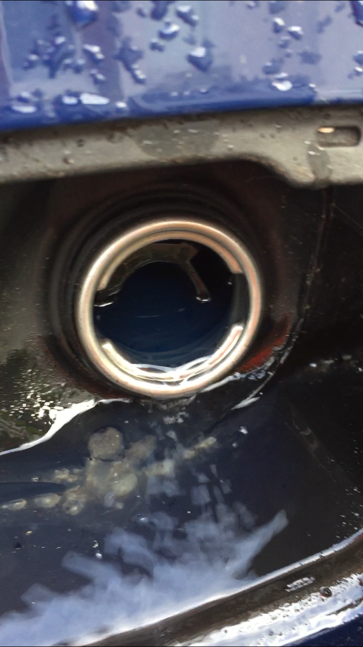

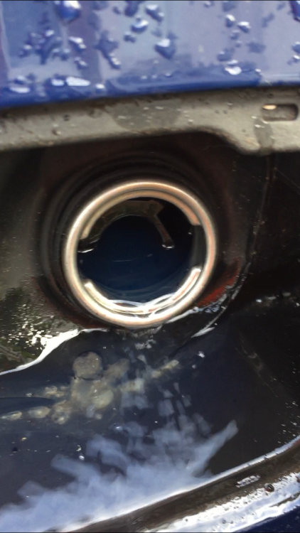

We have Skoda superb  4x4 estate petrol TSI 280 year of manufacture 2016 . Three times in the last 18 months fuel has leaked out of the petrol tank through the filler cap - Skoda have had the car for over 2 months in total (under warranty) but don’t seem to be able to fix the problem despite changing the fuel tank . Has anybody else had the same problem please

No sadly the leaks are not after filling up the car but when the car is about half full normally - it has the saddle bag shaped petrol tanks so maybe this is a fault they have ?
The fault happened twice when the weather was very hot so we wondered if that was causing the problem but today the temperature was only about 10 degrees so it cannot be a high temperature problem
Faulty fuel cap maybe?
Surely Skoda would have thought of that as they have had it for 2 months trying to fix the problem ? But maybe not - It seems as if there is a build up of pressure inside the fuel tank
Seems very strange how fuel manages to get back up the filler neck despite the tank not being full. What was the fuel gauge indicating when you took that picture?

Half full

"carried out Guided Fault Finding, which is part of our computer diagnostic procedure, we have sent reports to Skoda technical department and have been discussing the fault with them over the last few weeks, we have checked the pipes and breather assembly, we have removedara the fuel tank and checked the tank, fuel pump and filters. We have replaced the fuel pump and o’rings on both sides of the tank." And then return it to us saying that it is fine then a couple of months later the petrol comes out of the petrol filler again but not constantly on a ad hoc basis . I take a video of it skoda take it back in do more checks and return it to us yet again saying it is fine and then the fault reoccurs again -

I'd like to see the parts fiche for the fuel system.
But would have thought there would be a small bore breather pipe between the top of the fuel filler neck & the tank.
If this became blocked or kinked I think it could give you that problem, of the filler pipe not draining back to the tank.
