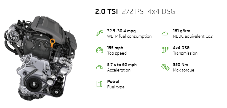

The facelift 272 estate claims 5.7 to 62
The Superb Estates are slightly heavier than the Hatch and therefore a couple of tenths slower as a result.:biggrin:
