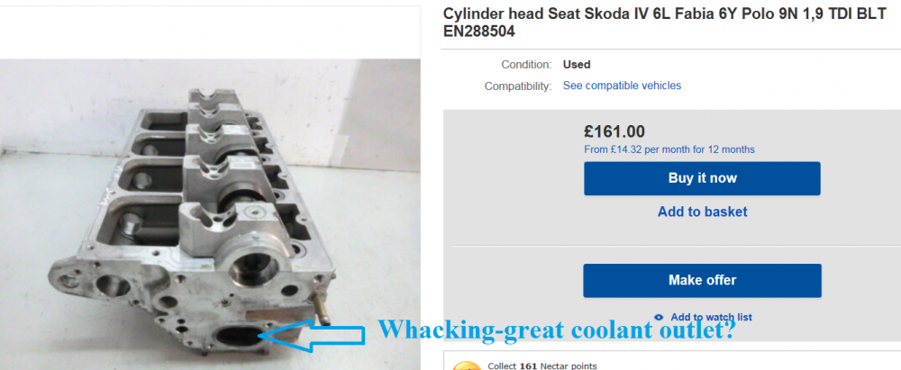

You may need to improve your searching skills:
I saw that, but the diagram you've referred to doesn't list the BLT engine code.  They the same on either engine?
Is there part numbers anywhere for the thermostat and housing if not?
  • Sponsor
BTW, if you're on a phone or something you may not be able to see the part numbers column on those pages, try a proper computer.
