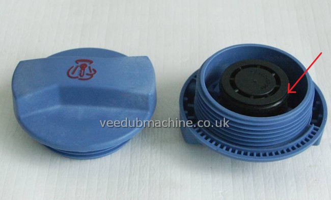

2 minutes ago, TMB said:
No O-ring.
Wow, missed that, seriously?
Buy a new cap, fixed. FFS.

I am mistaken - there is an O-ring around the centre inner part.
Yes, that's where it is on every VAG vehicle since about 1976.
The black bit has a pressure relief spring and will allow coolant to spurt out of the flange on the blue part, hence the outside of the tank gets wet when it blows.
Not rocket science chaps.
Is the O-ring actually missing off your cap then Aaron?

No need for a picture, the cap is designed to leak coolant from the outer 'race' as you call it, there is only supposed to be one o ring on the black centre piece which is also the pressure relief mechanism, nowhere else.
I will say this only once more, if your cooling system is over pressurised then the cap will blow coolant out while you drive.
If you have no residual pressure in the system when it's cold then you have a stuck thermostat or a blockage somewhere.
If you do have pressure when the engine is cold then its head gasket time.
