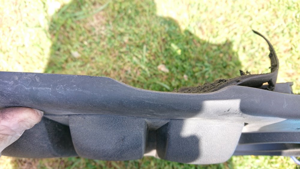

I have also modified the engine cover slightly to allow a little more space:

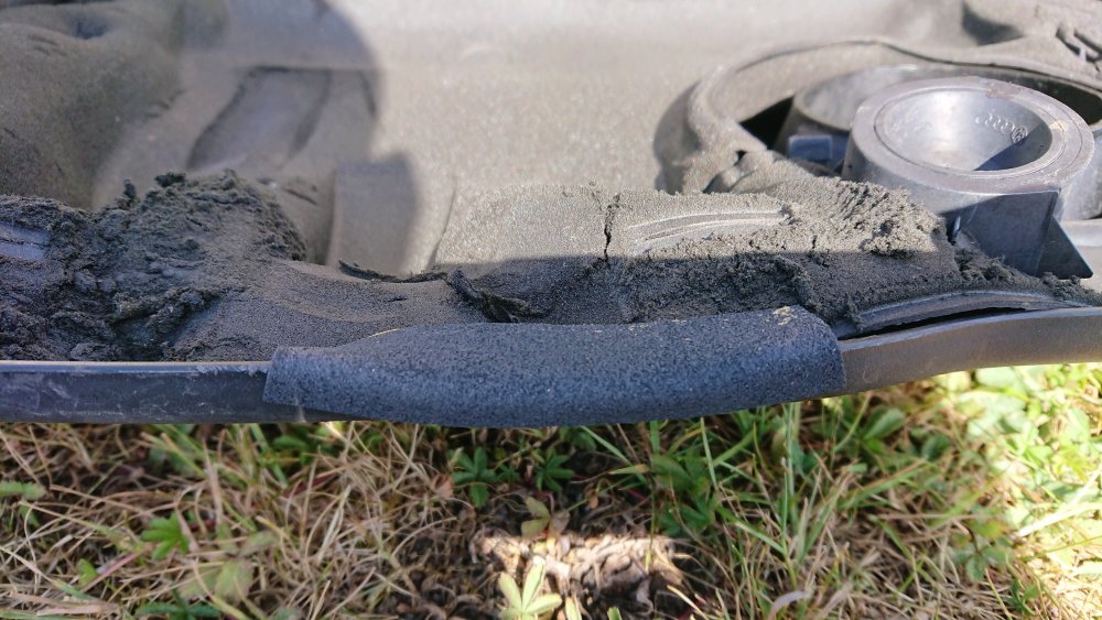

And added a piece of rubber foam tape I had to provide further protection:
(I'm not sure how that will hold up with the engine heat though)
To reduce the vibration on the lose engine cover I also added a small piece of garden hose over the rear engine cover mounting bolt.
