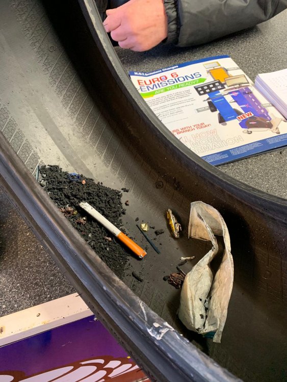

Hi, my future son in law purchased a new Fabia two weeks ago and had a puncture within a few days. Replaced with the space saver and took the damaged tyre for repair. On taking the tyre off the wheel the garage found debris from the Skoda factory inside the tyre, the puncture was from inside to out! Anyone else had this problem? He's flagged it up to Skoda who are going to give him out of pocket expenses.
Edited by Rich2
Added photo
so what exactly caused the puncture?
We think the thing that looks like a cigarette, it's actually a piece of metal. The other stuff was all soft. It looks like the factory workers used the tyre as a waste bin before fitting to the wheel. The dusty looking debris is bit's of tyre rubber scrapped off the inside of the wheel. It couldn't be repaired, a new tyre had to be fitted.
The tyre will have been fitted to a wheel before delivery to the factory.
The small black bits are from the Inside sidewall where the car has been driven with not enough air in the tyre.
Was there any evidence of a puncture repair in the tyre?
Is there a hole in the tyre?
I would suggest that the tyre has been removed/refitted since leaving the factory.

Well, it wasn't a "brand new car", but a tyre fitter mate of mine once had a car come in with the owner complaining that "this rumble started when I got a new tyre from $fast_fit_place. I would have come to you but you don't stock this size". Investigation found a large, and pretty new, set of pliers in the tyre (and I know because I was actually there).
