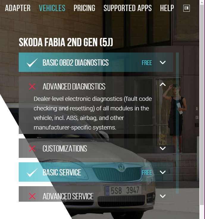

On the Carista website it said that it didn't have advanced diagnostics for the 2007 Fabia... so I wasn't going to buy it without knowing that they're available. If anyone else can either dispute or confirm this, i'd be grateful.
Edited by kirstyjay
Ah, okay my mistake, I was confused at first but now I can see that Carista did not bother to extend their full coverage backwards - only started at when they launched and give support forwards!   Oh bother, sorry for handing out duff info!

It's funny though, because other 2nd Gen Skoda Fabias do have full diagnostic support... Such as the facelift - See the link : https://caristaapp.com/vehicles/skoda/fabia/5jfl
Yes but the time of these cars initial launch came just after Carista started doing all its work to reverse engineer this app, normally with owners of newly launched cars, the issue is that Carista has not had enough time to give full coverage, so starts off from what you saw for your car - and with time catches up and give full coverage.
