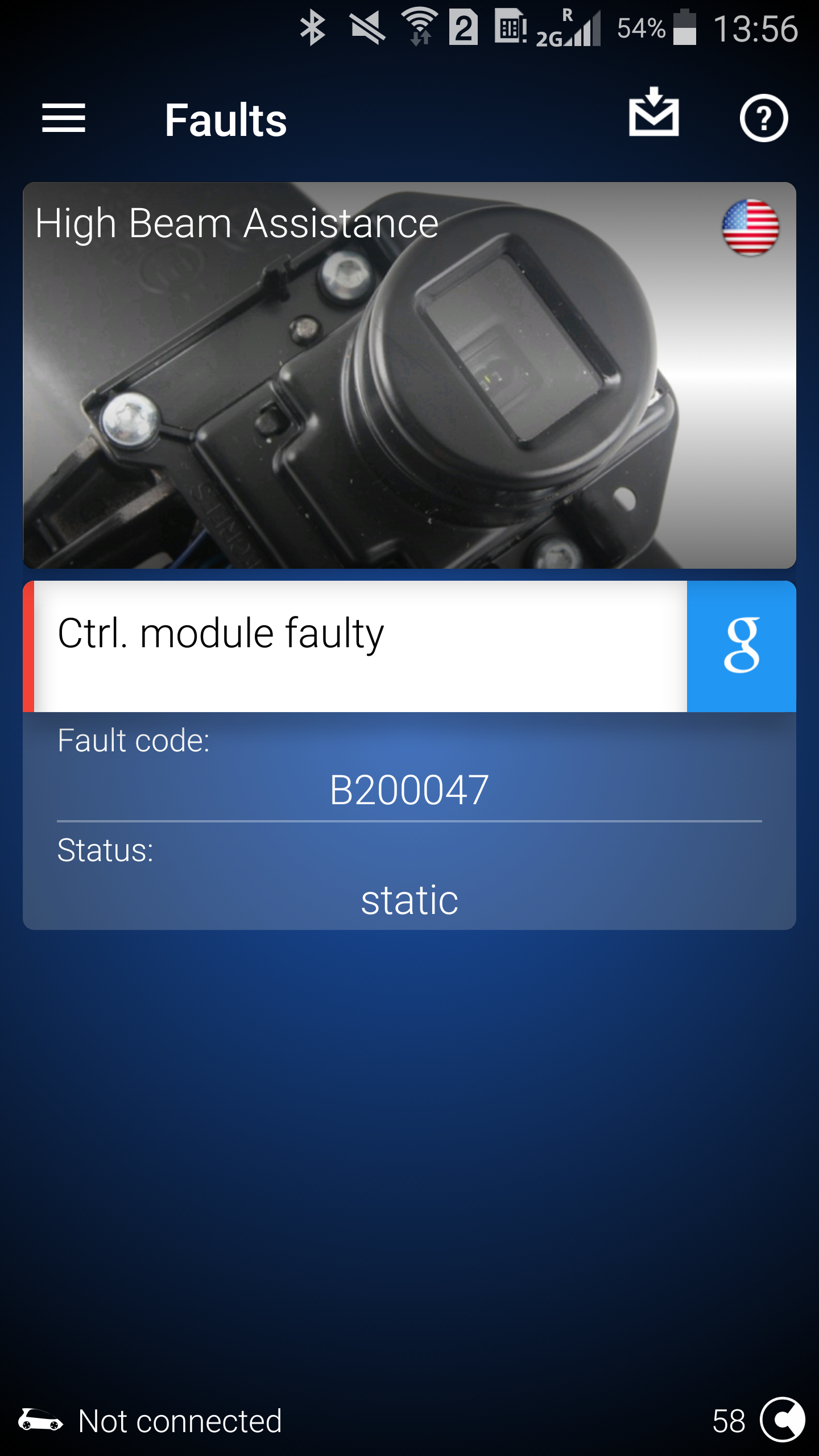

I have configuration 1, basic camera system, no lane keep assist. But I do have ACC and front assist, both radar based system are working well, HBA doesn't work.
My static error code is B200047 for in High Beam Assist module, "Ctrl. Module Fault"

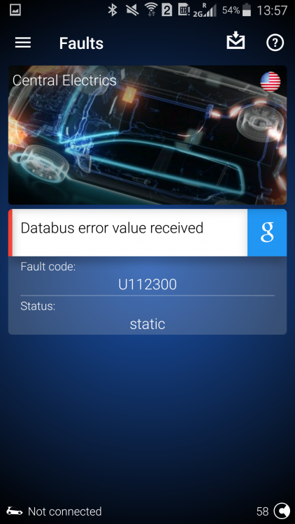

I also have U112300 static error in Central Electric module, "Databus error value received" Not sure if linked.
