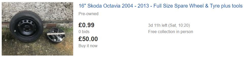

Loads of choice on eBay...

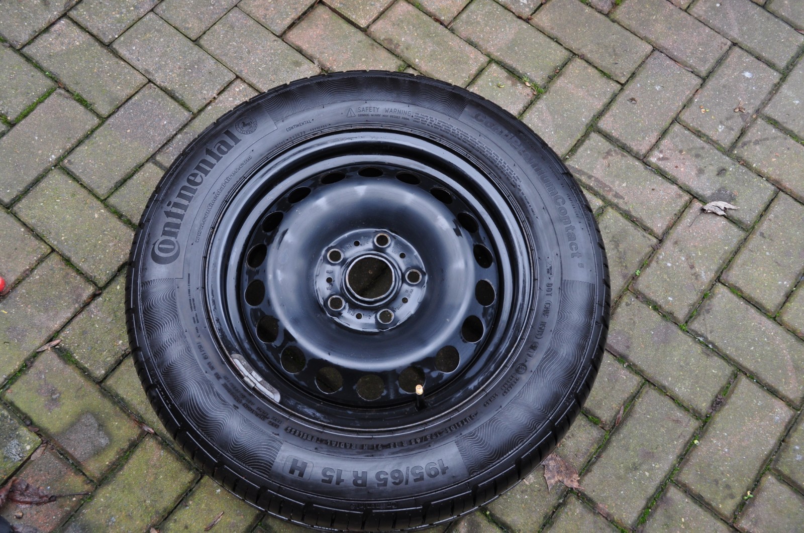

Here is a genuine MkII Octavia 15" spare wheel fitted with a 195/65 R15 H tyre...

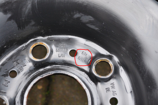

If you are worried about the diff / transfer case etc then take off your old wheel and read the size stamped on the inside then buy the same size wheel (width, diameter and ET) and tyre (diameter, width and profile).  If the carpet sits a fraction high then make a packer / spacer out of carpet felt / carpet / styrofoam, etc.  This will quieten the rear of the vehicle as well.

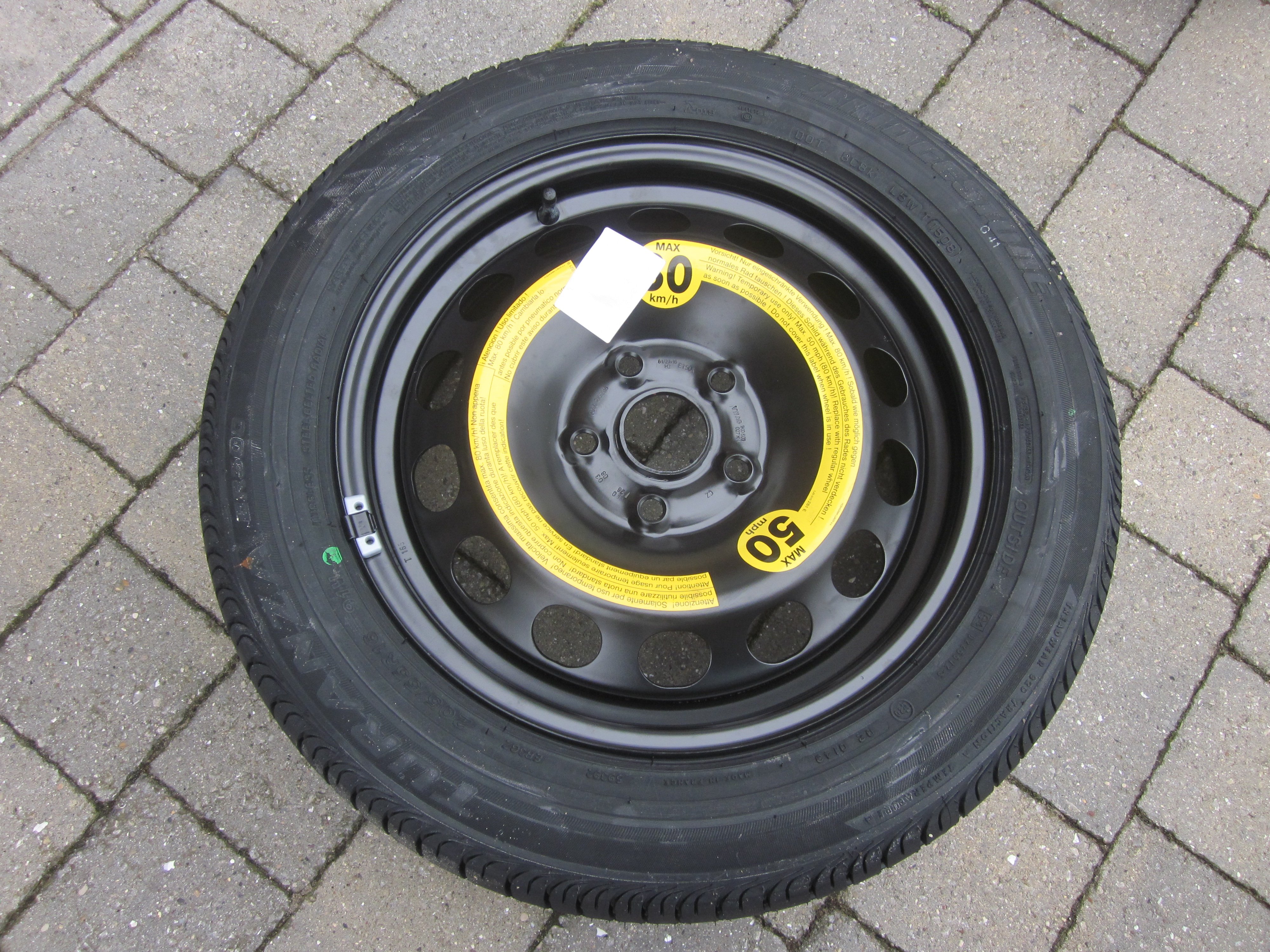

Im thinking the skoda dealer was just meaning it is restricted height of 6 or 6.5J width....after that it must be a space saver...or repair kit inflator which mine is supplied with.

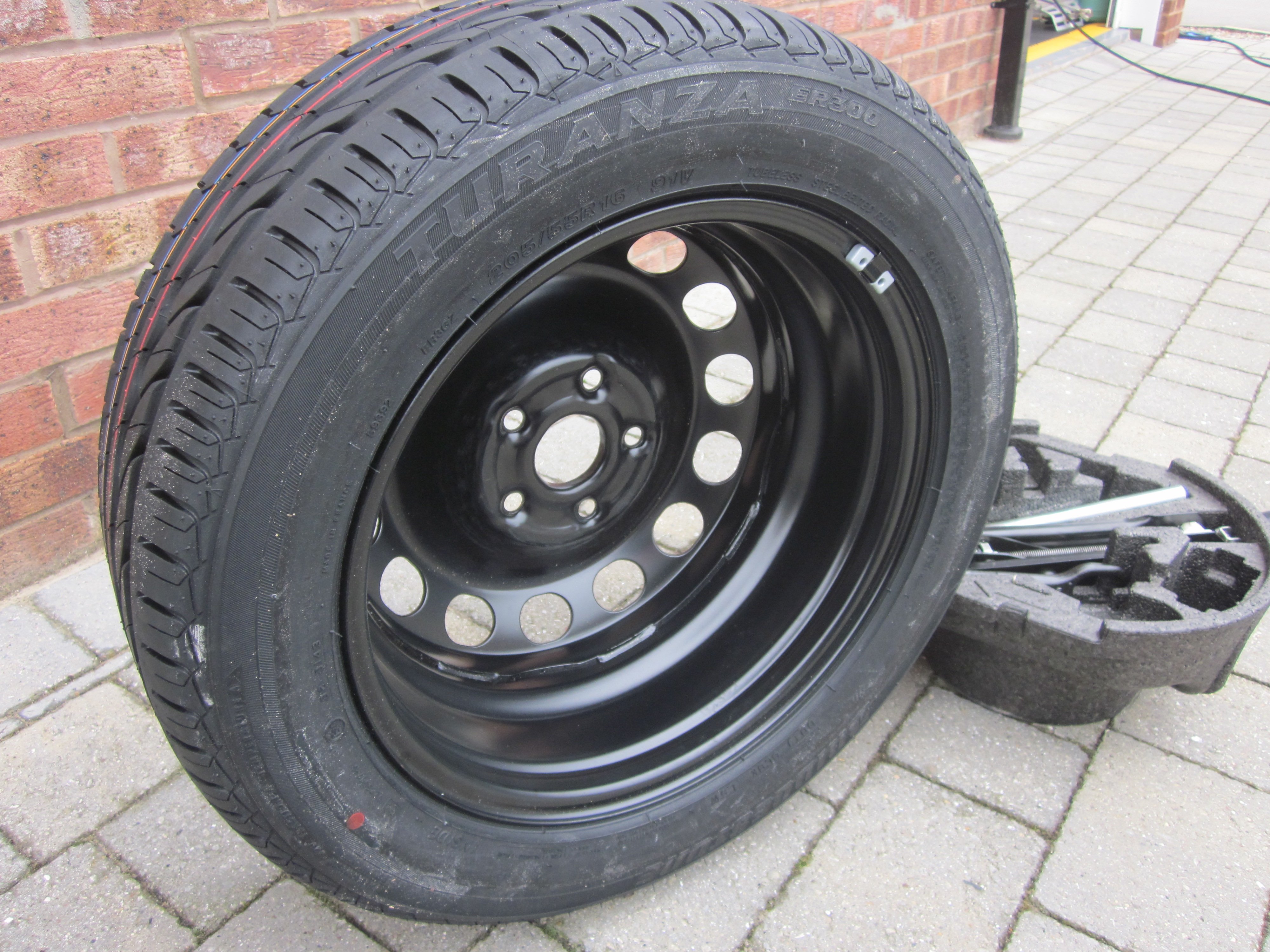

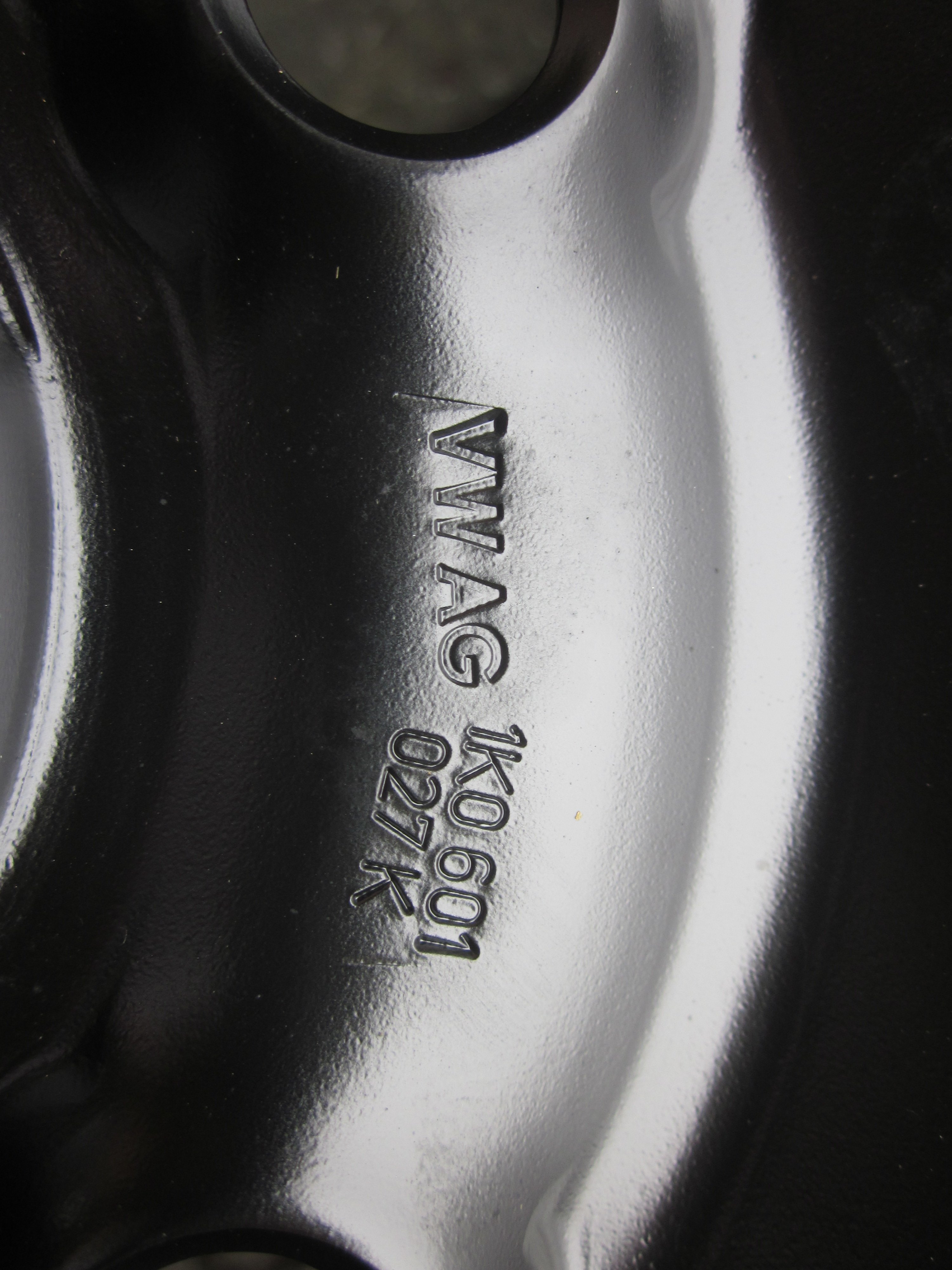

Recieved today a skoda wheel, 6J X16 rim with a 205 60 15 tyre so will try it for size 2mo....I'm sure it will fit along with the tool kit.
From what I can string together guugling etc is even the scouts with 17's only have a 16 as a spare ?? This is classed a s a space saver...this info may not be 100%...just what I've read here 'n' there

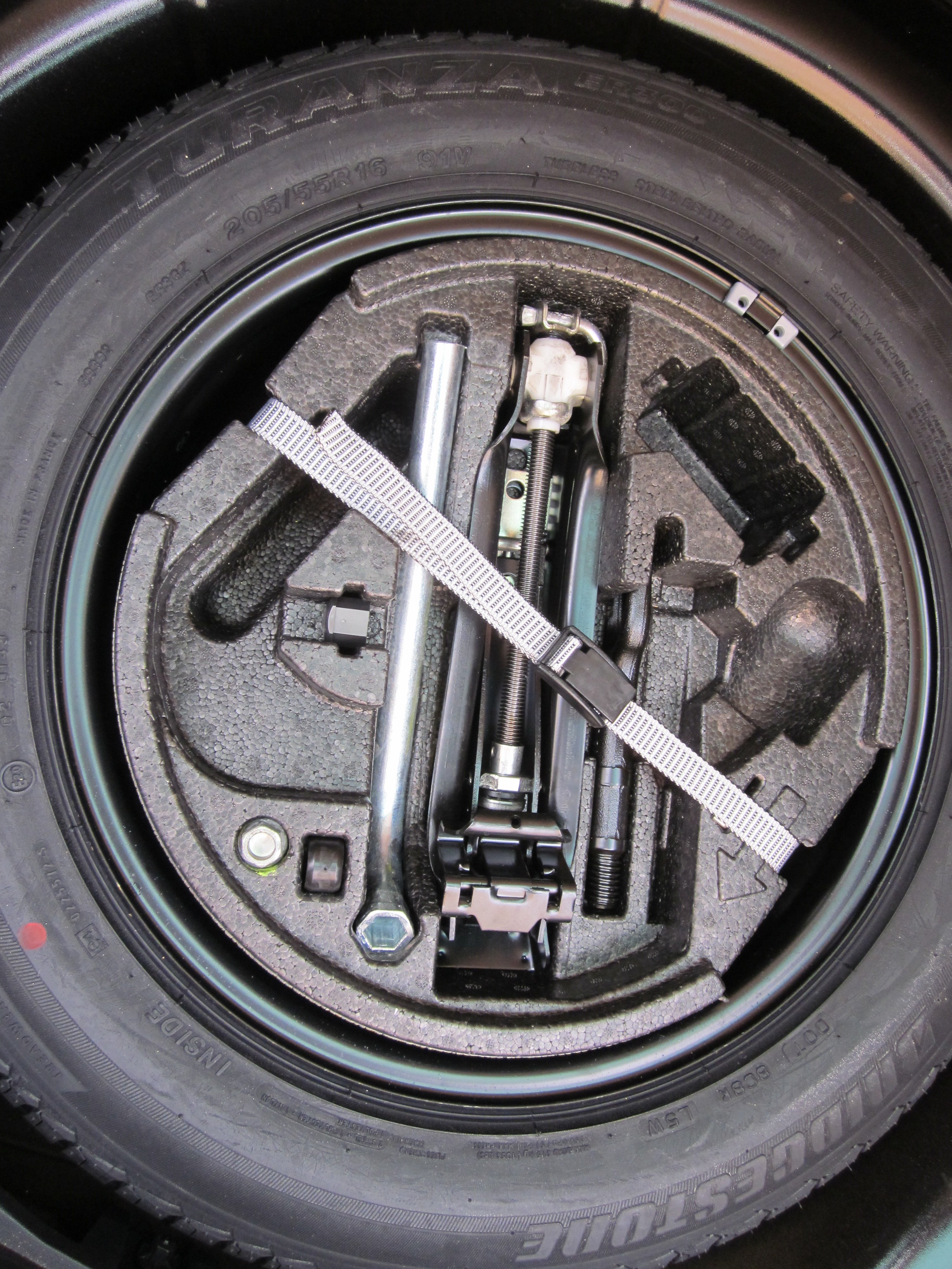

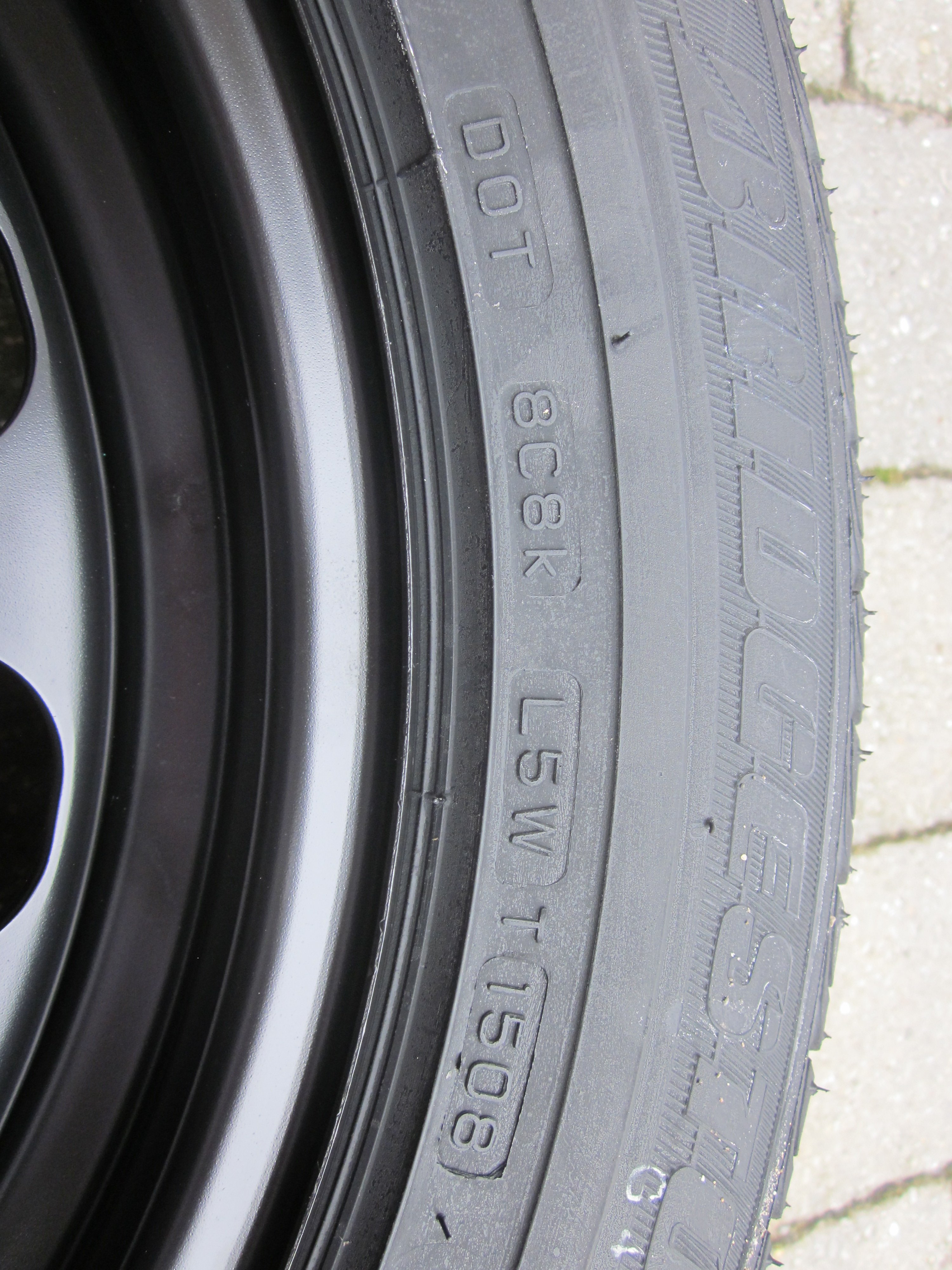

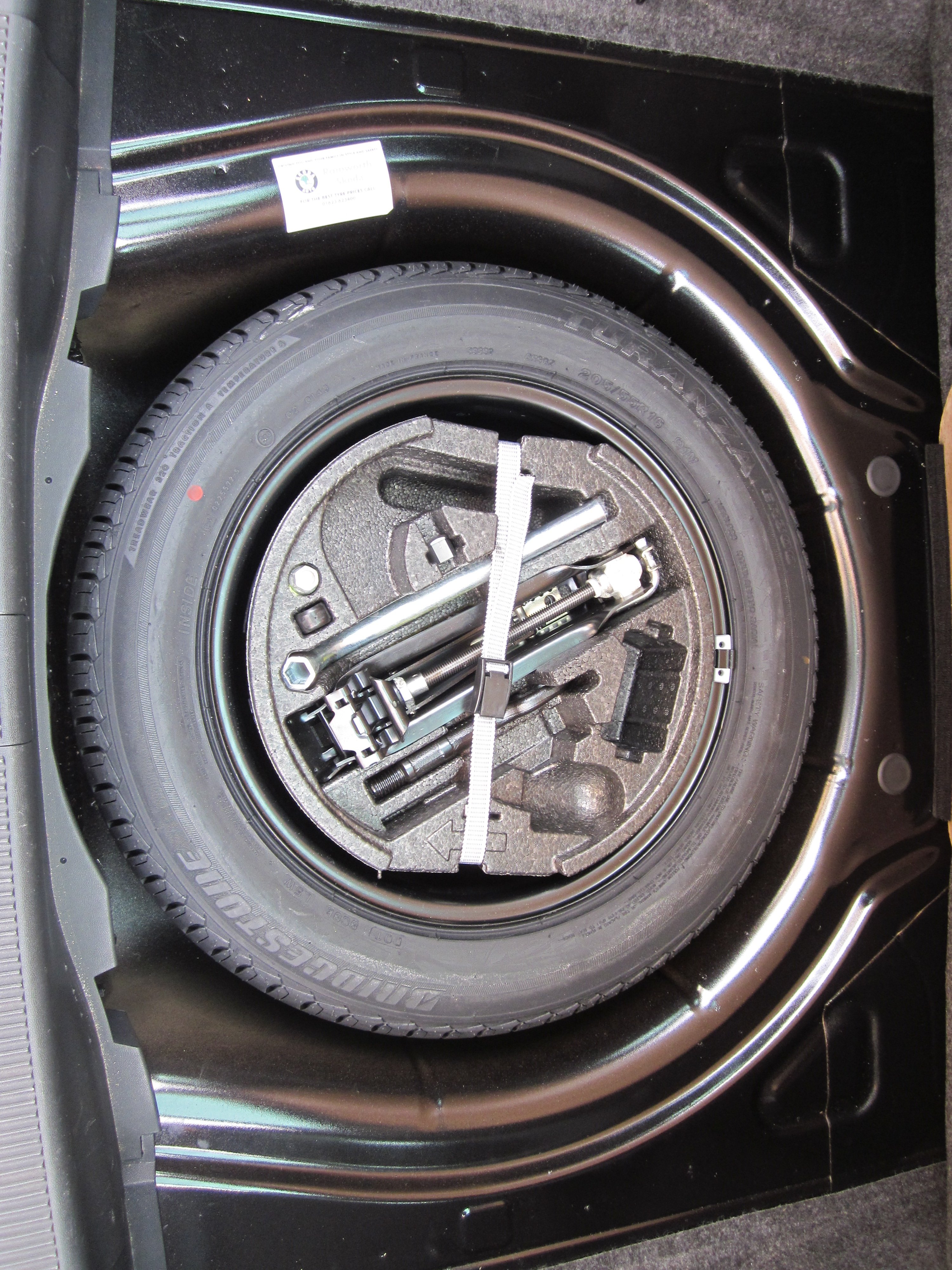

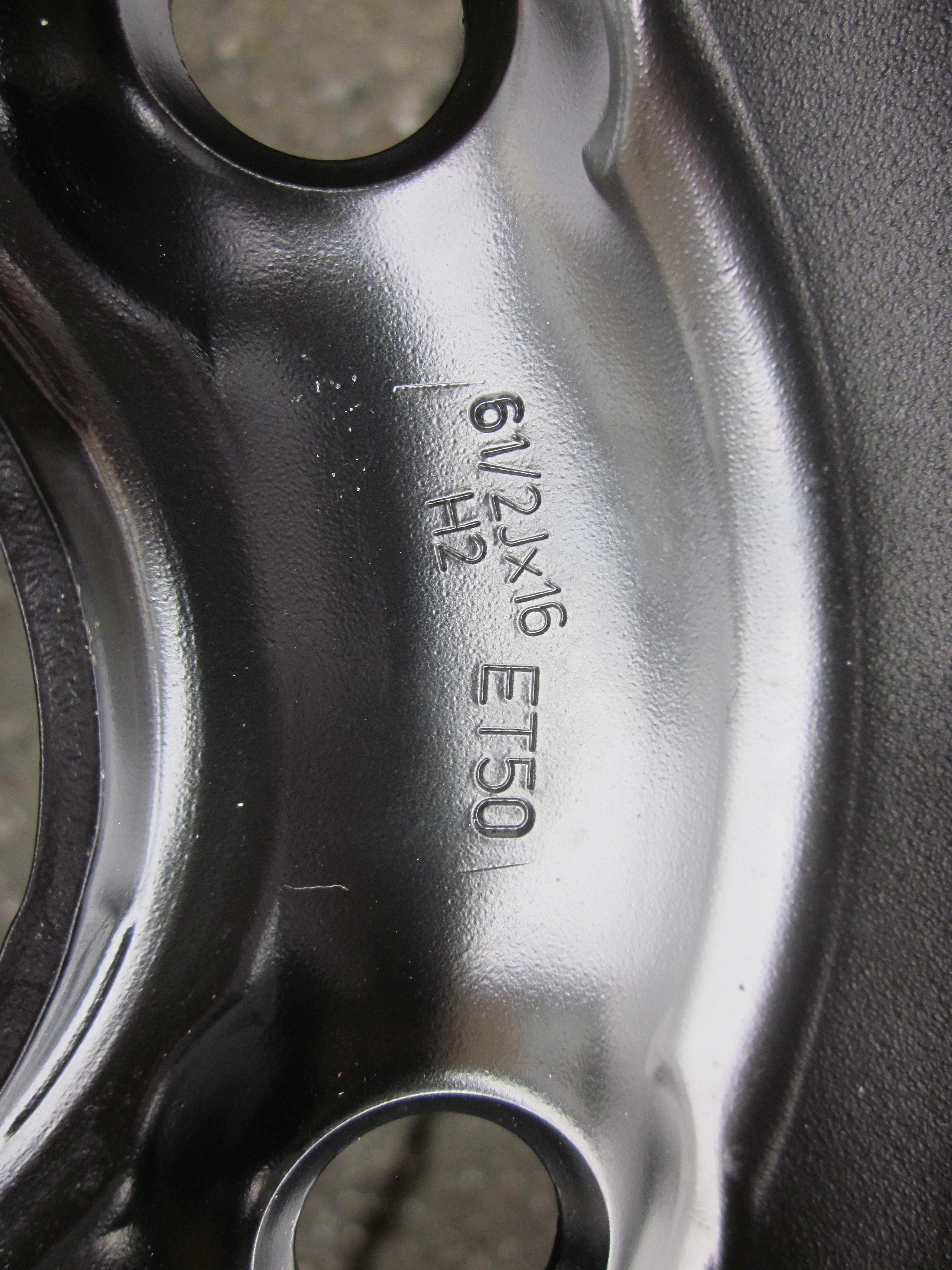

All Octavia estates have the same floor pan, the Scout is no different.
The Scout gets the same full size 16" steel spare wheel as other Octavia's.

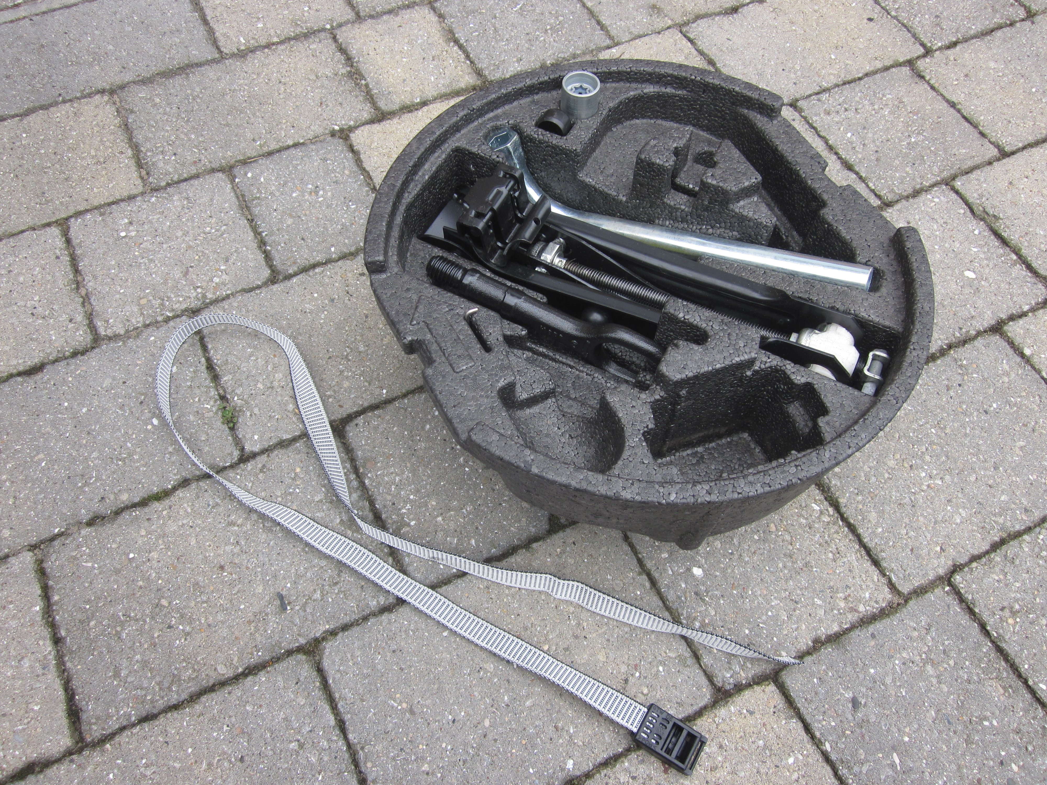

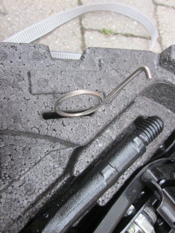

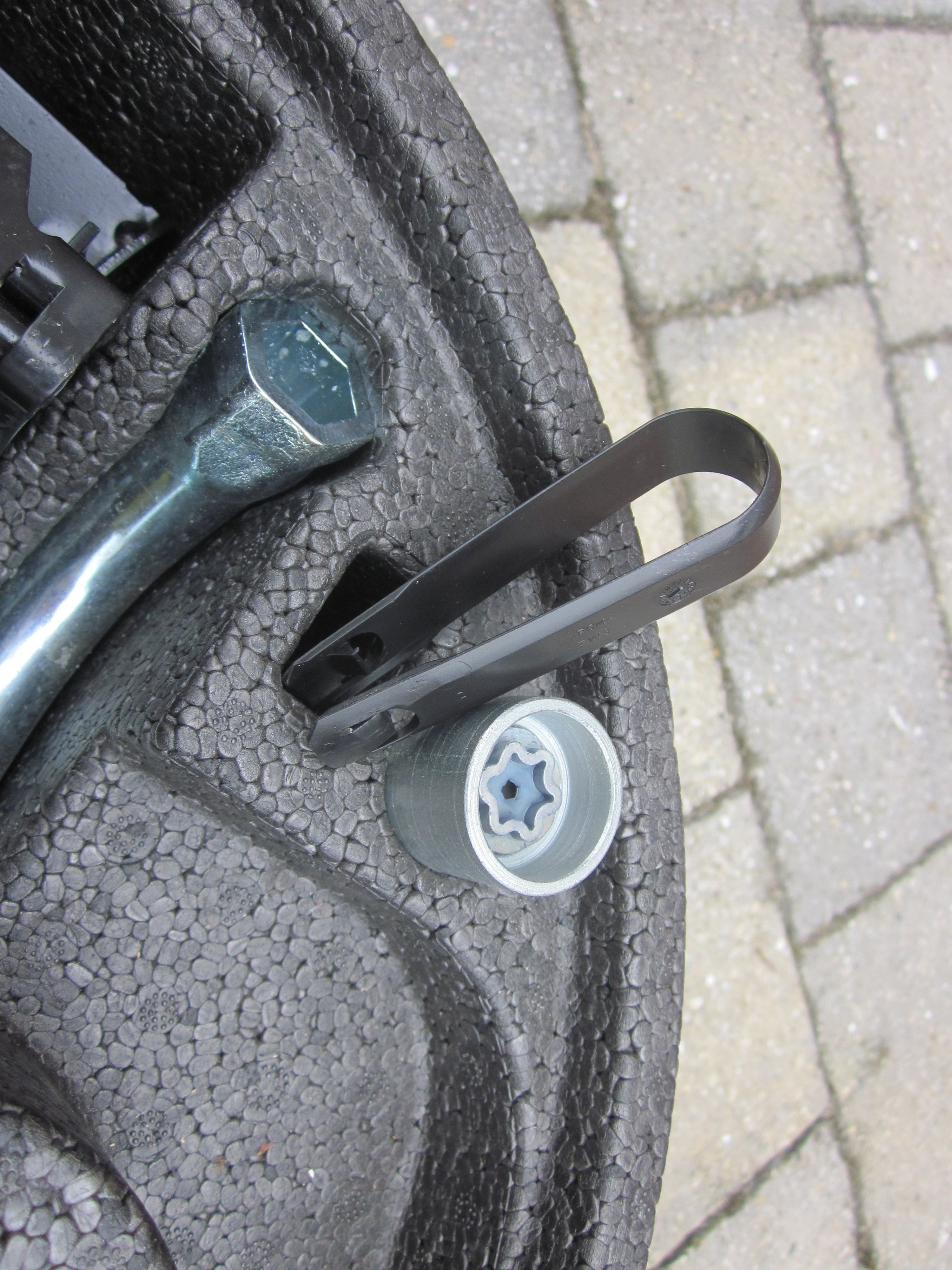

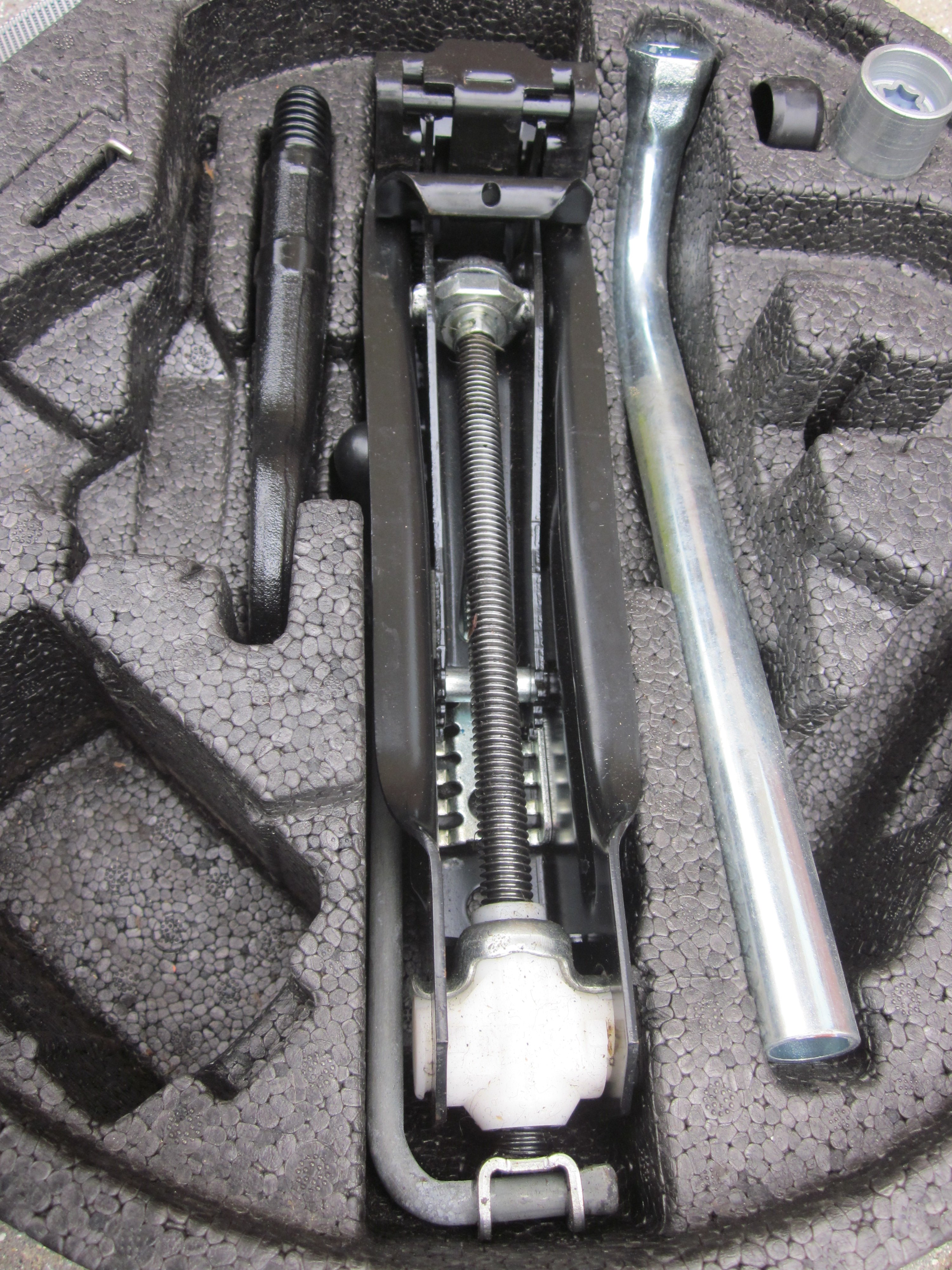

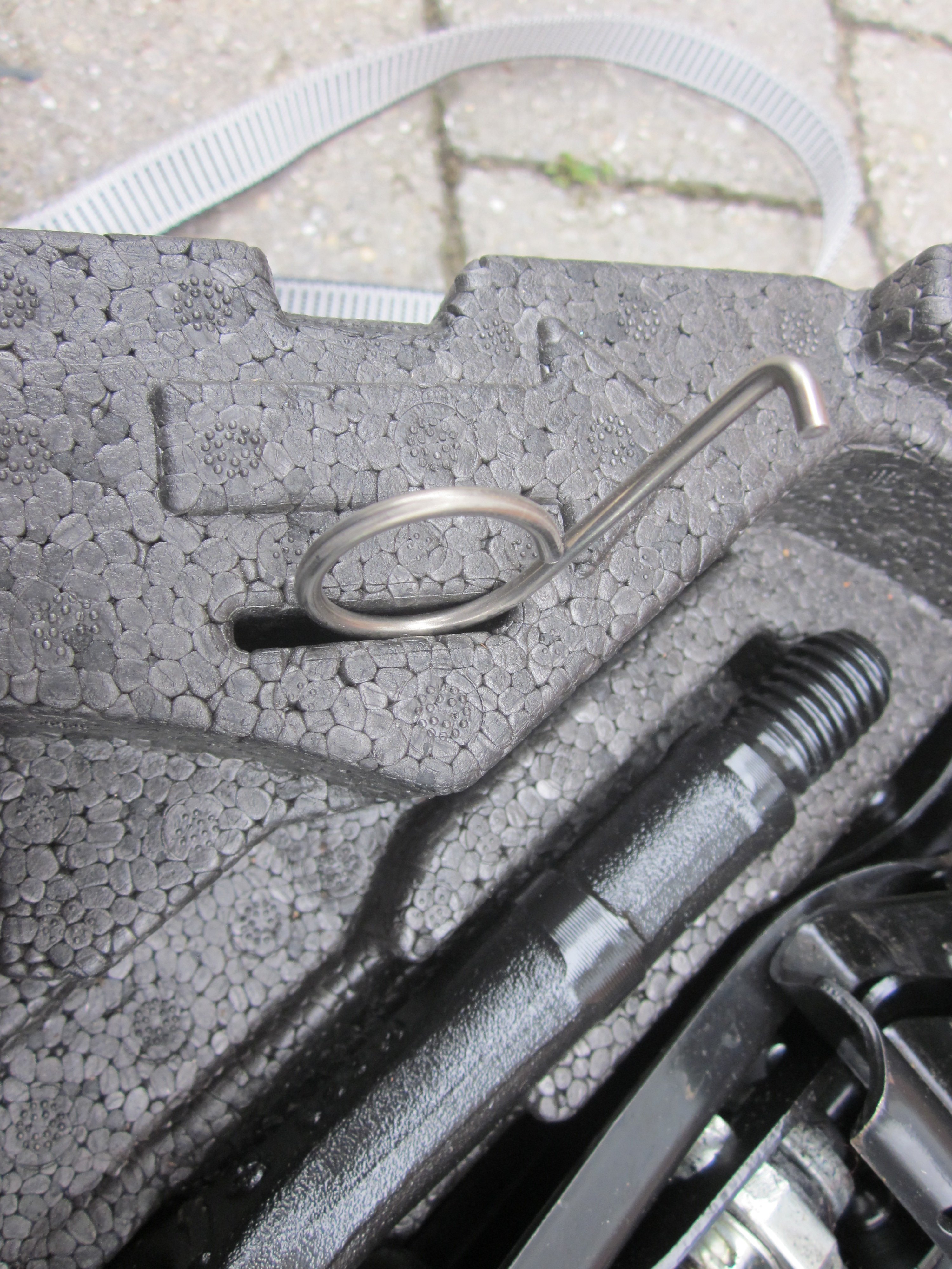

These images are from my Scout...
