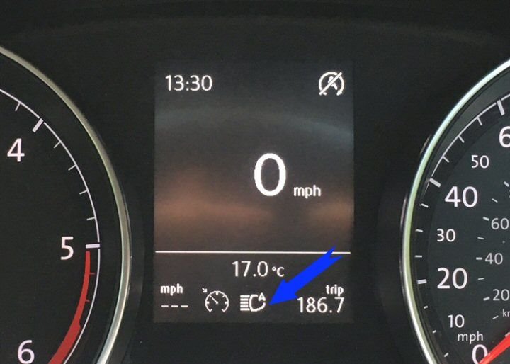

When driving along (over 50kph I think) when you push the light stalk away to turn on high beam you should get a little symbol on the dash that looks like this. It will dip automatically when:
- under a certain speed
- it sees what it thinks is a car approaching
- it sees too much light like your headlights off a road sign
If you turn on high beam assist and the lights don't come up then one of the above is likely getting in the way. When on full beam you can push the stalk away again and it will go to regular high beam. Pull again to turn off. Away again and it goes back to auto.
