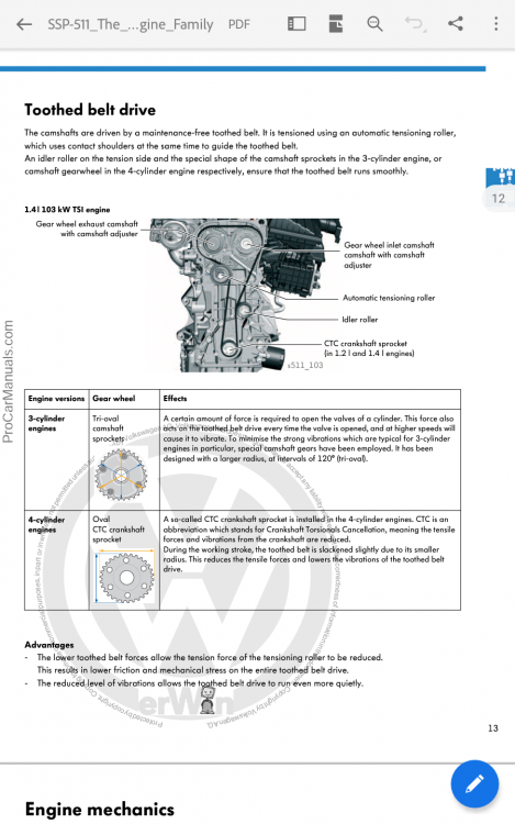

Specifically regarding the EA211 petrol tsi engines, google them. There is plenty of available information that the timing belt system is designed to have reduced load on the belt by the design of the cogs and the tensioning system, and movement of the water pump to the other end of the engine with its own separate belt.
Also the belts are reinforced and designed to last.
