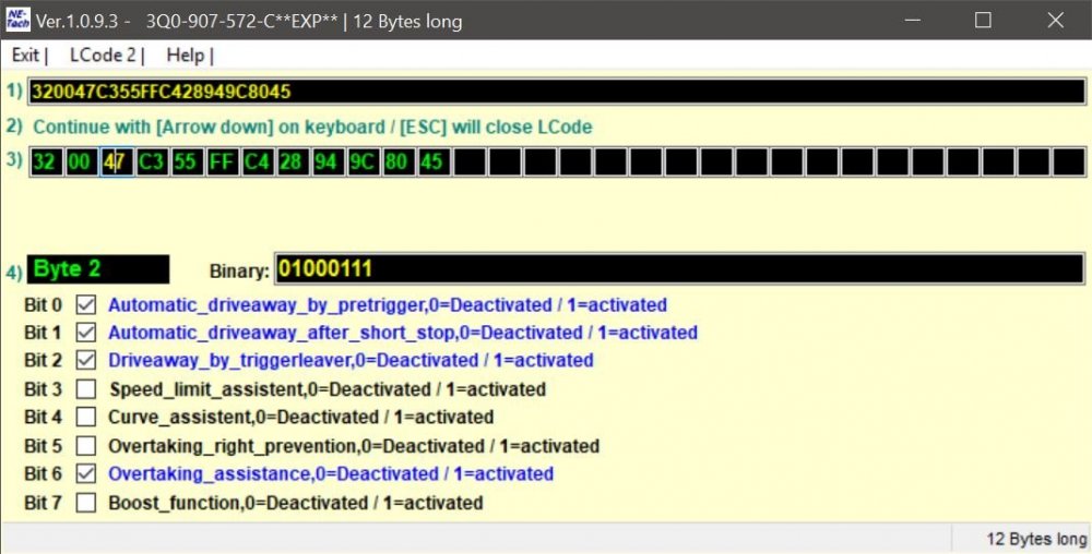

Can you please tell me how you disabled this via vcds? I would love to change this on my car.

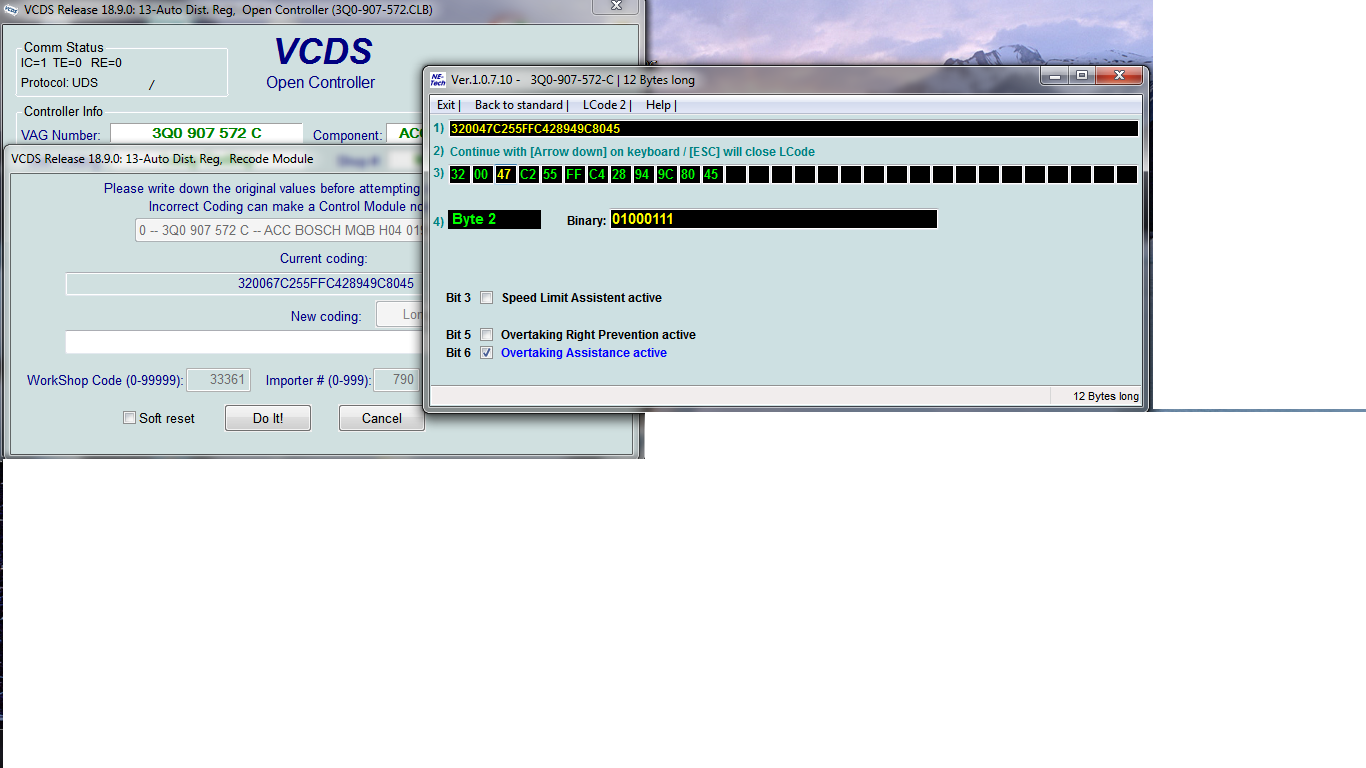

Undertaking Prevention De-activation
Controller 13-Auto Dist. Reg
07 - Coding
Byte 02, Bit 5 to 0=Deactivated
Untick Overtaking_right_prevention.
Once done, make sure you reset the Driver Assist, otherwise it will disable TJA below 65km/h.

Thanks. It worked.
I also made screenshot. Looks quite different.
good to hear it worked :)
yes, your is very much different.  out of curiosity - wat model year is urs?
the "automatic_driveway" is related to traffic jam assist. i.e. it will stop n resume, in combination with ACC, hence TJA.
the speed_limit_assistent and curve_assistent i believe is relation to the Dynamic/Predictive ACC, but i don't believe this works on any Skoda models yet.
sadly, simply activating the checkboxes is not enough, as Predictive ACC is a SWaP secured feature with an entitlement code, as well an associated data parameter table.
its certainly there for some VW and Audi models.
Edited by JR RS
