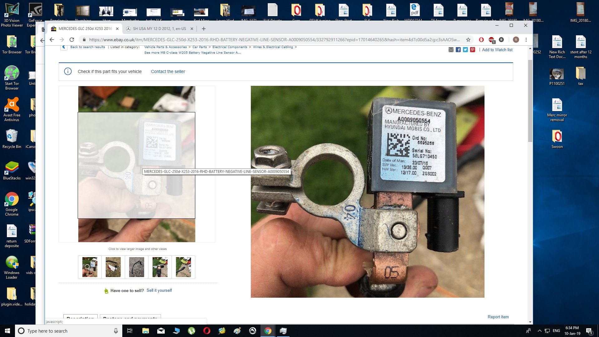

You don`t need an agm battery otherwise it would have been fitted by the manufacturer, stop/start just drains the battery, the smart charging system is the problem as it won`t allow the alternator to charge the battery level beyond 75% when the car is under engine power, the other 25% capacity is for regeneration only, short journeys= little or no regeneration which = a near to flat battery as you have discovered. Disconnect the sensor on the negative post of starter battery, buy an Ebay voltage tester as pic and plug it into the cig lighter socket, run the car on your usual short journeys for about a week then test the battery with a multimeter after the car has rested overnight, if the battery is good it will be fully charged 12.6/7 volts. When driving the car the test meter in the cig socket should show continuous charging of between 14.3 and 13.8 volts.
Nothing will be damaged, disconnecting the sensor is same as sensor failing there is not even a EML shown on dash, if that sensor fails the EMU reverts to a continuous standard charging regime 14.3 to 13.8 volts, as previously stated I have been running my 2012 Merc with this sensor disconnected for the last 6.5 months.
Disconnect sensor, small black connector as pic of Merc sensor, yours should be similar.

Terfar,
As said If you have disconnected that sensor both stop/start and the smart charging system would have been disabled, this should have solved your low battery problem as the alternator will now charge continuously under the engines power, the battery on my Merc is stamped 23/11 on the negative post which means it was produced on the 23 week of 2011, it is still going strong, before disconnecting the sensor I always manually switched stop/start to off.
