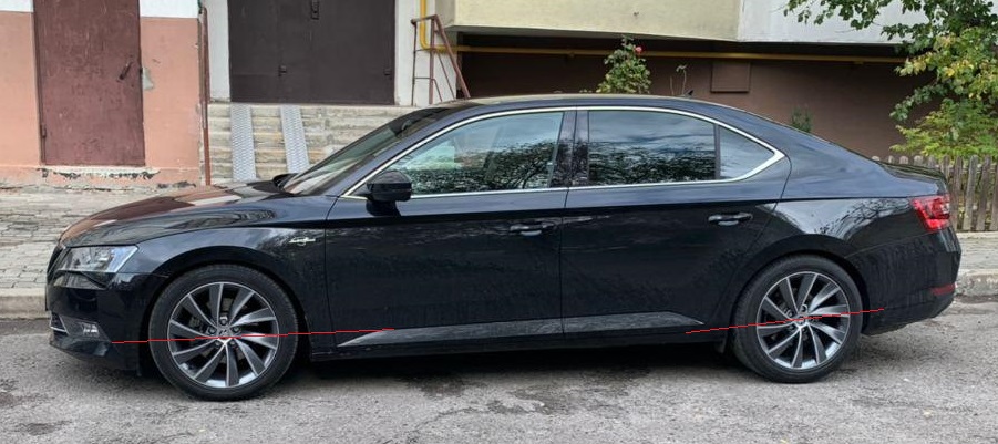

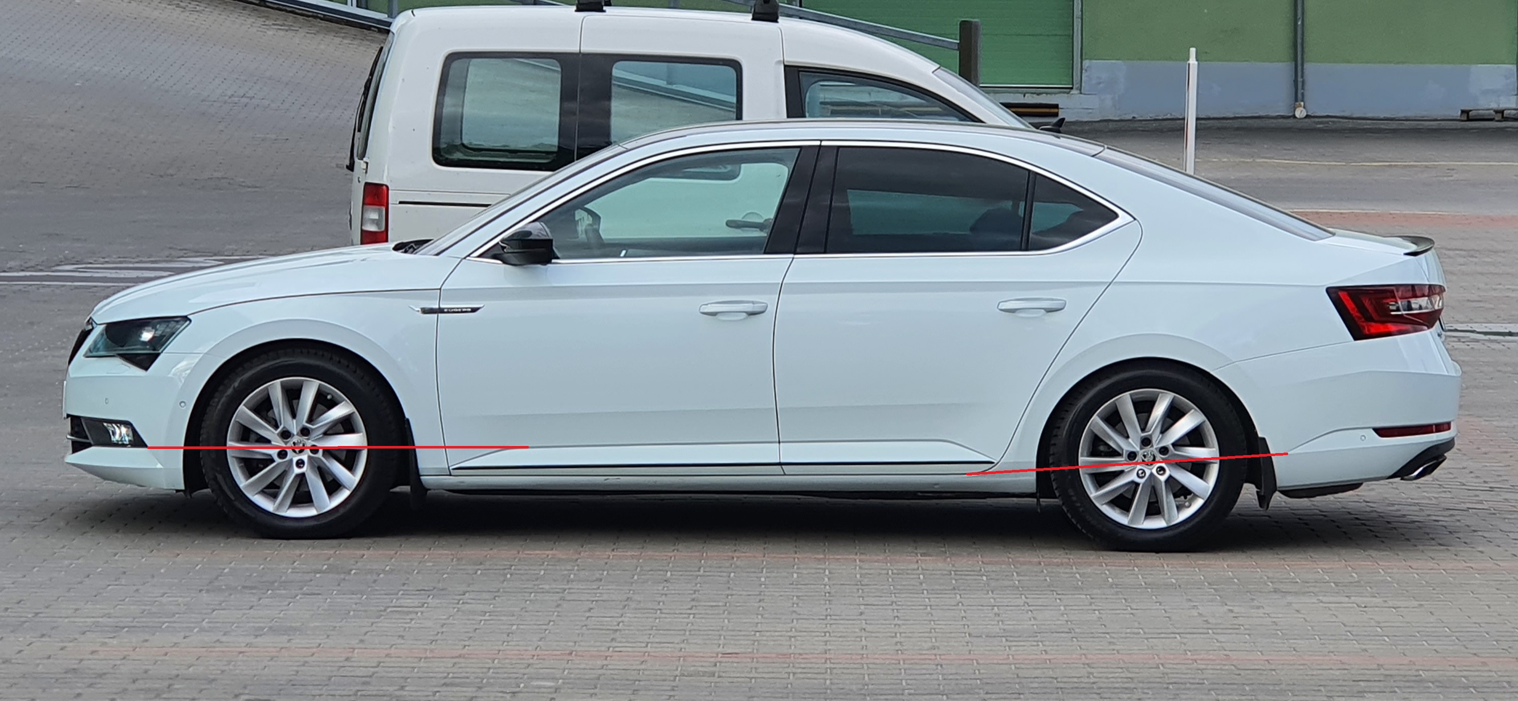

Sorry this looks like it has definitely dropped at the rear too, sure not as much as it would drop if using the springs meant for this car, but this not how the rear sits even on a stock Sportline (it should be higher).

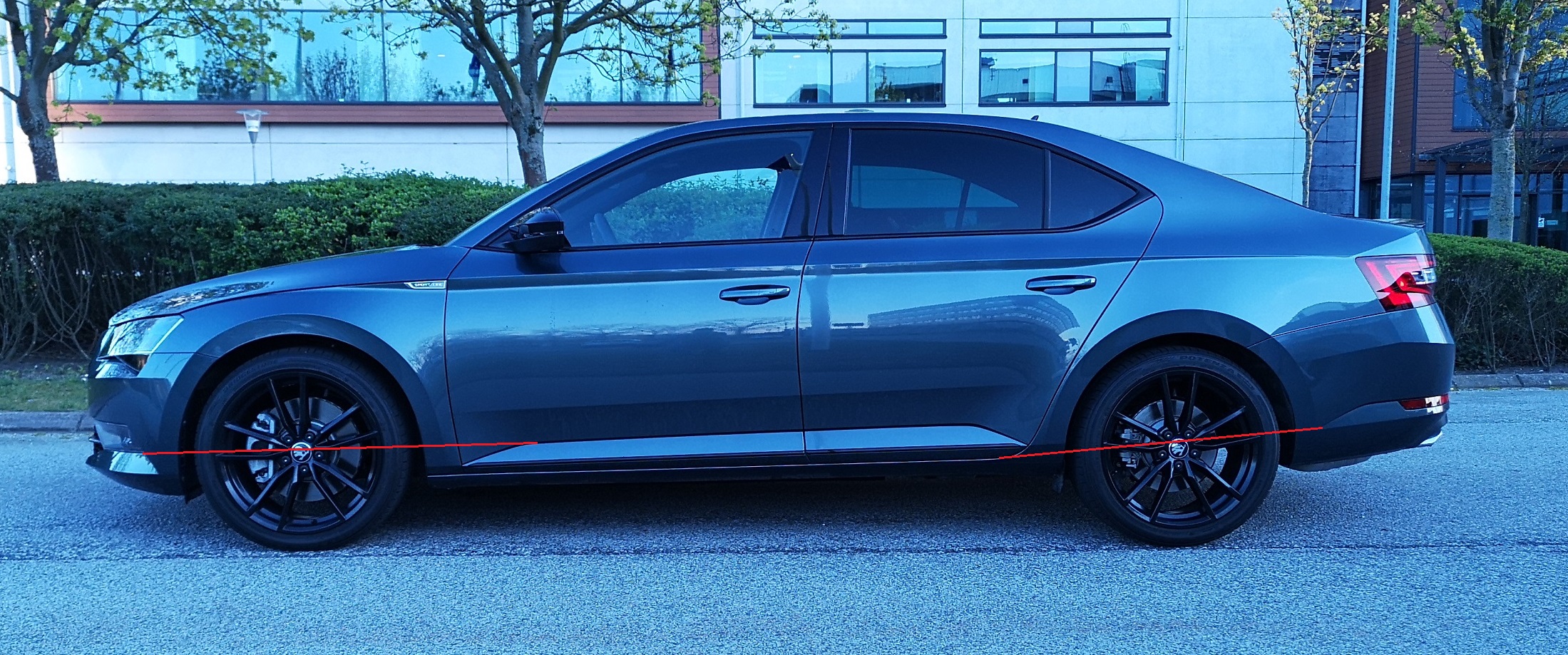

This was my stock Sportline before any mods, you can clearly see the rear arch gap being double than the one in your photo of the FWD car using AWD rear springs:
What would be the point in keeping it fully at stock height then? Not that it is even possible to do this with AWD springs anyway but just wondering.

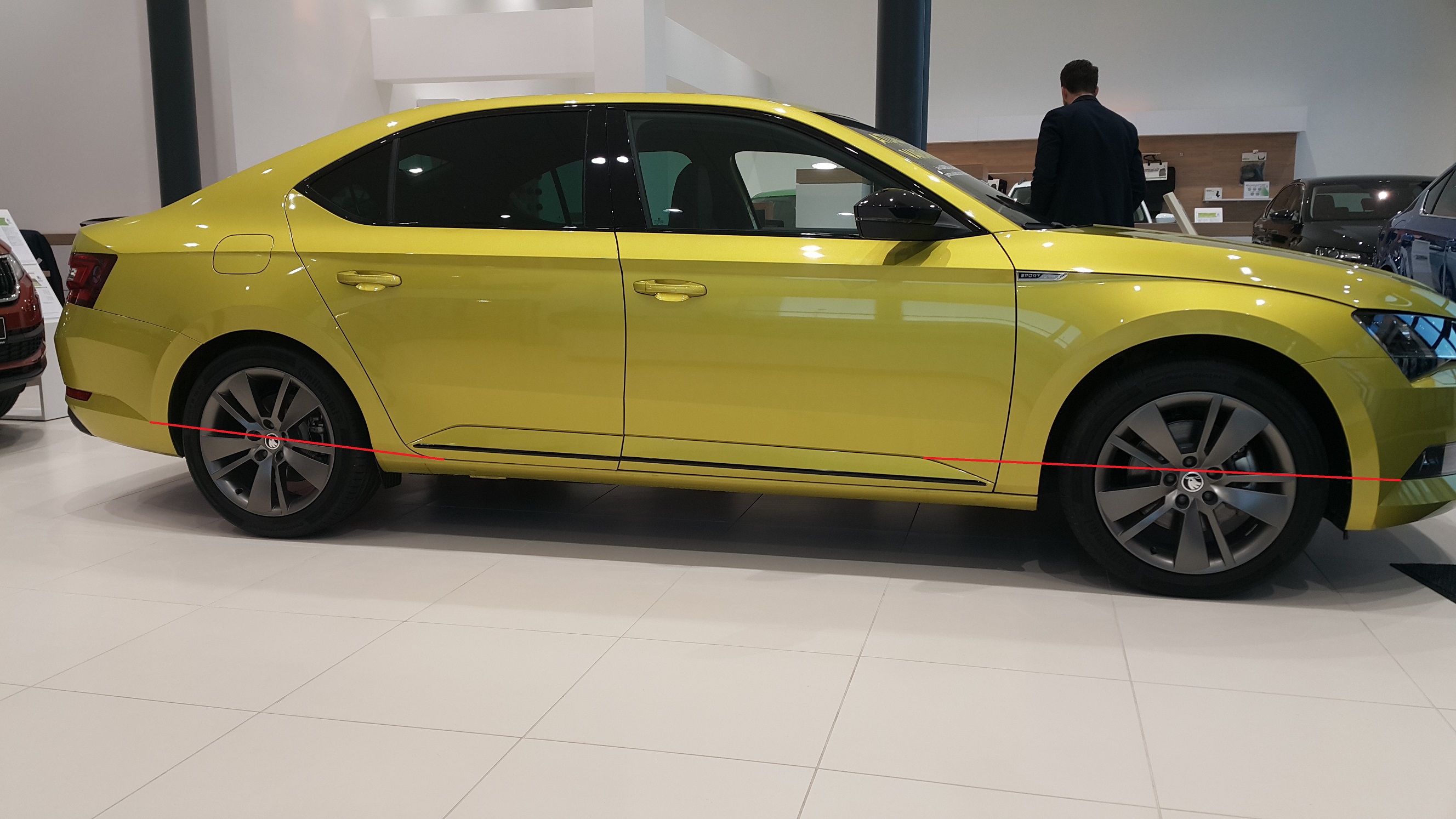

Sportline doesn't always mean there are some differences in suspension,
look to this nonsense, guessing with rough road package

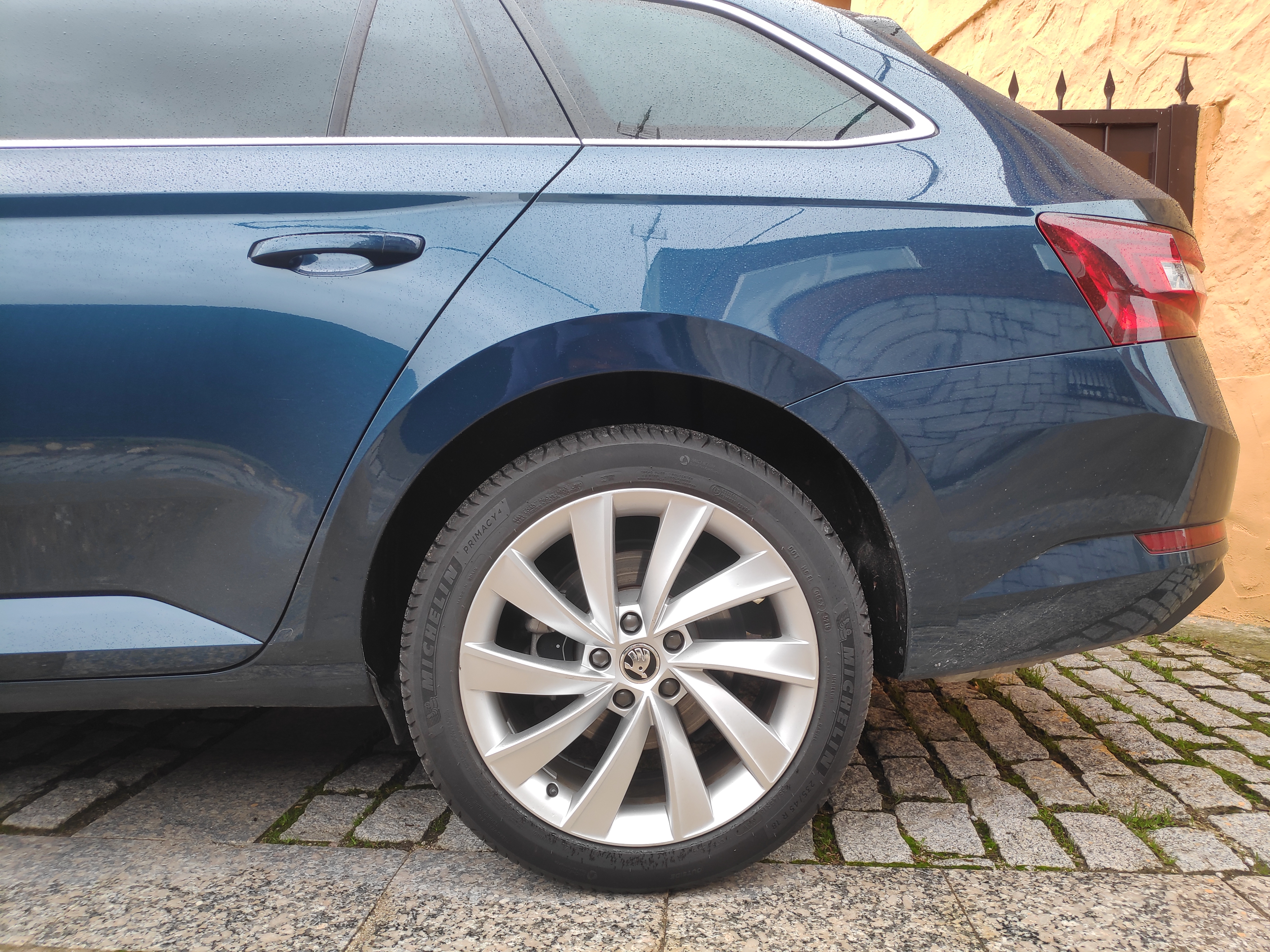

This is my Tdi 190cv 4x4 with suspension for bad roads.  For me, it is excessively high, I notice too much inertia and aesthetically I just don't like it.  I don't know if the B12 kit will be too low.
Parte trasera...

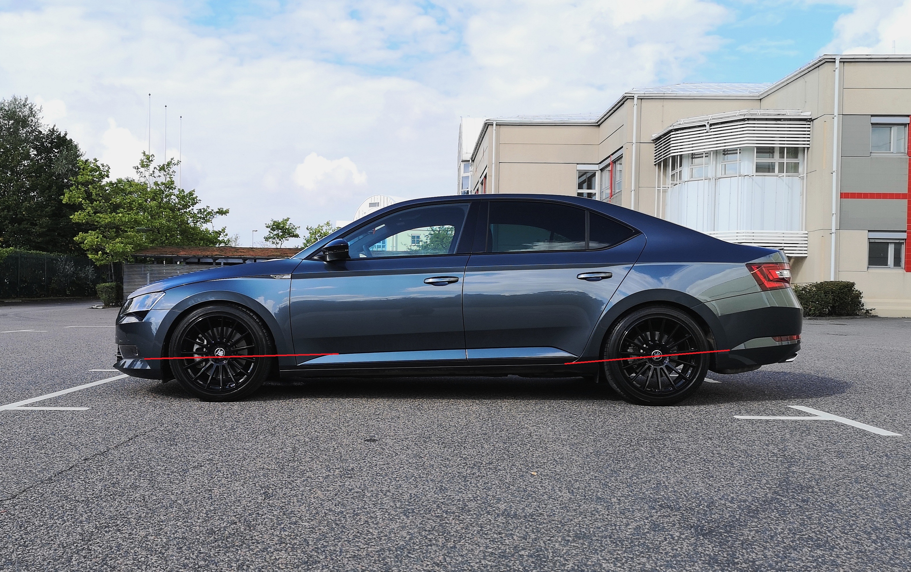

As you can see in the 1st picture (stock), the rear is sitting 5-10mm higher than the front, probably for loading and carrying people without getting lower than front. This is true on many cars also.
Now in the 3rd picture where I used the Eiback Pro-Kit (the correct one for my car) but I also added the thicker Audi pads on top (at the rear), the rear is again a bit higher than the front, similar to the stock proportions.
If putting just the Eibachs on, you end up with the front and rear at exactly the same height. Looking good on photos but I didn't like how much lower it went when loaded so I brought it back to the stock relative position.

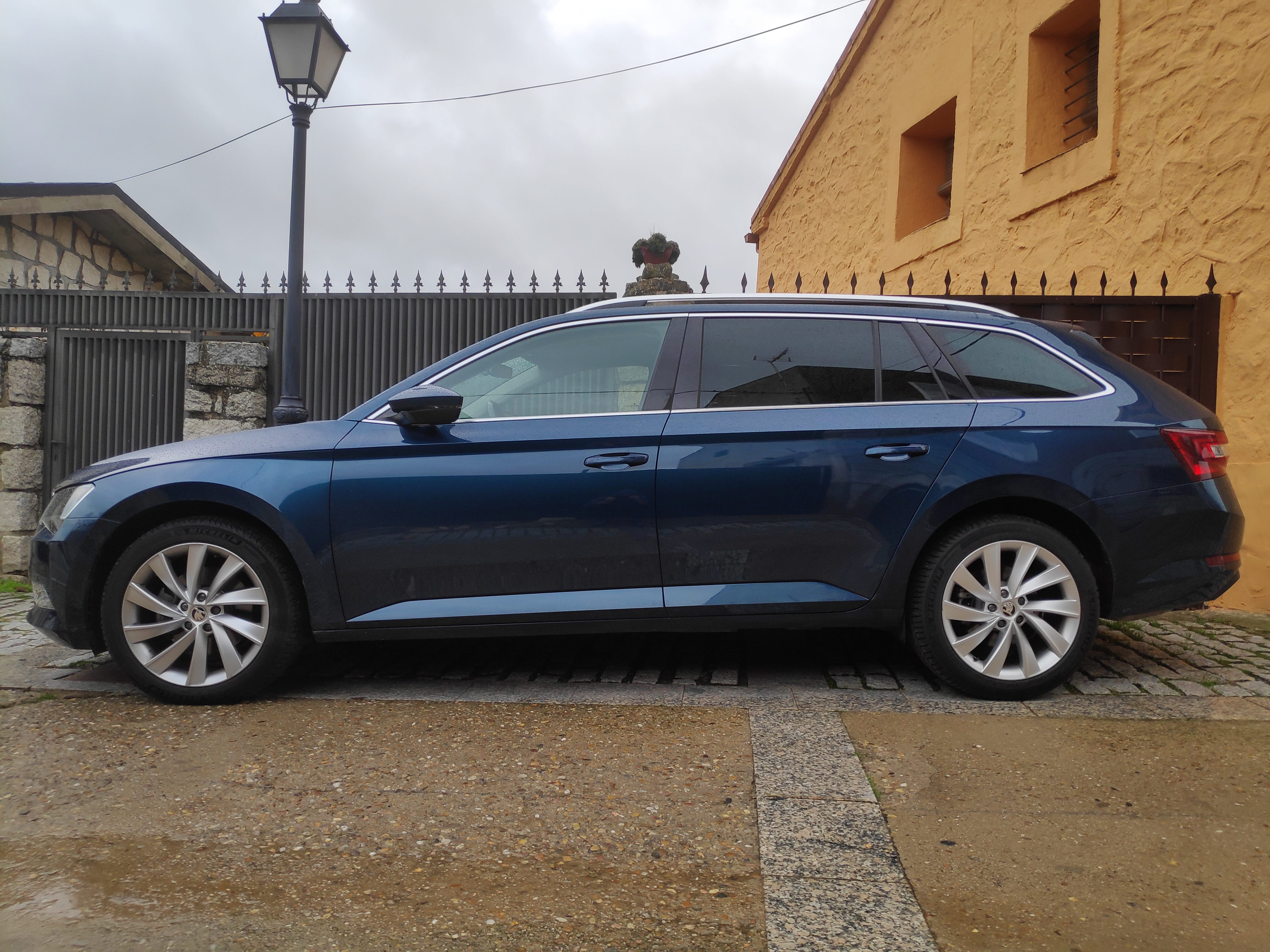

Currently, the rear is 73 milimeters from the ground with a 7-centimeter gap between the rubber and the body.  In the front  I have a gap of 6 centimeters.  If I have not measured wrong.  If with the B12 it goes down 3 centimeters, it seems perfect.  I had b6 and prokit in another car for years, but now I am expecting a baby and I don't know if it will be too tough for trans-European trips of 7000 km.  Is there a better option?
1 hour ago, newbie69 said:
Mi automóvil en esta imagen se reduce en ~ 30 mm:  B12 se reduce en 25-40 mm, por lo que en el ajuste más alto (25 mm) debería ser incluso un poco más alto que el mío, lo que creo que está bien. Esto depende de dónde vivas, por supuesto, pero el mío, que mide casi 30 mm, está bien para la mayoría de las situaciones diarias, bordillos de velocidad, rampas, etc. Hasta ahora no he tenido ningún problema. El tuyo no tiene DCC , ¿correcto? De lo contrario, B12 no encajaría sin un kit de cancelación DCC .
I don't have DCC ...
It won't go down 30mm from your 70mm... These measurements are usually taken from the standard car (not the Rough Road springs or Sportline) so you need to add the extra height of the Rough Road pack, if it is 15mm it would go down 30mm + 15mm = 45mm from your current height.
If you worry about lowering you could combine B6 with the Sportline springs.  Much better control but still a height which leaves quite some clearance in the arches. Height would be same as my stock Sportline probably, more than enough:

Part Number is E10-85-042-01-22
alternative is H&R springs.
Part Number is 28784-1 for Superb 3V3 Hatchback 1.4 TSi.
if u have DCC shocks, it will lower by 20-25mm.
