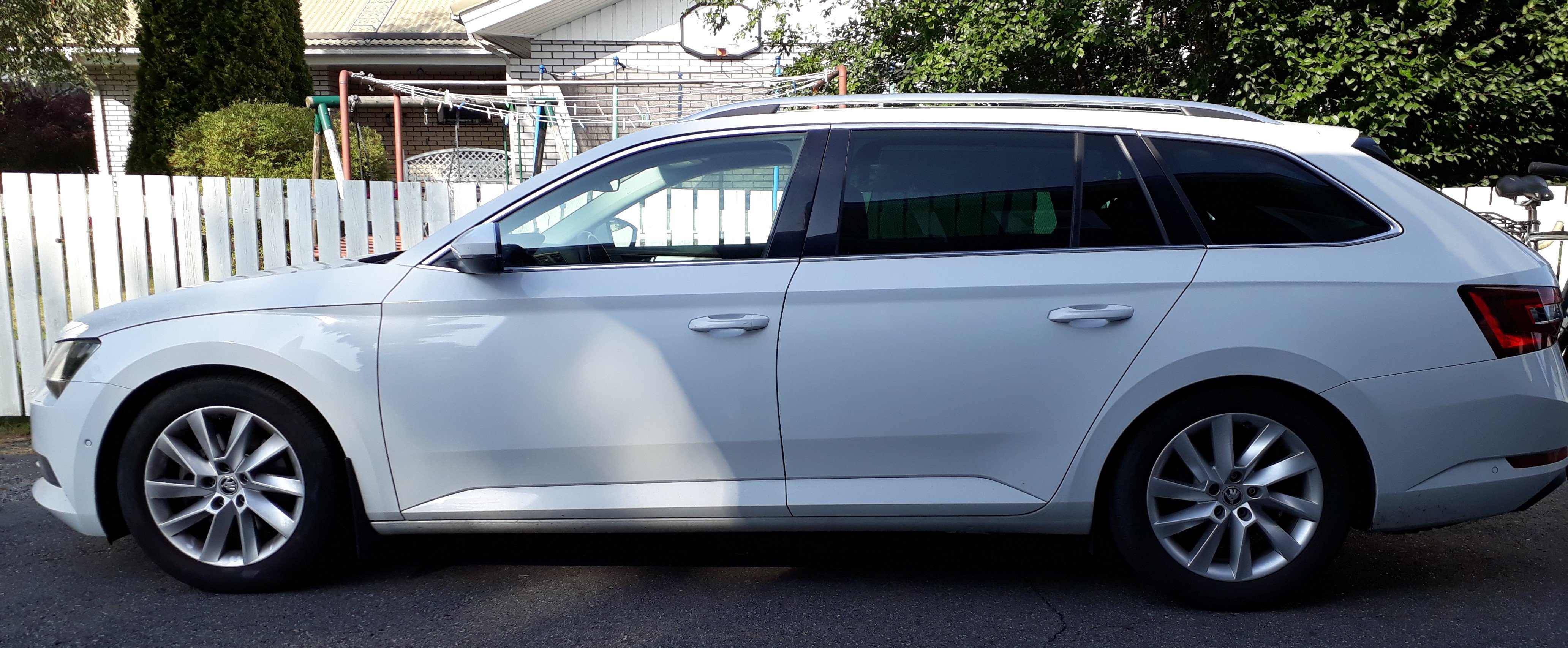

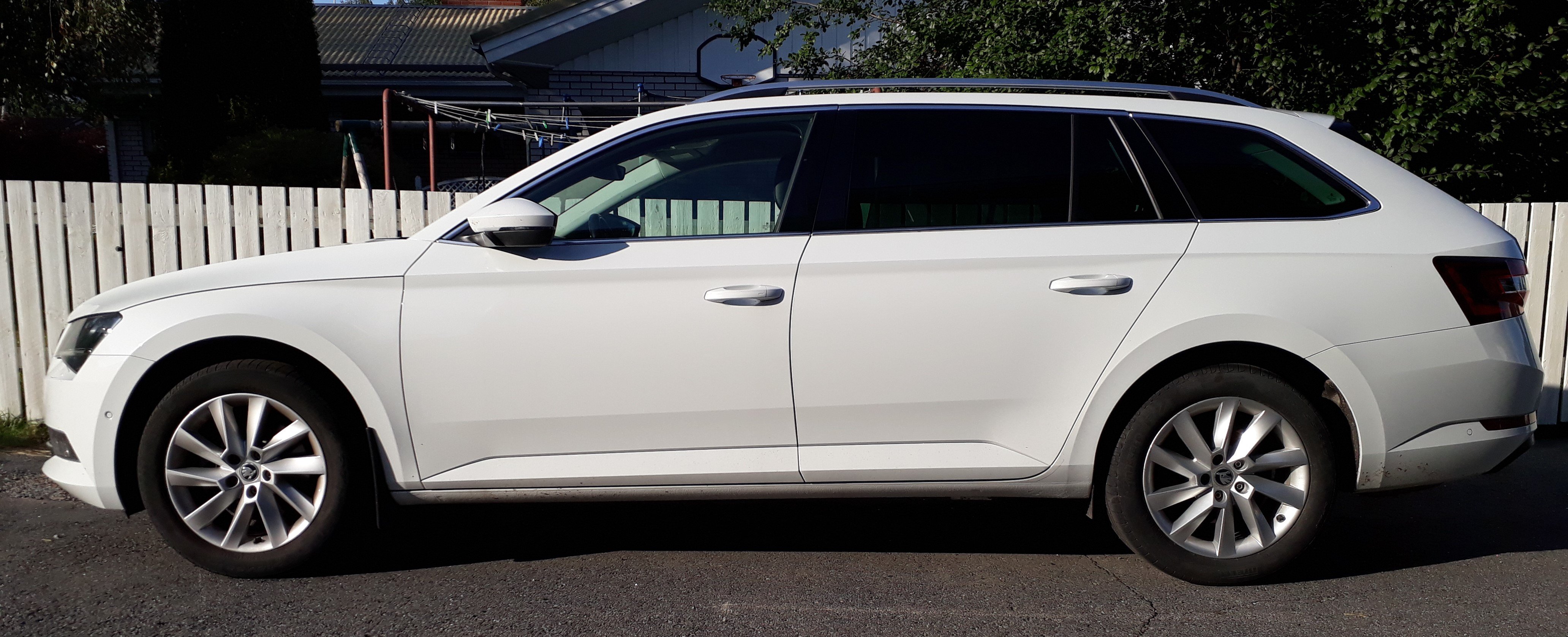

Now Eibach pro kit installed. Forgot to measure before installation but to me looks better and drives much better :) Next I'll have to start looking for new wheels.20190819_180651.thumb.jpg.5eef6d8d7f271e273619e80f15cee004.jpg20190821_160128.thumb.jpg.9d0813be8df8ef6725d0e85782aa00e9.jpg

  • Finally the Eibach Pro-kit is in!! woOot 😁 Its less wallowy now in Normal mode.  It's good now. Sport mode is nice n firm.  Comfort mode is still comfortable 👍 Before - 690mm from fe
  • Now Eibach pro kit installed. Forgot to measure before installation but to me looks better and drives much better  Next I'll have to start looking for new wheels.
  • Currently on b6 with prokit springs (octavia) and as newbie says they offer support and control but without being overly crashy/firm.  Used the B6 on stock springs for a while too and definitely somet

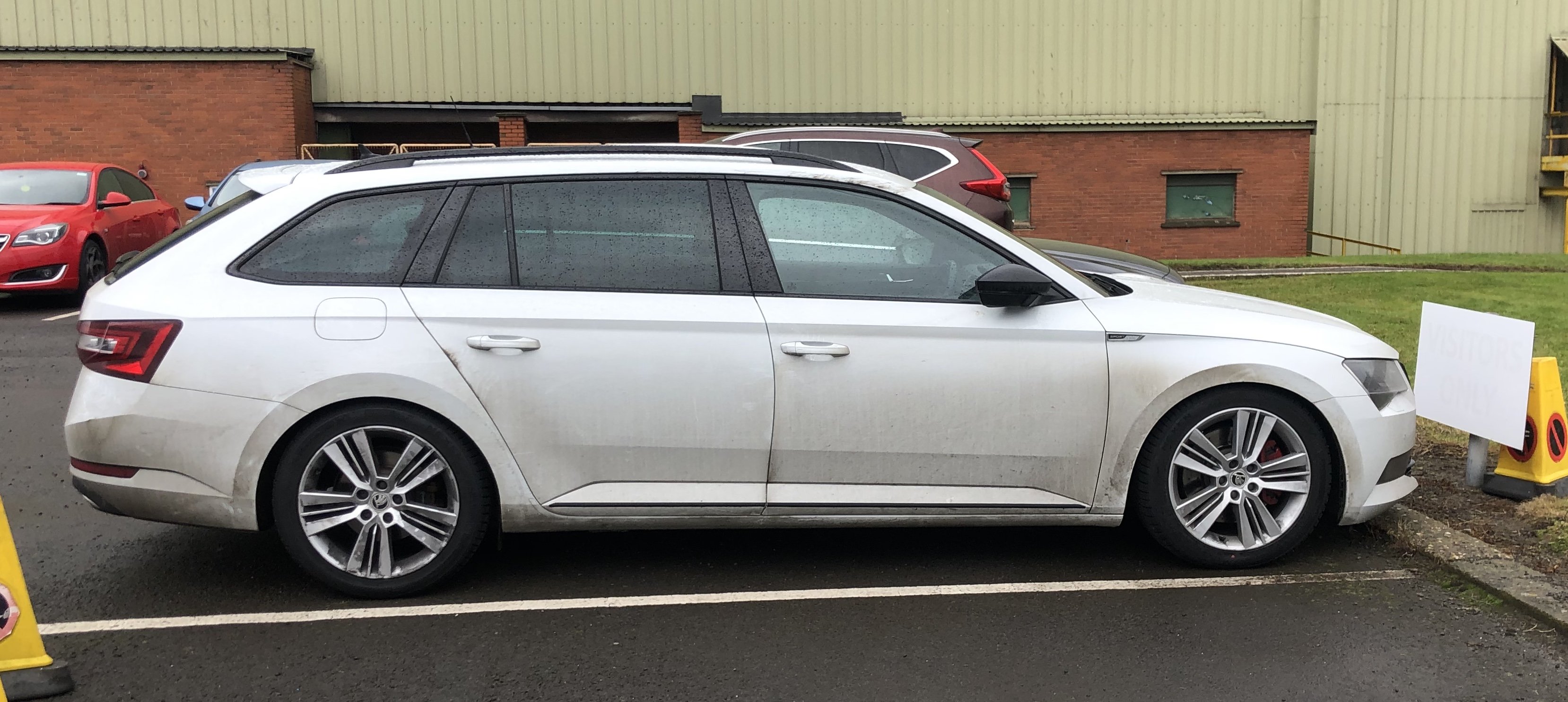

On 12/04/2019 at 03:30, JR RS said:

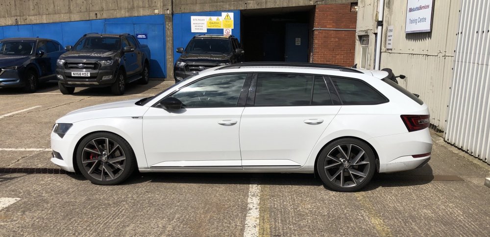

tis not an estate @Bigken6002, but below r some pics of a Superb lowered on H&R springs.
HR-Splitter-Mesh-Wheels-Springs-Spacer-Badge-Lights-Mirrors-RamSpeed.jpg.b3dec4efada8760f6f76babde4d6dc32.jpg
this one is riding on aftermarket 20" rims.......
Skoda_Superb_2WD_GFW_front.jpg.2157364a3ffd51365dc66e20028b59cc.jpg40629_1503662001914.jpg.391fd4e4a565d3de3718ad5673fdc770.jpg
below is an example of a Passat B8 DCC with the Eibach Pro-kit springs, the same used for the Superb - to give u an idea.....

If I remember correctly, the Eibach rep mentioned that particular car had a 25mm drop.

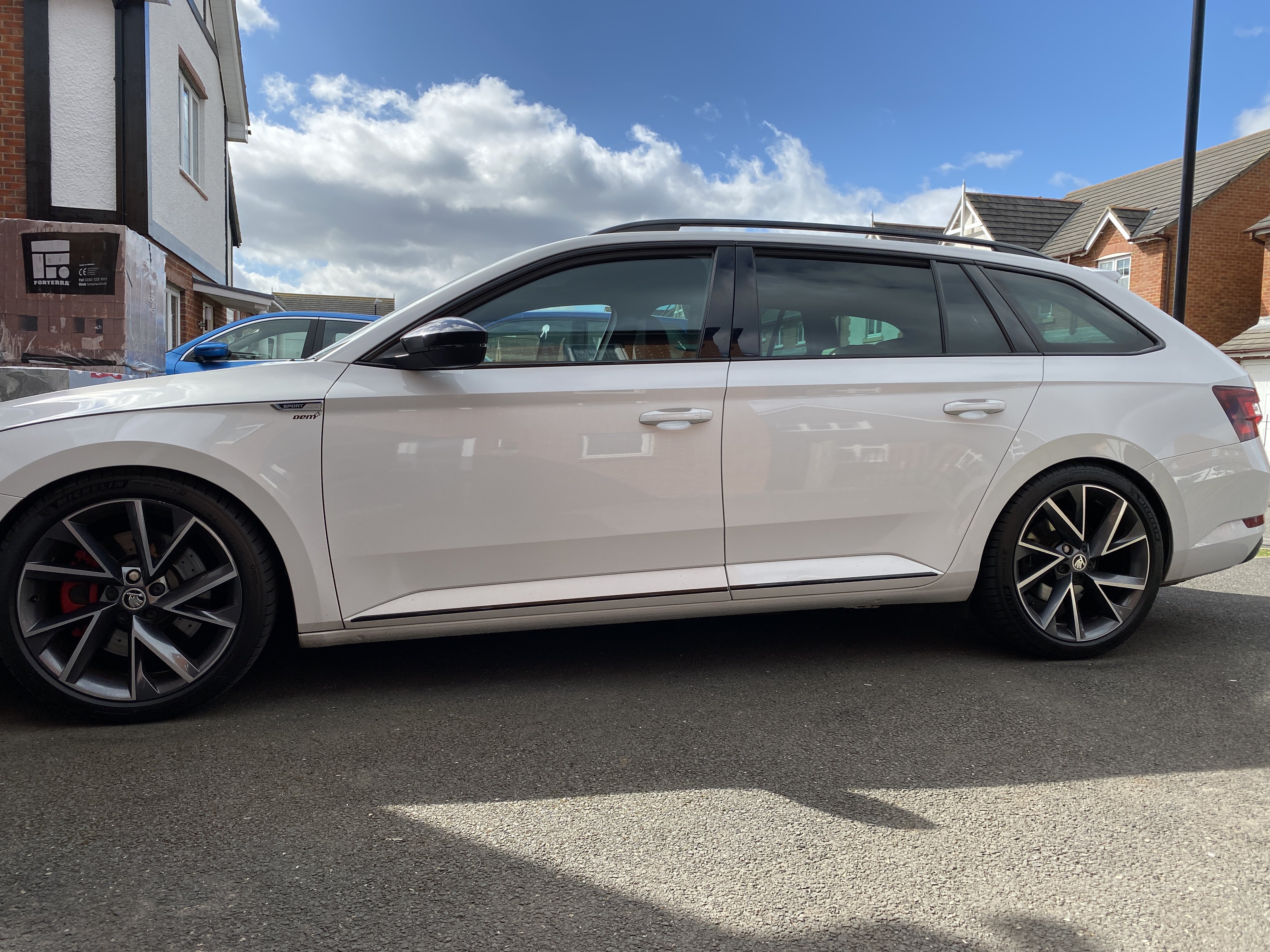

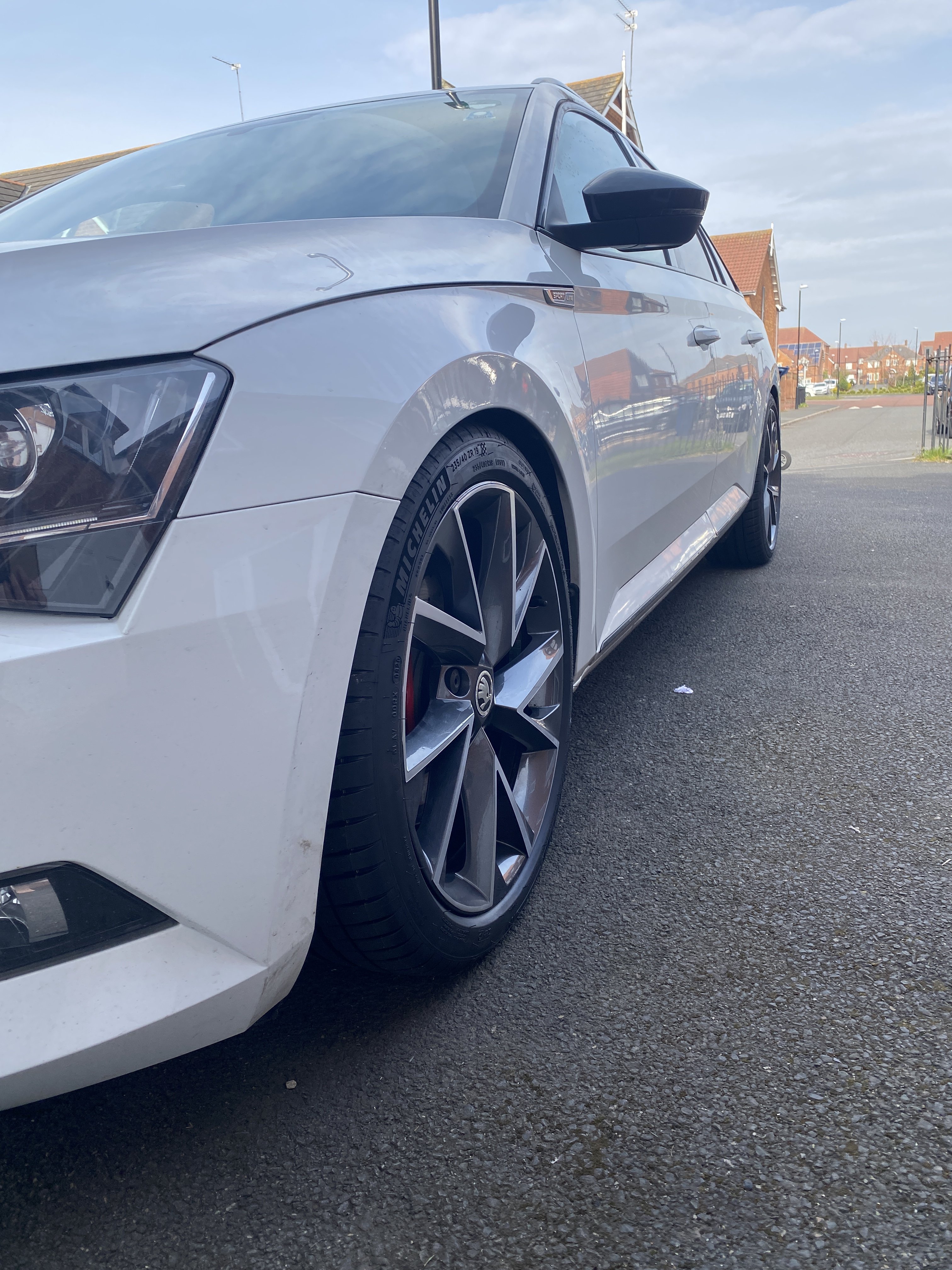

My sportline 4x4 on h@r. Ask with a pic of it on 18’s with winters on. 12mm spacers all round too
I wonder how the back will look on this when half-loaded or say during a road trip with stuff and people at the back. I had ~40kg in my boot the other day on my stock Sportline and the rear looked exactly like yours on H&R. Are the H&R progressive springs? Can't remember that. I fear there would be almost no arch gap at all in the above scenarios which somewhat defeats the main purpose on the car (for me at least).
Edited by newbie69

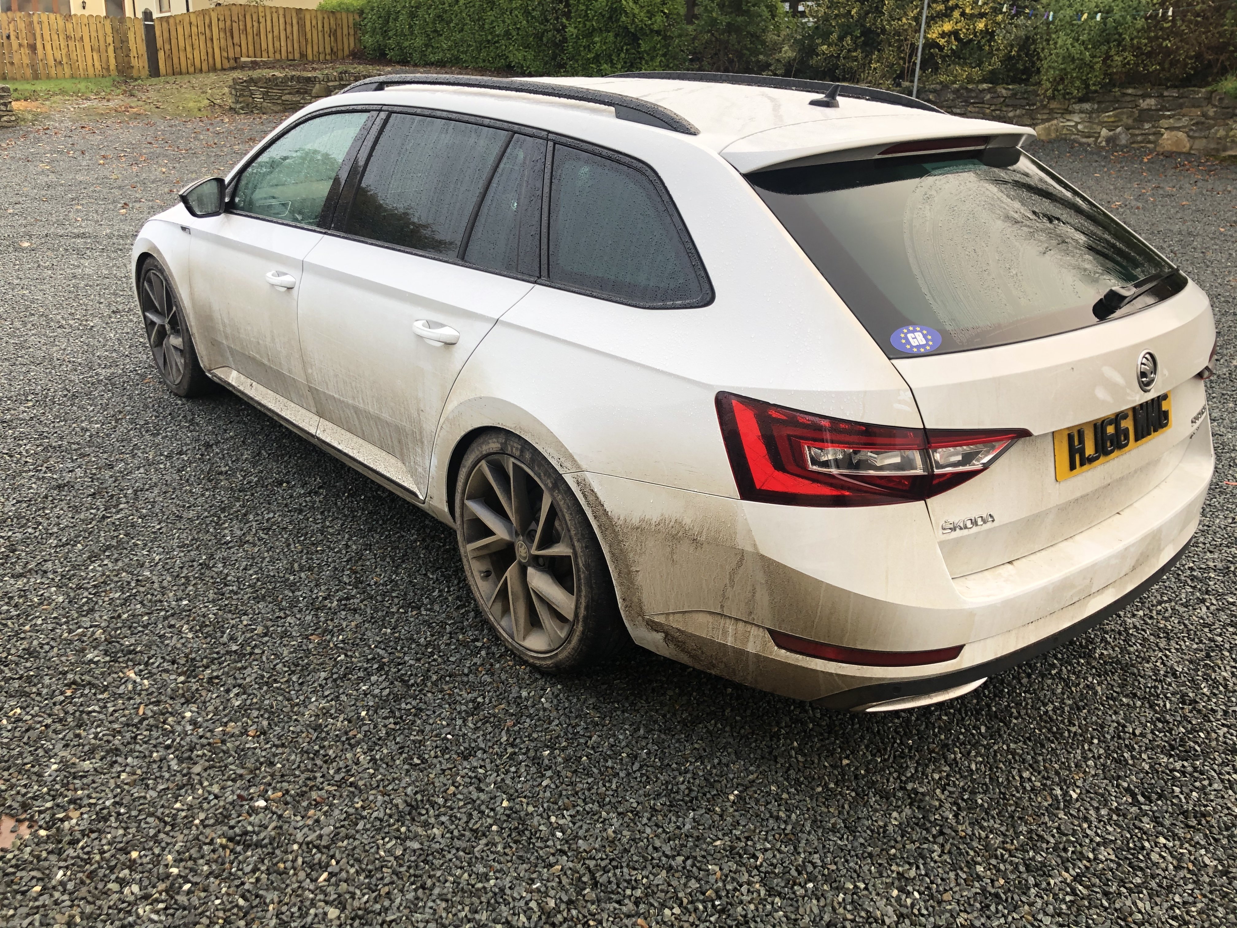

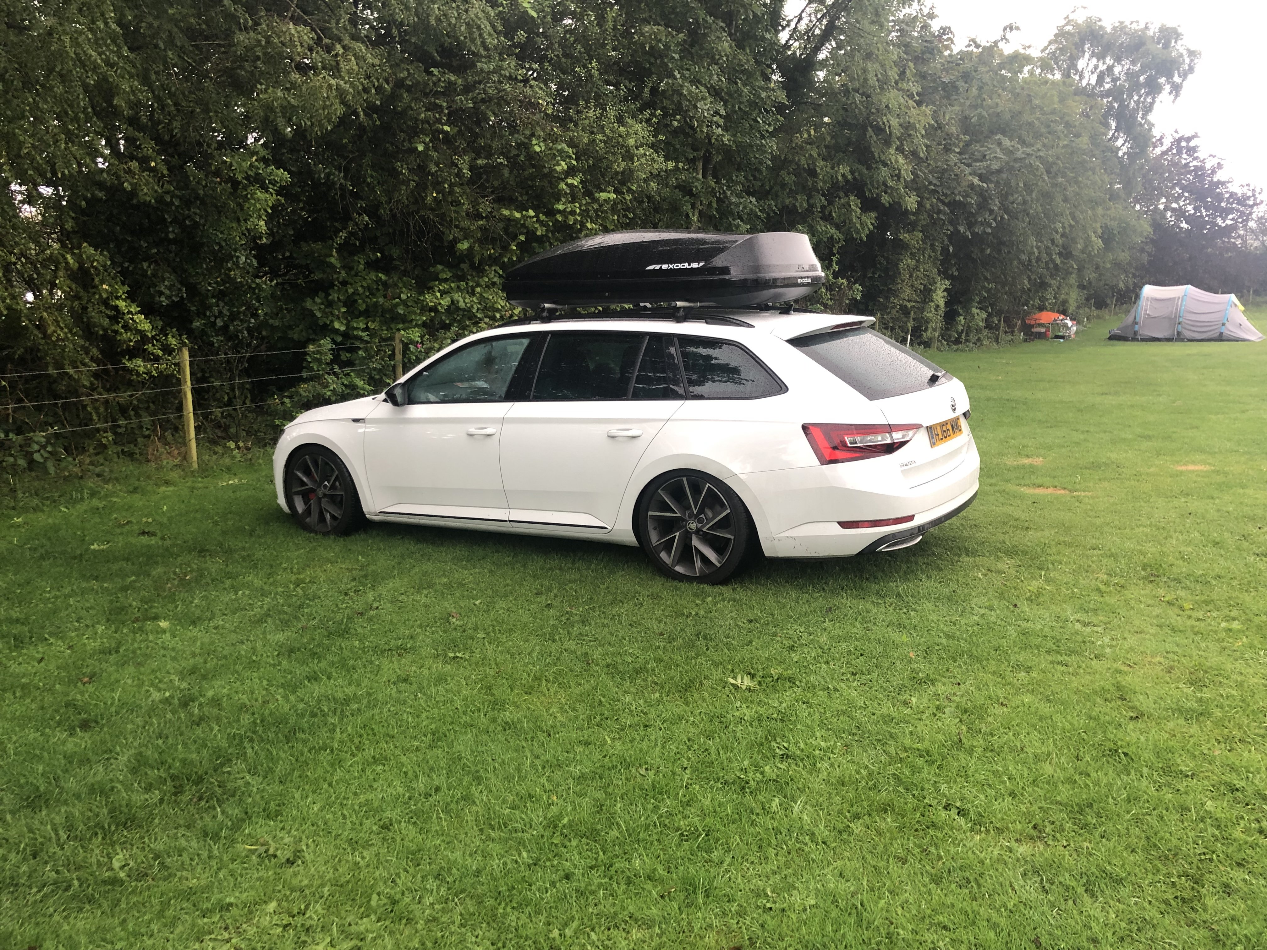

Springs are progressive.. 1 Fully loaded with roof box on, wife and kids in AND luggage.  Still got about 2-3 coils left working on rear.
side on shot probs has a bout 50kg in boot and probs about 100kg in on the rear dirty shot.
still rides pretty well tbf even fully loaded.
That's not as bad as I thought then.

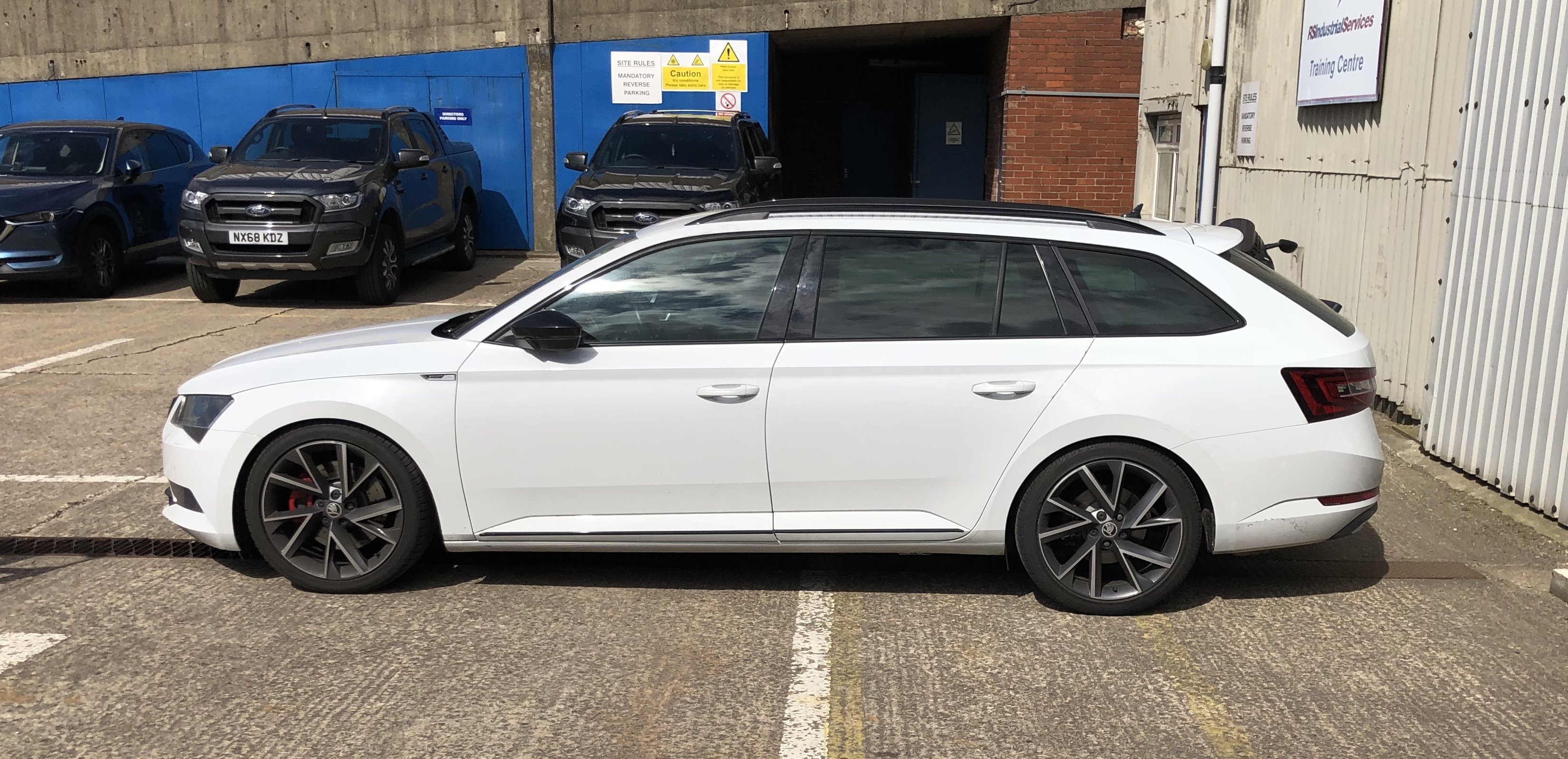

Hi all. 2019 Superb Estate (non DCC) 272 4x4 here. Have put an H&R rear ARB in already and happy with that.
Car is bottoming out on suspension (bumping) when driven fast on swoopy A/B roads, so I’m looking at tightening up the springs.
Garage is asking me if I want just springs or coilovers. I’m leaning towards just springs, not just because they cost less, but because I want a set and forget installation. It’s a still a long distance touring car and I just want to dial out some of the bounce, without introducing new problems.
Those of you with the Eibach pro kit. You still happy? Wish you’d gone for the super pro? Any other thoughts or tips, having lived with them for a while?

From what I have read, I believe springs are not the best option to adress what you're after in a non-DCC car. The DCC suspension in Sport firms up nicely and can control the car even with the shorter suspension travel provided from a set of lowering springs under most occassions but the non-DCC one being softer will probably struggle. Another reason is that the Eibach Pro-Kit is hardly stiffer than stock, they are mostly designed for reducing the ride height so don't expect the effect of an uprated suspension at all.
If I were you and wasn't worrying about looks I'd consider a set of Bilstein B6 dampers on the stock springs. No useability trade-off but a much improved body control. Otherwise if you're looking to remove some of the stock arch gap as well, B6 + Eibachs should work well together.
