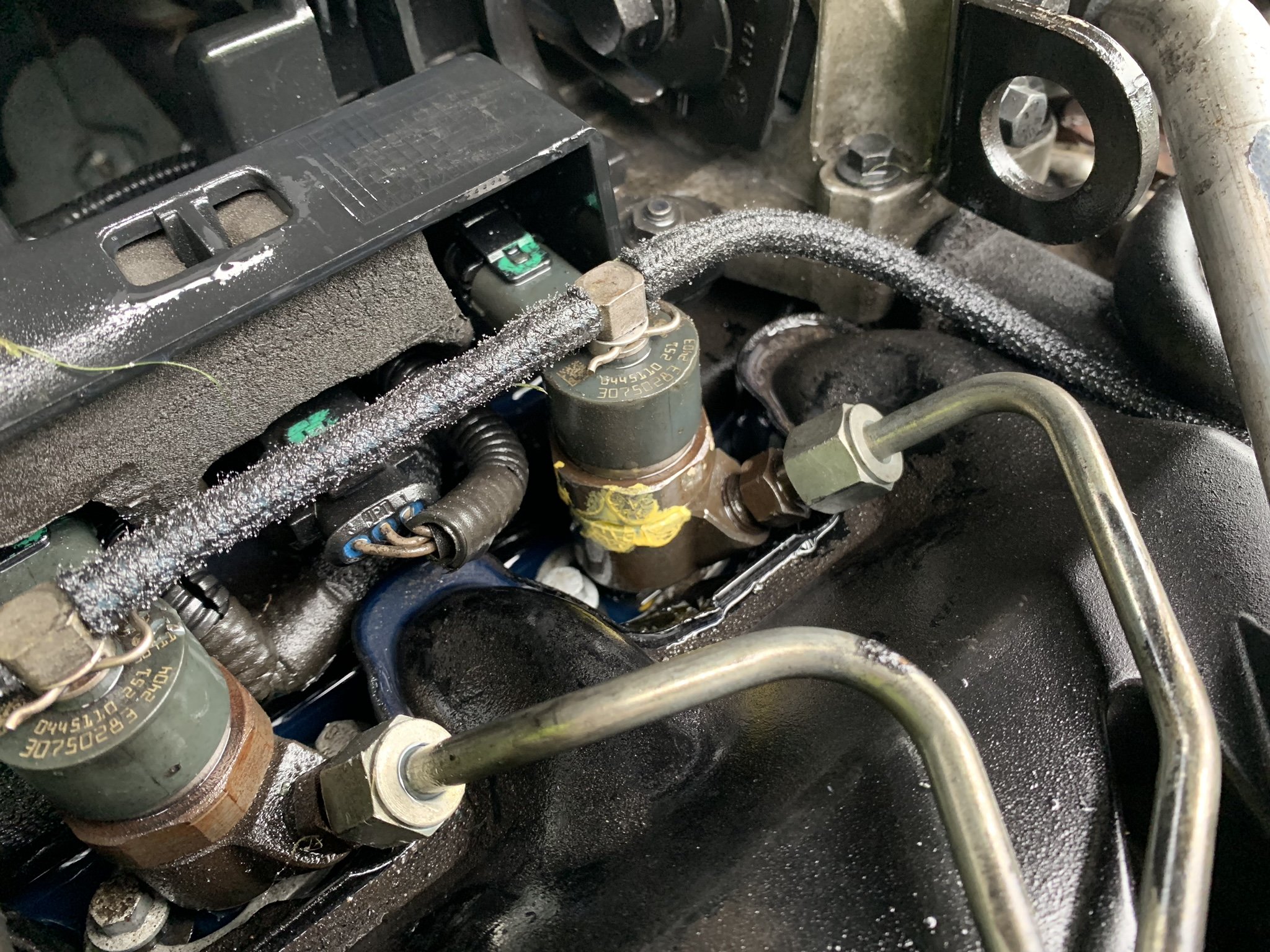

bloody cars... replaced a faulty injector, car now works, but of course its ****ing diesel all over the engine bay....
Right my next door neighbour mech, has sorted it, taken the leaking valve off the old injector, swopped it with the good valve off the old injector , reassembled it, and its all working! My main mech wanted £500 plus in parts before taking on the work.... I have paid £80 in parts for a DPF pressure sensor and 2nd hand injector, and £80 to my neighbour for his time, and we are sorted! £160 for a job that could have cost £1000! 😮
