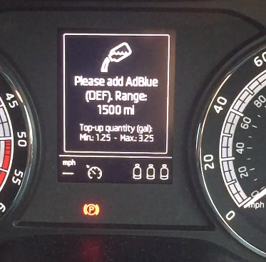

thought i'd pick brains of you guys rather than reading the squillion page manual. :)  My Kodiaq tells me I have to put ad blue in. Its' the first time it's asked. It says i have 1500 miles but I don't believe it as I've been on 2 journeys and it still says that.
Anyway can I just put the cheapest stuff from the supermarket that I find? or does it have to be special skoda stuff? And how much do I need? Thanks for any help.
Cheapest is just the same stuff as anything branded. 10 litres does a good few thousand miles so don't expect the range to count down as precisely as the diesel range. Just put in what the display tells you to put in.
Any range over 1000 will not let you fill the whole 10 litres.
I've filled a couple of times and never been brave enough to run it low. I top up anywhere between 1000 and 1500. Usually takes around 9 litres. Then throw the remainder in the tank later.
As above, cheapest is best, but ensure it comes with a filling spout.

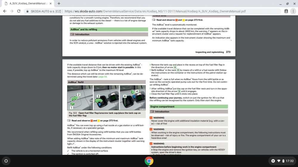

Remember when topping up the AdBlue to then have the ignition on for 30 seconds before starting the car to let the Range Register.
Page 274 of the 2017 PDF Owners Manual.

Doesn`t help always. I left the ignition on for a minute, nothing changed. Started to drive and after minute or two new figures about adblue range popped up.
Seems fine.  It was started then, 30 seconds and then after a couple of minutes drive popping up.
No biggy, you know you have in AdBlue.

Yes i just read this in the book too and am very confused!!.. :blink::excl::excl: How is it possible to even switch the ignition on on a keyless start car?  The ignition remains off when you get in the car and if I press start the engine starts.
and whet the heck is a gallon? You can only buy it in litres  ..I gotta do maths as well now. This is mucho complicated

If dsg don’t put foot on brake, if manual don’t depress clutch.

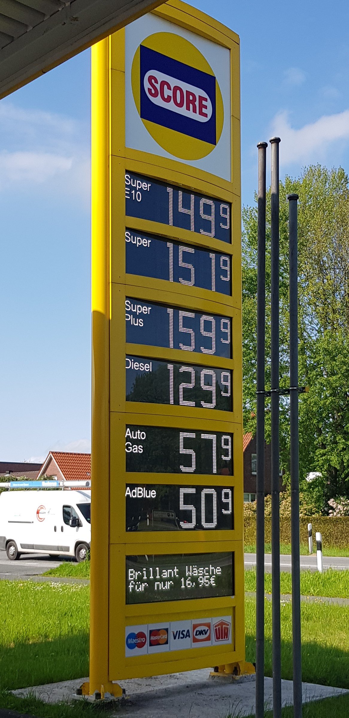

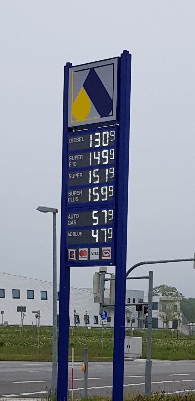

Yes, adblue is much cheaper in Europe than here in the UK. Here are a couple of fuel station prices from last week in Germany, showing prices of 0,47.9€ and 0,50.9€ per litre:
20190520_100645.thumb.jpg.621f1f720270edde909545b19af12bd8.jpg20190522_165306.thumb.jpg.b1b0b9be63b417667431792787f70f36.jpg

You can change between gallons and litres in the settings menu.
