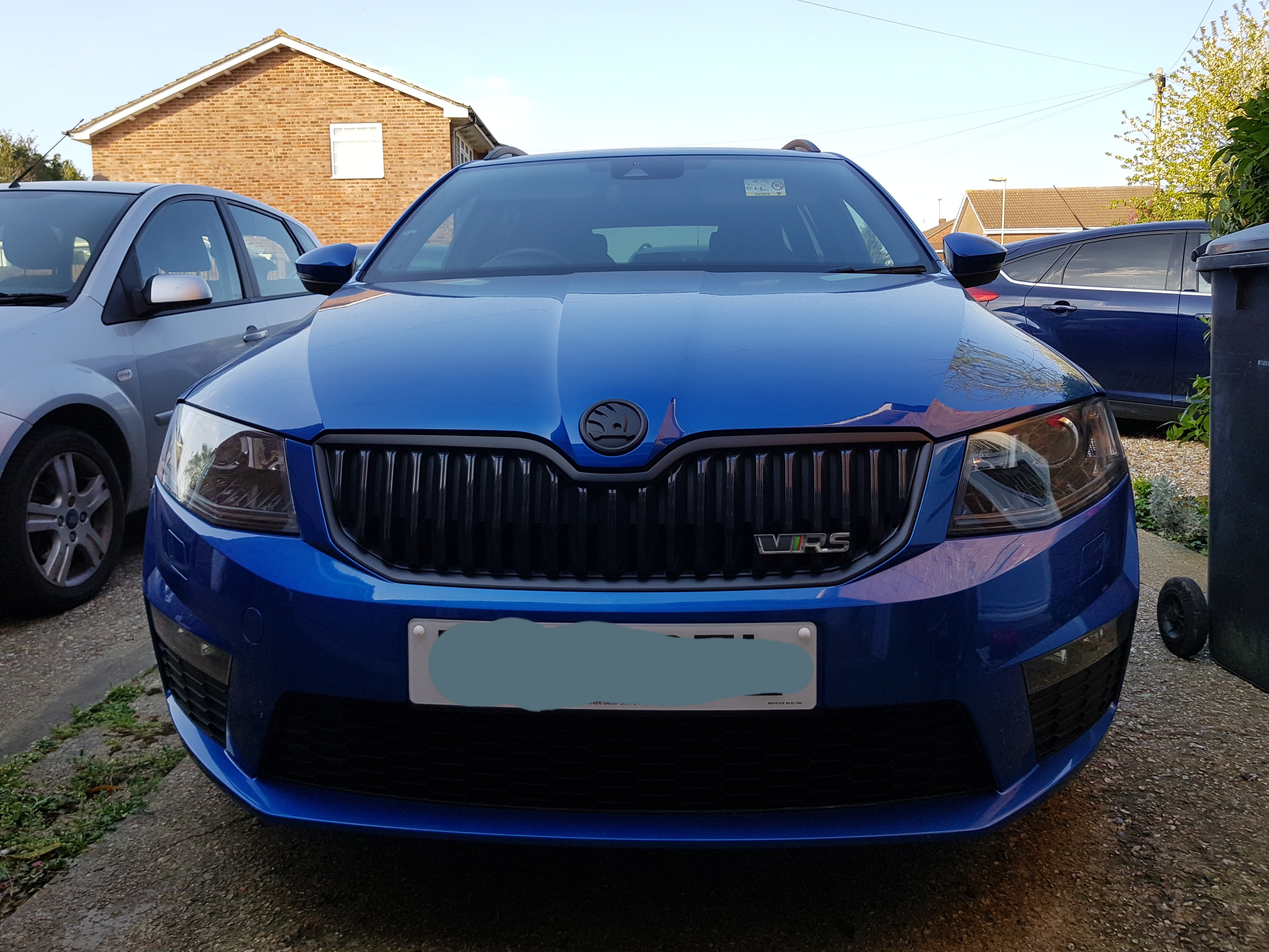

Nothing too exciting.....plastidipped my grille surround black and the skoda badge. Temporary solution until i have the spare funds for the real deal. Looks so much better black than chrome

Gave it a good polish and got a price to have the grill surround wrapped in black ,so next couple of weeks the chrome will be gone
Has anyone looked at doing just the top of the grille surround? I think it would look quite good but not sure. I have enough spare black vinyl to try it.
