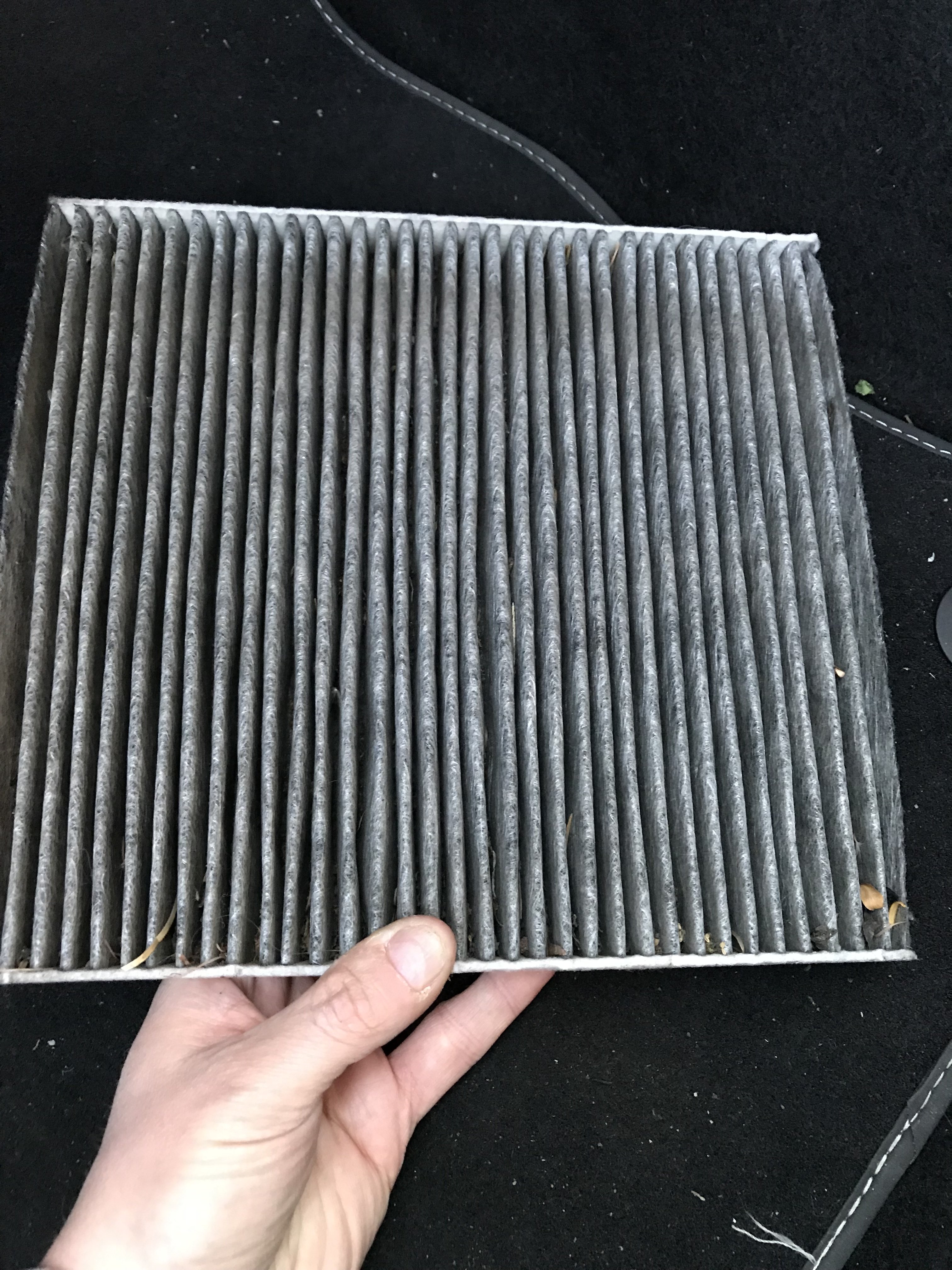

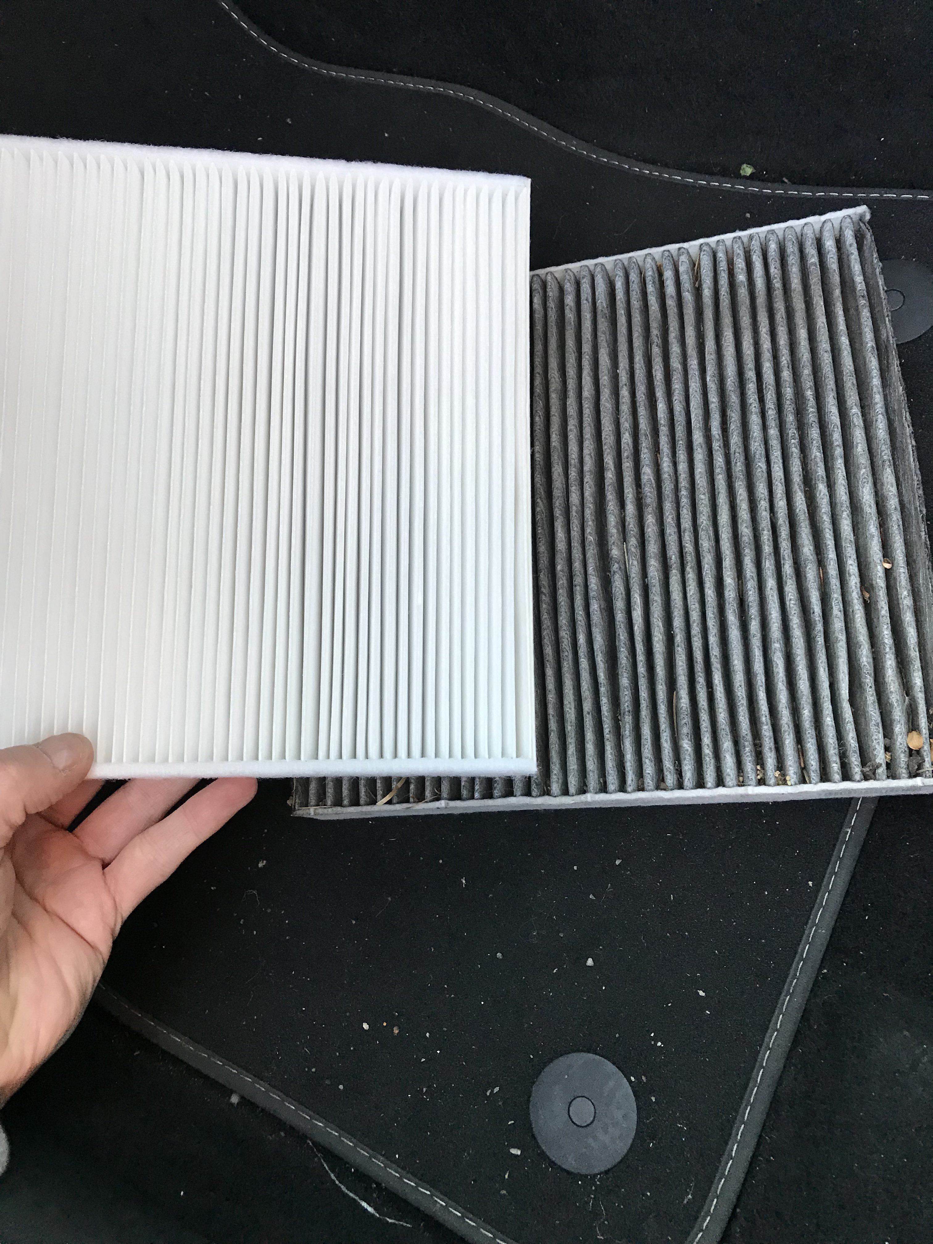

Changed my pollen filter last week. Looks like my suspicions about a pongy smell were correct. A lot better now.
That's not a dirty filter it is a carbon filter. I'd replace it with another carbon filter as it greatly reduces smells entering the cabin. The white filter will just stop dirt and bugs coming in.
@SkodaKingThis is the cabin/pollen filter housed in a small tray behind the glove box. Are you saying the carbon filter slots into the same place but carries out a different function? Thanks
As SkodaKing mentions there are two types of pollen filter, the paper one as you’ve bought or the activated carbon version that you have removed.
