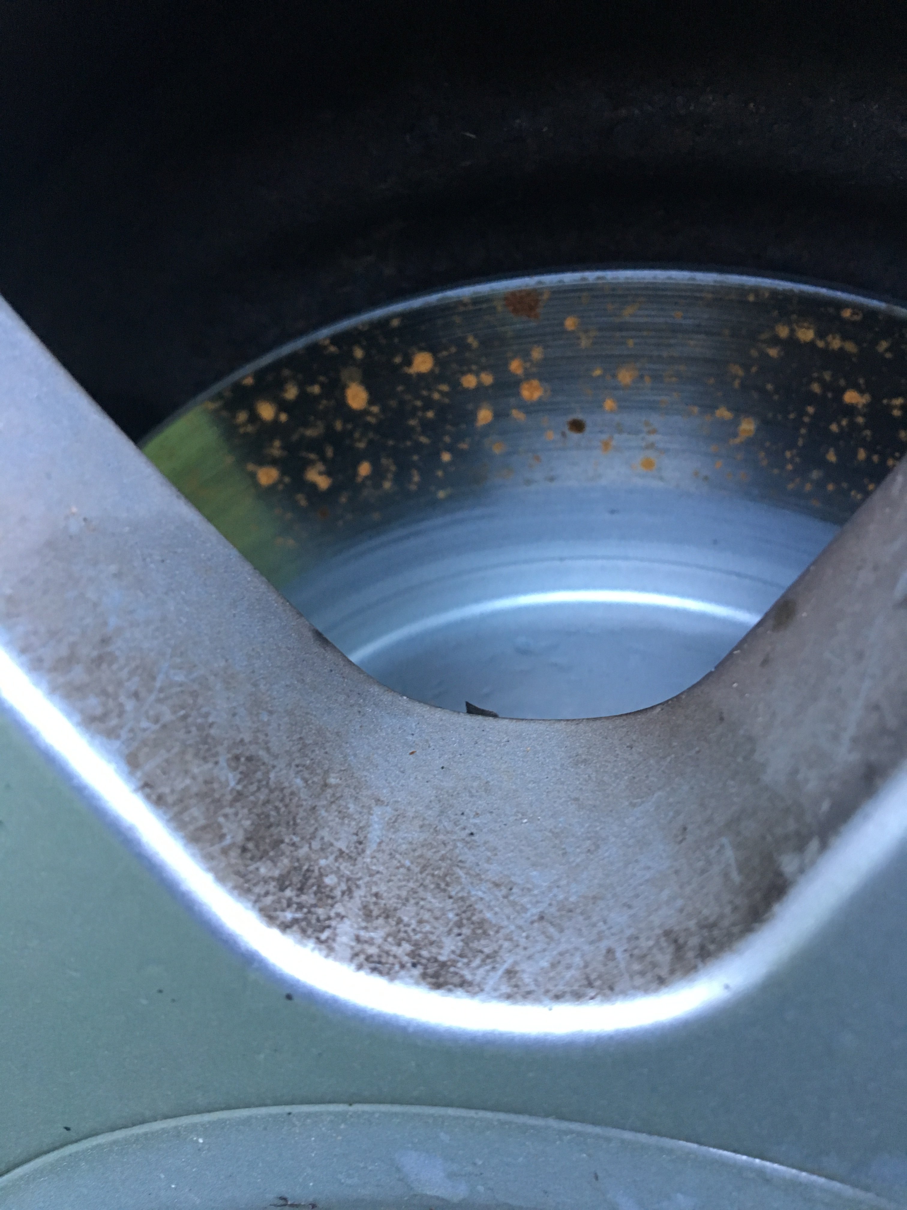

Just a side note. One of the discs had a whiteish mark on it after my first drive ( didn’t check before leaving ) I’ll attach it. Does it look normal?
That’s just the protective coating being worn away as the pads and disc bed in.

Your photo of the discs don't look right to me , If the pads are fully in contact  with the discs then they should look evenly marked over the full face ,. Either wrong pads, too wide and the edge catching on the disc hub,  or right pads jamming someway as they don't seem in contact with the inner face  of the disc. If they  were  just were needing bled then it would show mark over the whole disc face.
That’s what I thought... the white area has decreased now though. Not fully though. If i have to take it back to the garage this week I’ll mention it. It’s only like that on that one wheel
