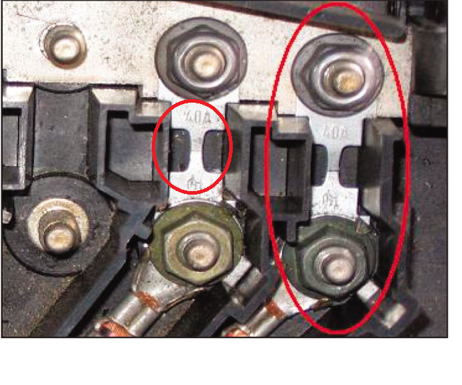

Have you checked the strip fuses on top of the battery? They can develop tiny cracks that can make intermittent contact and could conceivably be affected by temperature.

I have checked the battery strip fuses, again all appears as it should.
