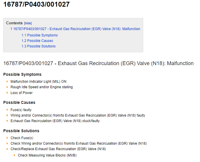

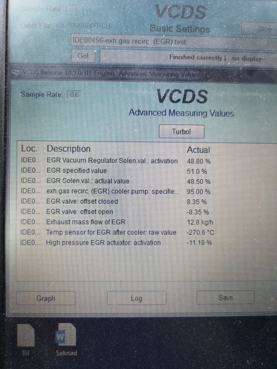

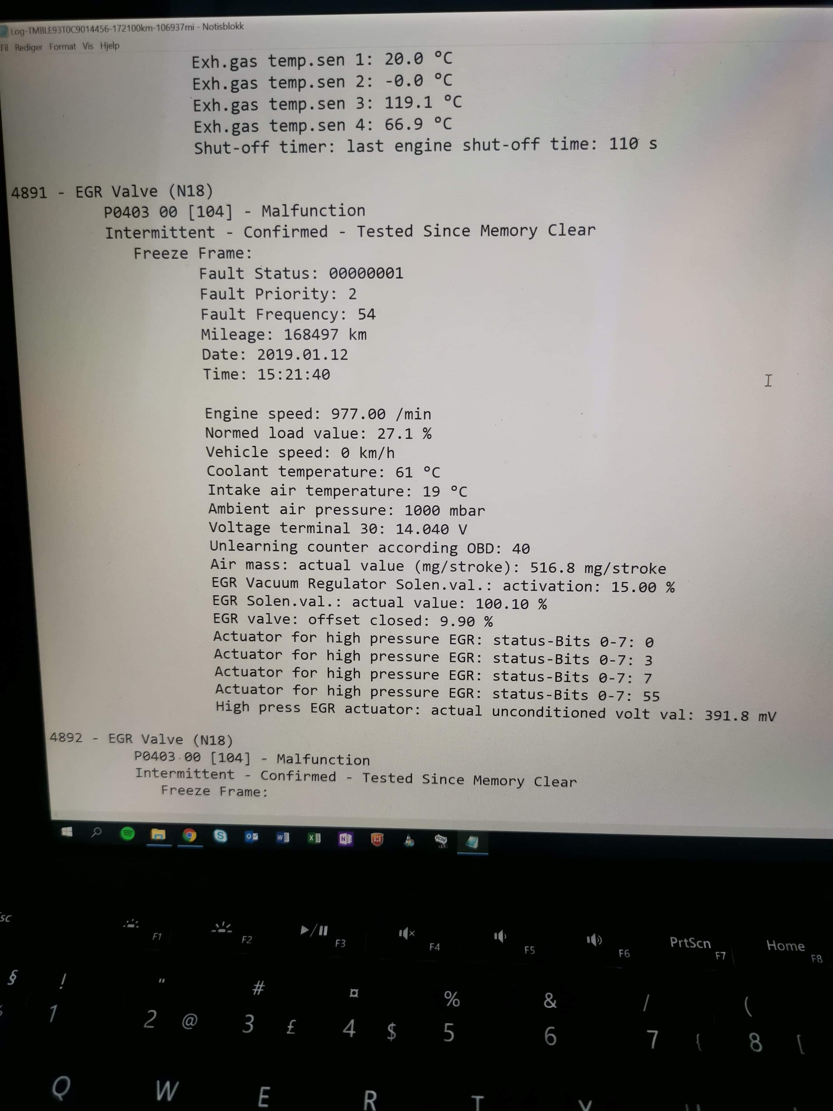

Hi! New in here, and got some trouble with my wife's Superb. Got the motorlamp in the dash, and the lamp for the glowing starts blinking after som driving at low speed, and then the car goes in limp mode. At the highway the car don't goes in limp mode if i drive in 80km/t. Got some faultcodes from VCDS, that says malfunction on EGR Valve N18. Will post picture of this code, will post some pictures of the values on the egr, after i take some test on the valve today. Sorry for my bad english, but hope you guys understand!
