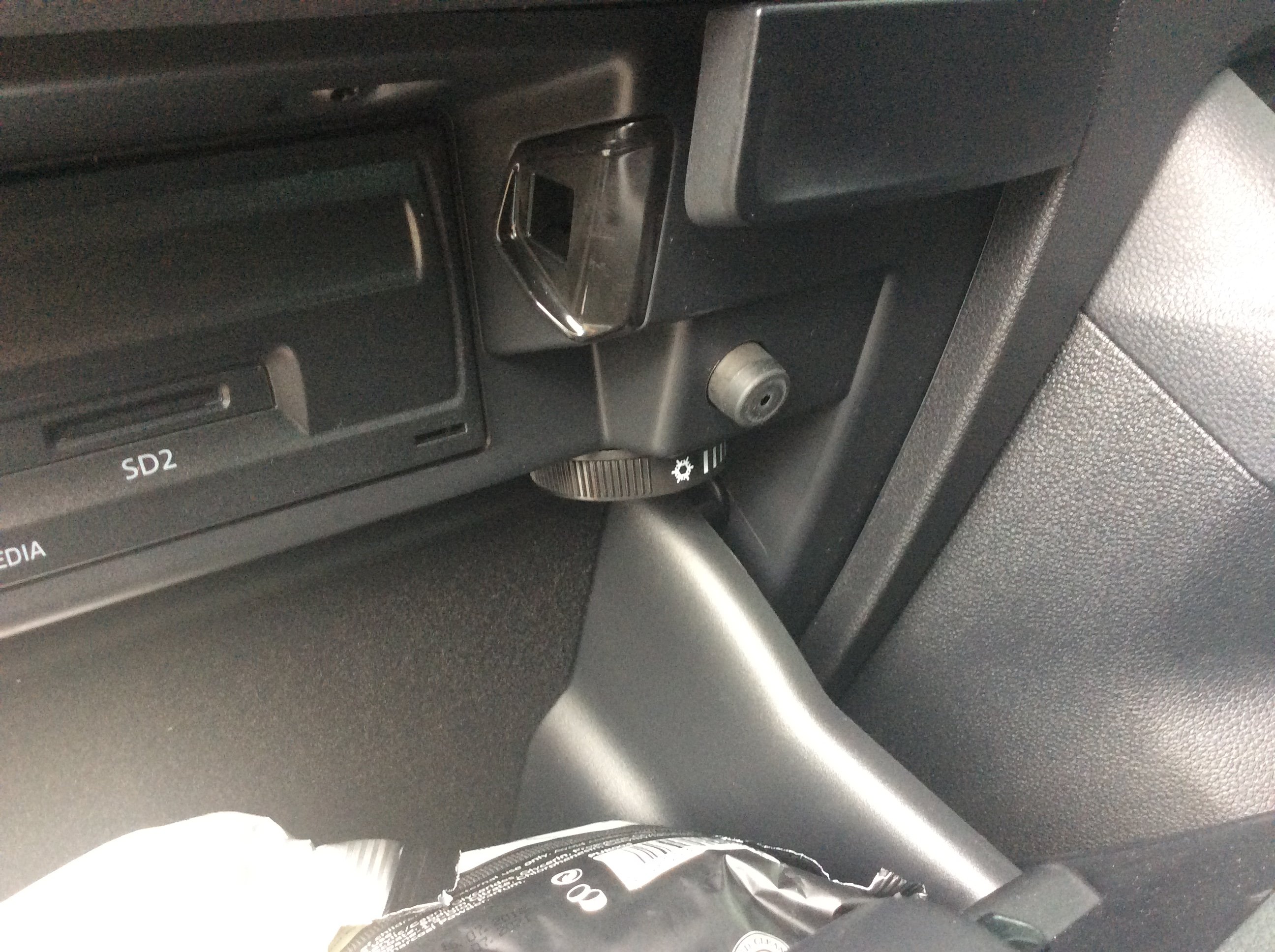

i was wondering if you just might be able to help me out with another query.
in the glove box at the front and on the right hand side is a vertical control know with a graduated scale of 0 to what I think is a frost guard symbol. I can’t find any reference to it in the hand book.
I don’t want to ring the show room again as i’m Sure they must think i’m A bit thick.
please see the photo
msny thanks in anticipation.
This supplies air to the glovebox to cool is - so frosty setting is probably coolest (cool your drinks can (if you can fit one in)

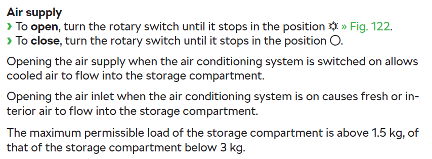

That last line...'The maximum permissible load etc....'
Lost me!
That makes two of us, or does it mean between 1.5 and 3kg? Who knows!
Both the slovenian and italian editions say "The maximum permissible load of the storage compartment is 3 kg."
The figure 1.5 doesn't appear.
Edited by agedbriar

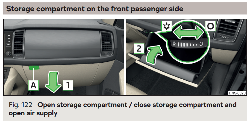

The picture is of a Kodiaq which has an upper and lower glove/ storage box.
So 1.5 kg limit for upper box and 3kg for lower.
Yes, sorry guys, I used the text from the Kodiaq manual instead of the Karoq, knowing that the air conditioned glove box nozzles are identical.
The glovebox arrangement however is different...
