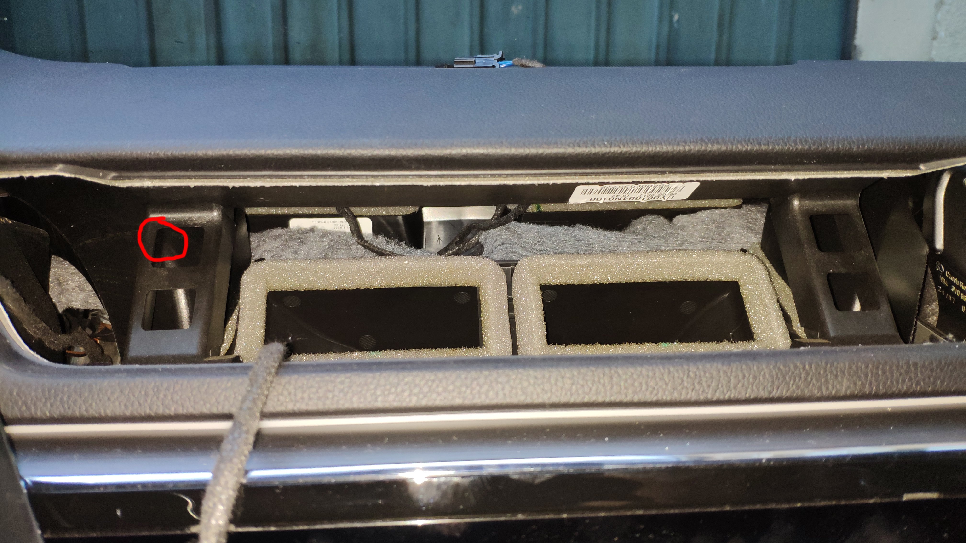

I’ve had those 2 grills off on top of the dash and I don’t have a speaker there. I take it you only get the speakers if you have the upgraded stereo. I couldn’t see anything obvious. I did put some felt around the sensor that sits in one of those plastic vents as there was a little bit of play when the sensor was seated but it hasn’t stopped the vibration. Listening to it it maybe under the dashboard near the instrument cluster. I know it don’t stop the car functioning but it’s so annoying.

When the vibration occurs have you pressed down hard on the speaker and vent cover on top of the dash?  (Push down and towards the windscreen).
I have a vibration around this area and it's definitely the speaker/vent covers.  I've padded them out with absorber foam and felt but when it get's really hot there must be enough expansion to cause the surfaces to just come into contact.  I'm going to remove them soon and really go to town with the 'padding'.  Like you say, it's not affecting functionality but it's annoying as hell!

I’ve used the car for about a week with those panels removed so it defiantly isn’t them. I thought it was. But I took them out of the car.  It only does it when cold so obviously every warms up and expands the noise generally goes away. Not every time but it’s certainly less pronounced. I’ve attached a clip of the noise just so you can hear it.

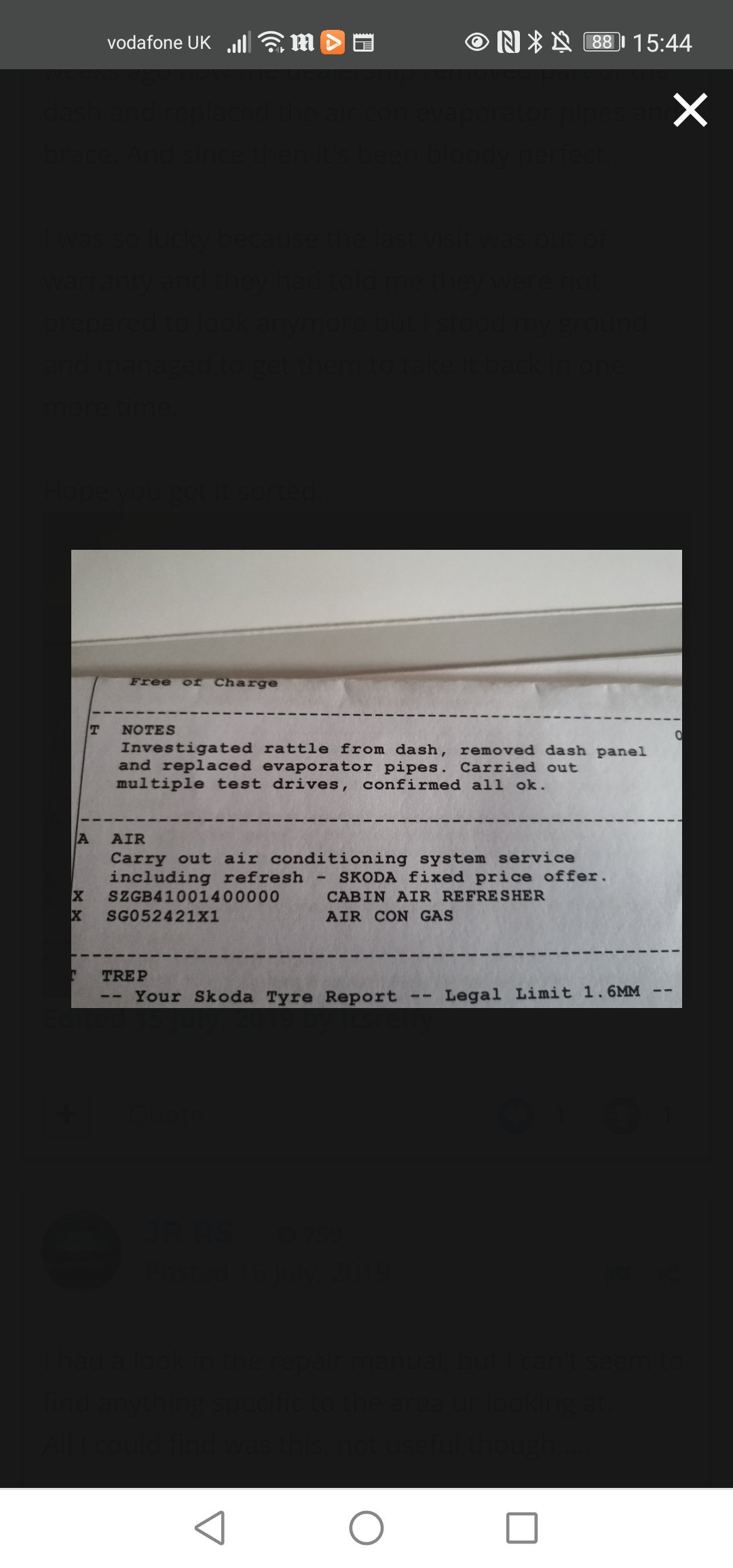

I remember they had to remove the top of the dashboard and all the vents, and I was definatley told a brace was replaced. But what it was I can't recall.
I thought I put it in a post on here but I can't find it now.
All I'd say is keep pressing them because I did and mine was actually fixed by skoda outside of warranty. So I got lucky.
It was the evaporator pipes they replaced, but I think they replaced what holds them in place too.
