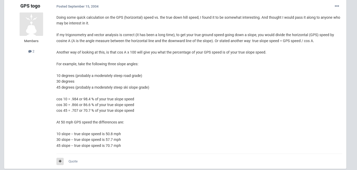

I knew the mathematics, I knew the Cosine Theta error would be small on most road gradients, I also knew that anyone that speaks of anything being "spot on" or "margin of basically zero" would neither know nor understand so I was happy to leave it unexplained and them blissful.
It was amusing to be told that I have issues with elementary maths though 😁

Yes, looks like it. Some can explain things, some can only mouth.
10% slope angle corresponds appr to 5,7 degrees. So, 10 degrees correspond to 18% slope angle. I have been travelling all over Europe, never seen this kind of a gradient. I have a 7% downhill near my country house and this seems like diving straight down.
If I remember correctly, the max slope can be 15% in Europe and modern roads are built using max 5% slope. Steepest road in Europe is in Norway and has 20% slope.
What we are talking here is that in real life the slope error can usually be 0,1 - 0,2% of the speed.
So, driving at 90 kmh the max slope error will be 0,18 kmh.
Conclusion - can we trust GPS readings on down- or uphills? Yes, we can.
