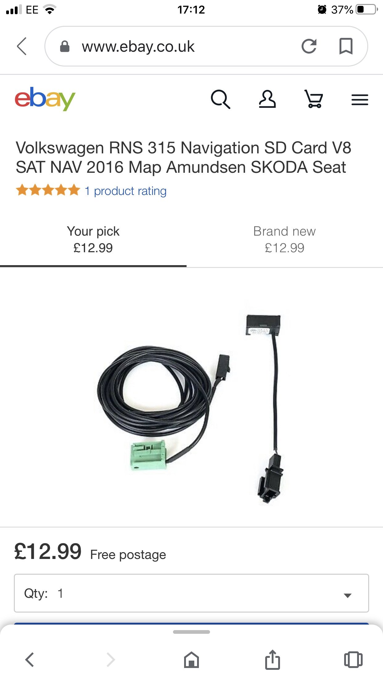

Hi I think I'm losing the plot fitting a Amundsen+ can anyone tell me on the phone function does the Amundsen have a built in mic as i can make a call but they can't hear me ?
@Chickenlickin - there is no microphone builtin to the Amundsen+ (RNS-315), you'll need to add one :)
Thanks but where do you connect it to
To the two mic pins on 'connector c' of the quadlock.
Is that a dedicated plug setup is this the item ?
I fitted this item and found the voice problem persisted - I also noted that the cut-out for the microphone was on the passenger side.
I wonder if this is a VCDS settings issue?
Has anyone been able to sort the problem ?
If BT isn't enabled in the headunit, it'll need turning on but after that point, it should just work assume the mic is correct and wired in to the right pins. If it doesn't work, find a local VCDS user to check for fault codes and go from there.
