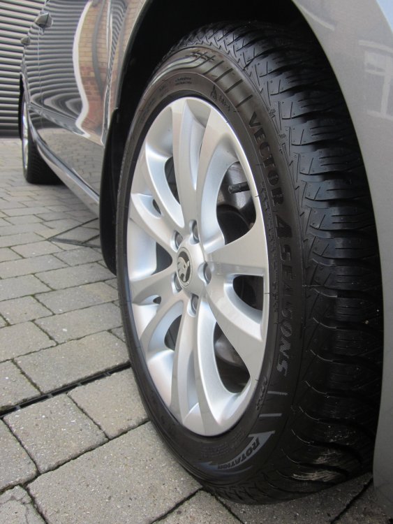

Just don't ever try and switch to using all-season tyres as there's literally a choice of two in this size.  😕

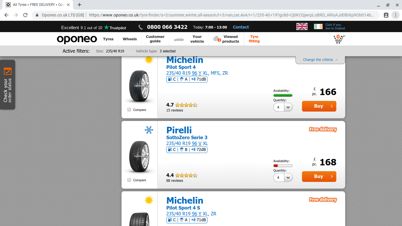

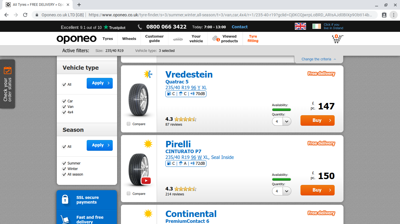

I’m paying £150 a tyre fitted for P7 pirelli
Why? Have you used them before?
Serious question.
Interesting choice, I have P7s which came on my car and want to change them.  Fine in the summer, but dreadful in cooler weather of autumn until April mornings, hard and not grippy.
What do youlike about them, or do you run separate set of winter tyres?
Vredestein Quatrac 5,
not expensive and work rather well in the conditions that they work well in. Just a mater of what you want.

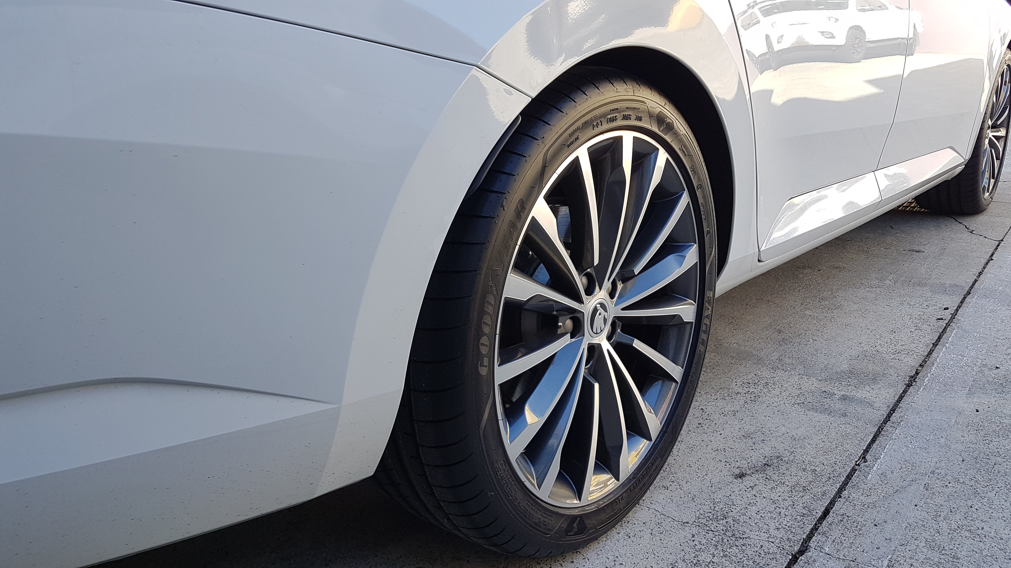

Finally got mine on yesterday; Goodyear Eagle F1 Asymmetric 3 245/40R19 98Y XL
Cheers........any chance of a full side on photo of the car on these tyres.
Will the different size cause any problems with the cars safety systems??
I will try and get another pic up soon.
As for the cars safety systems, I have the full suite... and no issues what so ever!
