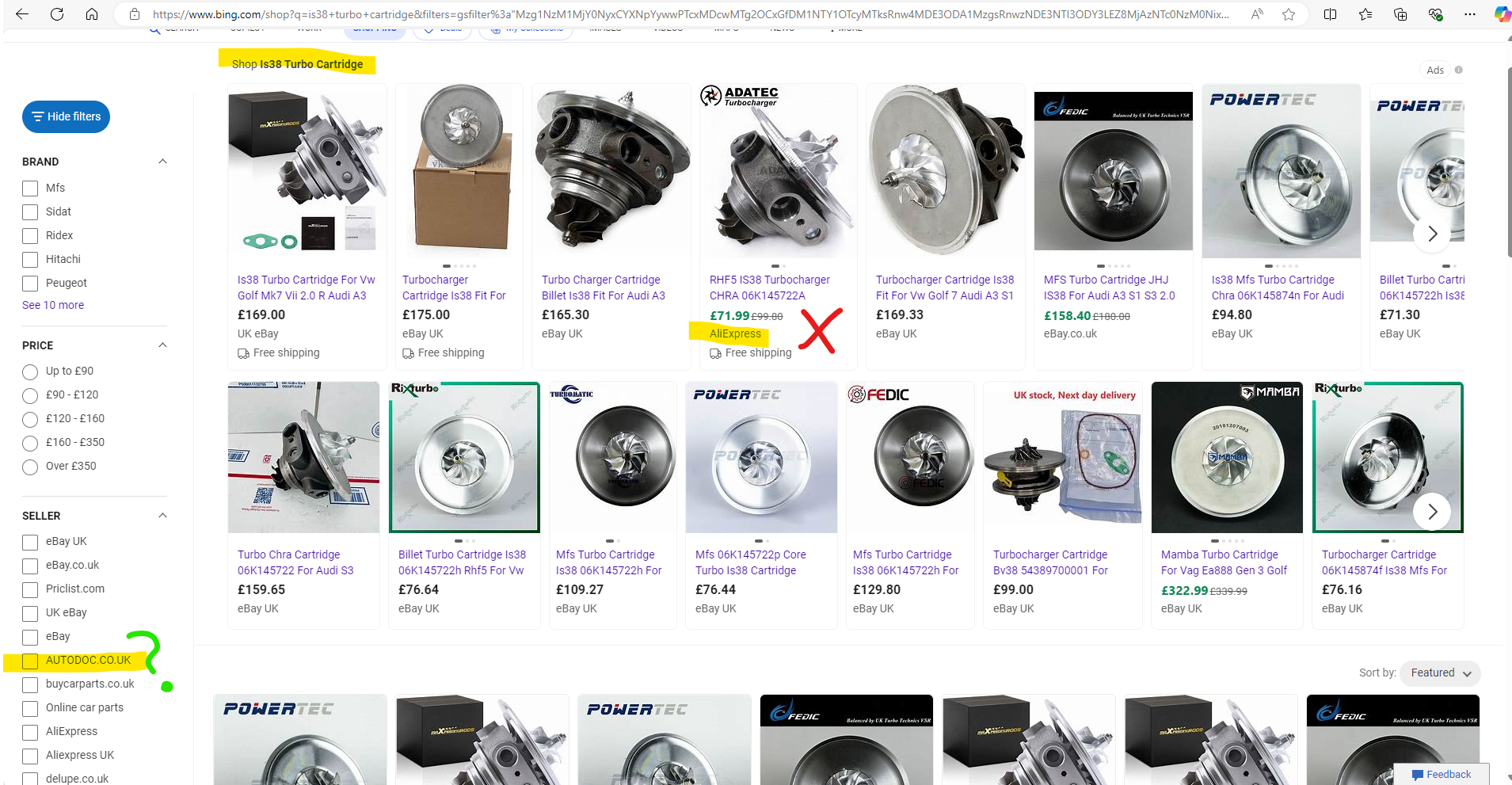

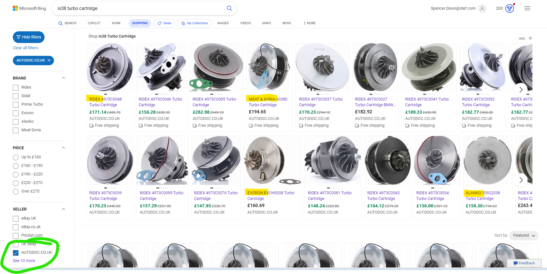

Look at an internet search for IS38 Cartridge.. They're obviously churning them out in China and I'm guess quite a few of the sub £100 ones on eBay are probably from China too..
But AutoDoc are offering Ridex, Evoron, Alanko, Meat & Doria.. Never heard of any of them but if AutoDoc..  I trust them 🤔
image.thumb.png.7a49d9f024de9fe485d935146fdd246d.png   image.thumb.png.3a06c9769ab0c84d46db7830f28eb070.png
There has to be an element of unknown I guess for all those manufacturers that make stuff for others. I knew a company called AB Automotive who made a part, which then got shipped out to US to be incorporated into the brake light switch for some Ford trucks. No-one would have hear of them and not known their pedigree I suppose. You'd hope Autodoc do their DD on suppliers...
Meat &Doria is a well-known brand of aftermarket and equivalent to OE parts, also they have been around since a while, but while I know for things such as fuel pump, I would not know for a turbo core ...
In your case, as you want to keep going stock, I would look for a reputable turbo builder in your area and have them refurb your unit, or swap for a refurb unit wich exchange. Buying online who knows what might work for cheap, but assembling together a turbo is little above average wrenching, and if something goes wrong you got the inconvinience to prove who or what was at fault. To each its choice ...

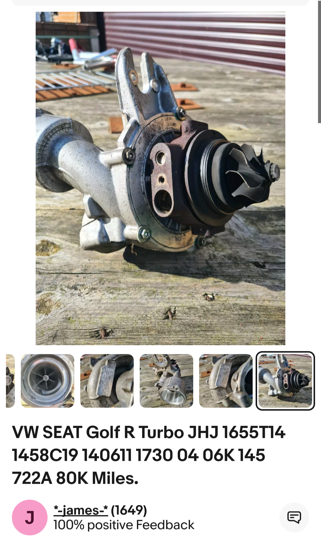

Bit of an update.. I've taken a punt on a used IS38 off a 2014 Golf R with around 80k miles on the clock.. only £100 so worth a punt. Still haven't decided whether to just keep it tucked away as a spare just in case or crack on get it refurbed.
My thinking is, I do want to remap my Superb 280.. I just haven't decided on the map.. some of them might be more aggressive on boost than others.. will my 100k miles turbo survive? Wait and see? Or pre-emp it?
And if I do refurb this spare one.. standard back to OE refurb.. or try and get some improvements (without going silly on cost) 🤔🤔🤔

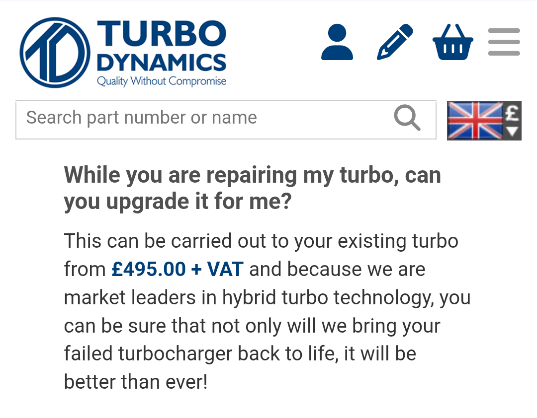

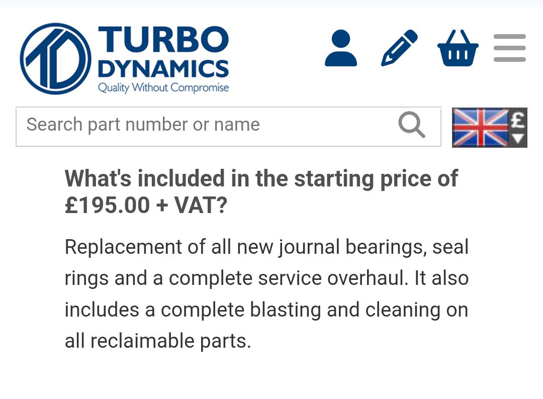

What I'm hoping to find is a turbo specialist who offer different levels of rebuilt.. new core and refurb to OE, refurb with design flaws improved on.. stronger basically and maybe a rebuild with tweaks.. bigger, faster, bit more boost.. I dunno.. will have to see what's out there for sensible money.
Here's a local'ish option..
Refurb to OE or upgraded optionsScreenshot_20250216-2100252.thumb.png.67ae08e22ab0c21834ee8237ff183d6d.png.. I'll have a chat with them and see what's what 🤞
