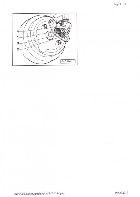

ok i give up, have a 2008  4x4  6 speed estate {ex police}  where is the brake light switch?????, have checked around the pedal nothing, have looked and felt around master cylinder,with great difficulty i might add, again no switch to be seen,
any ideas
It is on the master cylinder it has a 4 pin connector and bolts onto the front of the master cylinder

believe me there is nothing bolted onto this master cylinder, unless it is cloaked :-)
That's from the dealer manual

Surely the brake switch is at the far end of your brake pedal under the dash!? It activates when you push the brake pedal, the other side of the pedal comes away from the switch....
On the MK1 it was, but for some reason they moved it to the MC on the MK2
Not all models. Mine's a 2005 2.0 Tdi Elegance and the switch is on the pedal assembly.
