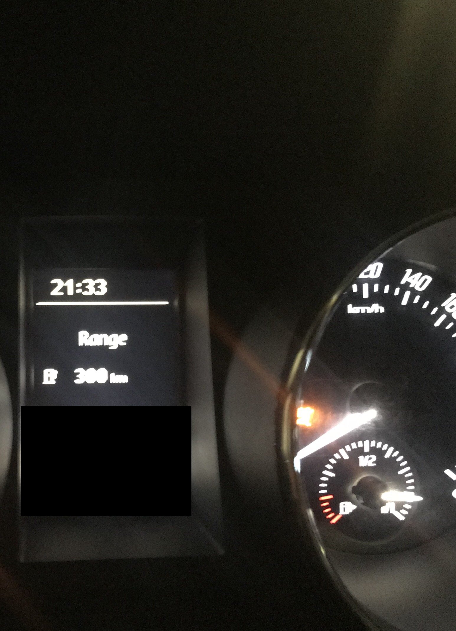

Is this normal for a 1.4 TSI. Range vs Fuel tank meter? i have attached a pic
If there was about 40 litres in the tank at that point the range of 300 km would mean you had been getting pretty poor economy at that point.
But is the fuel tank 45 or 55?  I have done 65km so far.

The algorithm used to calculate Range is heavily biased towards most recent driving style. So can vary wildly depending on where you are/how you have been driving. Don't worry about occasional variations. Do worry if you run out of fuel early...
Fuel gauge tends to stick at full for some time in my diesel. Hence have used a lot more fuel than you think by the time it indicates at that position.
The gauge is not linear. The range is dependant on how you are driving and what type of roads you are on

300 km is silly low even if you drove it like you stole it.
Thnx. I will test it this time until gas runs out.
No worries I’ve never seen a range that low with the gauge where it is in your picture.
Thats why i got concerned. Its been few days i bought this car. Since the clock spring it not working i am unable to check the other menu settings within mfd
Yeah even if you drove it hard all the time you’d never see that. 65km from full our gauge has not even moved.
