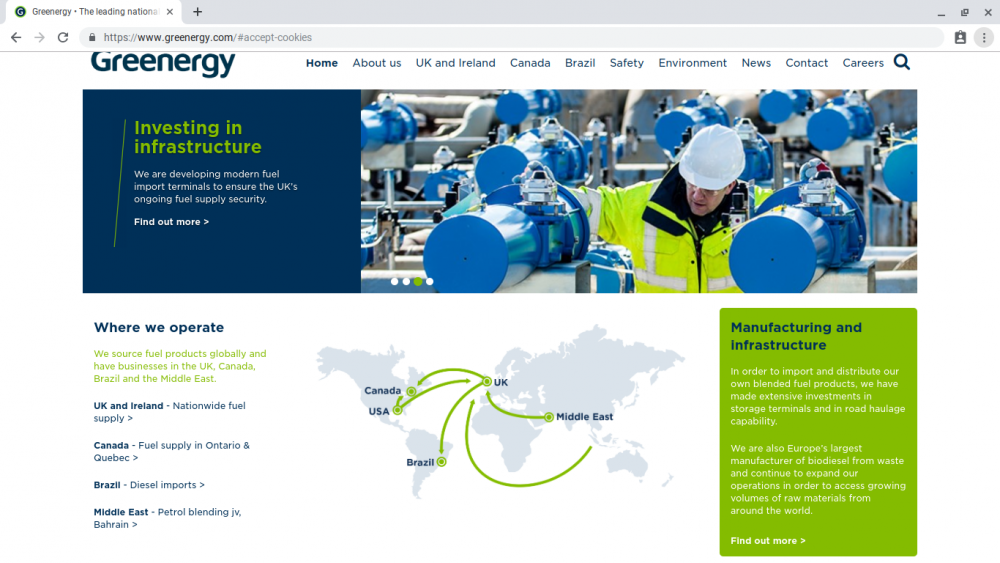

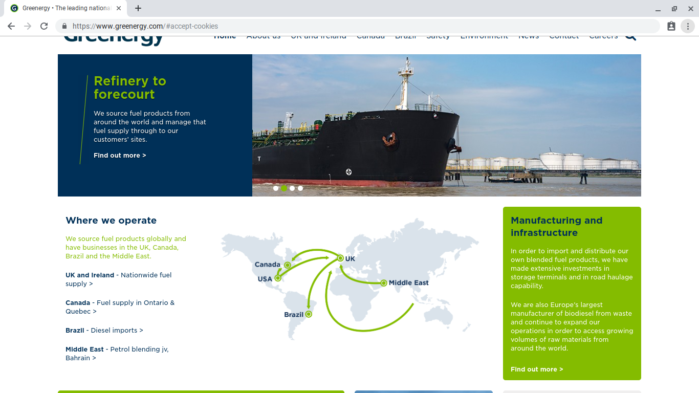

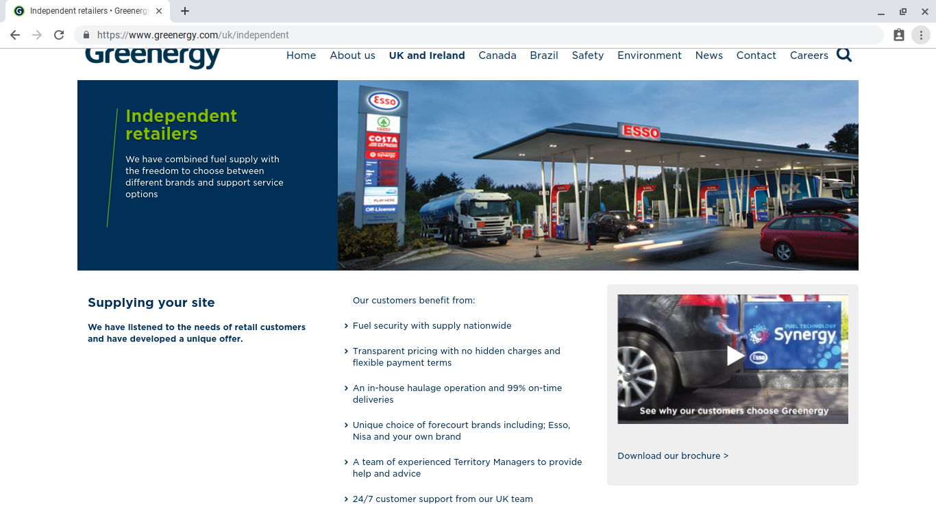

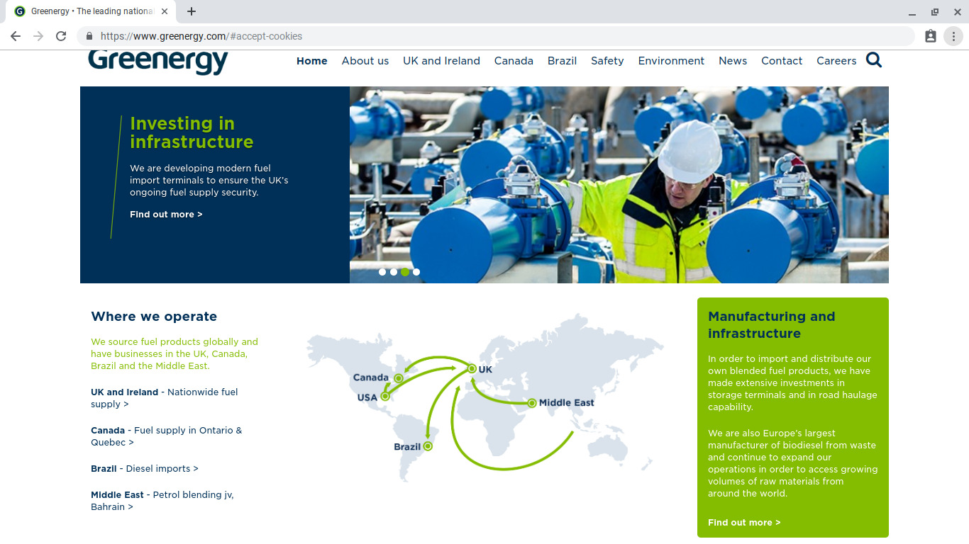

Where do Morrisons source this crappy Derv, and is it available to other retailers of crappy Derv?
Is there some back street hooky Fuel Depot filling Fuel Tankers that are going to Supermarket Filling Stations?
There is pretty strict legislation covering the specification of all fuels produced and sold in Europe which is backed up by random testing of retail sites and the last figures I saw suggested that the failure rate was very low. Admittedly only a low percentage of outlets would have been subjected to an independent test.
I think the difference between various fuel brands is overrated. There are a lot of people who buy Panadol because they consider it better than generic paracetamol. Marketing is a wonderful thing 👎
I would have thought that the high turnover of fuel at supermarket outlets means that they are less likely to suffer from 'stale' fuel than say a small, remote, low budget independent outlet.
I do know of at least two separate incidents at small outlets in our Australian Northern Territories where polluted fuel caused hundreds of diesel engine failures. I'm pretty sure it was the local retail storage facilities and not the deliveries that were the issue.  It is a bit more a 'frontier' region with a typical tropical climate and only ~250k people in an area about six times the size of the UK.
Edited by Gerrycan
Own Brand Fuel at Supermarkets in not like Home Brand Digestive Biscuits or Baked Beans.
So much snobbery without knowing what arrives from where with what additive packages with diesel or petrol.
