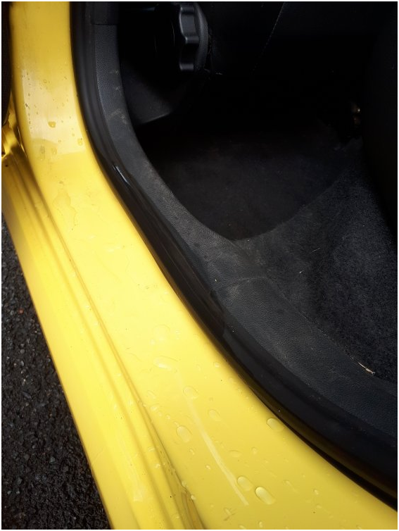

The main issue beyond the cylinder head are the surface rust covered sills, I hope they are not too far gone.

The door seals are a well documented and easy fix, do all four doors with plumbers gold and they shouldn’t need doing again for years and years.
Get some pics of the sills up if you like? Again if you have the time you can prep these well and get them painted properly or you can do a DIY fix if you’re that way inclined.

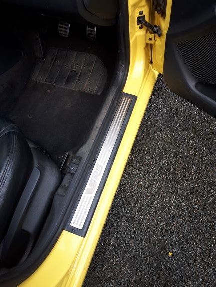

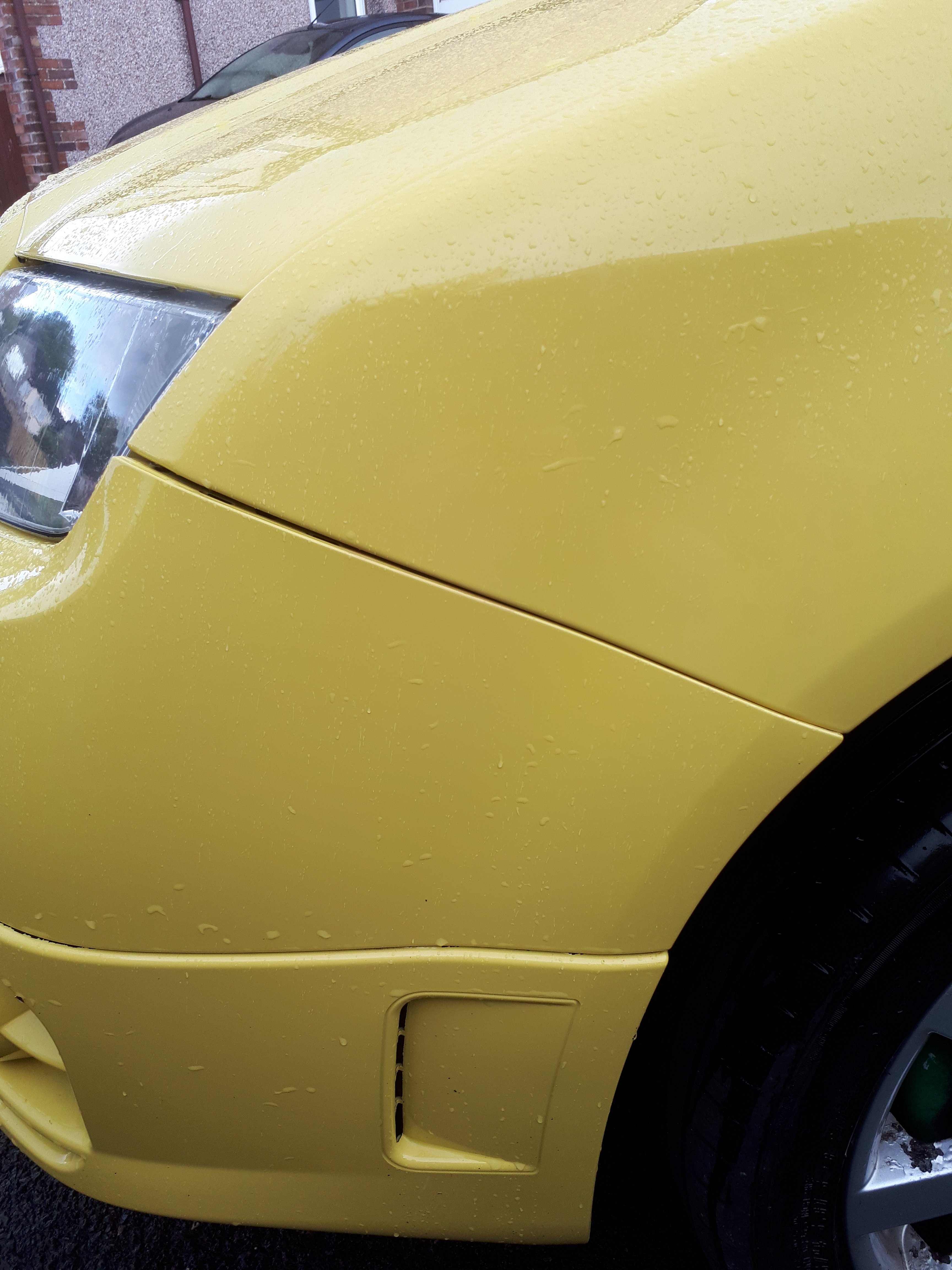

Just a few photos on various issues wit the body work, poorly aligned bumpers, rusty sills and not sure what my Son has done to the wheels, good job he bought a replacement set although they are not refurbished as yet.
I know it was an immaculate car when he bought it with full skoda  history and one owner.
The drivers door stay sounds terrible when opening and shutting the door, loud cracking noise, the other three are silent in operation so that has to be changed.

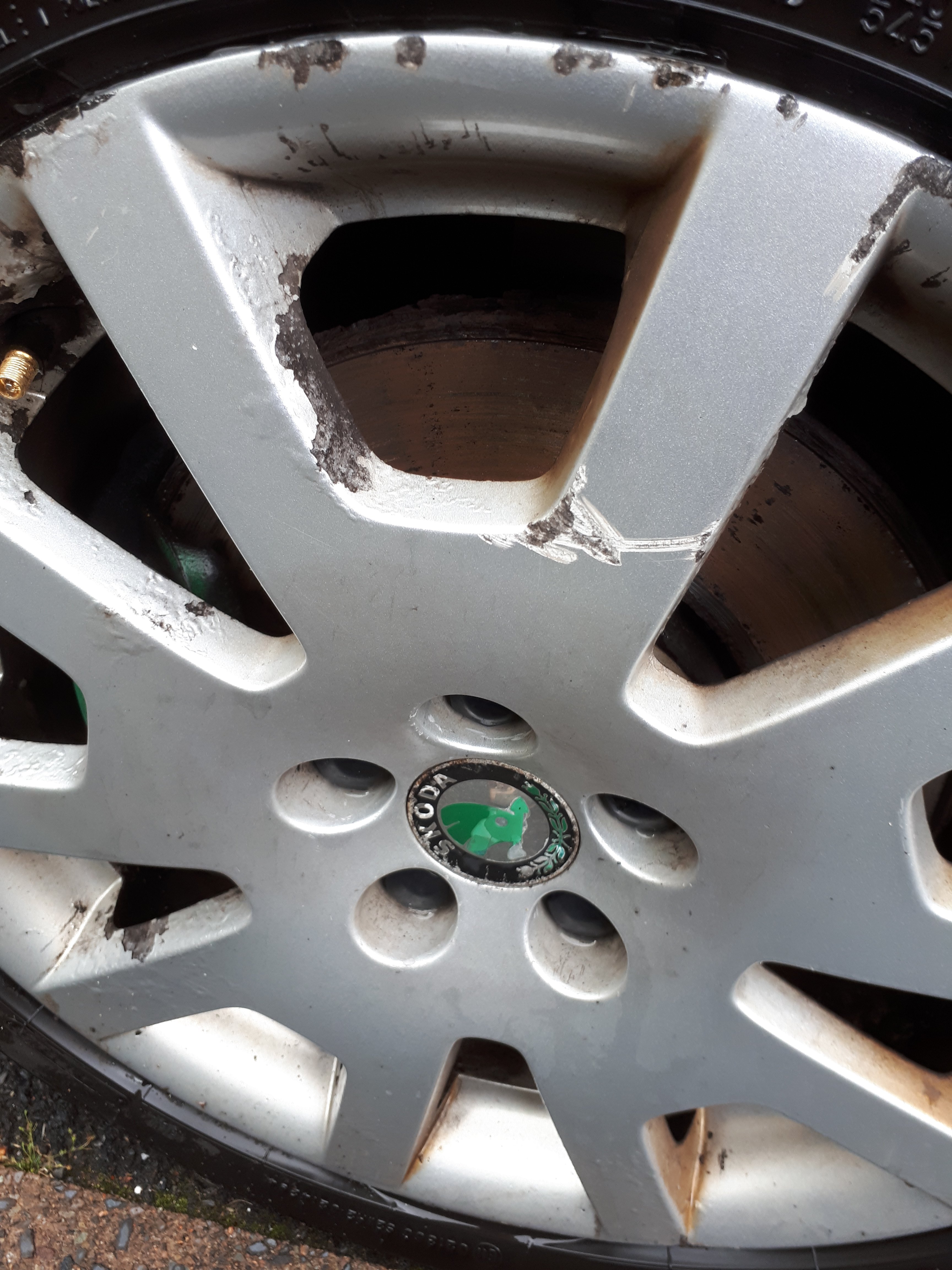

Be warned the wheels are it a terrible state.
More pictures

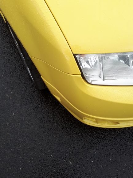

If anyone can advise that the bumpers are adjustable on the support brackets as I have no idea, not had any free time to do anything as yet, only to report on things that require sorting.
I have noticed a few VRS bumpers appear to sag down and have no gap against the lower edge of the wheel arch.

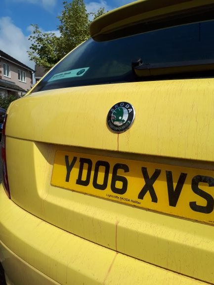

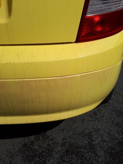

Decided to get some clay bar time in, working on the back of the car and after improving the surface I found it was still left with minute raised bumps which were rather strange looking.
Out came the tar spot remover and whilst a few bumps did dissolve I was still left with these mysterious ones and I mean lots .
I then left that job and cleaned the off side door shuts and door insides, unfortunately no before shots but they were in desperate need of sorting, under the drivers door and on to the sill vrs plate was an unsightly tar like stain which took ages to remove , looked like black paint and not tar.

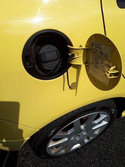

Then I looked in the filler cap to find a considerable gungy mess from spilled fuel and attracted road film.
Anyhow all cleaned up nicely but unfortunately the filler cap rubber/plastic tail parted company with the cap as I wiped it clean.
I took time to research the strange bumps on the paintwork and found it may possibly be metal spot contamination so I ordered some Korrosol and that had the desired effect but required two applications and careful agitation second time.
Lots of bleeding as you can see.

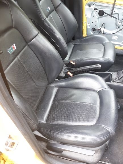

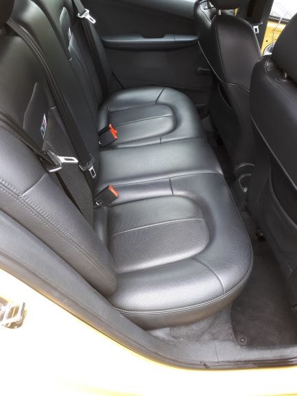

Just another question for anyone who may know, the car as bought by my son had the leather interior which is in vey good condition in fact the rear seat  doesn't look as its  seen much action if you know what I mean.
Was it a factory option or do you thing its a re trim, not had time to clean the interior as yet since I got the car.
Oh and no photo of roof spoiler as yet.
Martin
Car looks nice, re the leather seats, I know back in the day Seat Surgeons in York were a forum sponsor and doing some good deals on reupholstering seats.
Hi mdk1, interesting what you mention about the seats possibly being re upholstered,who ever did the work they made a very tidy job.

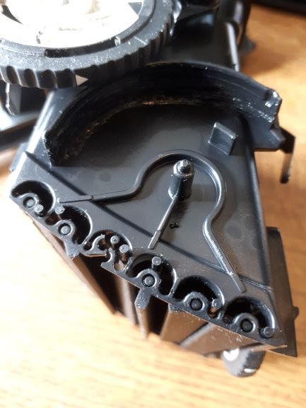

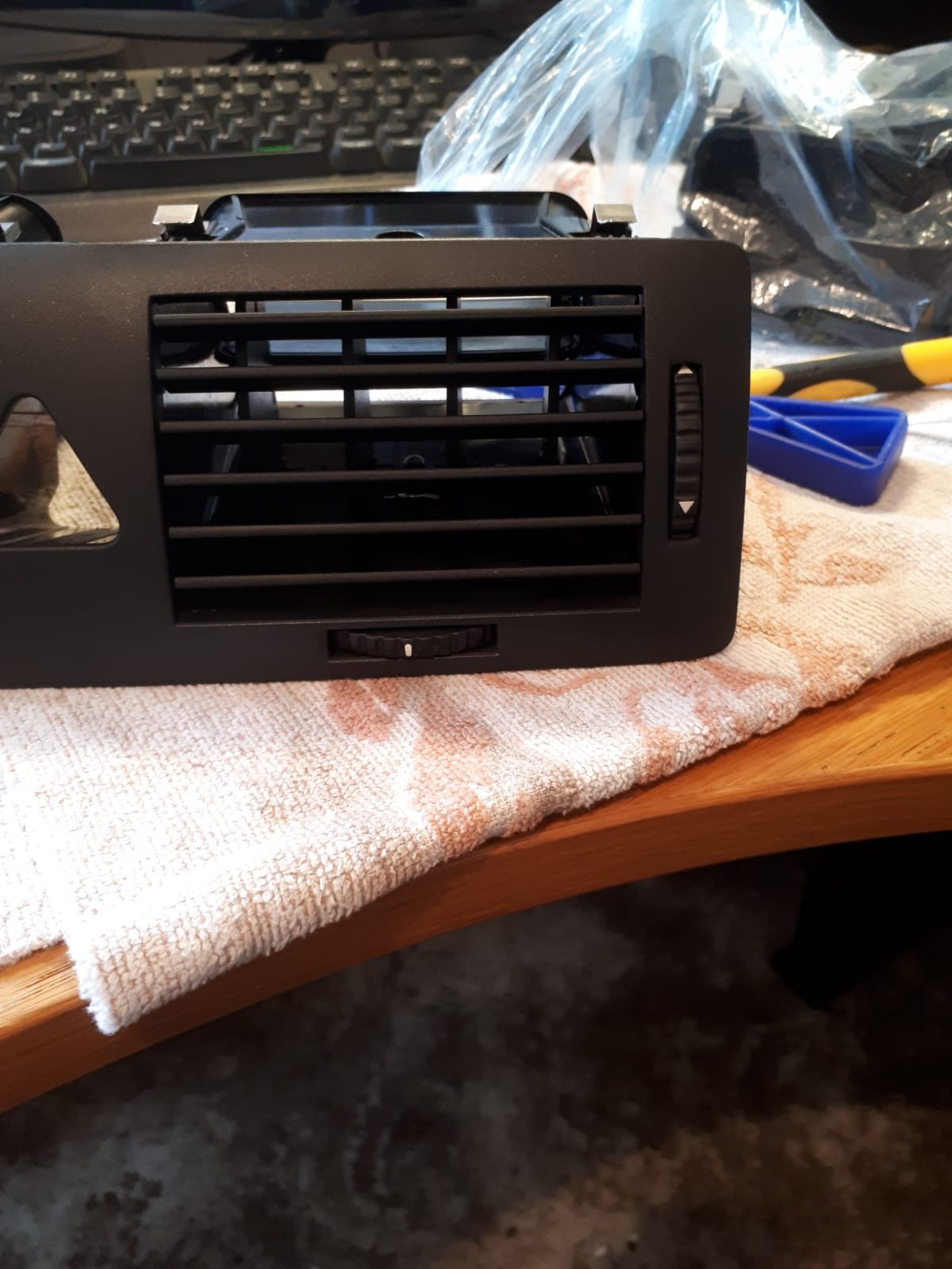

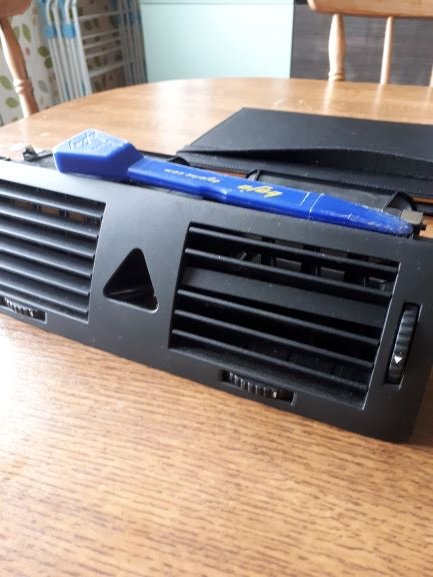

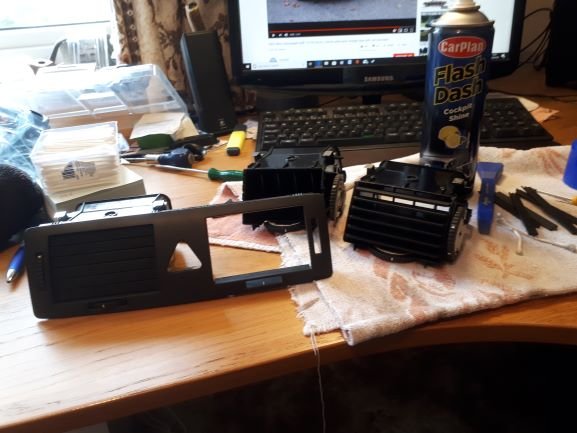

Just a small up date, I found whilst dusting the dashboard off that one of the central louvered vents was not closing properly with one of the slats out of position,
Decided to remove the vent surround with my trusty bojo  tool, having never done this to the Fabia it was a suck it and see moment with the vent housing rather reluctant to be eased out, anyhow success it came free without damage to either dash or vent.
I then Had to remove the offending vent housing thingy once safely out of the main housing it became very obvious as to why it didn't operate correctly.
The photo's  show the issue, I took all the slats out then tried to bend the caved in delicate slat housing back but to no avail, heated it up but I basically buggered it.
After much cursing I made a trip to my local breakers yard and out of a 56 plate classic I got a replacement for a fiver.
So all is well on that front.

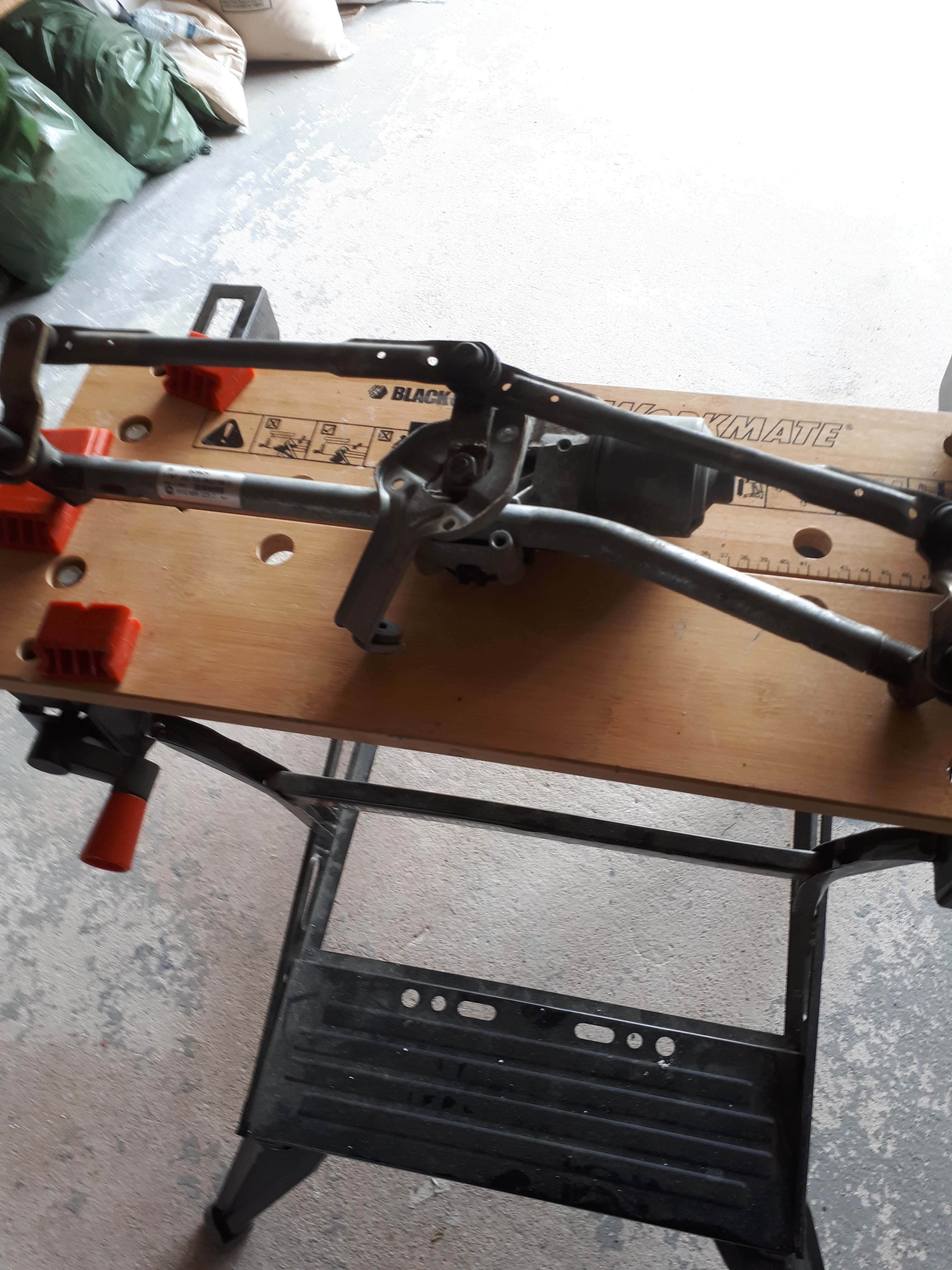

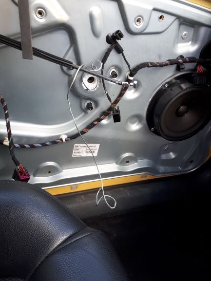

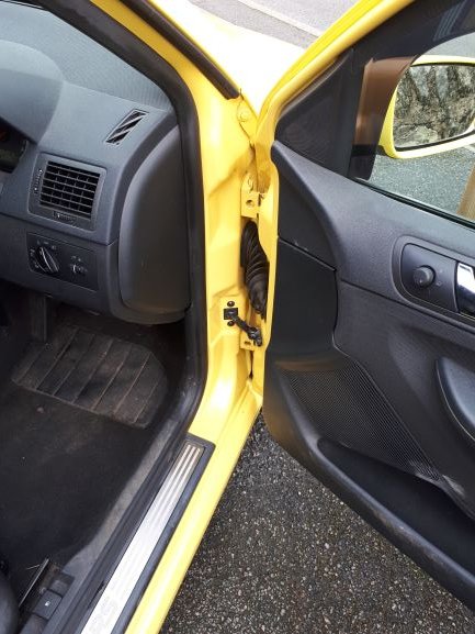

Yesterday I decided to look at the issue my son had with the nearside front window, this apparently decided one day to drop to the door bottom and stay there.
My son managed to take off the door card and found a long silver braided wire all twisted and hanging from the winder motor.
I re fitted the motor and it appears to work fine from both switches, the main issue is that I cannot see exactly the type of fitting that is holding the door handle, deffo not an Allen key or a Torks , is it possibly a star type?
If anyone can help identify that would be great.

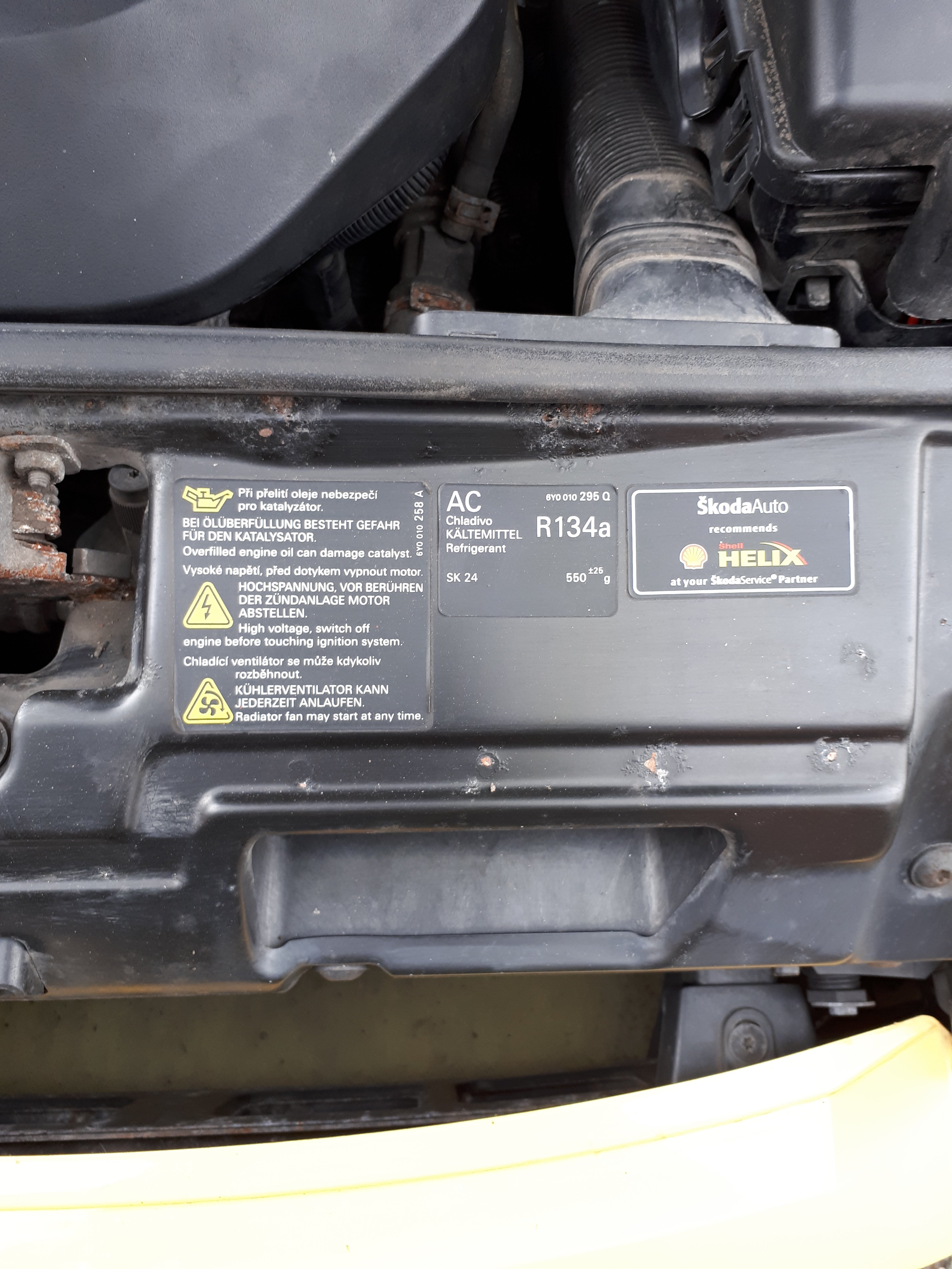

Also found that the air box lid has one of the lugs that fits into the base section of the air box has been somehow broken and does not squash the air filter down to seal properly, looks as though I need a replacement for that as well.
Had the radiator water chemically analysed at a local garage and the head gasket is deffo toast.

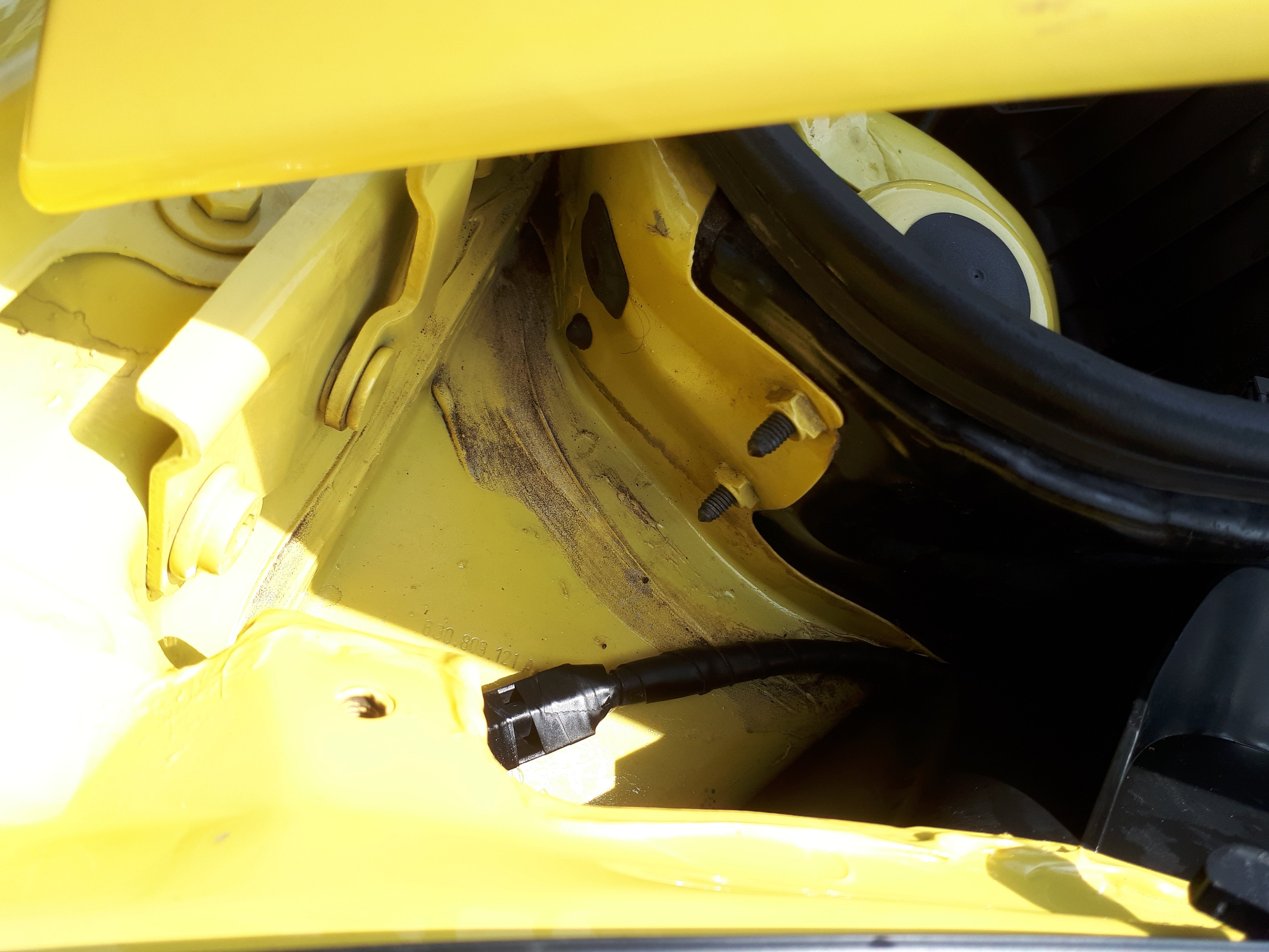

The bonnet slam panel requires attention (just put a post on the Fabia forum for advise) as there are some rust spots that look like spot welds, I know some members have had the panel stove enamelled as opposed to gloss spraying, not sure on this, also would like to keep/replace stickers with new if possible.
Bought new inner door panel with new regulator and managed to source as skoda rivets and door card clips from a seller on e bay.
Anyhow not much of a progress diary but things cant progress as planned -engine first would be more sensible but there we are.

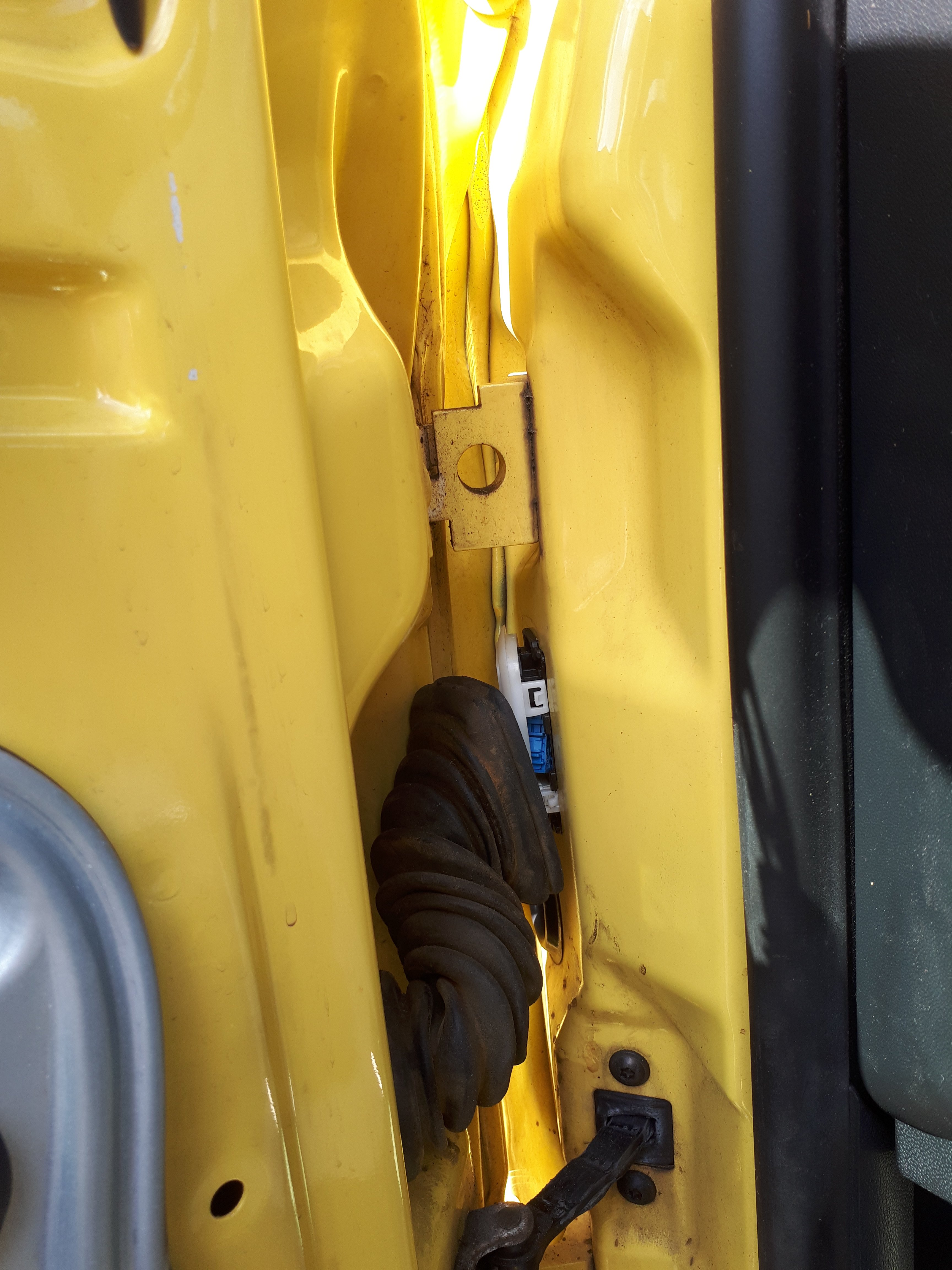

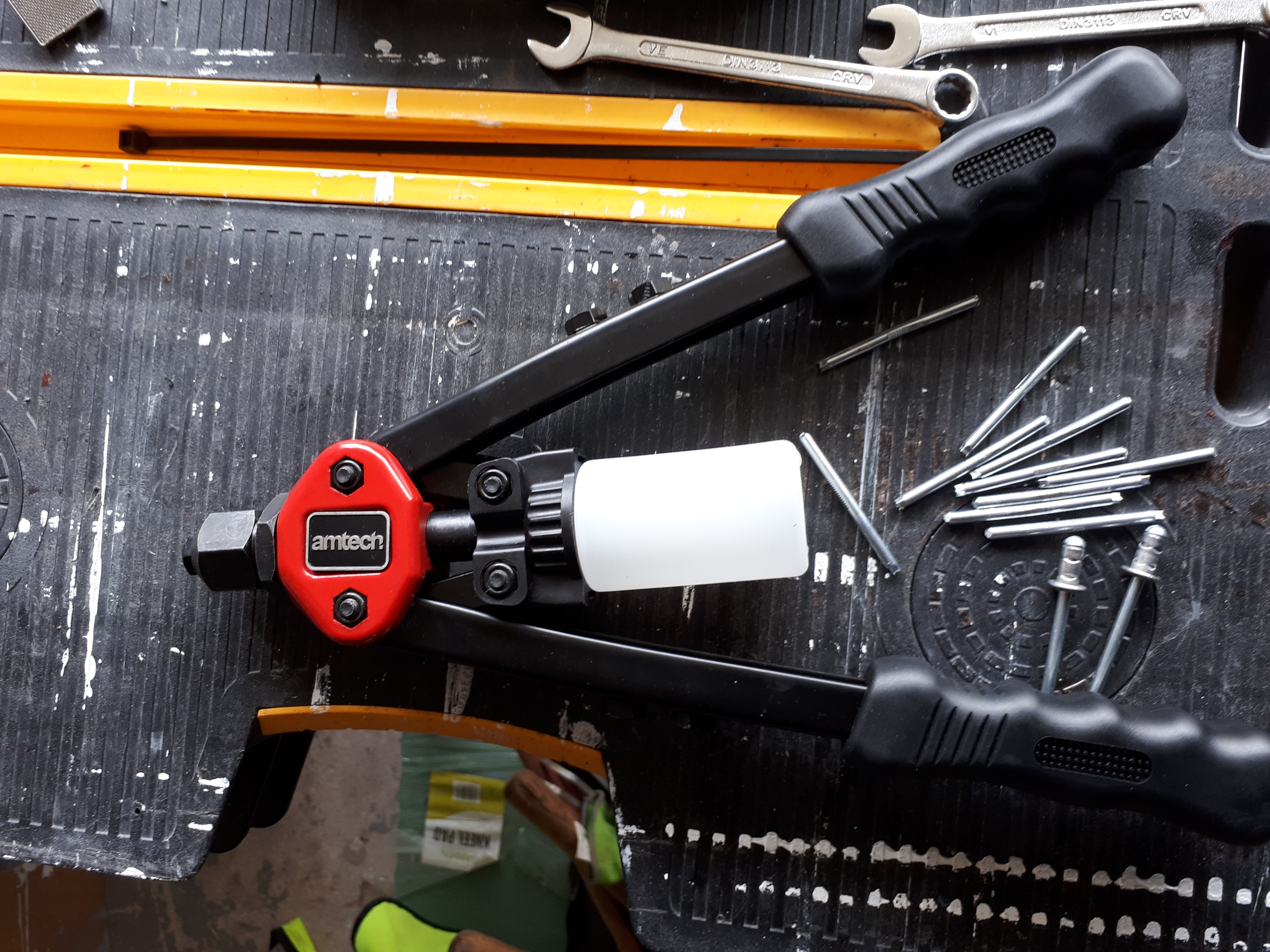

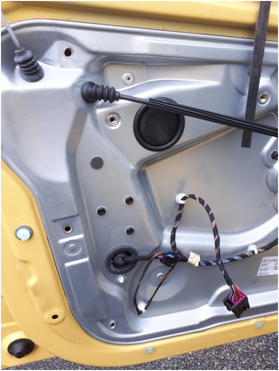

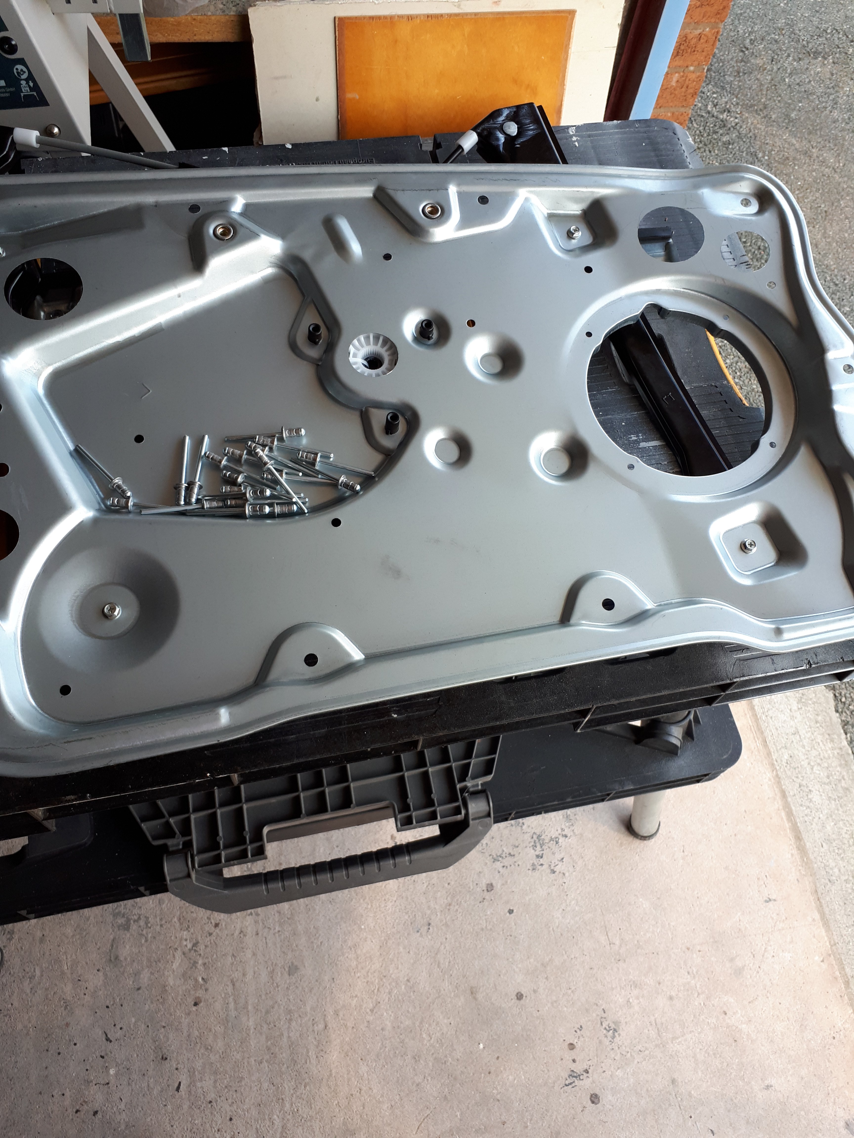

Just an up date  as to progress with the window regulator panel, had quite an interesting week end (for a change) fitting the new panel, the existing panel was not riveted to the door ,must have been someone else other than my Son that did it, also two of the four speaker rivets were drilled-rather strange.
Anyhow following Tech1e's detailed help (many thanks) I removed the original panel with associated wiring loom, removing the door pillar to door electric connectors was just a bit difficult to say the least, anyhow managed not to break anything.
All the 10 rivet drilled out heads were still rattling around in the bottom of the door, removed with a magnet/needle nosed pliers.
With the old panel on my work bench I carefully removed the wiring loom and the lock and transferred it to the new panel, that's when I noticed the lock support bracket was cracked through where it is riveted to the lock .
I remembered watching a video on you tube showing how to plastic weld so I gave it a go for the first time and it worked.
I decided on buying a heavy duty riveter not the lazy tong type hoping it would be strong enough, thankfully it was fine.
The most difficult bit to the refitting was feeding the four electric connectors back through the water proofing bellows and re connecting the connectors to the pillar.
I made sure all was working prior to riveting the new panel, window winder motor ,lock etc.
I put a post on the mk 1 forum yesterday as the door locked but refused to release from the lock keeper which was quite a shock, initially the moving part of the external handle was standing proud of the fixed handle piece when I got the car off my Son so I thought I would try to adjust the lock cable to make the handle fit more flush when released , trying about half a dozen times the handle would operate the lock with out closing the door, all appeared to be fine only to be pretty shocked to find the door would not release from its keeper as expected.
I must have tried it quite a few times then it suddenly opened, needless to say I moved the adjustable cable to the handle back to where it was when I started and all appears ok at the moment, unfortunately the small section of inner door handle is missing so will have to visit my local vehicle dismantlers who knows when.
I know Tech1e mentioned particularly the cable that I had trouble and finally luck with, had visions of the door never opening again.
Martin.

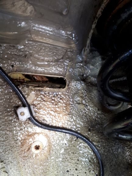

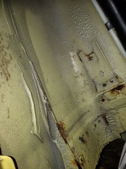

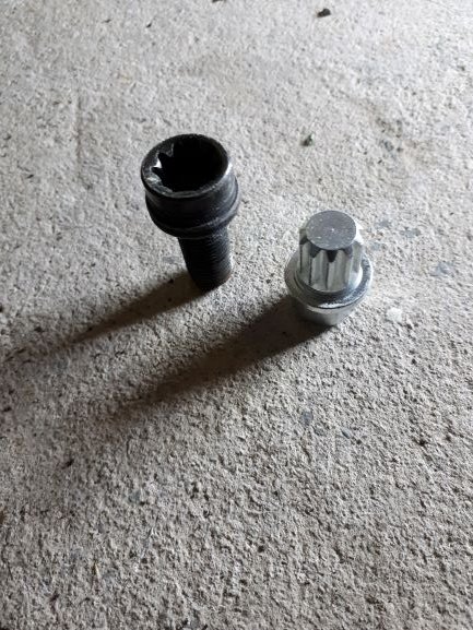

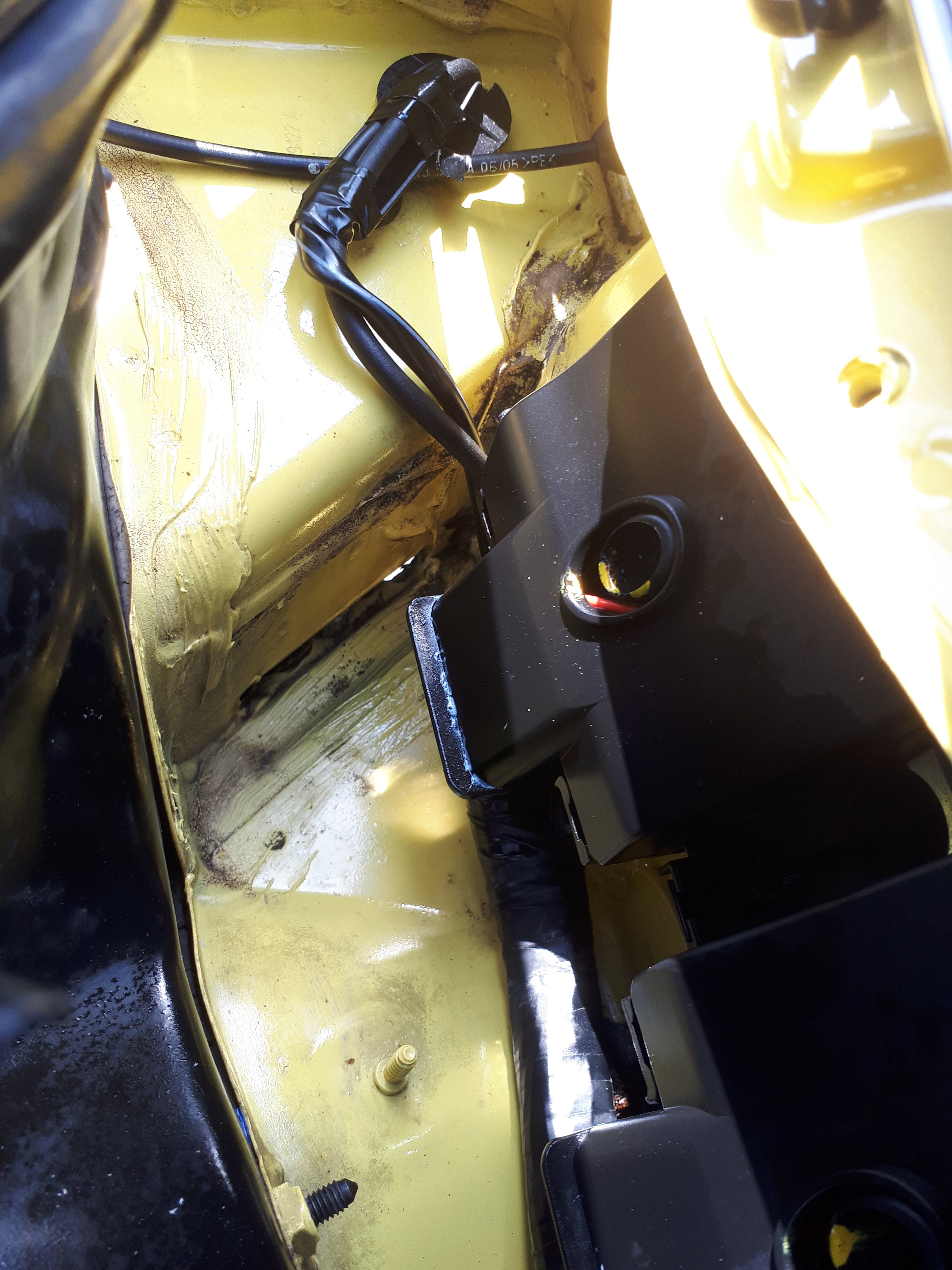

After finding out the locking wheel bolt was missing last weekend (only had the car a year) and following help and recommendations from several members I sourced a 10 spline key , it arrived this morning so I wanted to check under the wheel arch plastic liners to check on the wheel arches for rust etc.
I think they look pretty good for a 14 year old car, although some attention is required to treat areas of rusting.
I found that the front off side drive shaft gaiter is split so that needs attention as well as the front discs /pads as they are grease coated, the mileage at its last service was 57,639miles and now at 71,378miles, time will tell if the knuckle joint requires replacing as we all know if grease comes out debris can get in.
The fixing screws for the liners varied in states of rusting and some almost had no where to get a good torx fitting grip, slight tightening then loosening did the trick and all came out , will require new ones once the liners go back on.

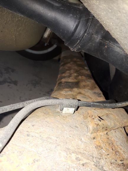

There appears to be lots of surface rusting on the rear suspension beam but hopefully it's still sound.

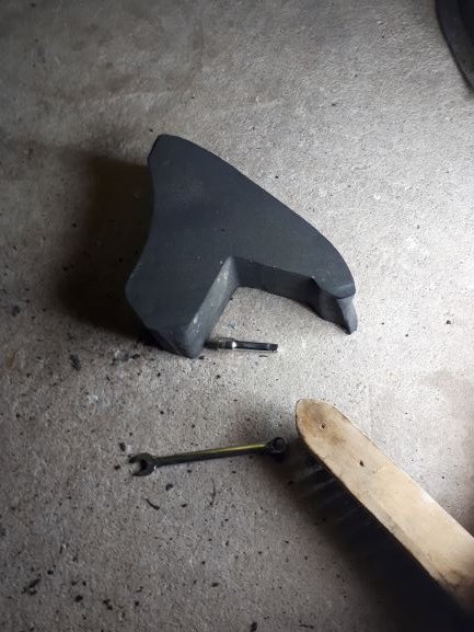

There was a piece of shaped hard foam drop out once I removed the front liner, not sure how it fits back or it's orientation, also a long clear tube dropped out at the back arch once I removed that liner, not sure but it looks kike a drain from the filler cap.
I washed the arches out and got rid of the grime and mud.
The scuttle drain looks full of leaves ,pine needles and who knows what else, so another job is the remove the scuttle panel and have a look.
Anyhow took a few photos of how it looks, some prior to washing and some after, not much difference really.

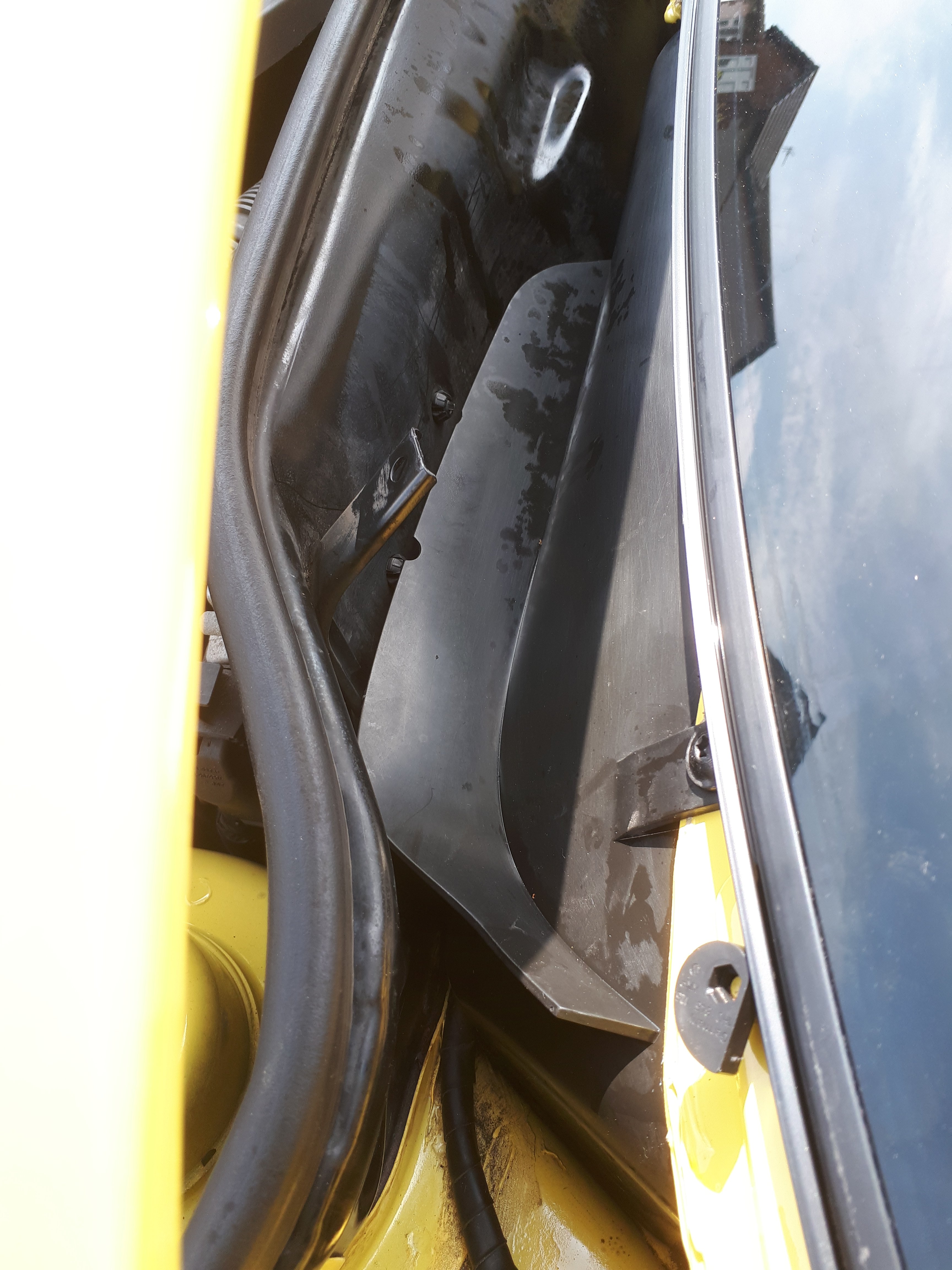

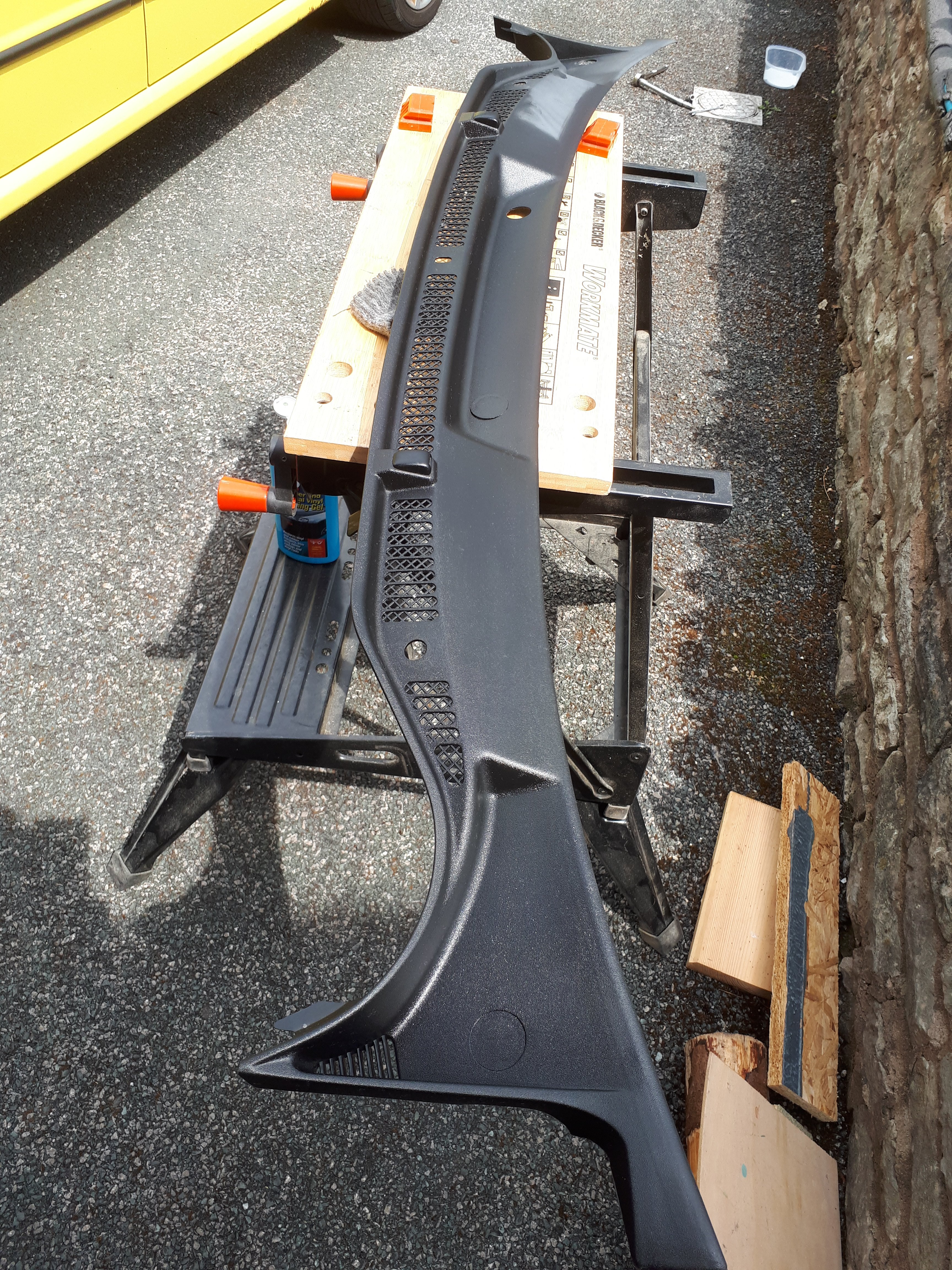

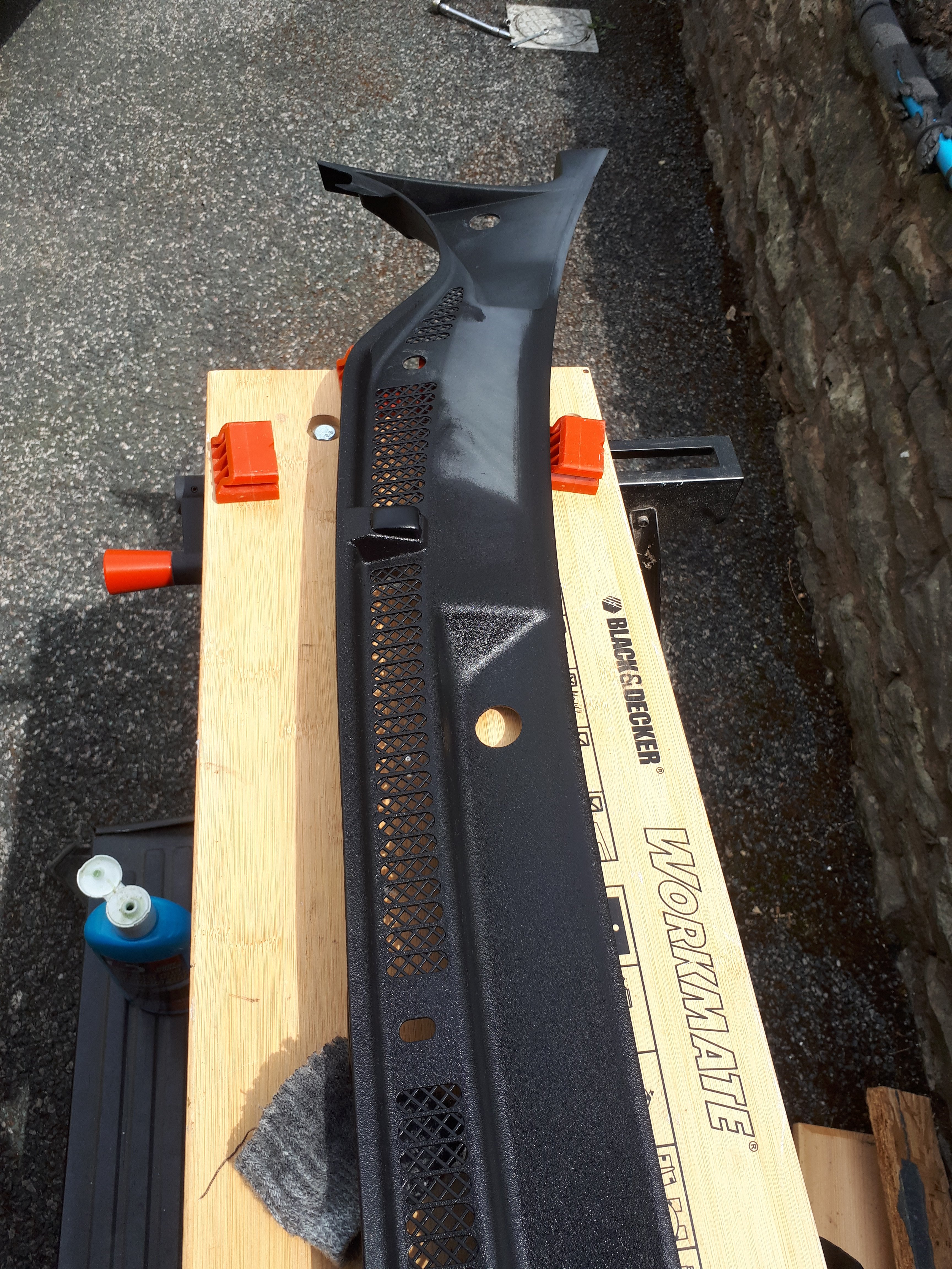

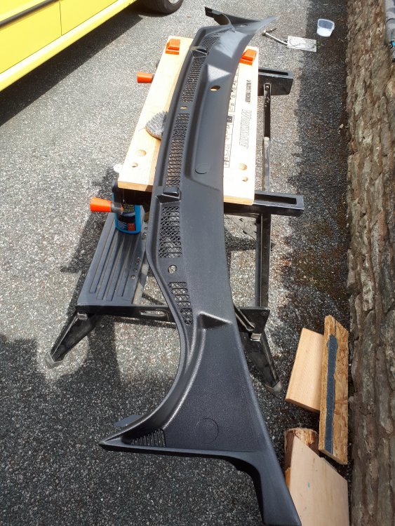

I have been checking if it had any nasty surprises lurking  in the rust issues but up to now all looking ok I recon, 14 years as a city car and it's OK.
Scuttle panel removed , full of leaves but not one bit of rust so all good.
Cheers.

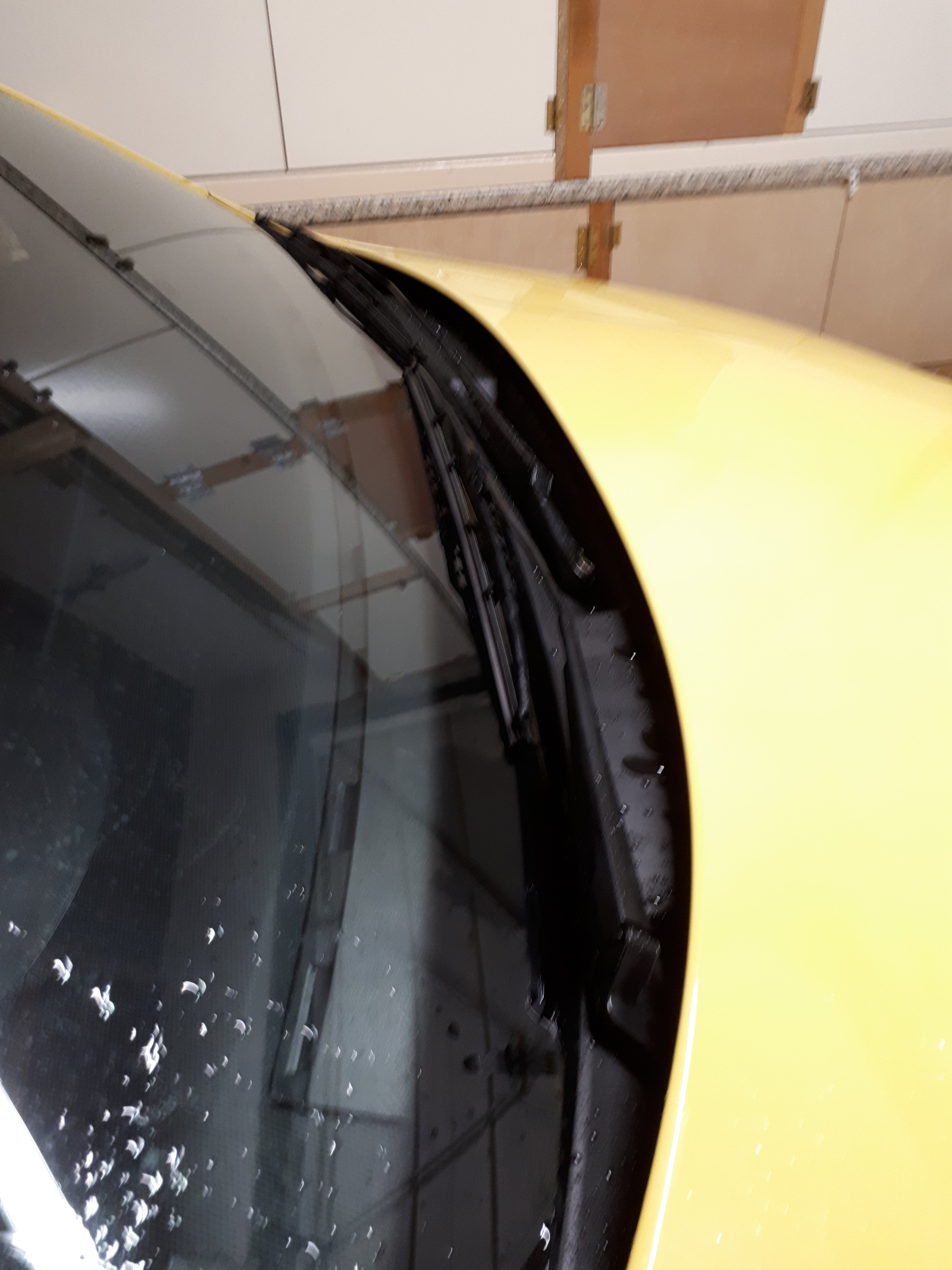

Some pictures of the scuttle area which I hoovered out first, then used a detail brush with diluted Bilt Hamber korosol  then washed out with hose on a gentle setting, and the plastic scuttle panel after I put some restorer product on it from Mer,  which came up really well, had to purchase a set of pullers as the wiper arms would not budge, I even took the arm retaining nuts off and flooded the spline area with wd40 and left for 24 hrs.
there was a build up of grime on the windscreen just above the scuttle top edge which would not move with washing so had to use a razor blade scraper which did .

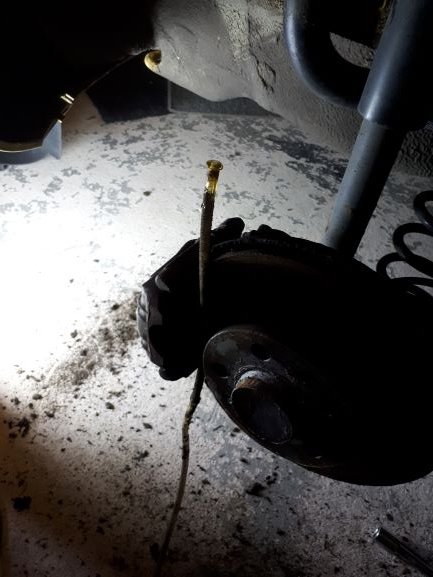

It's been a while since my last post, since there was an advisory on the last mot for brake discs I decided to take advantage of the black Friday discounts from ECP and bought new front and back discs from Pagid  along with Brembo pads.
Today I decided to look at the rear offside brake as I have recently been putting the car out of the garage on to the drive, it has been noticeably reluctant to move and any movement is accompanied with squealing and a hand brake that has suddenly become reluctant to release.
Nothing untoward with the pads or disc and the handbrake lever calliper end  is free to move with strong return off movement.
Sliders that hold the calliper are also moving freely.
The calliper is a Lucas one but in silver not green so I suspect that this one is a replacement.
I decided to replace the existing disc and pads for now.
I need to look at the nearside brake next as there was noticeable groaning from that side as I lowered the car off the jack.

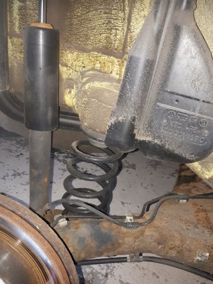

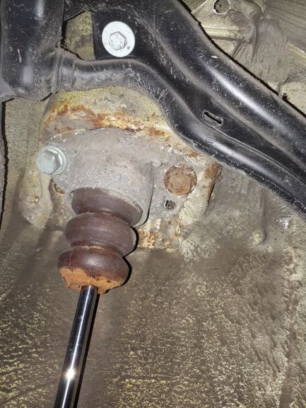

I also managed to get pictures of the rear suspension beam which looks rather grim with eruptions of rust on top and underneath, I know it has been covered by other members , what it best to do, I don't think it is perforated , I think it needs to either replaced or restored, I found a seller of new -restored ones that are not expensive also comes with bushings.
Has anyone done a restoration on a beam and would removal, replacement affect the cars tracking, not sure if there is any adjustment.
