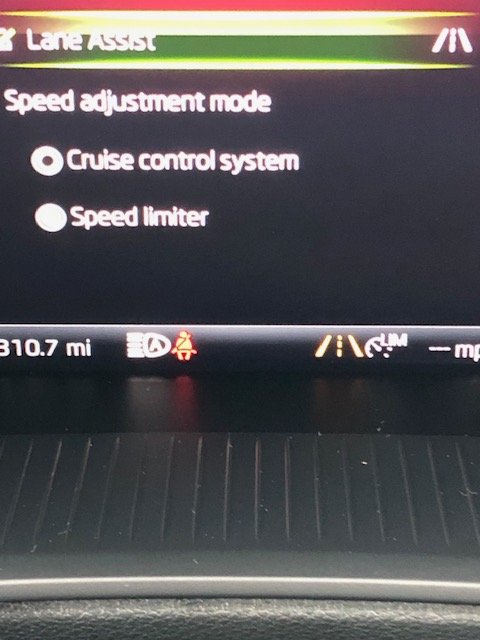

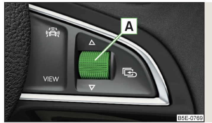

I change the mode from CC to limiter by using the right handed thumb wheel on the steer wheel and to get the modes displayed in Maxi dot I press the top of the section next to the thumb wheel above " " View "
One thing I find confusing is I don't have the Anti collision  Radar in the grill yet I have the symbol on the steering wheel.

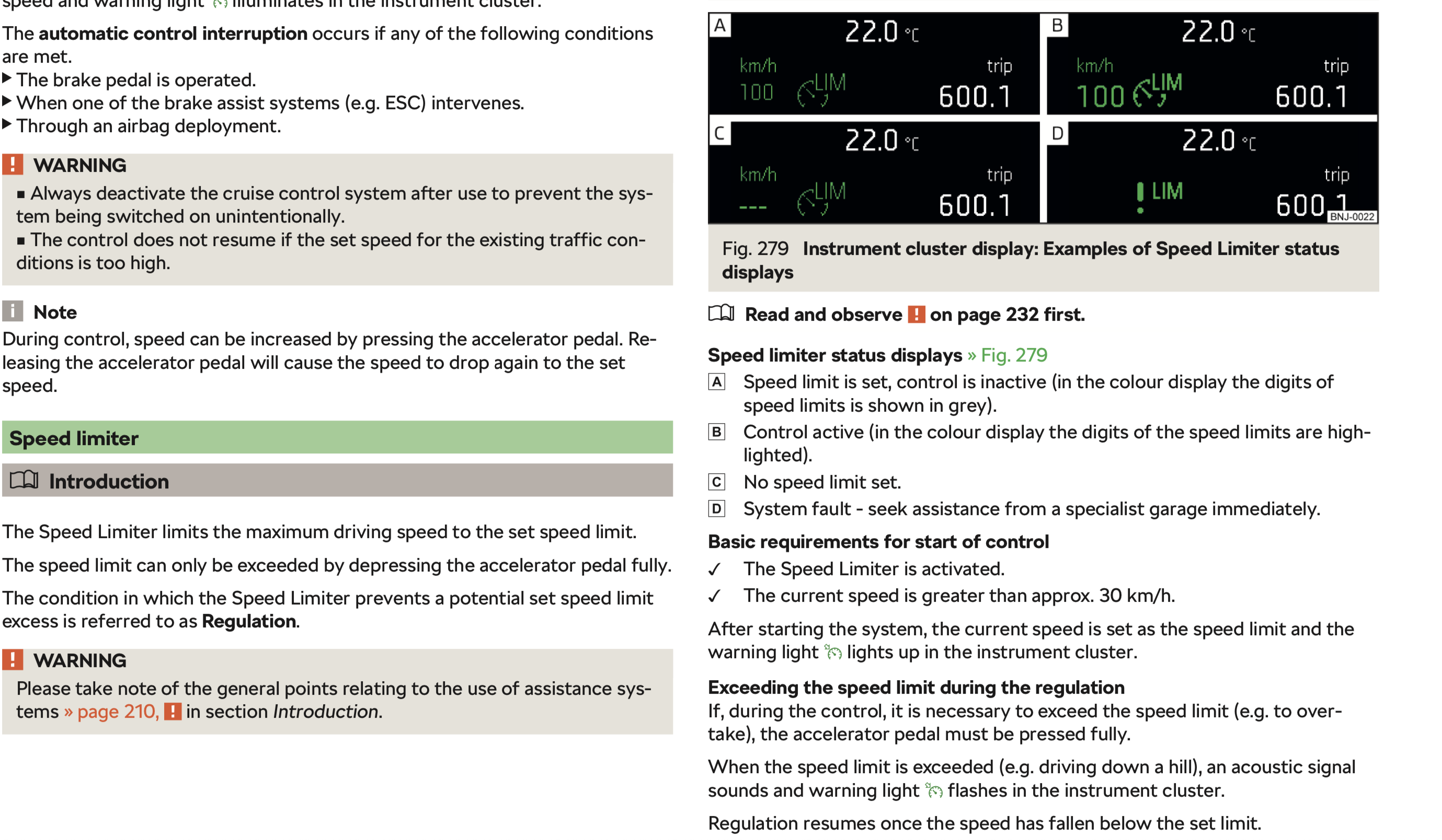

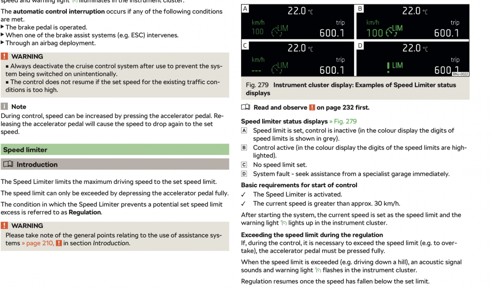

Screen shot is from the latest Manual page 232
Edited by Auric Goldfinger

Been out today so I tried the Speed Limiter,  Once you have selected it on Maxi Dot Via the Driver assistance  button on the steering wheel, Activate it by using the CC switch on top of the left stalk  to ON and once you get to the desired speed press the button on the end of the stalk and that sets the speed limit. You can increase/decrease the speed by using the  Minus/plus buttons on the end of the stalk. Turn the switch to OFF on top of the stalk and that deactivates the speed limiter but it still shows in Maxi Dot until you turn it back on via the switch on the stalk.
It work in a similar way do CC but you can drive normally but the car won't exceed the set speed unless you plant your right foot to the floor.
