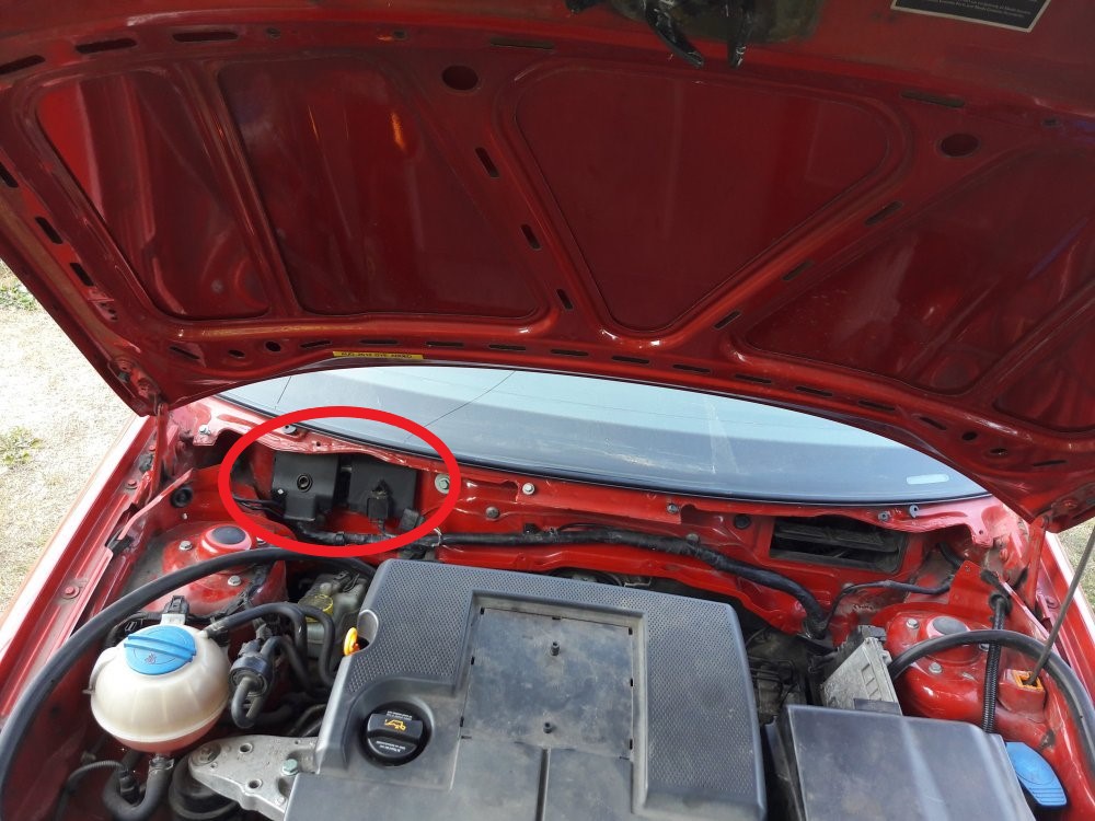

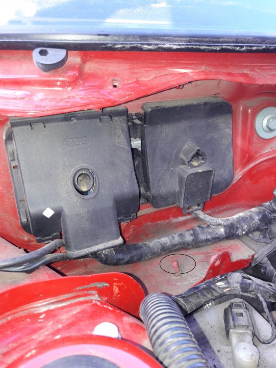

Okay don’t know if I’m being stupid but would that be under the scuttle panel?

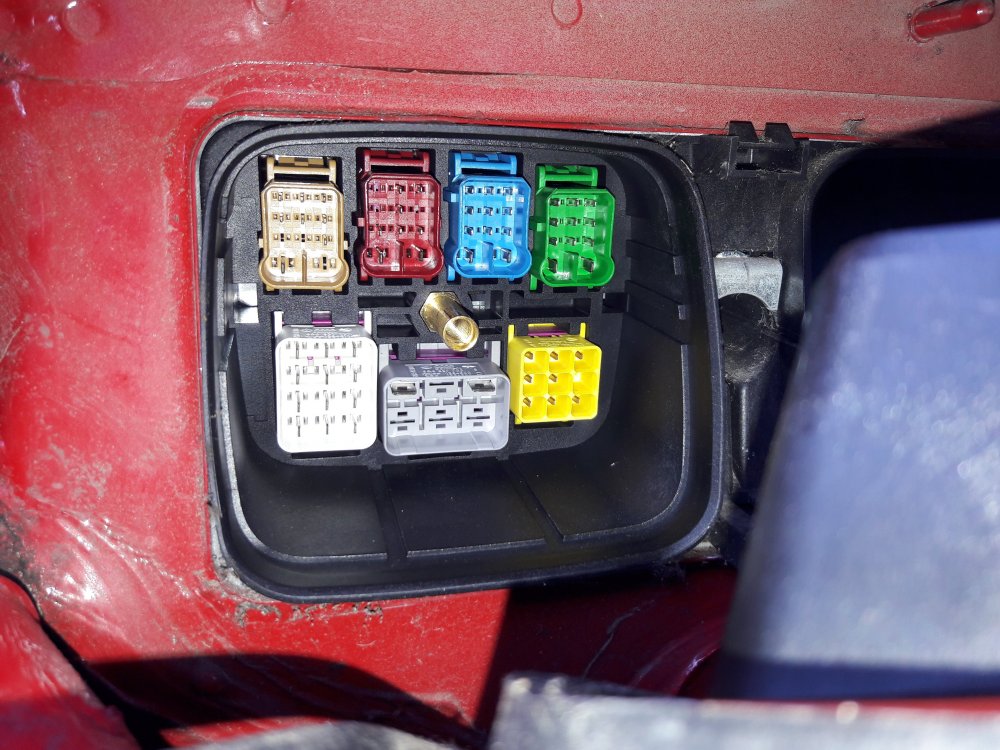

Bulkhead connectors look like this (pics courtesy of Wino)...
20180714-180051-thumb-jpg-1e3028ecec8198
20180714-182427-thumb-jpg-462593bfbf20c2
20180714-182532-thumb-jpg-8af62343b0d334
20180714-182539-thumb-jpg-119b2e60f9884a
Edited by TMB
Yeah that second from last picture shows the connector bottom left

Right! Now we’re talking I couldn’t work out where anyone was meaning, I’ll be checking in here tomorrow, so fingers crossed there will be a blown wire in here or something along those lines
Yes you were right - it's all under the scuttle panel.
