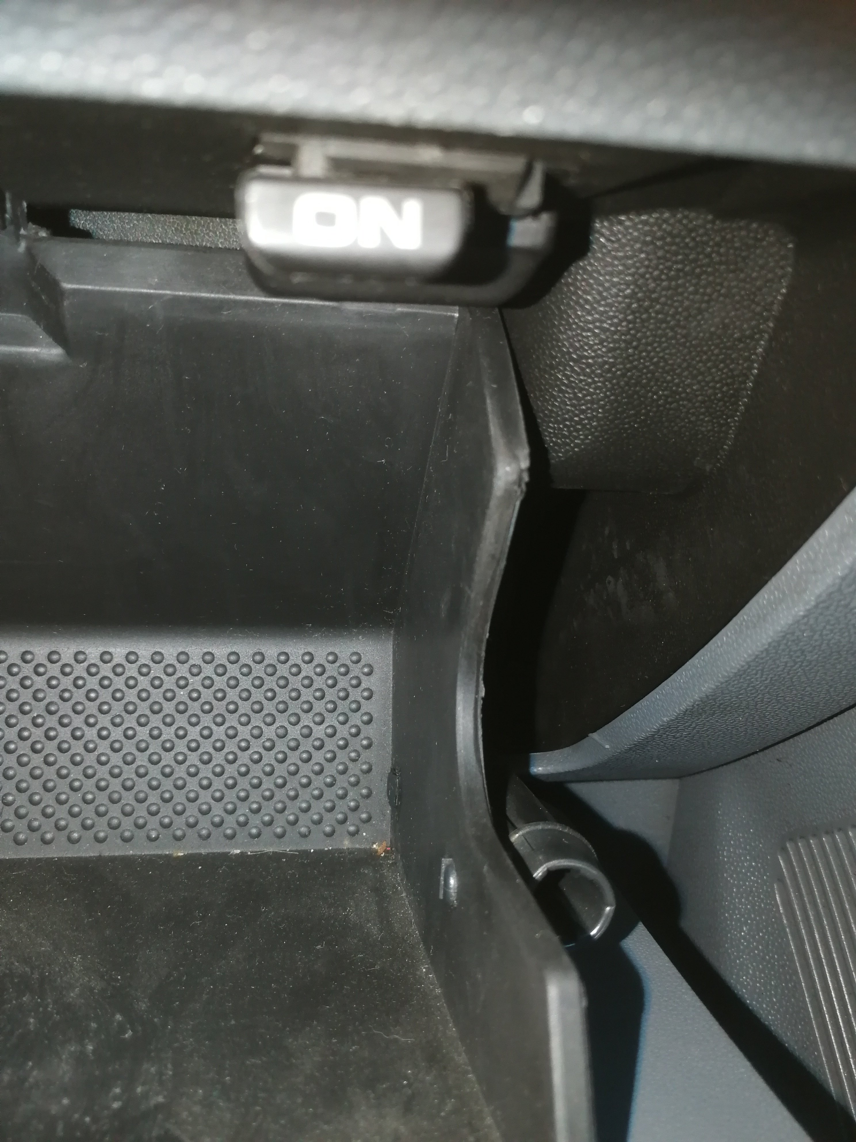

Skoda fabia 51 plate
On the driver's side there is a small compartment on the lower part of the dashboard
A small glove box you could say
Inside this there is a pull out tab with on written on it
Any ideas what this is ?
Or what it does ??
Many thanks

Can someone please tell me what this is ?
Right hand drive MK1 fabia
Right hand side cubby hole
The one you pull down to see the obd port
Top right of this cubby hole is a pull out clip ? With on written on it ?
In words , not clever comments !
What is this
Please , somebody tell me !!

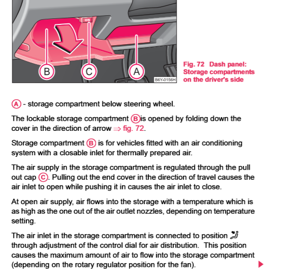

You've been given the correct answer several times.
That compartment gets connected into the vent system when the lever is pulled towards you.
So that cubby can be used to keep a drink can cool until needed, for example.
I've never tried it to see how well it works though.
Here you are if you don't believe us :tongueout: ....
