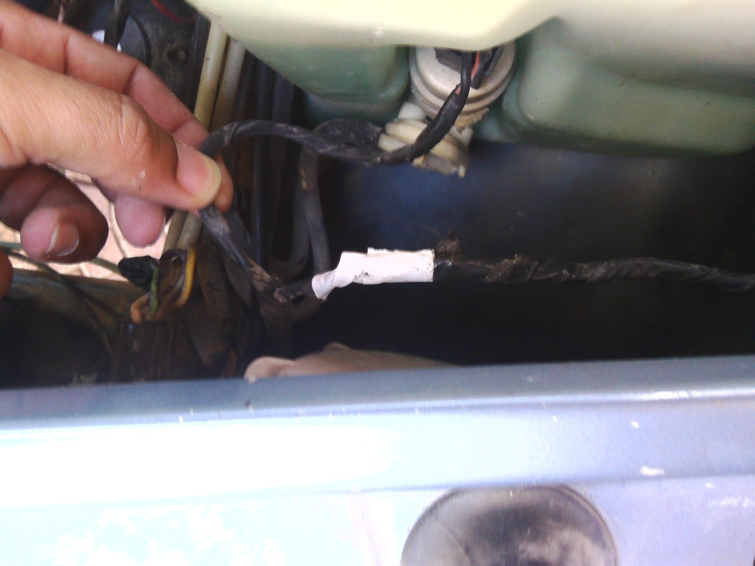

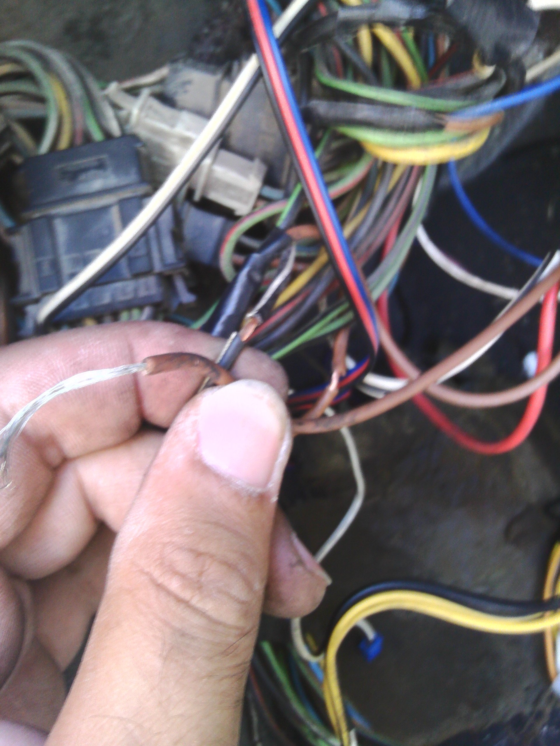

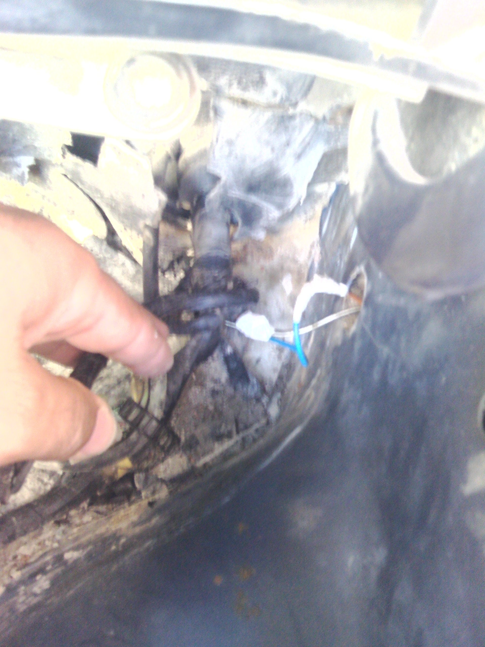

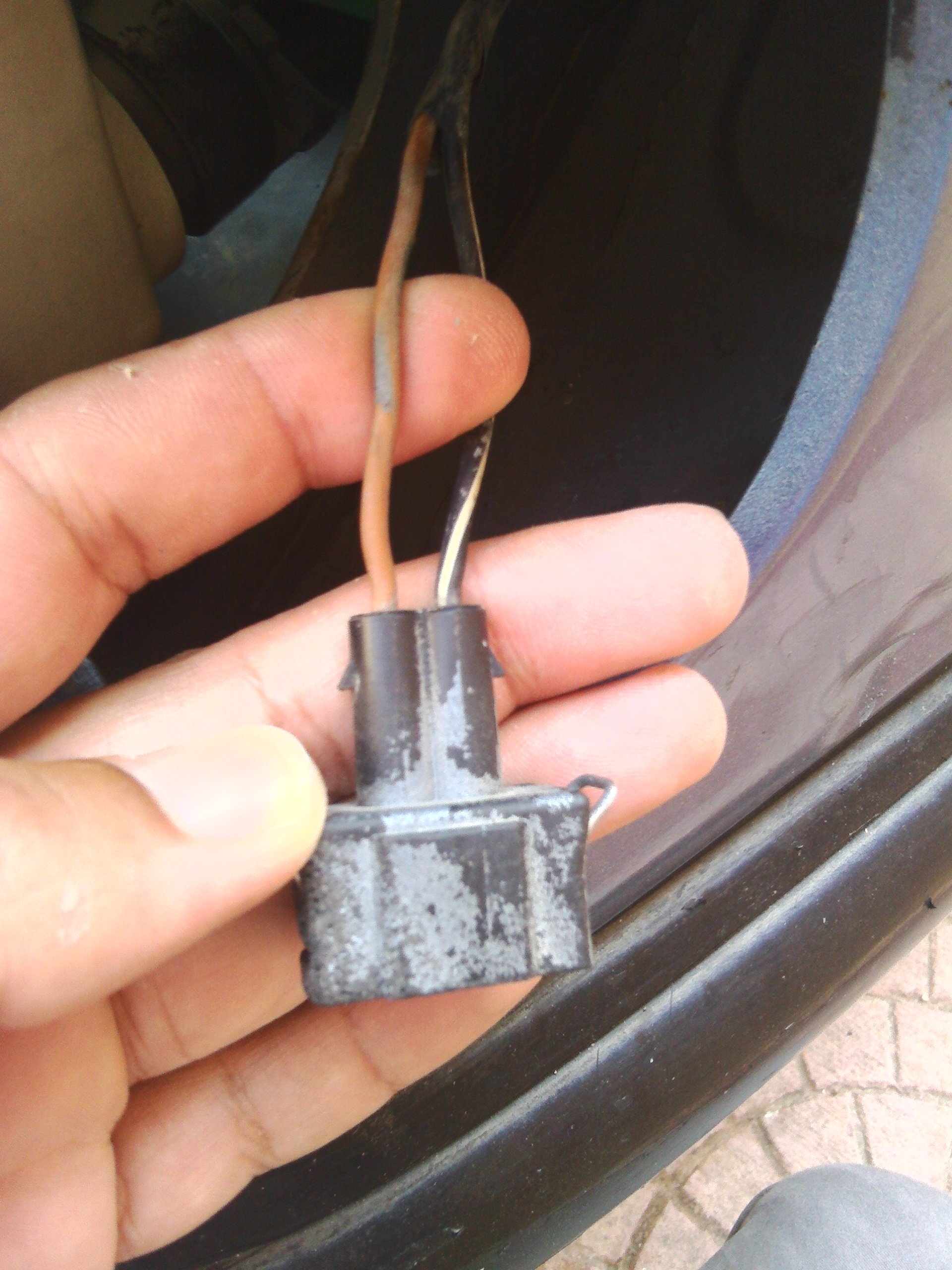

hi my friends
problem found in front left signal cables
when I repair the cable
signal and reverse light worked
thank you for your help
Front?? Photo?
I'il take a photo and upload it tomorrow.

You'll have to explain exactly what problem you found and what you did in the front of the car. Otherwise it will be difficult to guide you further.

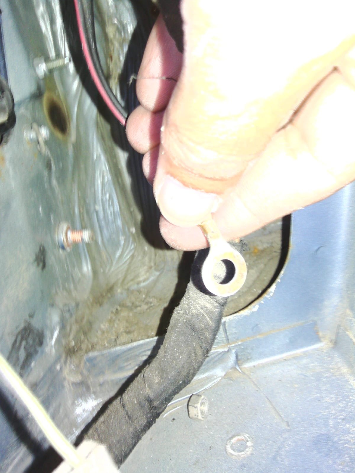

earth connection fault probably

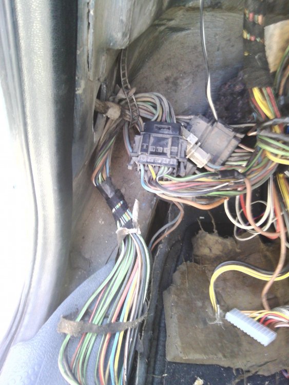

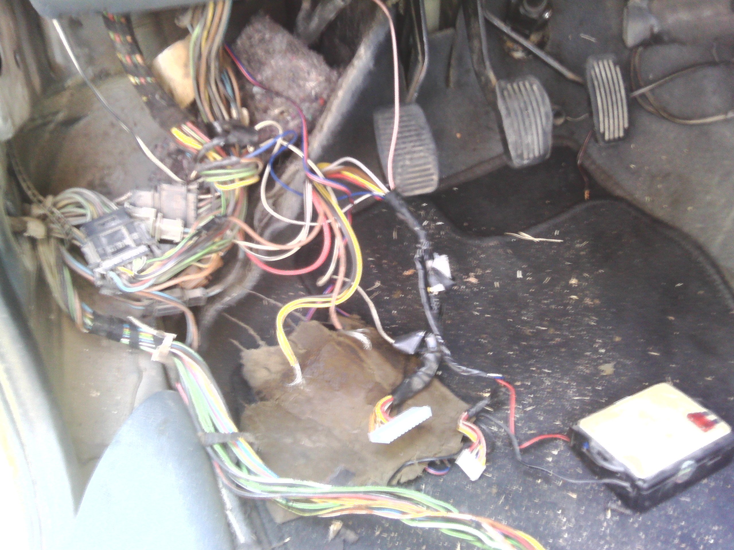

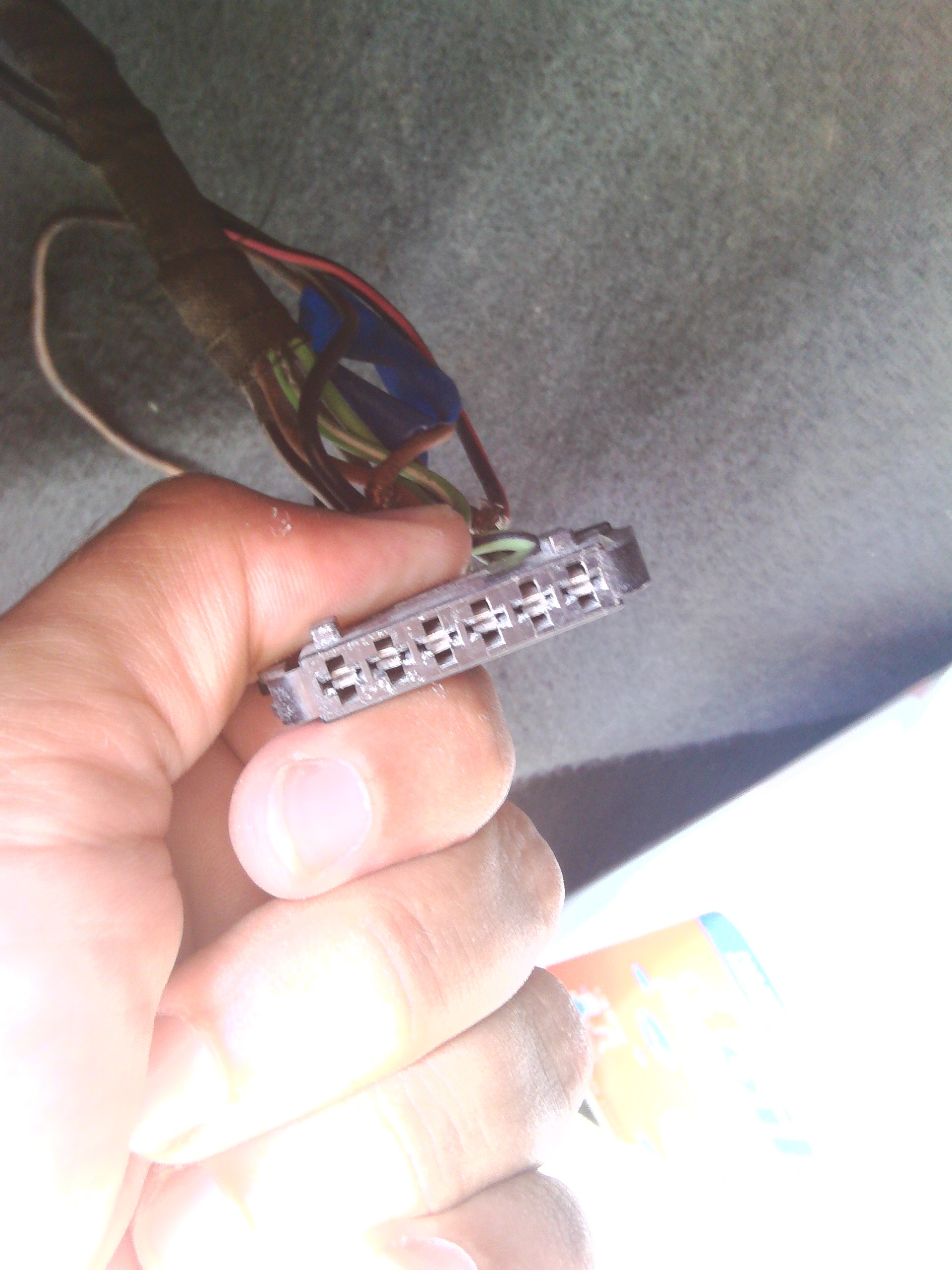

the problem continues

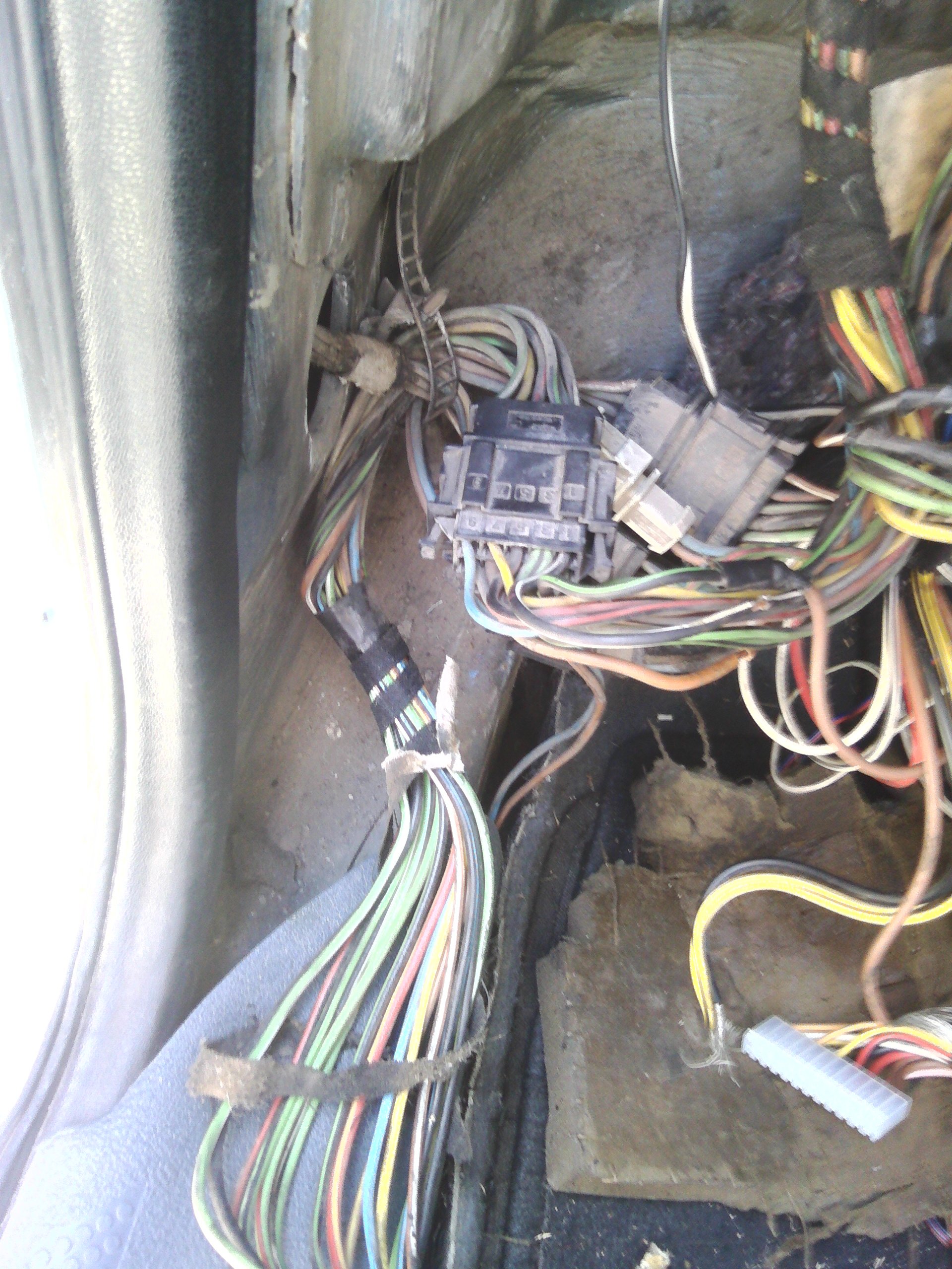

I will remove the dashboard to check the cables
and for controlling the alarm
I will start over with Ricardo's First Message 😓

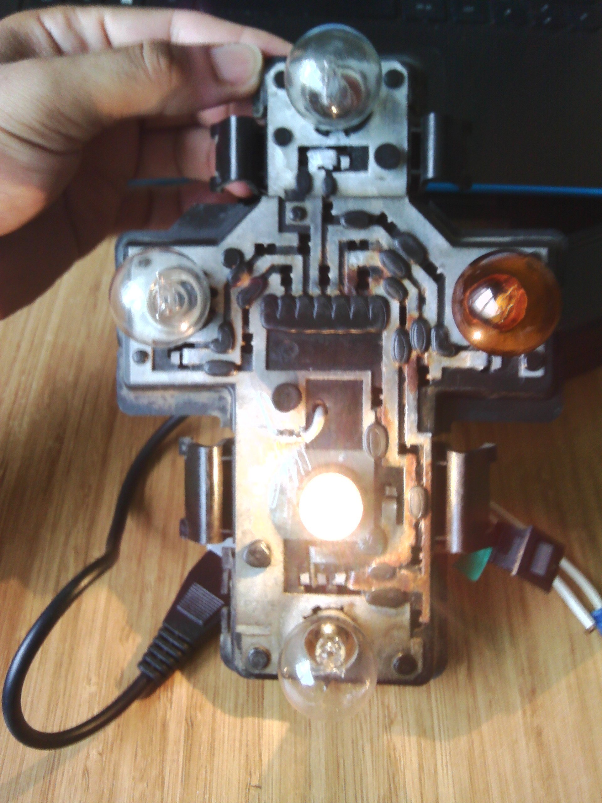

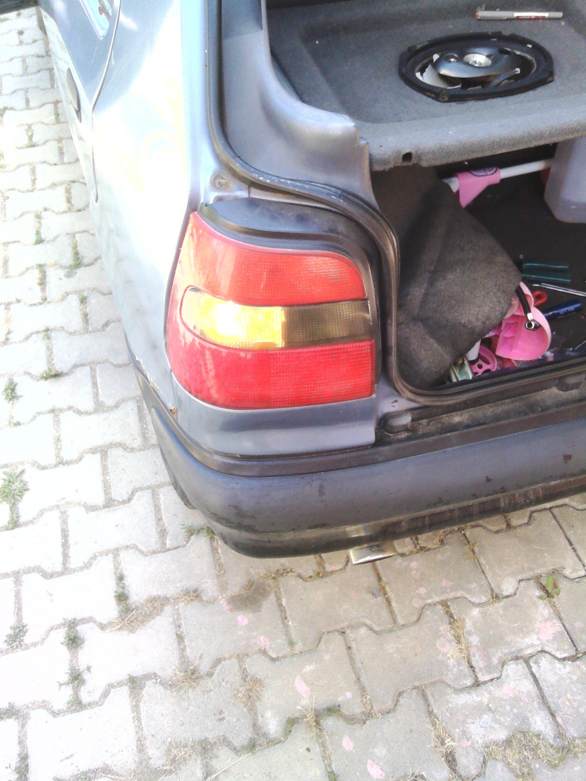

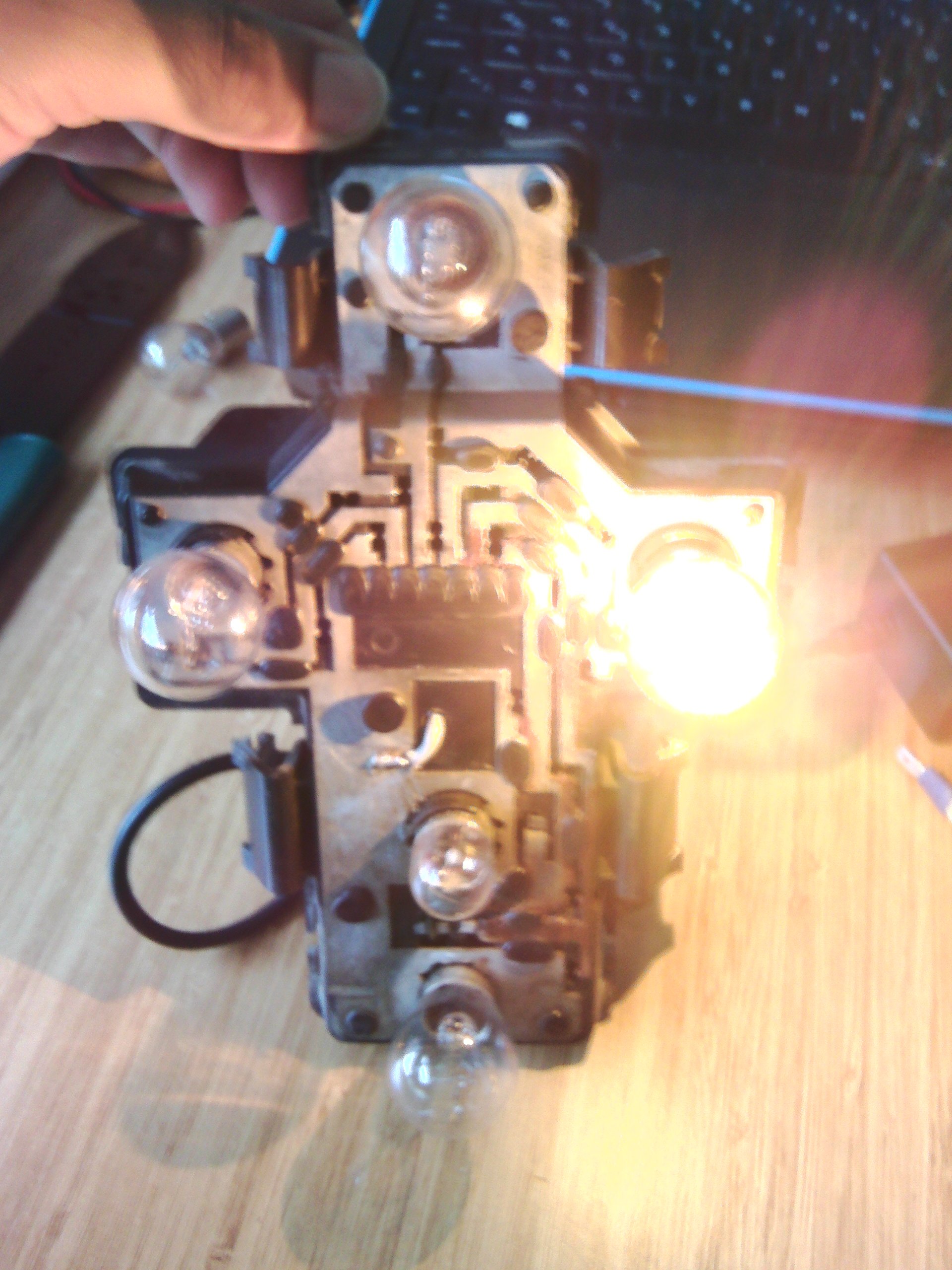

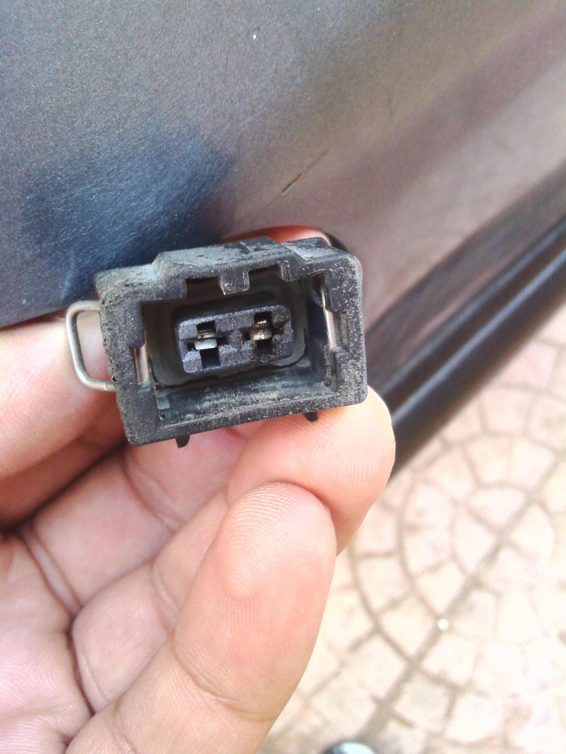

back socket removed
it worked when I energized the tail lamp from the battery.
no problem in the queue, apparently

Meanwhile the alarm system has been removed

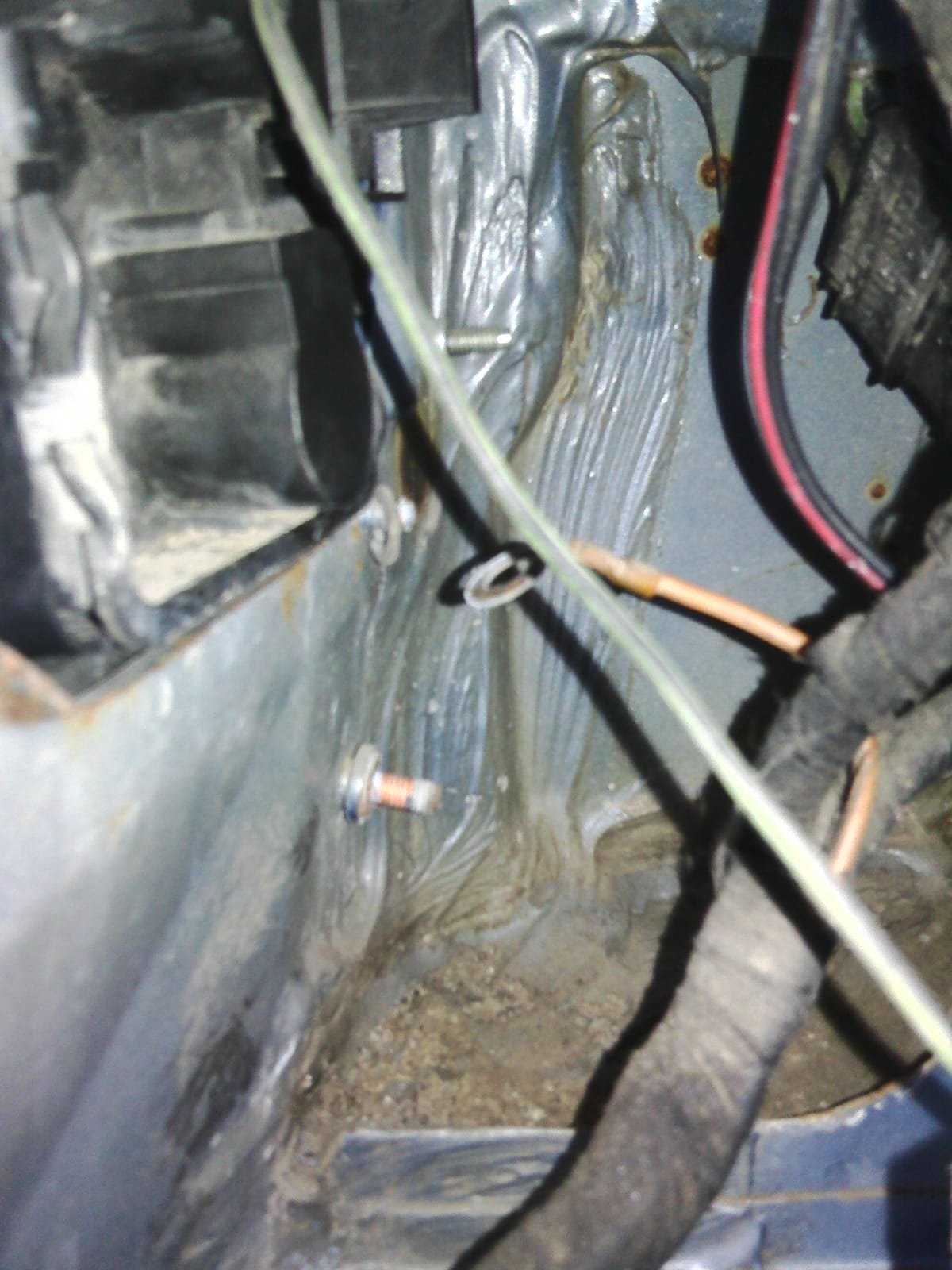

Let me check if I understand this correctly. You say that the rear lamps are working well and you are 100% sure there is no electrical fault in that area. So your conclusion (by elimination) is that the electrical fault is on the front wiring of the car.
If that is true you need to:
  • disconnect right front side lights (remember there is a lateral blinking lamp too!)
  • put ignition key ON and turn signal lever ON to the right
  • if the fuse doesn't burn, the lamps are faulty
  • if the fuse burns, the wiring is bad
Looking at your photos I think the wiring is in bad shape. You need to check it for bad isolation.
