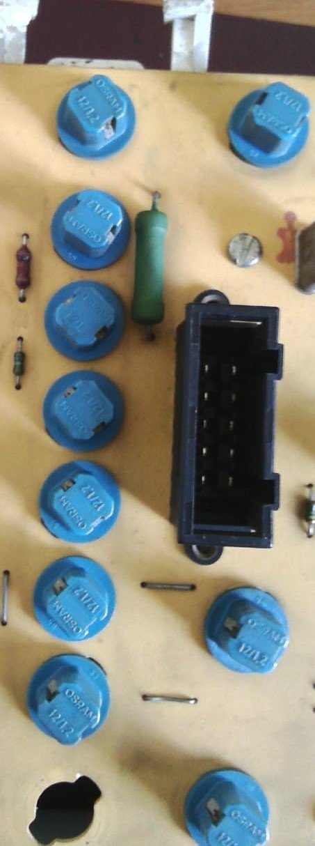

Hello there,
What is the green piece found here?
one side is broken
I soldered again
That is a power resistor. I can't remember now what is its role but I will tell you exactly later today.
No problem after 1 hour of usage.
I hope it won't be a problem anymore
Thanks a lot for your help 😍
It is a 82 Ohms / 2 Watt resistor. Its purpose is to protect the charging alert lamp when there is a fault of the alternator regulator and the voltage goes high.

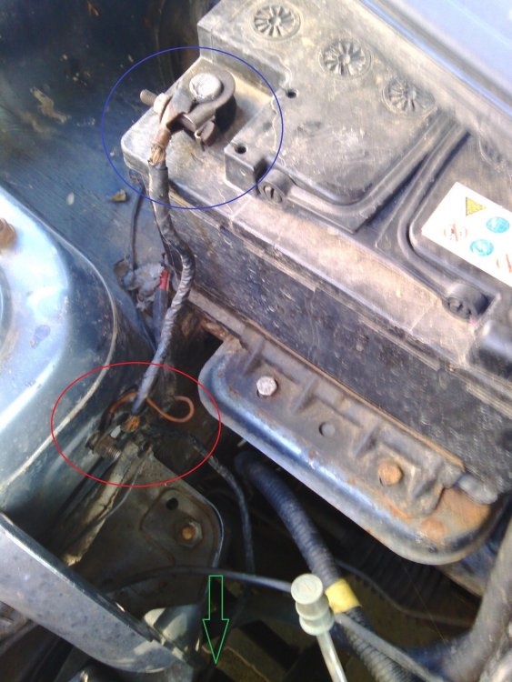

Hello again,
I want to renew the (-) cable of the car battery,
but one cable has two different ports (indicated by red and green shapes)
and I can't find the (L) shaped terminal marked in red,
Maybe if I pull two separate wires from the place marked blue instead, will it do the same job?Battery2.thumb.jpg.cd06408fcd4d39b0e93c1f64c2fdb0a5.jpg
is there someone who can offer ideas?
the terminal in red is THE MAIN chassis groung  you can run a beefy cable from the battery to there and you would be good to go

I replaced the old one with a 25mm two-piece cable.
The temperature gauge has been working properly since I changed the cable,
It looked different before, more than it should be,
When I turned on the lights, the temperature indicator was rising while the radiator or heater fan was running.
Now everything works fine
you see proper grounding is a reallyyyy big deal
