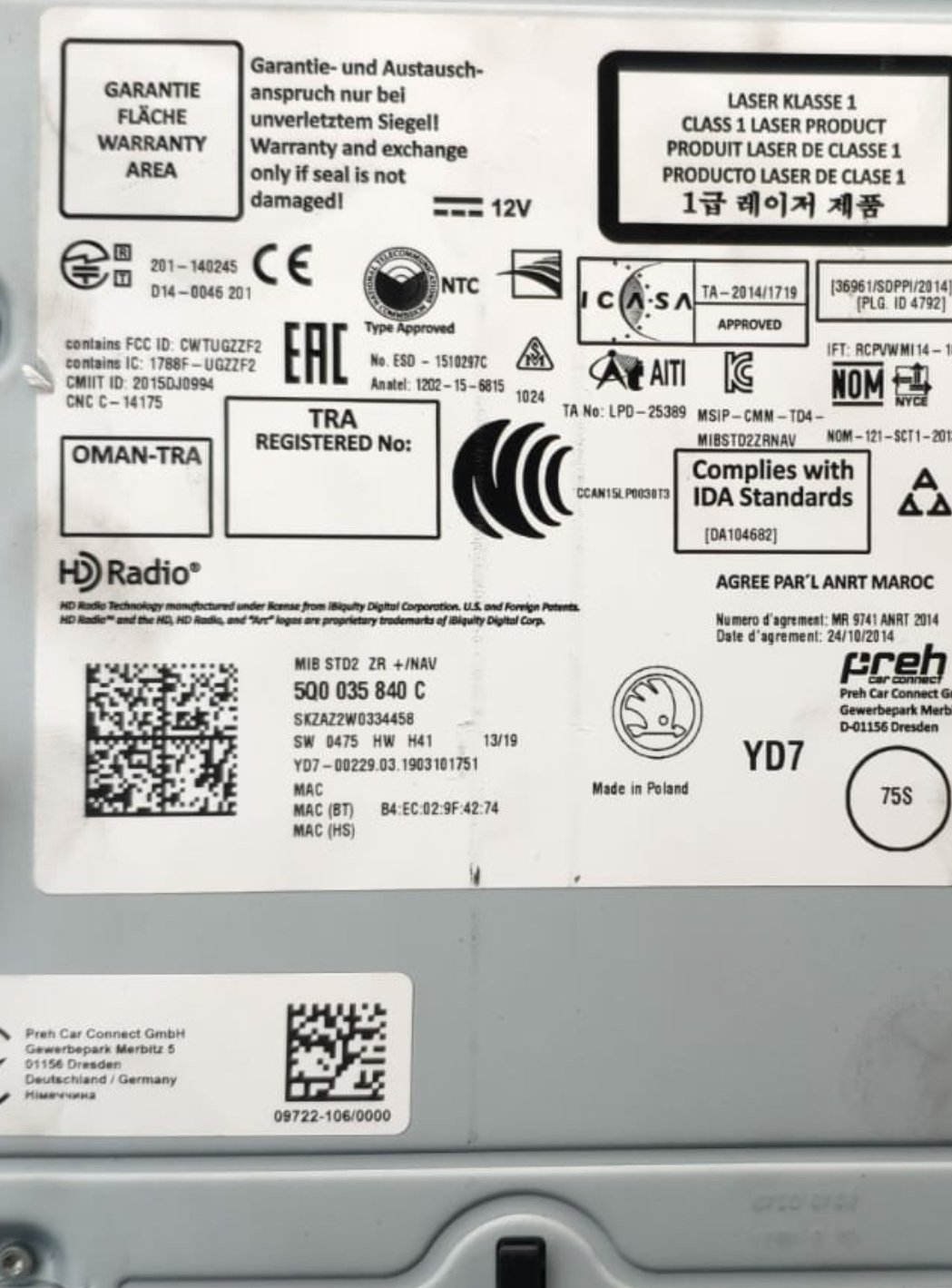

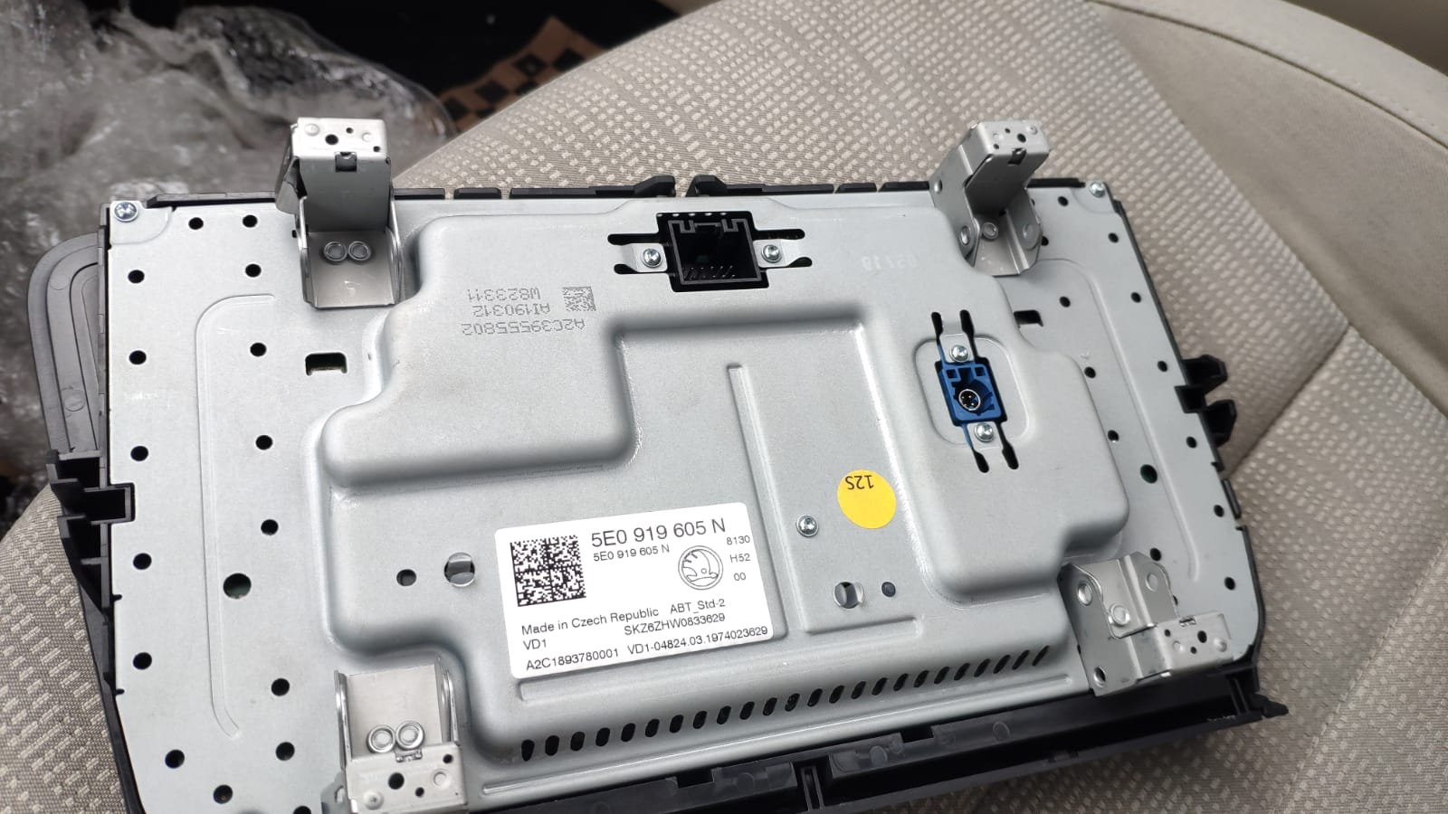

Hello, pab567 . I hope that you also have a connection in Turkey.
I want to replace the Amundsen Mib 1 system in my 2014 Octavia.
I bought the Bolero 8-inch screen and the Mib2 Unit of the 2019 Octavia car that was scrapped for this.
Smartlink is active on my newly purchased device and has not yet been installed in the vehicle.
Is there anything that can be done to keep Smartlink active?
In the meantime, the old system has navigation but the new system does not have navigation. Hope it won't be a problem
Waiting for suggestions. Greetings

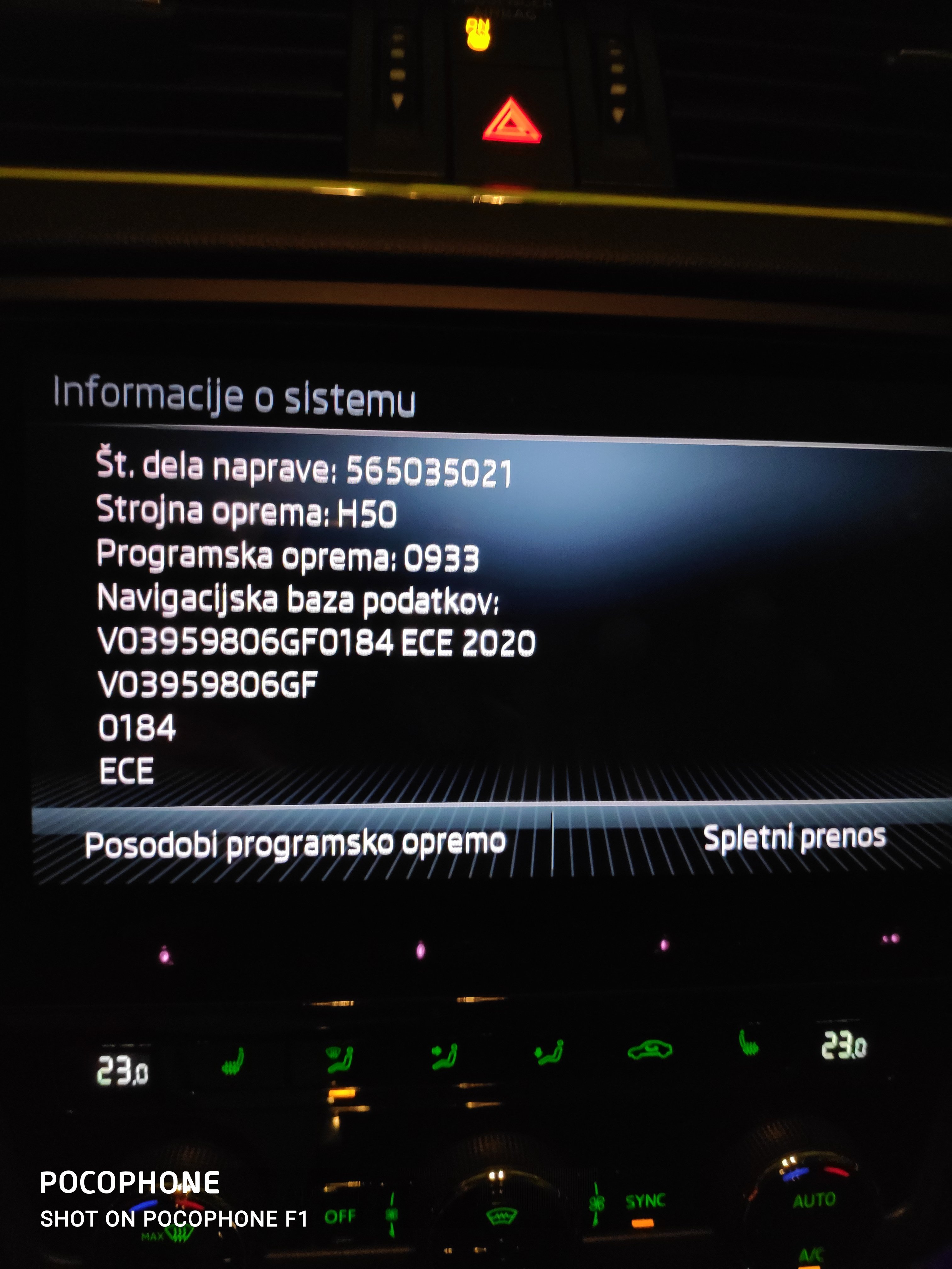

@pab567 hello! Got mib 2.5 my2017 in my octavia? Is possible to update to get the icons and sync ambinet lights?
Greetings!
Model number and SW version pls - you can check it in SETTINGS / SYSTEM INFORMATION
@pab567 here it is:
Check your PM
