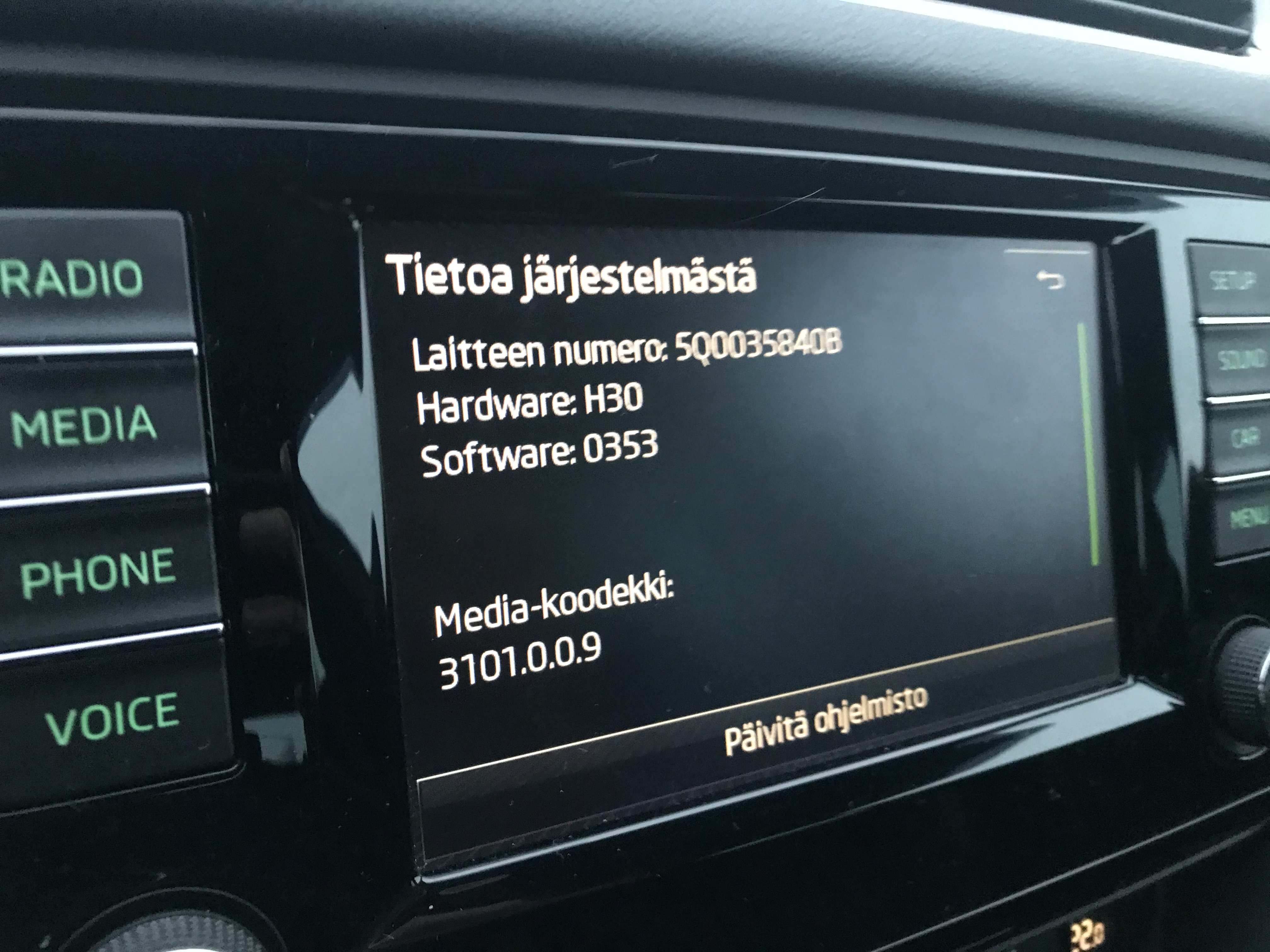

On 27/02/2020 at 15:46, Unknown_forever said:
Hi, I have Skoda Kodiaq 2017 with Bolero infotainment system. I want to update the system. The Bolero system spesifications are
Device number: 5Q0035840B
Hardware: H31
Software: 0363
Meda codec: 3141.0.0.1
Any luck?
Thanks for the help.
Serkan
I have the same unit on my vrs.
I would just like to have a bigger screen. What are my options? Can I change FL version screen?
Can I just plug a new screen and no need for CP coding? Only the plug mod, right?
That’s correct, 5E0919605N is the part number you need, there will be a small connector mod but nothing that 2 mins with a craft knife wouldn’t fix.

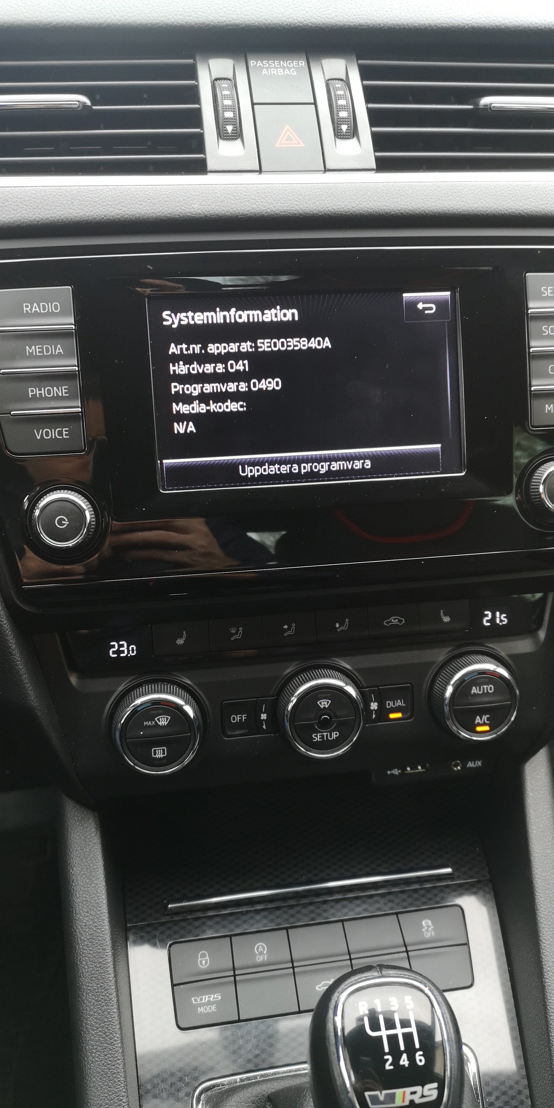

Hello from Sweden,
So, I have a 2015 Octavia vRS with Mib1 Bolero. I'd like to be able to fit one of the bigger screens and need to upgrade to a Mib2 if I've understood it correctly?
I want to be able to use Android Auto, but don't mind if there's onboard navigation as well. I might add that I have Canton speakers/sub.
What are my options, what should I go for?
If you want a larger screen you need a MIB2 and you need a new amp for the CANTON system that is CP free and MIB2 compatible so that’s the biggest issue, the rest of it is standard MIB swap stuff.

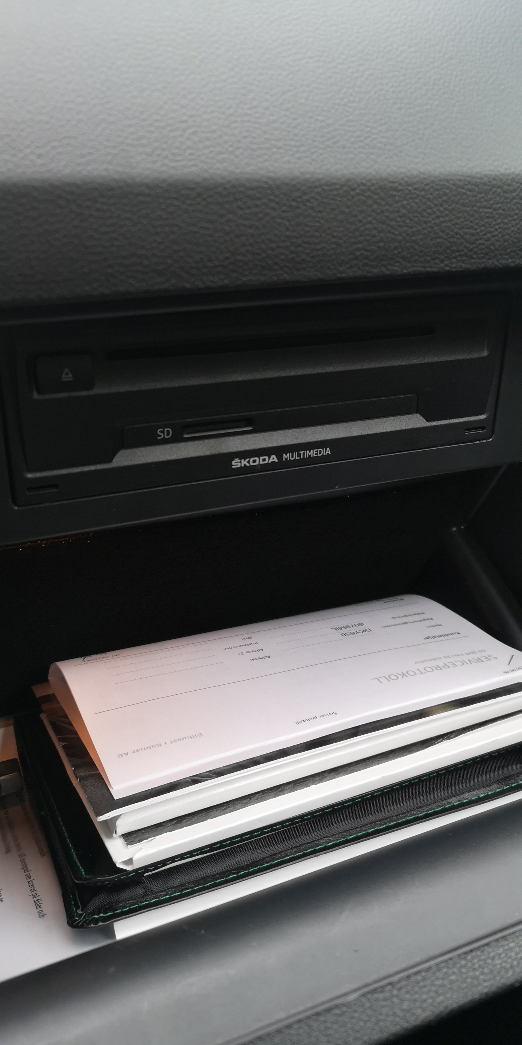

I am trying to find out what antenna feeds the Superb Mk3 L&K with Columbus sat nav has , the car is fitted with the sat nav, 8” screen, 2 SD card slots in the glove box, but no SIM card slot.
My suspicion is that the mini shark fin probably has GPS, and possibly FM radio with phantom power feed ? but not sure, I’ve not had a dig about under the headlining yet, so don’t even know how may feeds come off the antenna as yet.
Any insight greatly appreciated.
many thanks
