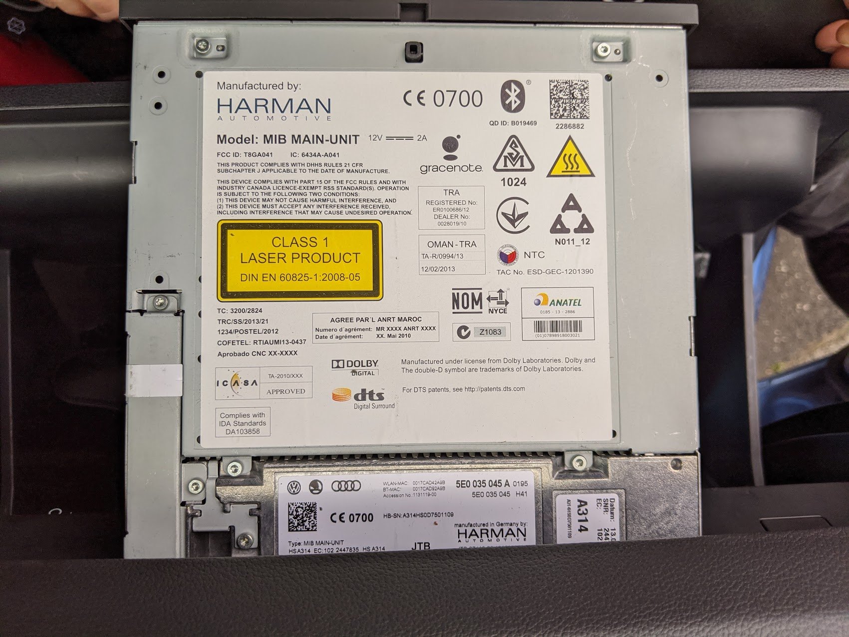

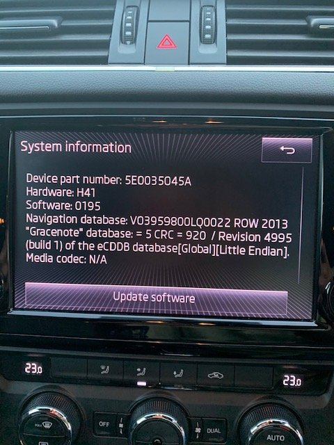

Hi,

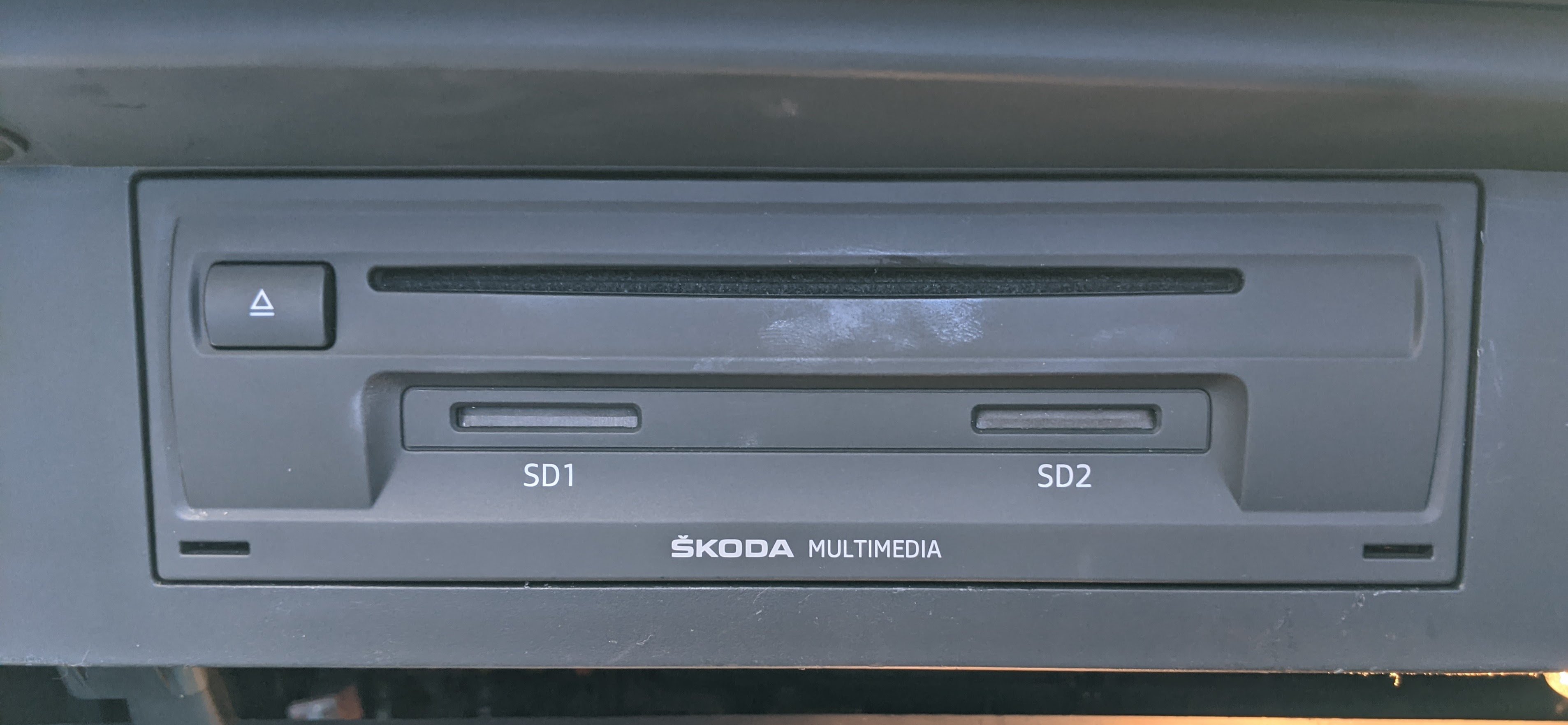

My wife's 2013 Octavia Elegance has an issue with the infotainment system where it powers on but goes into a boot loop: shows the usual ‘Welcome to Skoda’ screen then gets stuck on the Menu for a few mins before restarting again. The screen won’t respond to any touches at all and I’ve tried the soft reset method several times with no luck.
Took it to the local Skoda dealership here in Australia who advised that the glovebox unit was faulty and quoted us over 8,000 AUD for a replacement!  So I've started looking at some used examples on Ebay and from local salvage yards.
The unit we currently have is an MIB1 with the part number 5E0 035 045 A. The screen is the 8inch version (pictured below) but I'm not sure of the exact part number and unfortunately unable to retrieve it given the system isn't working. It also has navigation and is Canton.
Just wondering how interchangeable other units are with the screen we currently have? Unfortunately I've been unable to find a direct replacement on Ebay and I would really prefer to only have to replace the glovebox unit and not the screen if possible.
Am I able to simply replace the existing unit with any MIB2 unit such as 3V0 035 045 B without needing to replace any other component such as the amp or screen?
I understand any replacement unit will require content protection to be removed but the service dept at the dealership have said that they are happy to remove this for me and code it to the car.
Any help or advice would be greatly appreciated.
Thanks!
That screen should work with many mib2 units as it is a Columbus mib2 screen. If going down the mib2 route you will need a new amp and then that will need CP removal with the head unit CP work. Could work out quite expensive to get an amp too so look into how much it is for mib1 replacement and see if the difference is worth having carplay/Android auto.
Ok so essentially, even if I could source a used MIB2 unit, I'm still going to be up for replacing the amp with one thats MIB2 compatible to get the system up and running? If so then yep it looks like this is going to end up being quite expensive!
I'm not that concerned with Android Auto for this car. It's never had it so I was hoping that replacing the unit with an MIB2 unit would just give me all of the functions the car already had prior to it failing. If somehow it got Android Auto without making any other system changes (apart from a new USB connector) then that would be a bonus.
I've been struggling to find any MIB1 units around, they've mainly only been MIB2 or 2.5. I'll keep looking but I haven't got much hope. The alternative would be to go down the aftermarket route I suppose.
Thanks for your response, much appreciated!

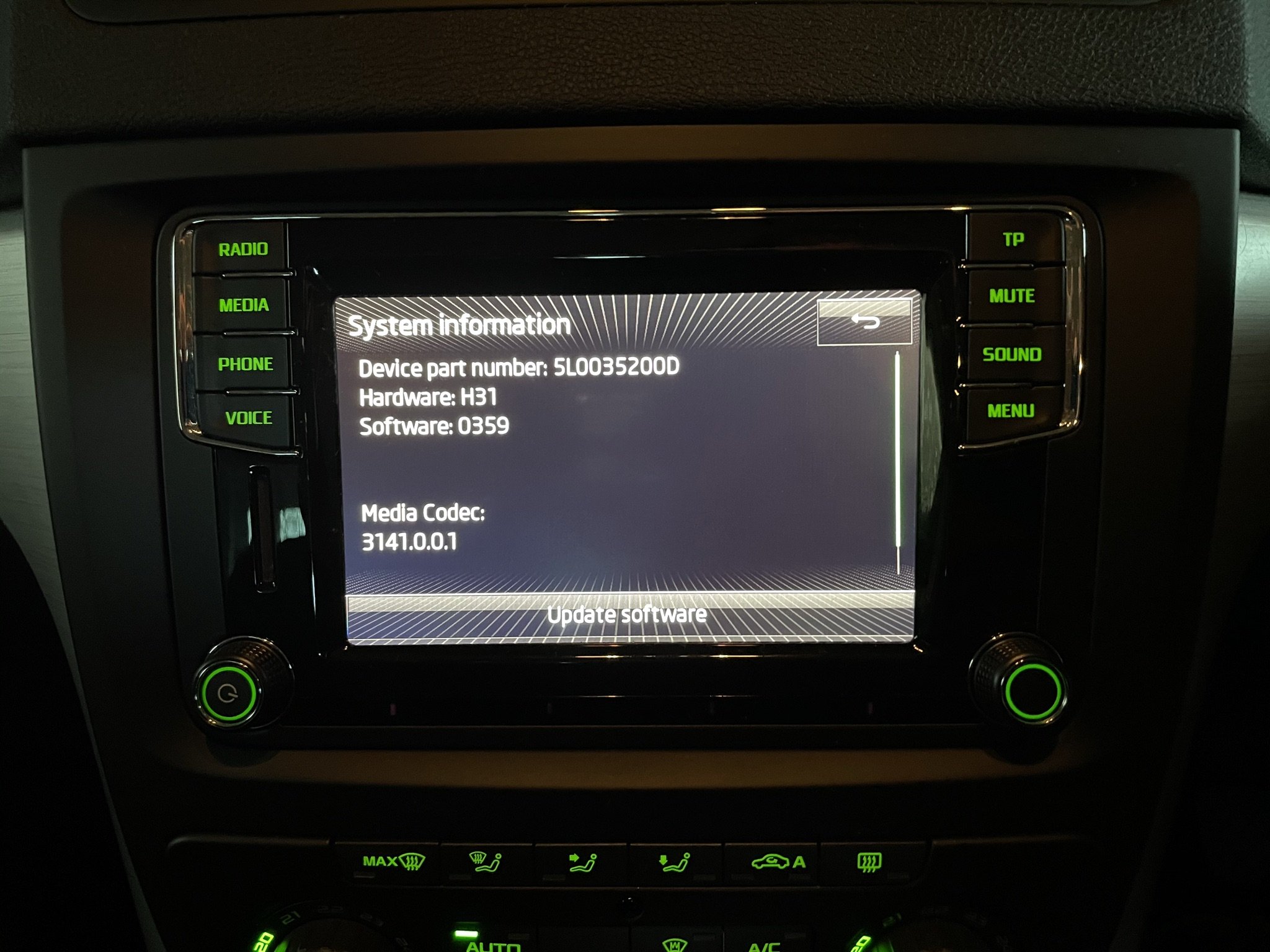

Hi all, hope someone can help. I’m looking to get CarPlay into a 2016 Yeti, the head unit has the smart link option but when selected it simply tells you to contact your dealer to have it activated. From reading through I hear it’s £136 or more for this to be done at the dealer?
the unit is info is:
Device part number: 5L0035200D
Hardware: H31
Software: 0359
Is it worth simply submitting to the will of a dealers prices, or are there other options that would give a bigger screen, better features?
You need an RCD330 that’s Skoda specific. Look for one of those. They have them for VW (I have purchased one) but it has red buttons instead of green.
@Rgrc29 - The Bolero you have is one of the best headunits for the Yeti. The only 'better' options from Skoda would be the:
- Bolero 5L0035200E which adds DAB
- Amundsen 5L0035680D which adds satnav
- Amundsen 5L0035200E which adds DAB and satnav
None of these have bigger screens or any additional features aside from the differences mentioned above. If carplay is your only want, I'd suggest paying the upgrade cost for smartlink as it'll be by far the cheapest solution to your problem :)
I would ignore the RCD330 suggestion, your current headunit is better, more stable and a cheaper route to carplay.
If you do want a bigger screen, you'll need to look at aftermarket solutions :thumbup:
