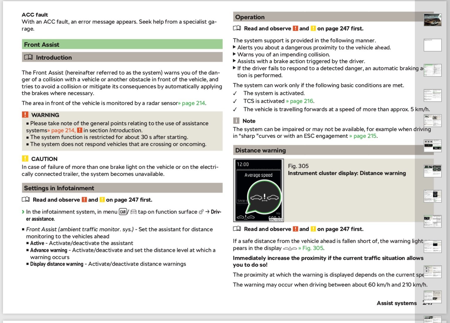

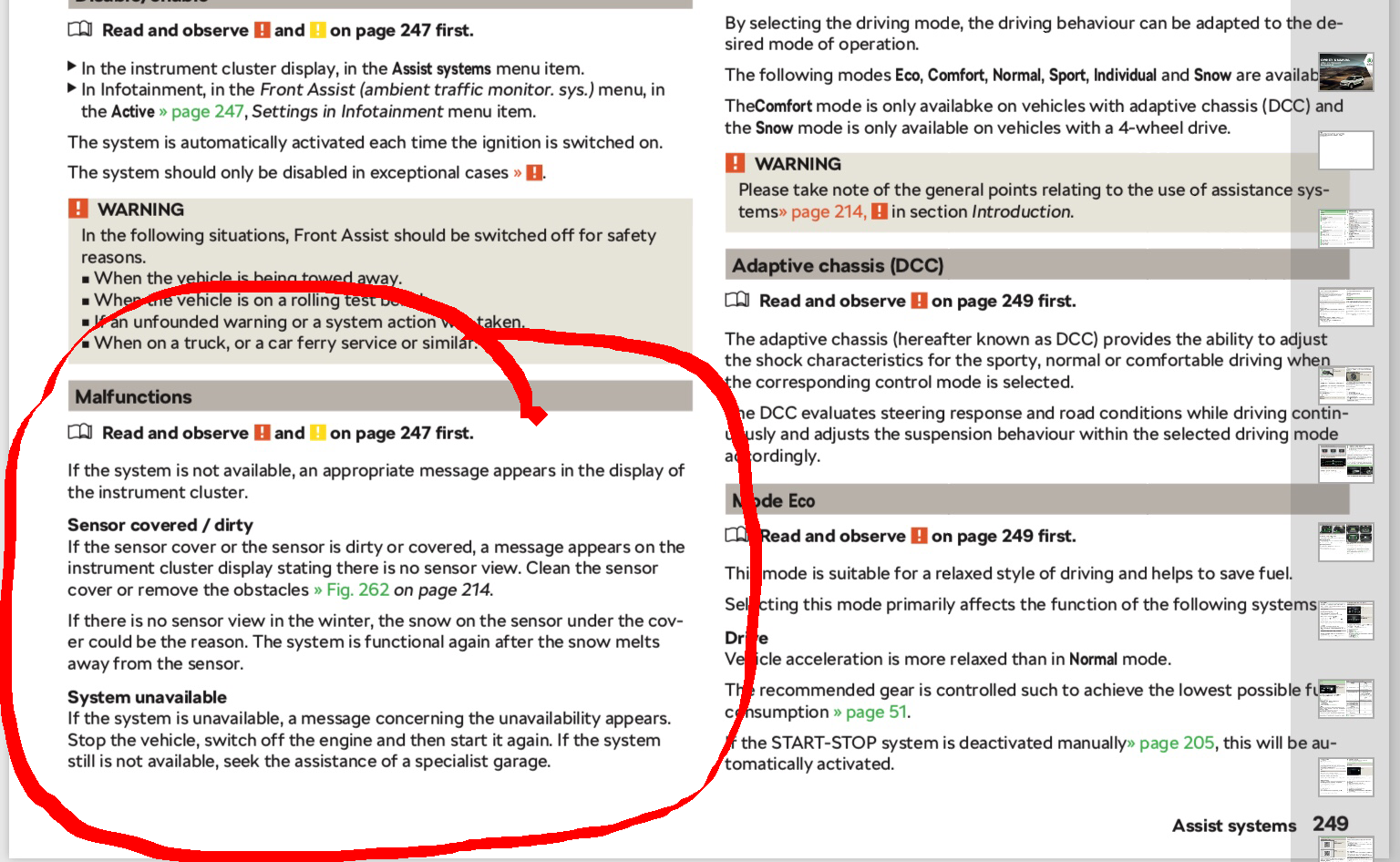

From the owners manual....
Hi  thanks, whilst not a great fan of manuals, I had spotted that and wiped it over. Just wondered whether it was something that had cropped up with other owners.
Looks like a trip to the dealer. Thanks again for your help anyway
