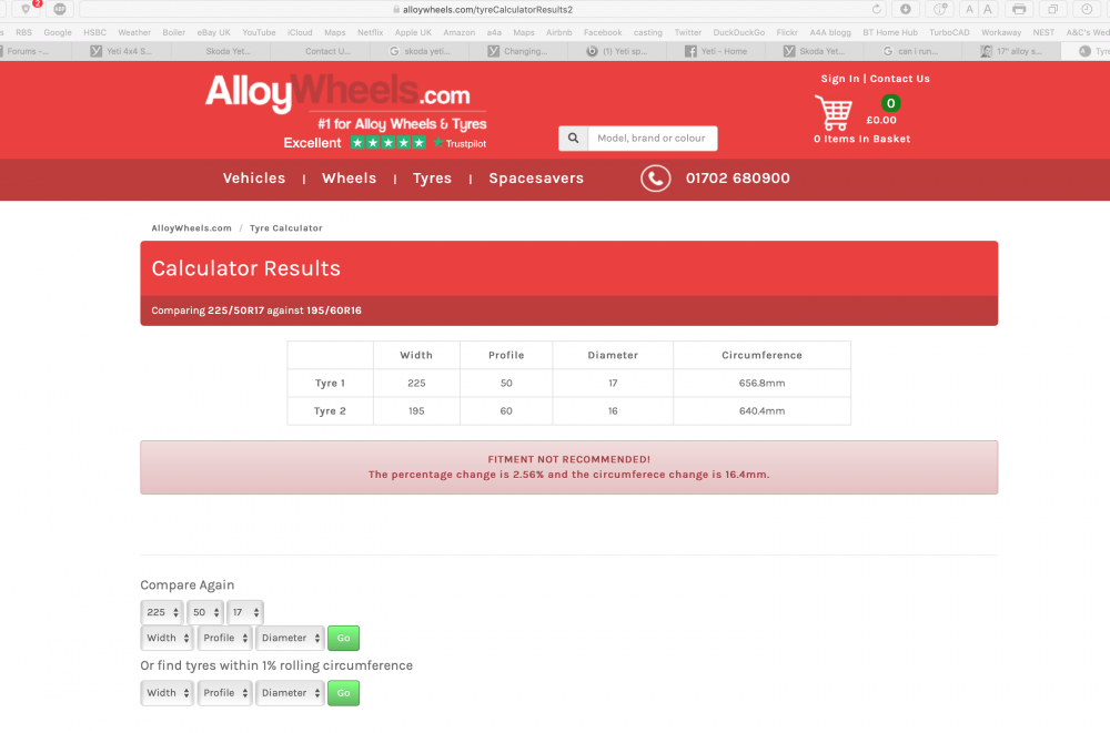

Of interest to me I came across a post which had a link to comparative tyre sizes and input the normal alloy size of 17" against the space saver 16" the result attached - a discrepancy 0f 2.5%+ and was not recommended. A better spare tyre to run on the 16" steel wheel it suggests (amongst many other combinations)  is a 205/60 16" .  https://alloywheels.com/tyreCalculator
I will stick with what I have though.
Here's a theory of mine as to why you should stick with the Skoda recommended spare size;
Your spare will be hopefully unworn..
Your road wheels will be worn. If they are are half worn they will have lost about 3mm of tread. That equates (I think) to 6mm x 3.142 (D x pi) or about 18.5mm reduction in circumference of a new tyre. So your half worn road wheels will have a circumference of about 638.3mm - or only 0.3% error compared with your new spare? In other words the spare's diameter is chosen to be similar to that of a half worn road wheel.
I stand to be corrected though....

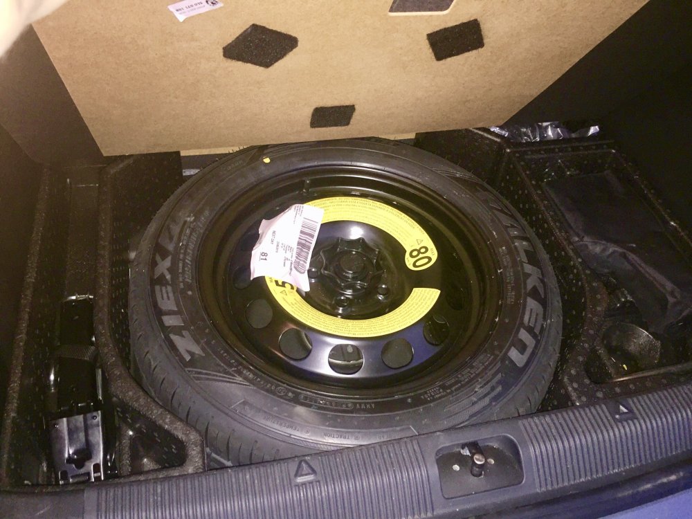

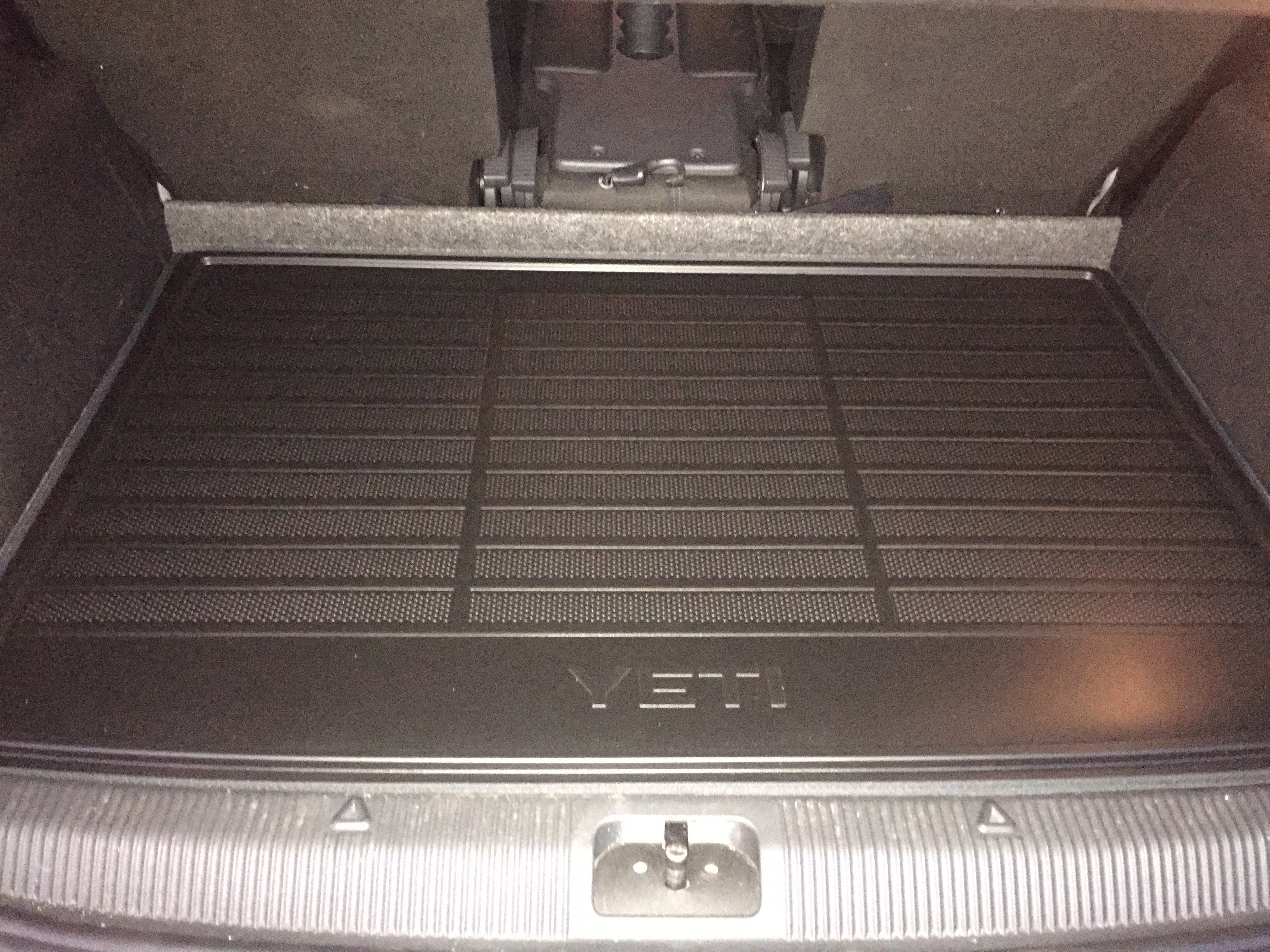

Yes good points, a full size 17" 225 wheel would not fit into the foam surround and would elevate the shelf too much. Installed the kit this evening with the 16" and shelf kit - its flush with boot cill, lost some space but happier with a spare wheel on board.
