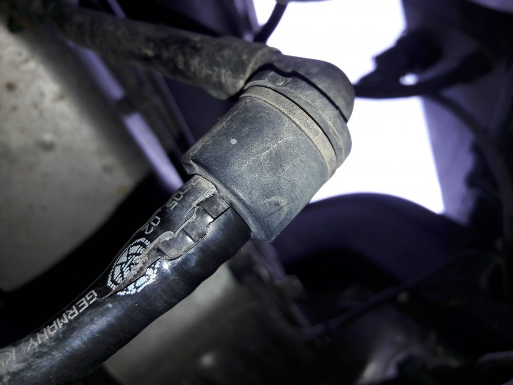

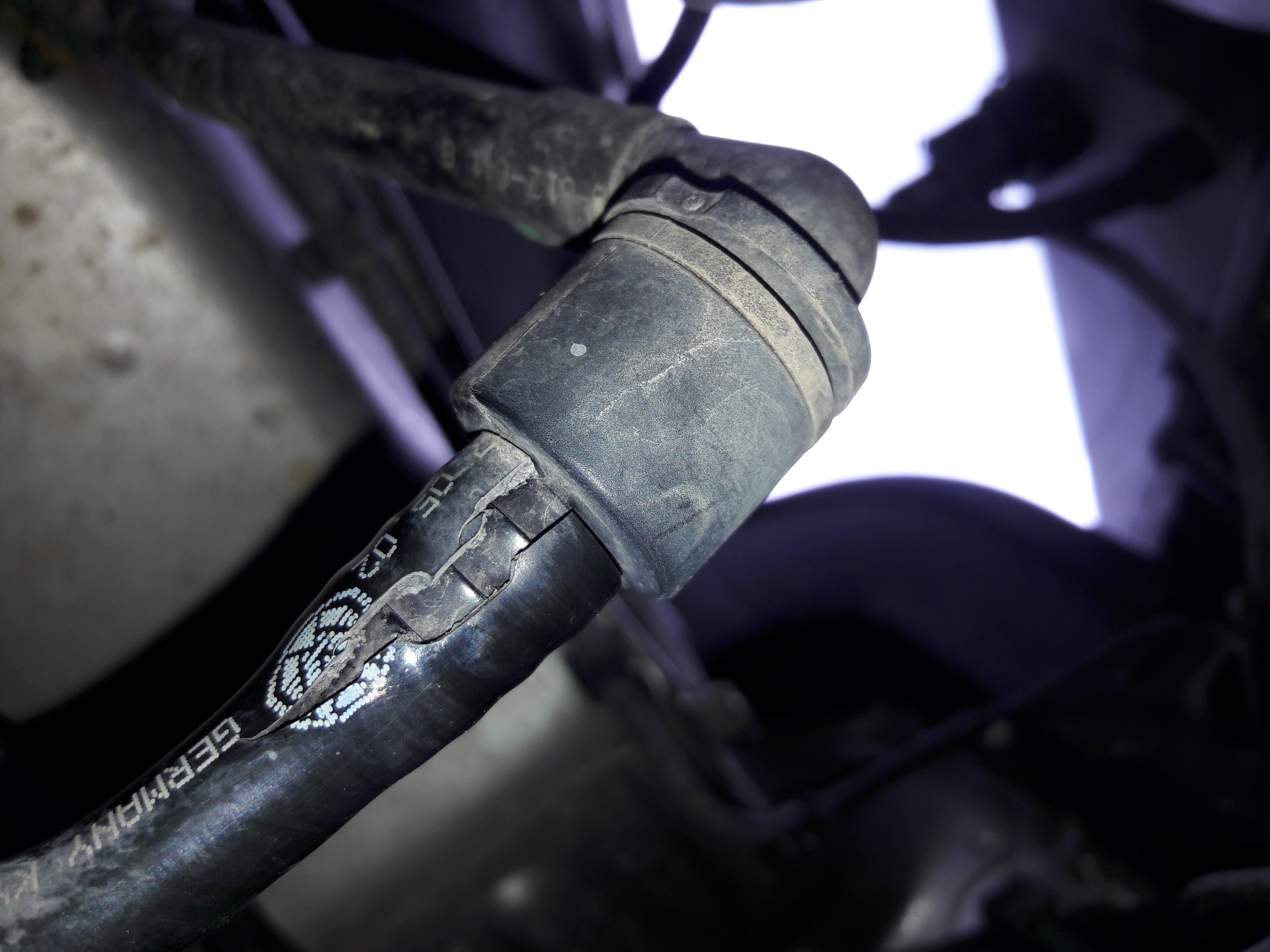

Inspecting the brake servo vacuum hose for cracks/splits by eye and by feel is a free check that's always worth doing unless it's been replaced in the recent past.
They tend to split at the ends of the hard plastic sections.
This photo's from a Mk4 Golf, but the materials and designs are similar.

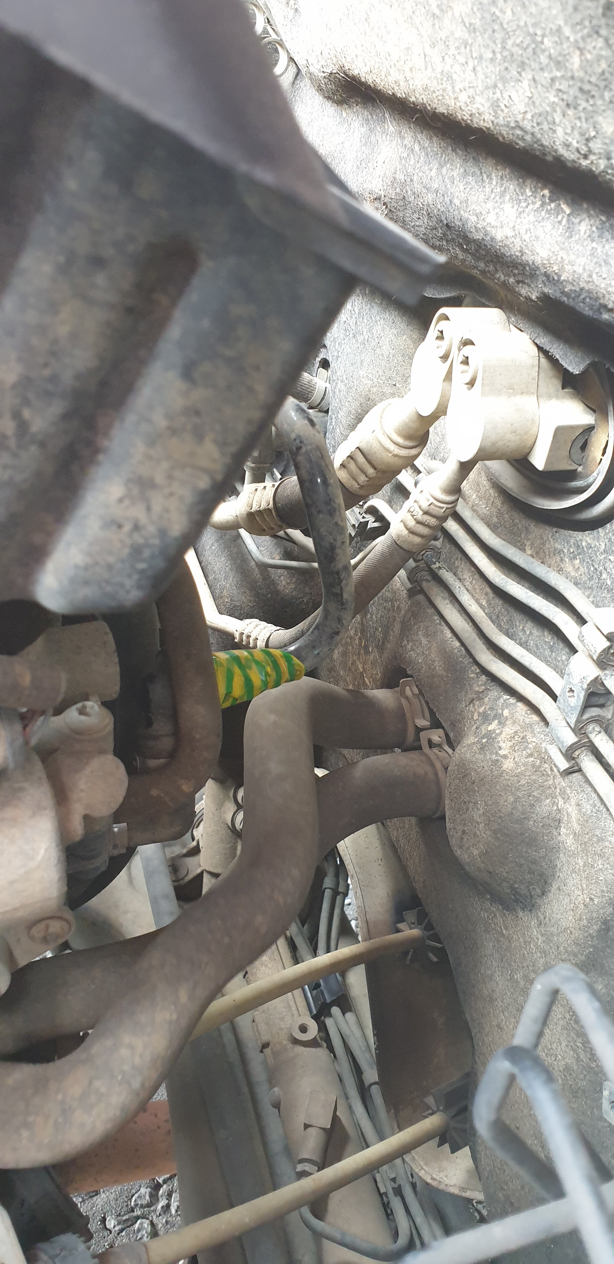

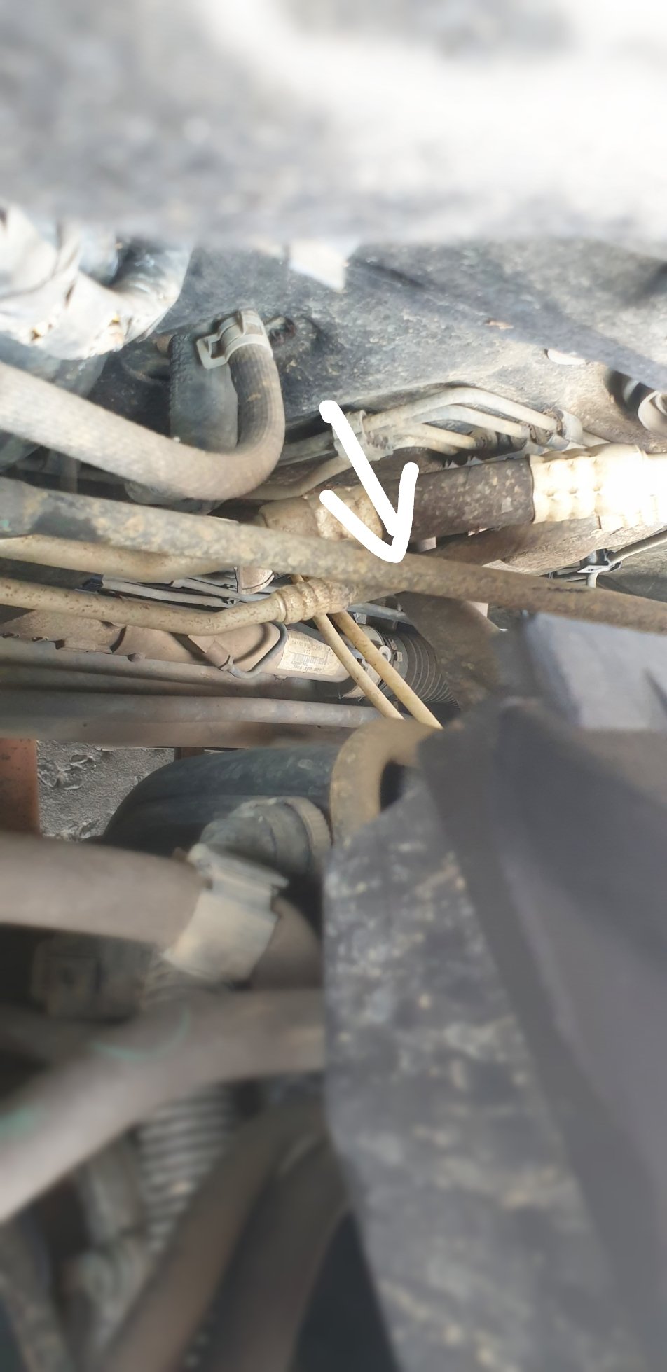

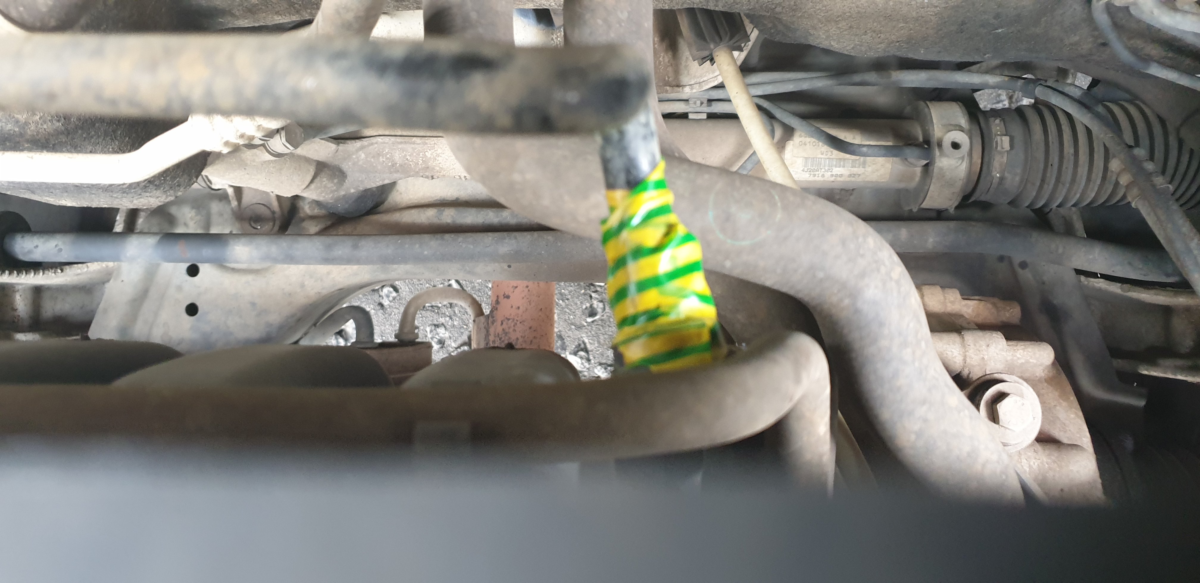

Hey I had the same problem where the car would stall when idling at traffic lights etc,
I found that the problem was this oxygen pipe that apparently supplies oxygen to the breaks,
The bit which connects at the back of the engine was split, so I put tape over it temporarily, but eventually I went to a garage and replaced it with a new pipe for £25.
Now it works like a dream.
It supplies vacuum to the brake servo.
