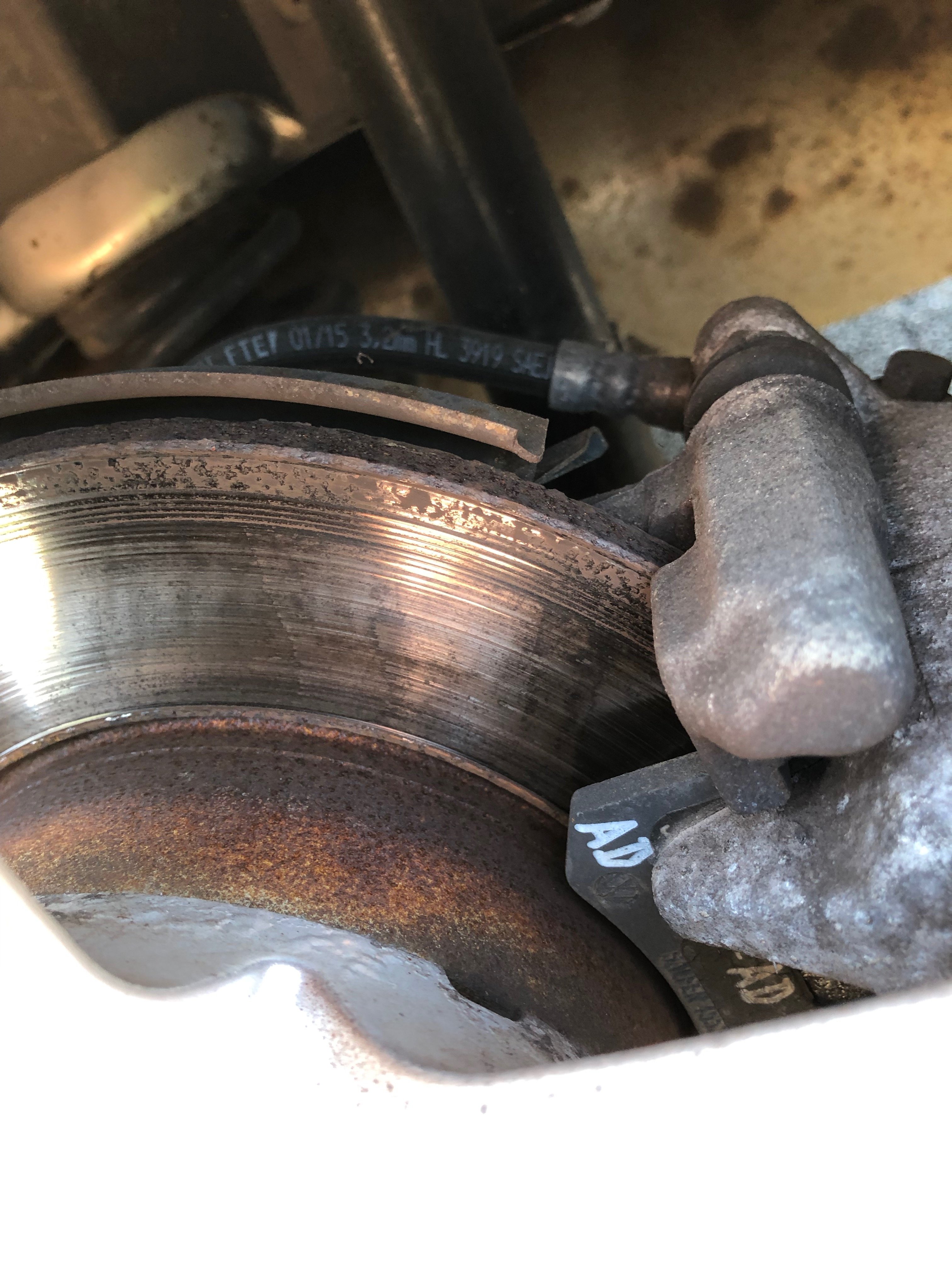

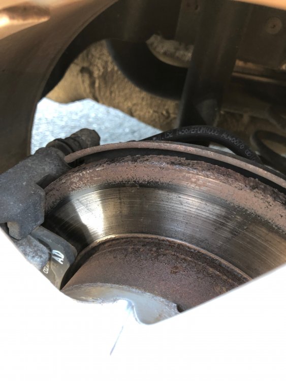

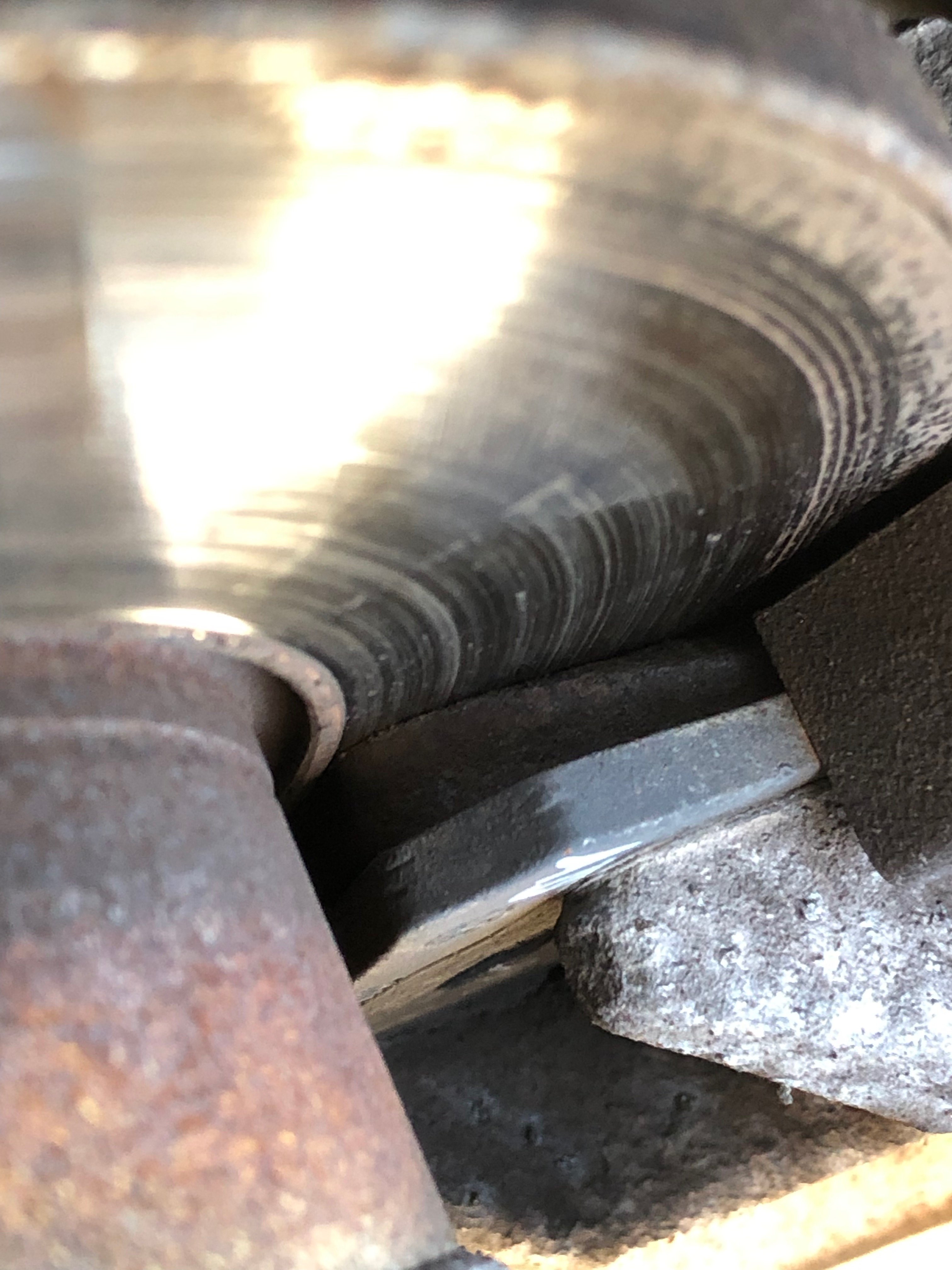

Hello all,
My rear brakes have a lot of rust on the outer edges, drivers side is worse than passenger side. Anyone else have the same issue or know what the issue is? MOT in April was passed but I had the brake fluid changed as I was advised from the garage that it was looking scummy.
I've always known VW cars to have a very instant brake pedal but this Skoda is more soft and spongy... small amount of pedal travel until it actually brakes, just wondering if this is the issue.
IMG_1333.thumb.jpeg.284792974d603e8b6d962386c325fc7e.jpeg IMG_1335.thumb.jpeg.66675b5ed28d2cf4f6b5d527b1e14e59.jpeg IMG_1336.thumb.jpeg.963bcfb787bdaa65a808b2a4687fffd7.jpeg
Well that is not helping anything, but they must be good enough for the MOT, personally, if I had rear brakes that looked like that AND I was not happy with the feel of the brakes in general, I'd just replace the discs and pads as these discs will never clean up that rot is too well in for that.
But you will see many cars with worse looking rear discs in any car park.
I'm by no means an expert, but as far as I understand its pretty normal for a bit of a lip to form on the outer edge of the disc, the brake pads don't make full contact. Wouldn't be surprised if maybe some of the rust on the lip has broken up a little of the pad or something so its causing a bit less contact hence a bit more rust?
Isn't the majority of the braking done via the front anyway? So i wouldn't imagine a great deal of noticeable difference from replacing the rears, might help a little though.
I read somewhere that it could be the calliper pins are either seized or sticky, and can be removed - lubed - put back in again, not sure if that's the issue. I know my disks are original at the front, car is on 30k miles so will probably just wait until they need replacing and i'll get all 4 corners done.
Does anyone agree with what I notice? I've had 5 VW cars all ranging from 2002 - 2016, Audi, Volkswagen, SEAT and Skoda (this car) and the Skoda seems to have a less responsive brake pedal than the others. I'm not worried as MOT is passed but I am curious.
EDIT: not sure if the rear brake callipers have pins though? Might take the wheel off next week and have a look
Edited by JAMMYZ

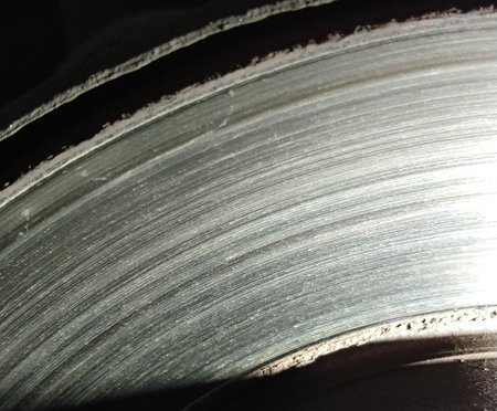

Photo of one of my rear disks at 3 years and 35 K miles.
But I take the brakes apart clean and regrease every year in the Autumn.
This is what you want to do to keep them working well.
